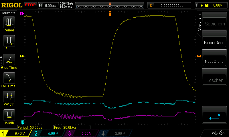

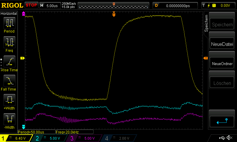

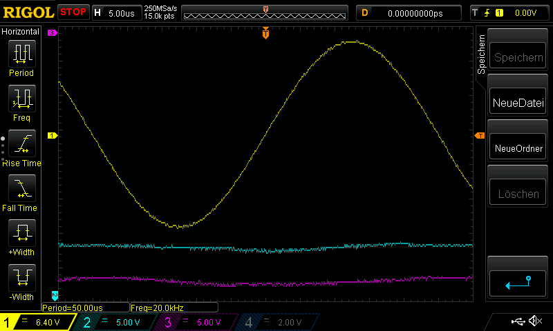

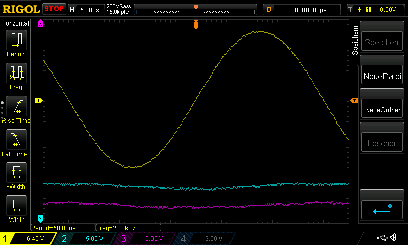

Here a comparison between regulated and raw power supply. The regulator is Jeff's inverted design which looks really similar to the raw supply. The original Naim regulator provides slightly flatter power rails (see previous shots):
You can see some instability also in my previous scope shots in the supply rails, even the Naim regulator board shoes this. But only at high power into a 8R/1uF load with square wave - really brutal, I even smoked one of my regulator boards yesterday (and repaired it already).

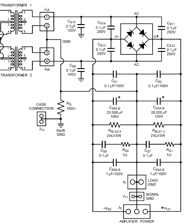

PSU is 500VA with 22.000uF. What do you think of the supply rails moving slightly up and down with the sine waves? Is that a bad thing?

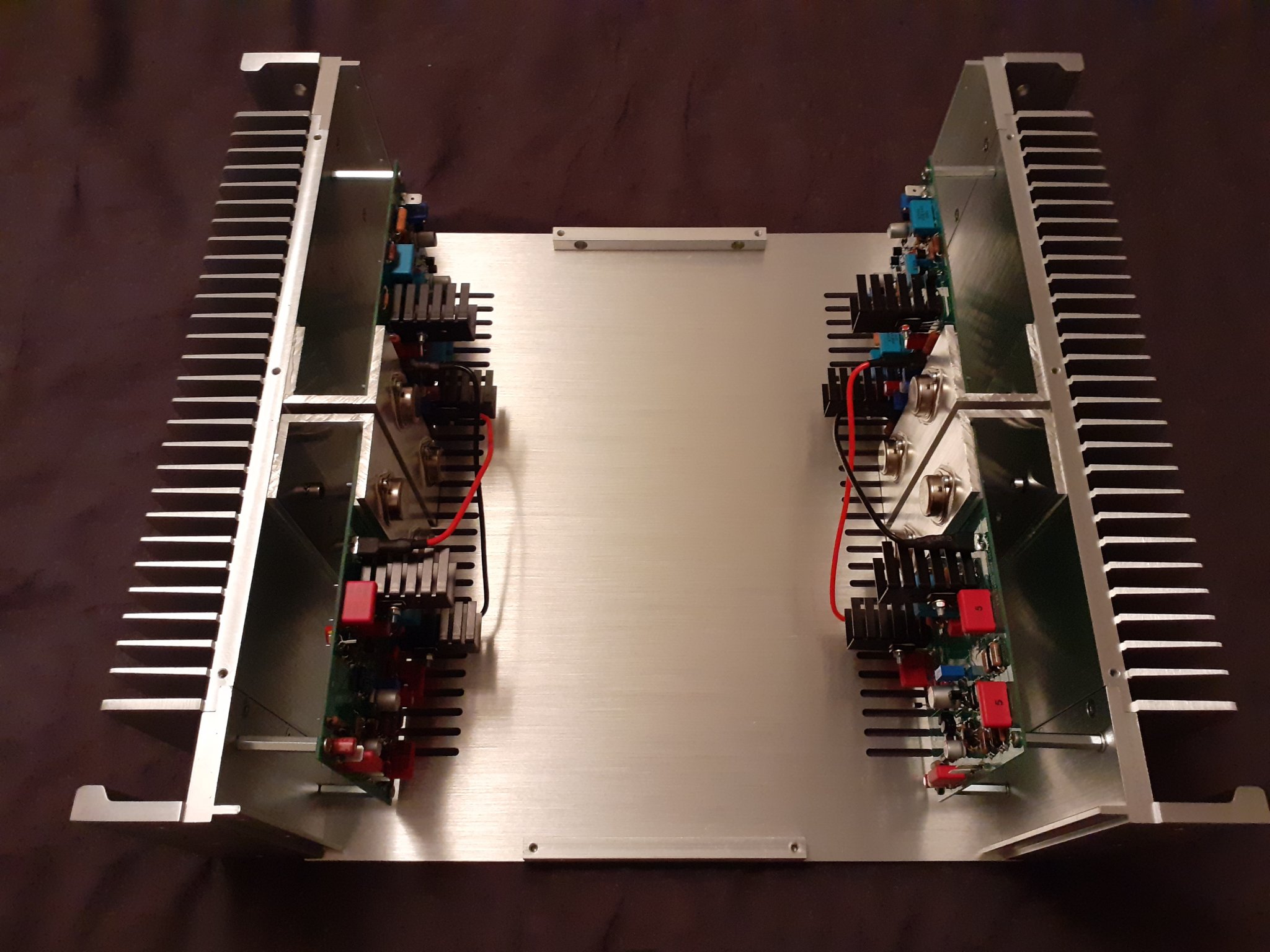

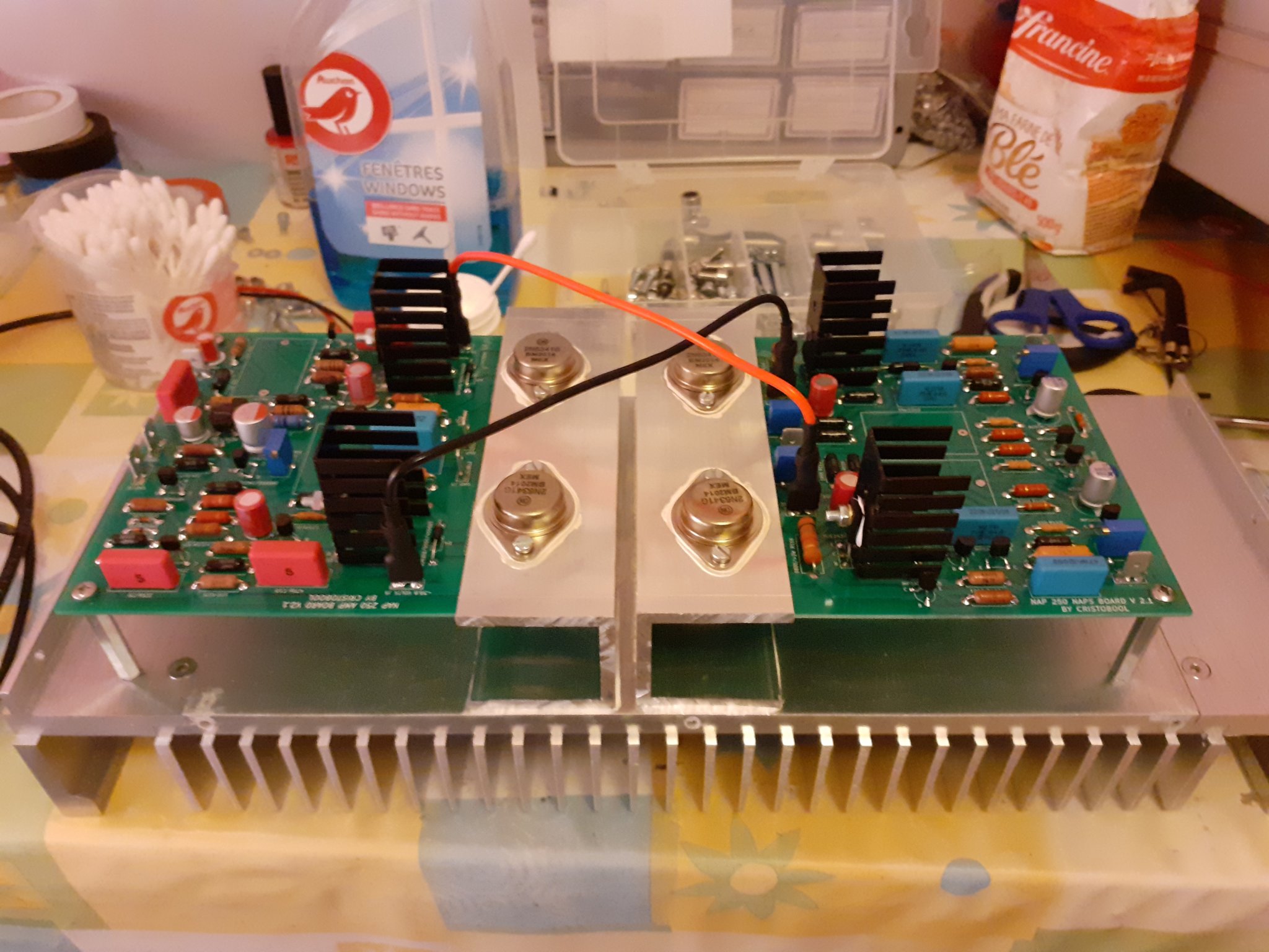

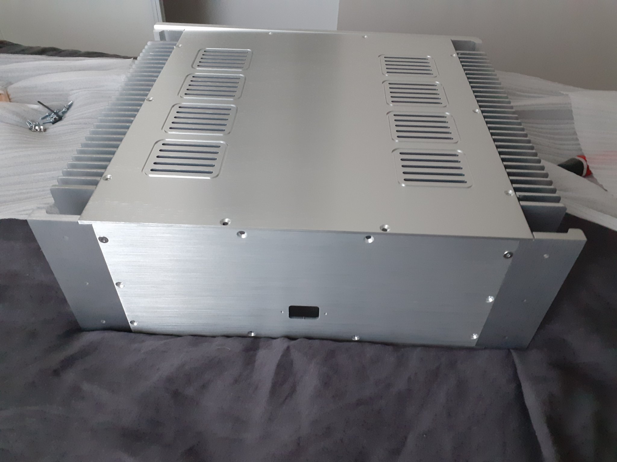

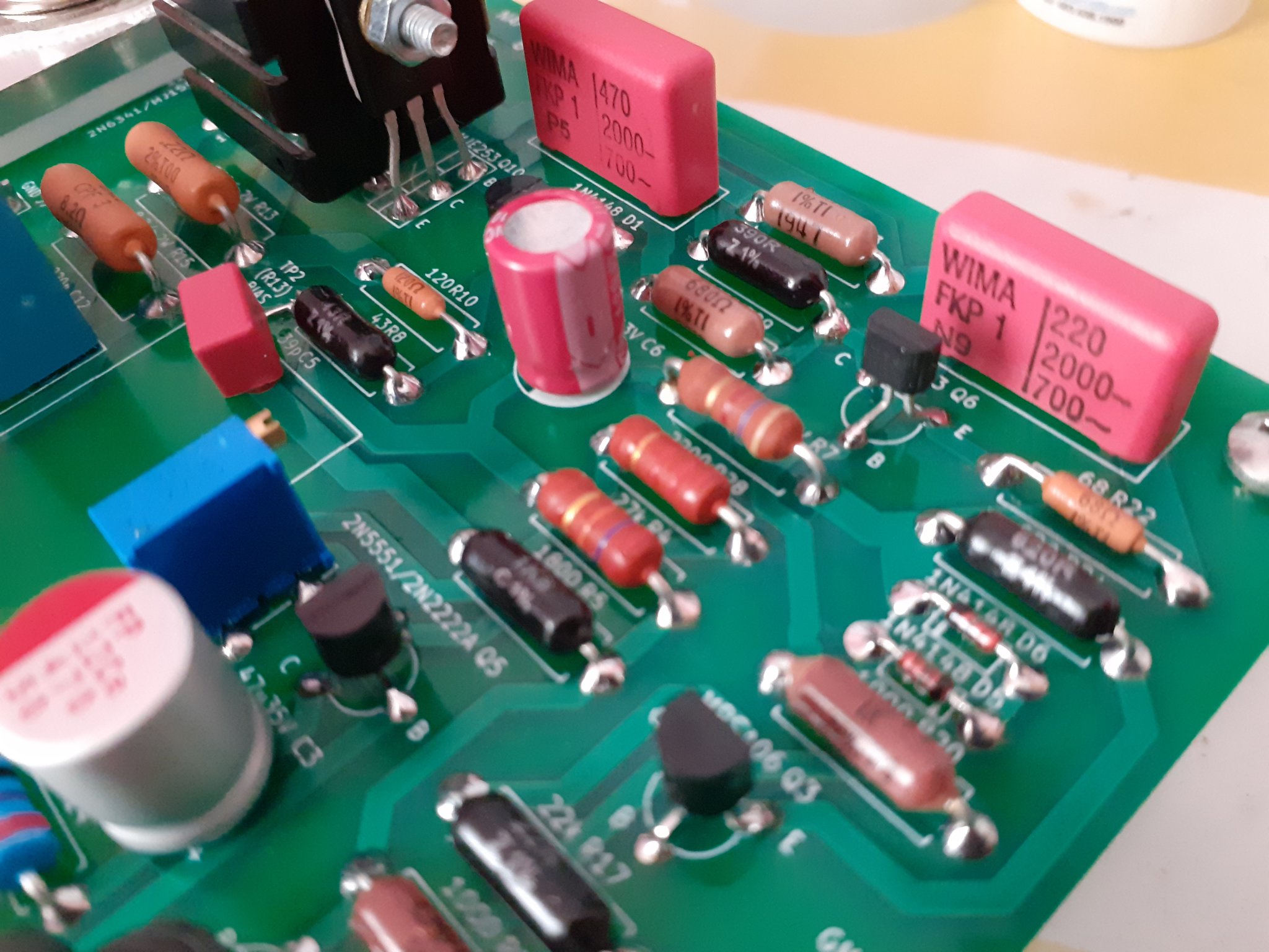

Nice solder jointsHello here is progress of the project. unfortunately I'm not moving fast, I must say that I'm very busy with my work these days.
I finished and tested the second regulation board
then i cleaned the solder flux from all four boards.

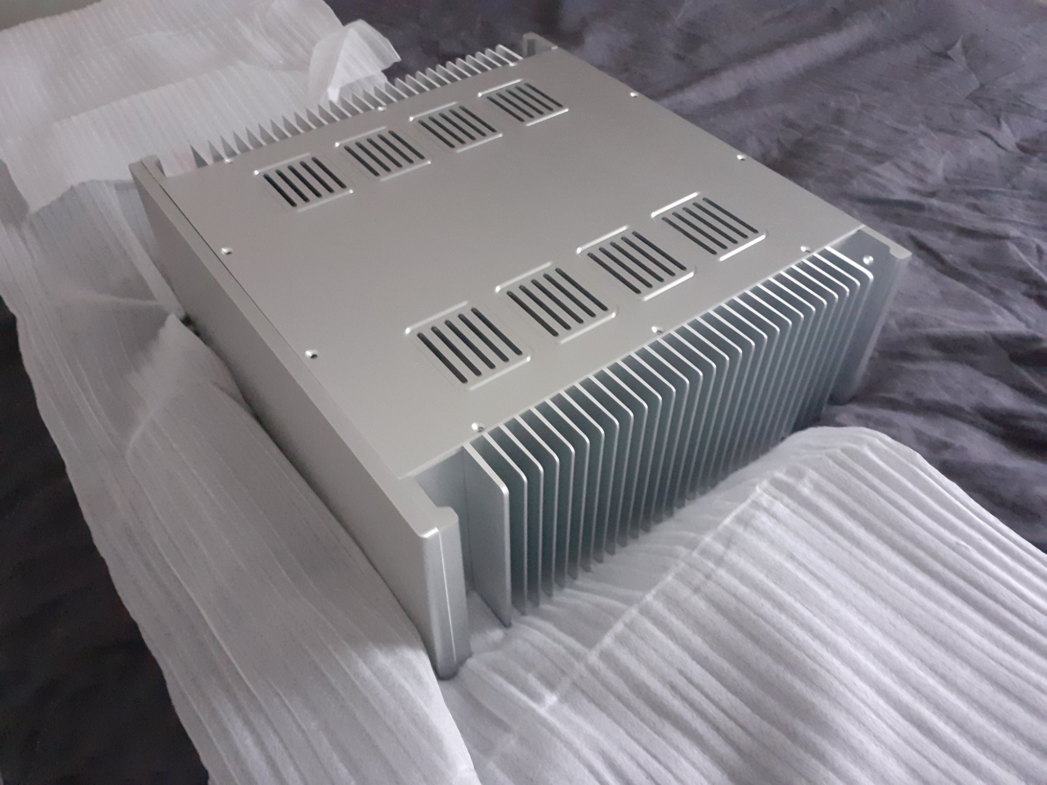

I received the final box
View attachment 1106526 View attachment 1106527

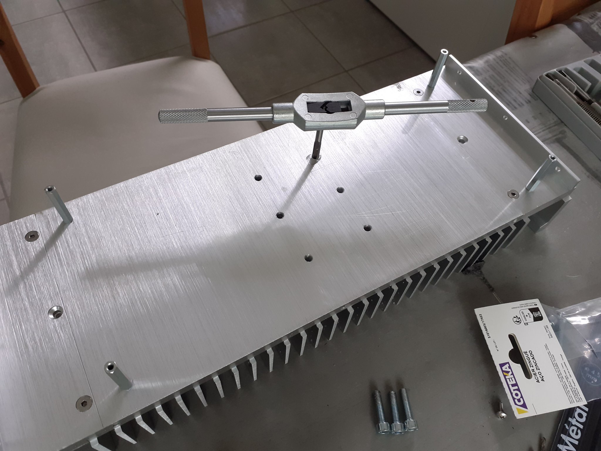

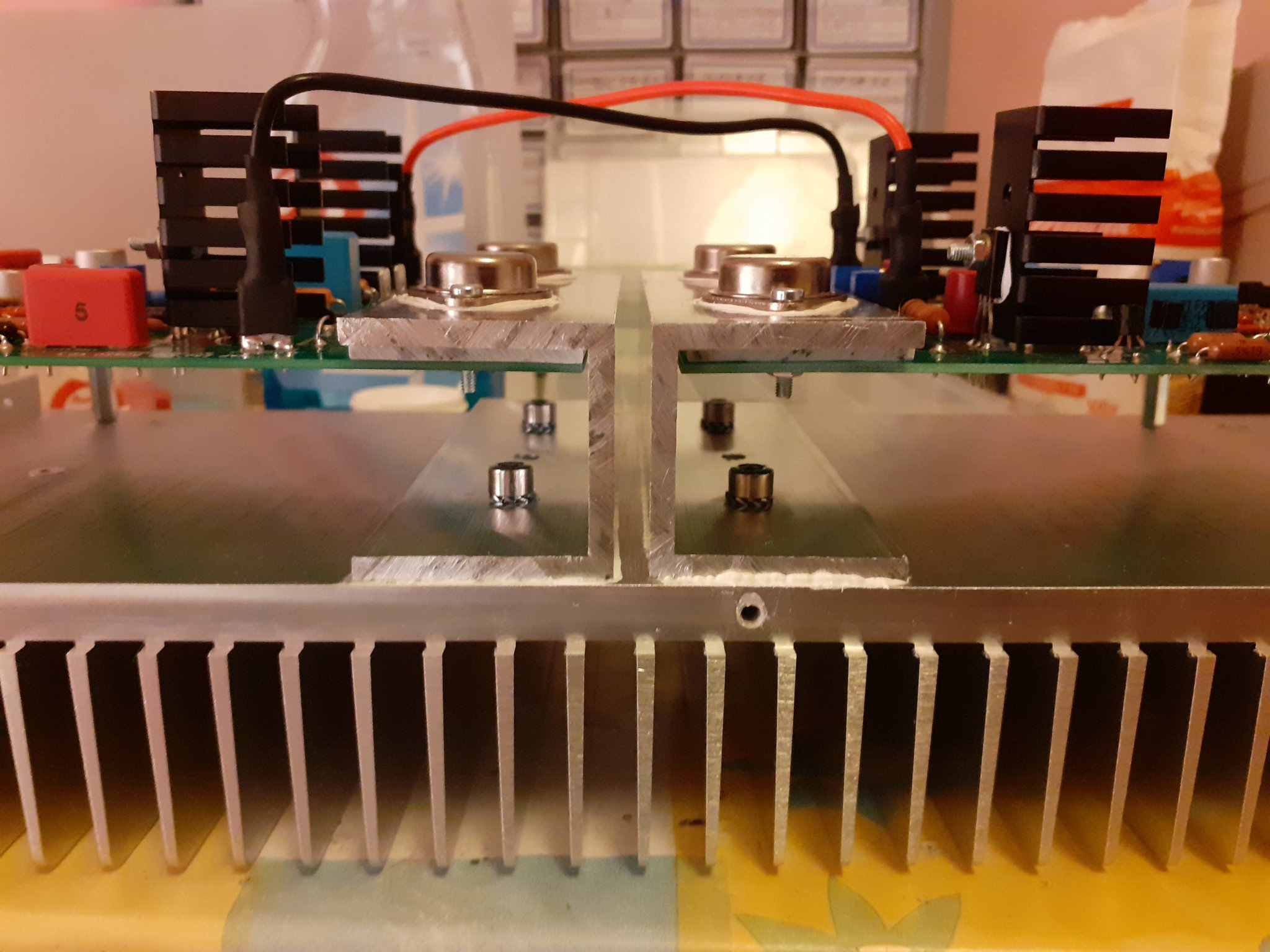

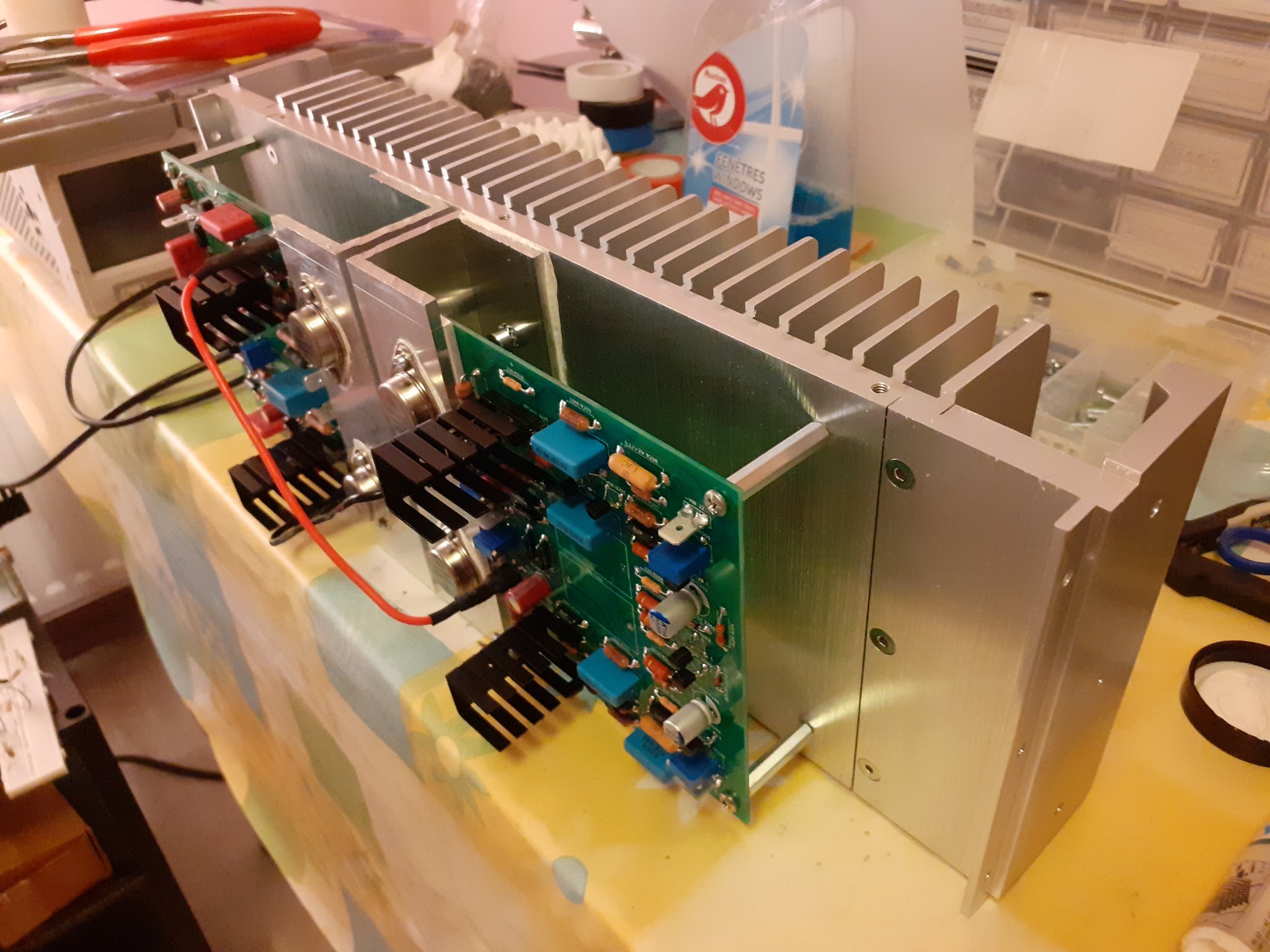

and I mounted the cards on the two heatsinks of the box and it was not without difficulties but finally we got there.
View attachment 1106529 View attachment 1106528 View attachment 1106530 View attachment 1106532 View attachment 1106525

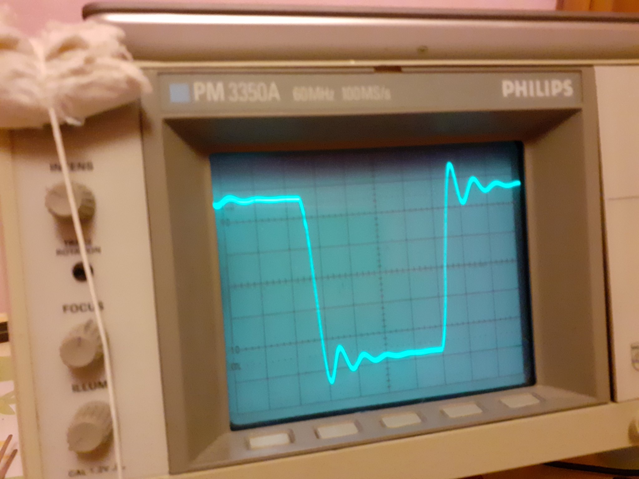

I continued the tests the day before yesterday. I tested with the Mj15003 once the phase compensation was adjusted with different frequencies and impedances (14Ohms, 6.8ohm, 4ohms at 100Hz, 1000Hz, 10,000Hz and 20,000Hz)
And the amp reacts the same up to 1 volt input, in short, the phase problems do not seem to depend on the impedance of the load or the frequency of the signal.
I then started the tests on the 2N6341G I was able to adjust the phase compensation, it reacts well I went up to 1.7 volts input on 6.8ohm. It is stable with a test on the capacitance of 1 Uf.
On the other hand there is more crossover distortion than with the Mj15003, it appears a little beyond 20,000Hz So it's better than with the BUV22 or the MJ15024 but not ideal either. Maybe other drivers should be ideal, I don't know.
I still have to confirm these tests with different frequencies and impedance. after I will try another transistor for TR5 (ZTX690B)
Then I would retest the stability of the regulation card.
results on 2N6341G at 10Khz/100mv 6,8ohms, 1Uf capacitor

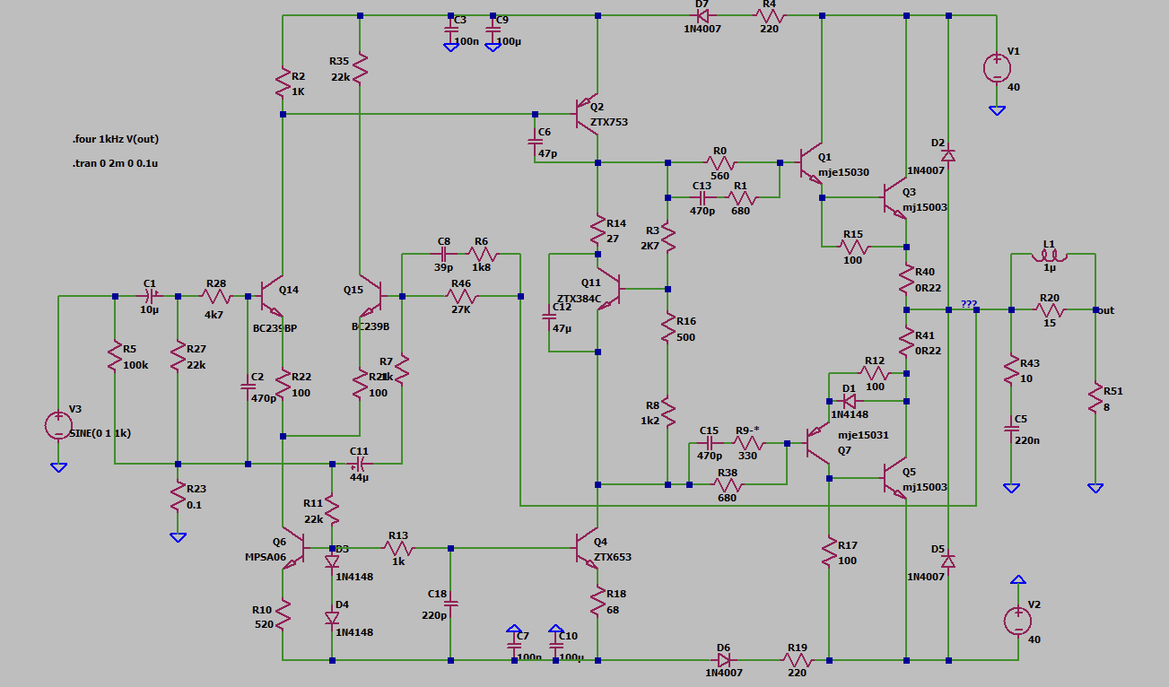

maybe ! but i don't have this drivers for now to test it ! i have another reference in stock i have to look at the datasheet of this first ^^Great! Maybe the MJ15030-33 as drivers solve the cross over problems, Avondale uses them even with 15003s, and many other clones do as well.
mdardeniz with 100 ohms ? what resistors you tell about ?
Sound signal is not a unique frequency. it depends on some harmonics and some addition of different frequencies. for example 20khz signal on the 1khz sin signal. I'm writing that, I want to find some complex signals for ltspice to simulate sound waves. Perhaps, someone show a PWL file or any advice? Is this another thread head?

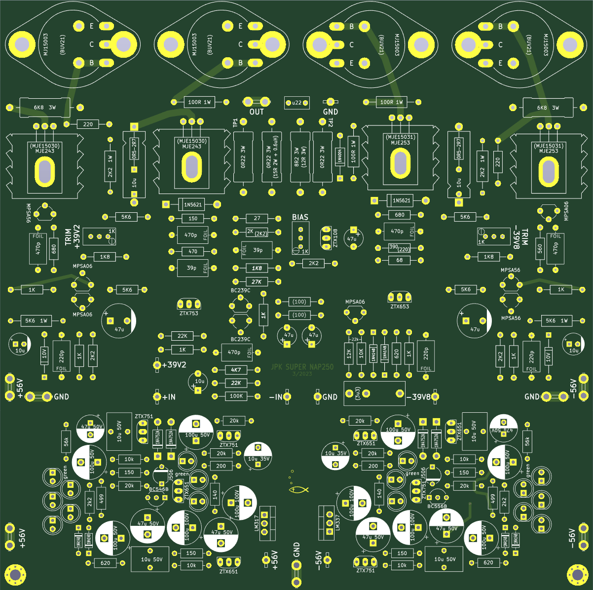

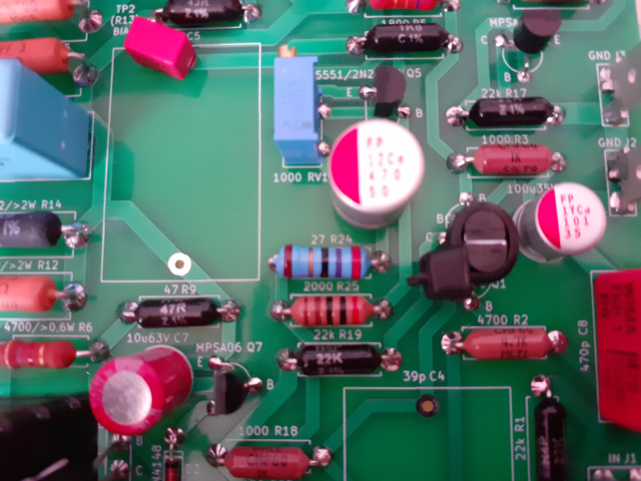

I have completed the tests on the amplifier board. With the 2n6341G I get the following values:
R25 2000 ohms
R26 1000 ohm
R27 750 ohm
R29 680 ohm
R30 820ohms
Crossover distortion appears around 30,000 hz
I did a listening test the amp sounds good it doesn't seem to really change the sound.
I can go up to 1.8 volts at the input so I'm quite happy with the result on this transistor model.
For the Mj15003 I found the following values (which are not claimed the very best)
R25:2000
R26 470
R27 150
R29,680
R30 220
in fact there is only R30 to change
with these values I go up to 1.5 volts in input
