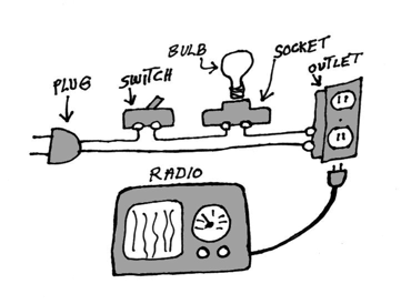

At power up you can use a simple light bulb soft starter..
These would help to avoid damages like these
Are the power transistors original or Ebay stuff. Last time I used Sanken it blew up into my face at DoGC amp.
Which is line & which is neutral?
Why the radio?
Why the radio?
It's so you'll still have music even if the amplifier is bad.
Why the radio?
Bulb goes to the power line.
Radio and all the rest just an illustration.
Please use a regular 100W light bulb.

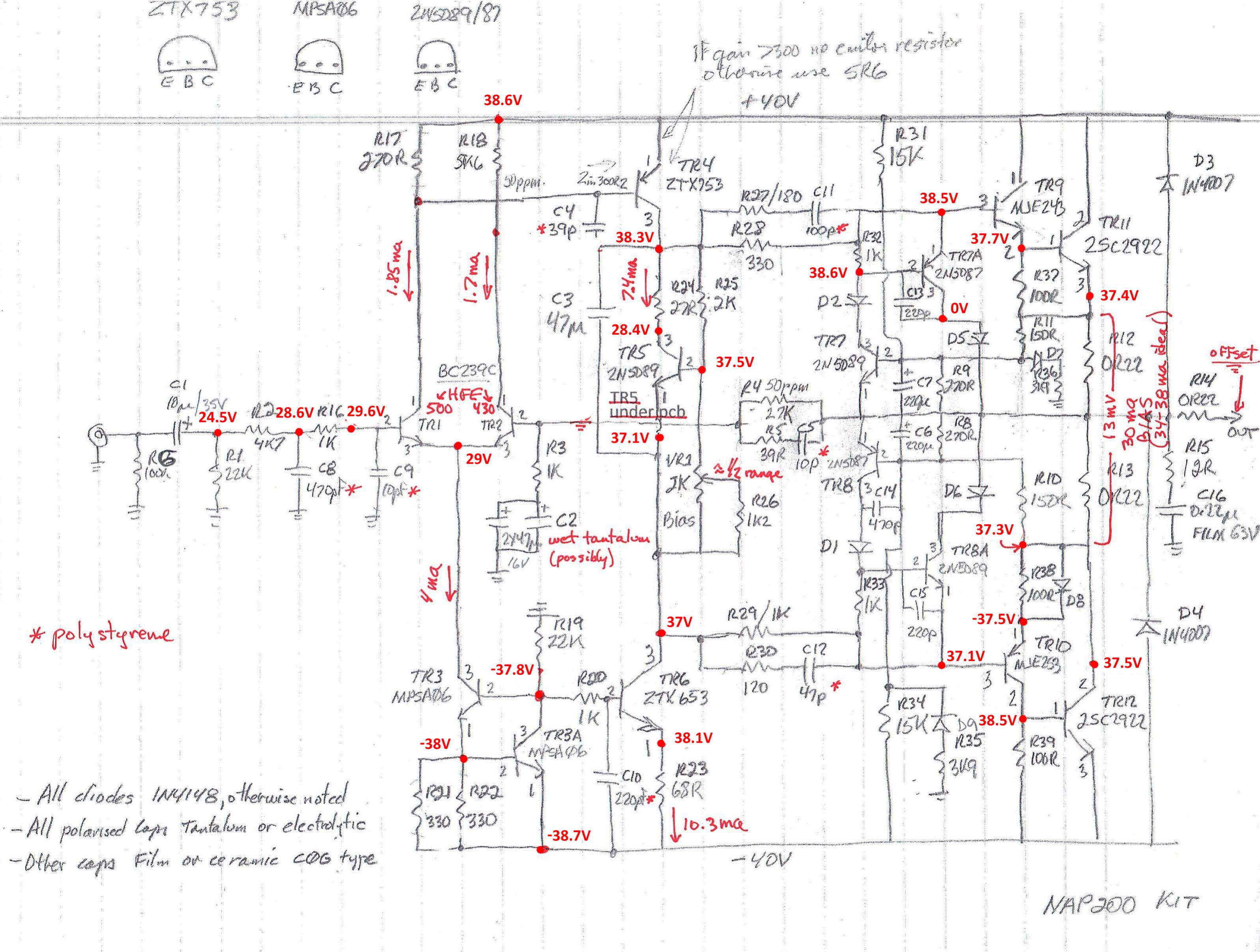

I've gone through the datasheet for the transistors and they all check out comparing their legs and the schematics. I'll need to check the voltages on all the nodes yes. Yesterday I checked even at the inputs after the 10uF input cap there's already 24+V DC. Several other test points also show up to 35-40VDC.
In the schematic by Algar, TR1 and TR2 are written as HFE 500/430 respectively. If I had matched them instead of following this value, could this be it too?

29V at the emitters of the input pair cannot be right.
have you inserted the transistors correctly?
have you used NPN pair?
Goodness, one look and you figured it out. I used a pair of BC550 and the pins are reversed 123. Everything now reads within a few mV from the Algar schematics.

I'm not sure what was my original TR1 and TR2 (the board is written MPSA18), but now the BC550 are backwards compared to the stencil on the board. Ie: Instead of 1,2,3 the pins are 3,2,1.
That's the usual issue with these kits. The layout was made for certain transistors, but you receive different with the kit. Always check they match the board! BCxxx are European (Philips) and MPSAs are American style. And you're right, they are exactly in reverse.

I thought you had the schematic like the in the measurement picture.
MPS ones are backwards. Then all clear.
I also checked the pcb how the transistor should fit in, not to mix up legs.
I'll fit in bd139/140 instead of the ztx for first test as I didn't have it in local shops. There I had to bend the legs around to be able to fit it in.
The shematic was from Algar, assuming he's using equivalent components the measurement points and values should still be the same.
