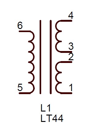

What tests have to run to check for a shorted turn in the secondary?
Yes, there are tests you as a low resourced amateur can do to check for a shorted turn.

Secondaries should measure very low impedance (or DC resistance even) it sounds as though your transformer is toast.
(unless you mean that's the resistance between the two secondary windings)
So according to the image - you should have low DC resistance between 1 & 2, 3 & 4, 5 & 6 - but nothing between the rest. (assuming your transformer has dual secondaries)
Yes I mean the resistance between the secondary windings.
According to the image,
low DC resistance between 1 & 2, 3 & 4, 5 & 6,
completely open between 1 & 3, 1 & 5,
and
700k-1M ohm between 3 & 5.
and
The high resistance between 3 & 5 is a worry - are you certain you're not measuring your fingers? (holding the probes)
I would try and get an insulation test performed before using it again.
You are probably right, it might have been measuring my fingers instead. The test probes don't have alligator clips so I pressed them against the wires with my fingers.
Here it says the windings should measure hundreds of megaohms or more between each other, but I only got kilo ohms.

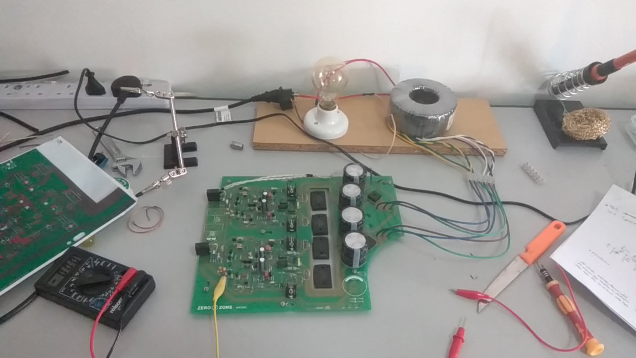

I've learned my lesson after that catastrophe and connected the light bulb current limiter. Couldn't find a 100W or 75W so I got a 60W. It still works fine though.
Transformer also works fine still, no smell no shorts. I guess I turned the power off quick enough.
However the faulty channel has a 30mV± DC offset while the ok L channel has about 1-5mV± offset. Is it too much of a difference?
I tested the rest of the components; transistors caps and resistors all are still fine except for the obvious burnt 0R22's.
Measurement with algar's circuit again yields within 1-2mV from his measurements.

You should never power up the board without the heat sink for 2922.
Improper static current setting, or even oscillation, could ruining the transistors.
I think it is safer/better to start with a low wattage bulb, either a 28W, or 40WI've learned my lesson after that catastrophe and connected the light bulb current limiter. Couldn't find a 100W or 75W so I got a 60W. It still works fine though.
That looks like you need further investigation.However the faulty channel has a 30mV± DC offset while the ok L channel has about 1-5mV± offset. Is it too much of a difference?........
It might be an overloaded resistor that has changed value.
I wrote that years ago in this thread, but it's obviously hard to read through it. It's very big now, so I'll repeat it for all people building this kit:
You should never power up this board with the power transistors!
First power-up should be with the drivers only. The circuit works fine on drivers only and output floating (no load)
That has several benefits:
1. If something burns, it will be cheap.
2. If nothing burns, but still the circuit is not working, you'll have generally more time to troubleshoot and measure before it fails permanently... In the worst case, something cheap will overheat and burn.
3. You can verify the whole circuit works - check output offset, check bias spreader work by turning the trimmer and measuring the voltage change between the driver transistors bases.
4. Leave the bias at something like 2V between base-to-base of the drivers. Then, add the power transistors and turn the trimmer up (by now you'll now what is the up direction) until current flows in the output resistors (5-7mV across). That's it!
Play some music.
