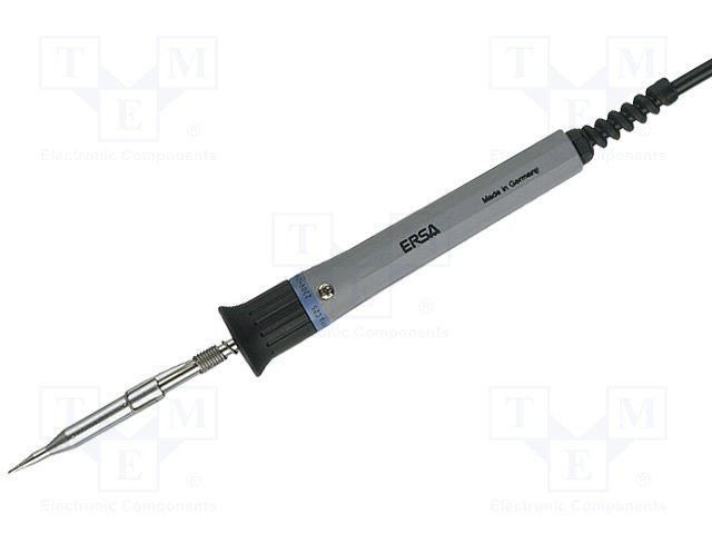

For a solder station I feel your money might be better spent on something like one of these:
The most important thing to ensure with these cheaper irons is that you can obtain replacement bits.
I have two irons that I bought from Maplin - they were around £50 each - and they have lasted me for years...

EDIT to add: Also look at the Tenma" brand as their stuff seems pretty good too.
I think one of the best.
