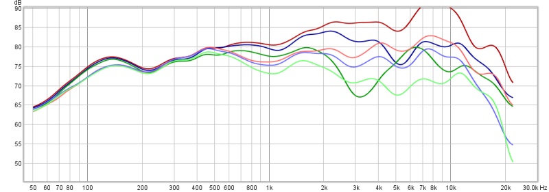

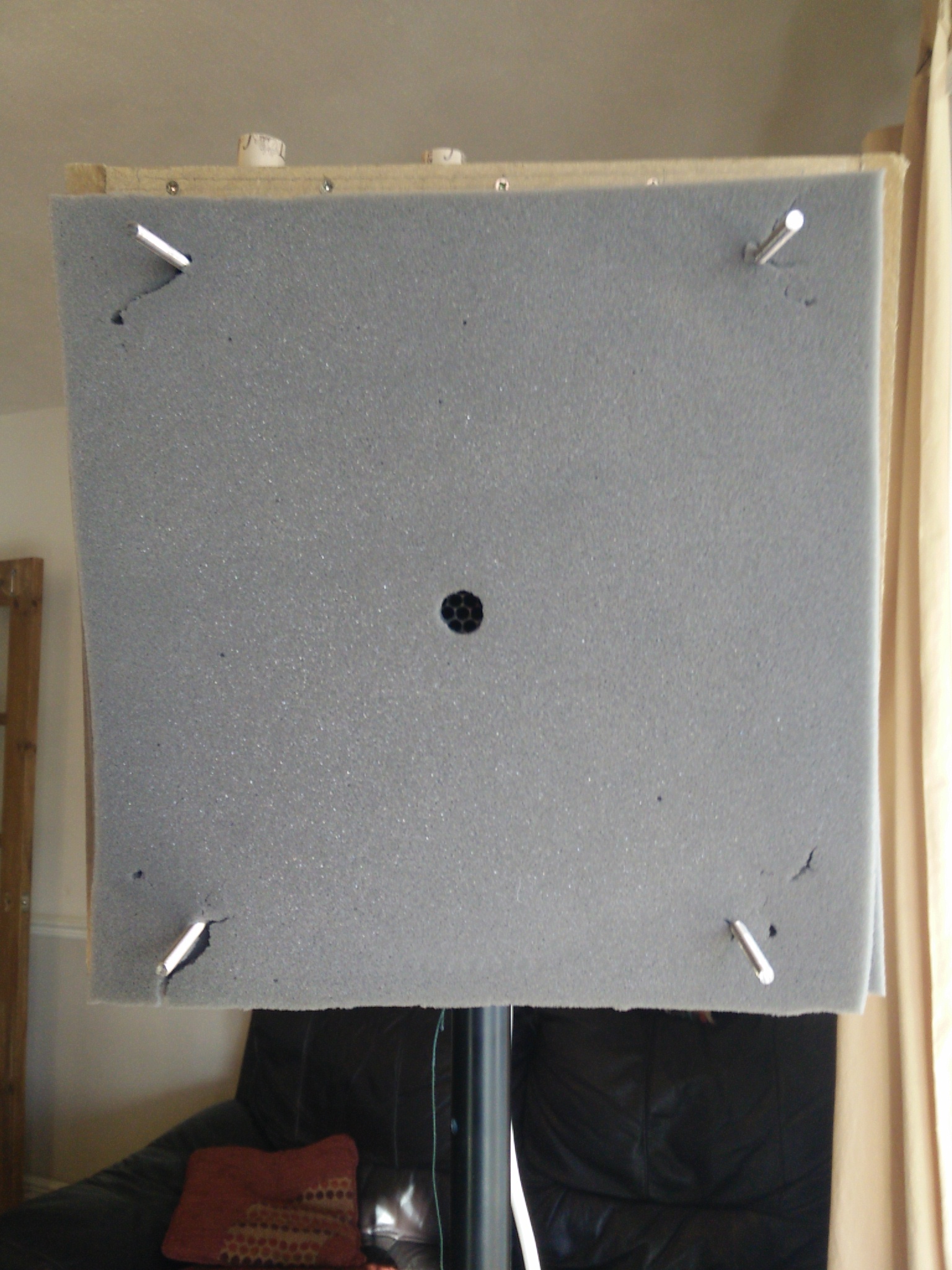

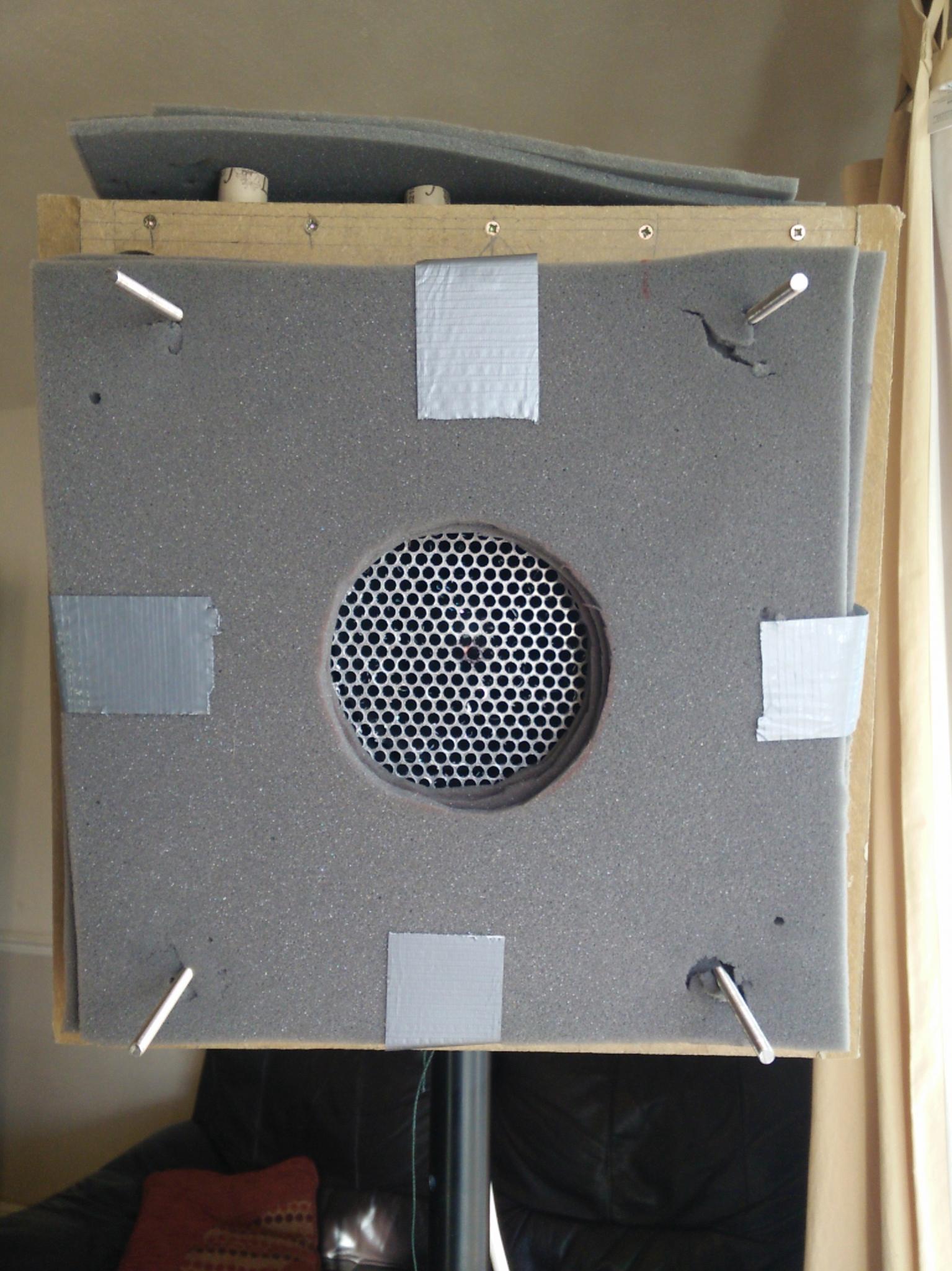

Thought I would have a go at modifying the dispersion with some foam, this is where I'm at so far:
Red = on axis
Blue = 15 degrees
Green = 30 degrees
Lighter traces are with foam, dark without.
Pictures please?
