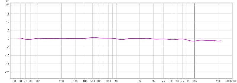

Sorry I could have been clearer, all foam is 6mm thick 8 layers in total, all other measurements are hole sizes, currently using pieces of perforated aluminium sheet for grills.
Below is the normalised response with just the two grills:
.... Two grills?
So: Grill - 6mm Foam x 8 - Grill
How much smoothing is applied?
I can be a bit dense, please use a teaspoon or dot counter.
so there's very little attenuation on-axis. How close does your lens group the horizontal polars vs no lens? I've seen a vertical ellipse on a 15" narrow tings down in the 2K region (IIRC) then lost effect higher. I have one of those Fane 12" but when MCM transitioned to Newark, Newark dropped Fane and several other manufacturers.
Yes, an inner grill to hold the foam away from the cone and the outer one to clamp the foam down, so grill - foam - grill.
A side effect of using the foam is a reduction of Qms, reducing Qts from approx 0.68 to around 0.52, of course this is dependant on hole sizes , thickness of foam and I guess also the rigidity of the grills as Fs also reduces to around 50Hz down from 57Hz.
