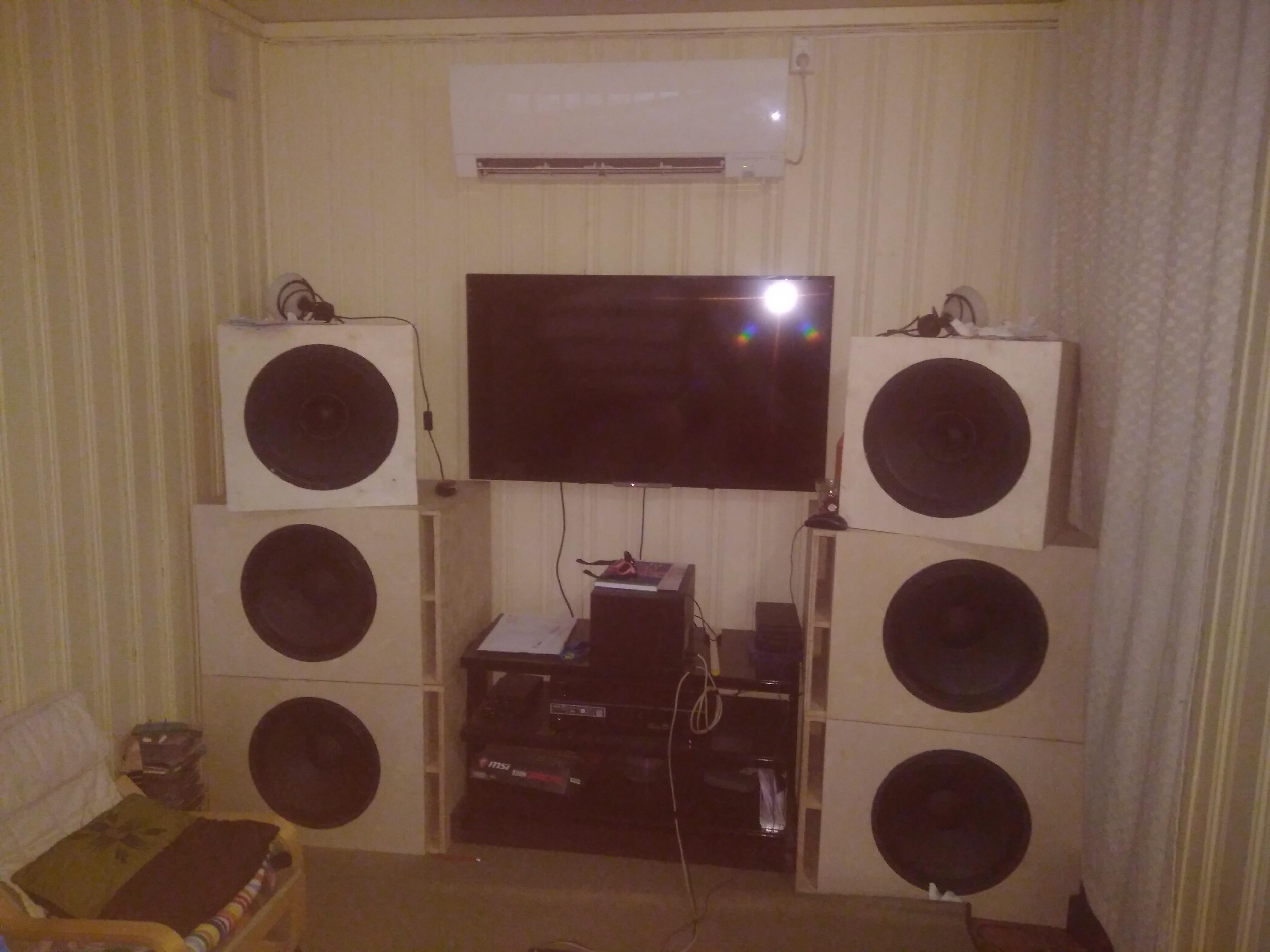

Have1 FC152/15-300TC + 2 Fane 15-400 per channel in a sort of waw setup. Pardon the crap picture, just got in the door after driving all day.
My personal assumption is that removing the dust cap may reduce support for the smallest whizzer, and adding a phase plug will reduce the cooling through the vent going through the magnet. Sound can also escape through that same vent, do not think "can resonance" is a huge problem with this driver.

I've been trying it for lengths of time in various positions, there are some significant sonic differences to every way you stack the setup. Stacked with max height and the FR in the middle they almost reach the ceiling. It sounds relatively similar to the way the speakers are right now, but now it's like the sound is coming from the screen. Very difficult to locate the speakers with a blindfold.
Best "impact" so far is with all bass boxes standing next to each other like a long tall bench on the floor. Will probably set it back this way after I get around to finishing them up, have to work through some points off my list first before going back to audio related things, so probably sometime later this summer.
I have settled for a 209hz LR4 xo for now, but this will inevitably change many times. It is impossible to discern when the subs take over, the transition is very smooth.
Edit:
And response in listening position is within a few db's down to 14hz. More than expected, was aiming for ruler flat to 27hz.
