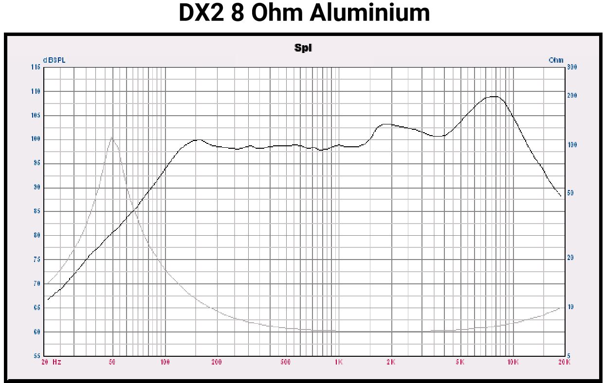

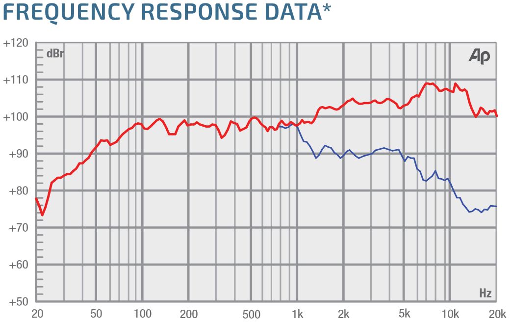

I wonder how "much" it is - because the Lowthers should be "much" according to the FR plot as well, but it does not seem to be the case in room.
Edit: Just checked the FR plots - I guess I will love the Fane, too:)

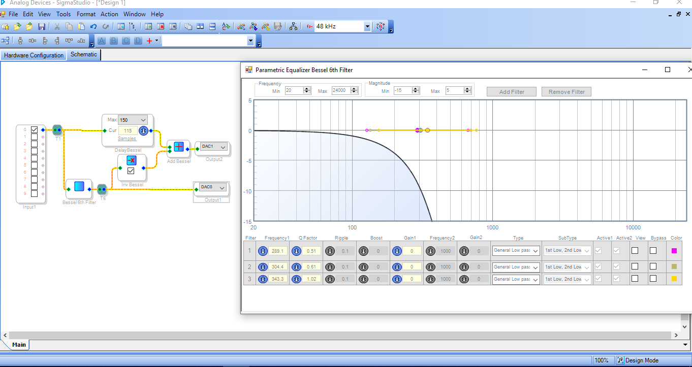

I'm currently using the Sure ADAU1701 DSP (similar to the FreeDSP) with a 12-250 crossed over to an EV 12".
Using SigmaStudio I have cobbled together a 6th order LP / 2nd order HP linear phase, Bessel based, Subtractive Delayed crossover at approx 180Hz, works really well with minimal throughput delay.

SubsSoniks, that sounds good. Would you mind sharing the Sigma Studio project file for inspiration? Or do you have some more information and pictures of your setup here?

Copy and pasted into a new project for clarity.

Kaffimann, thanks for information. SubSoniks, thanks for the file, I will have a look at it when I get my FreeDSP board back.
Let me know how you get on, what I didn't include for clarity is the eq etc to have a smooth freq and phase response acoustically through the crossover region prior to adding the crossover. Also playing with a three way setup with a view to using the 12-250 with a Colossus 12MB (180-800 ish overlap with 12-250)on low mid and 2 x 15" (33-180Hz) ported horns on the lows for live sound work.

here's that 12-250TC graph from Speakerplans a bit larger
Green = FANE Sovereign 12-200LT
Dark red = P.Audio E12-100F
Puke yellow = Eminence Beta 12LT
Purple = FANE Sovereign 12-250TC
