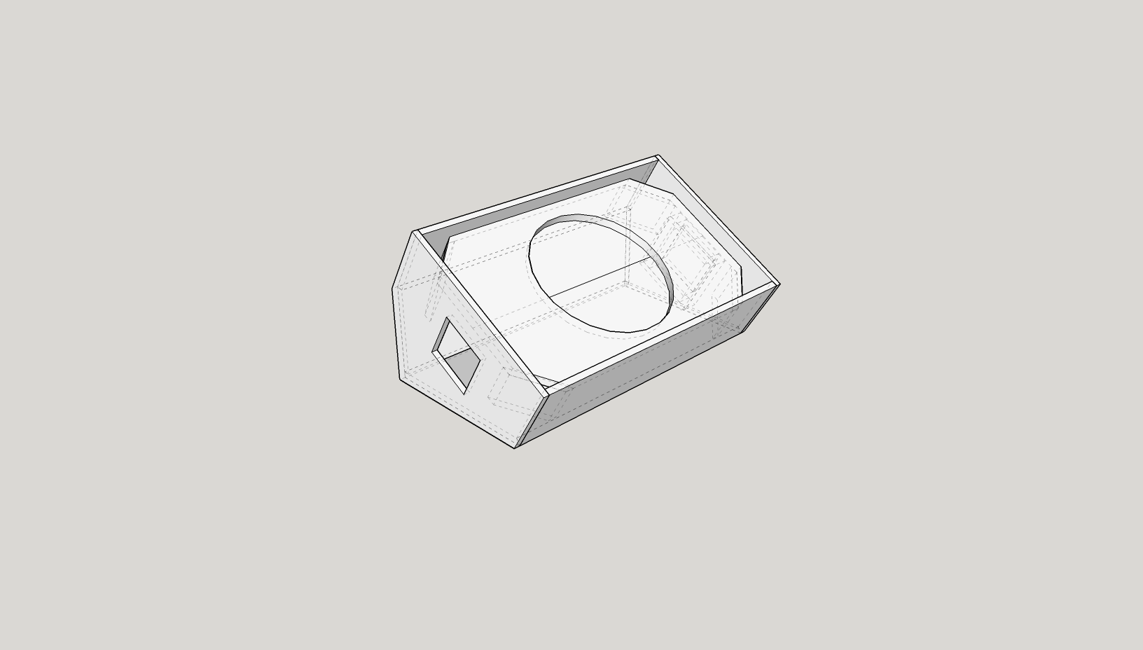

Ok so I did a fast drawing in sketchup
I would like to use 12mm birch only the baffle is 18mm
So it's not much but it's not an extremely big box.
It is mainly for getting the weight down and make it easy transportable.
The bas reflex ports also serve use as bracing. Maybe I will add some interna bracing but it's not a giant subwoofer either so.....
One side will have a handle the other side will have a pole mount.
I tuned it a little lower so the highpass can go a little lower without much extra excursion.
It will do around 110db @ 52Hz using 200w of power. From 87Hz and above it will do 118db using 200w.
It can do more then this but it will start to go over Xmax. Don't know what Xdamage is for this speaker.

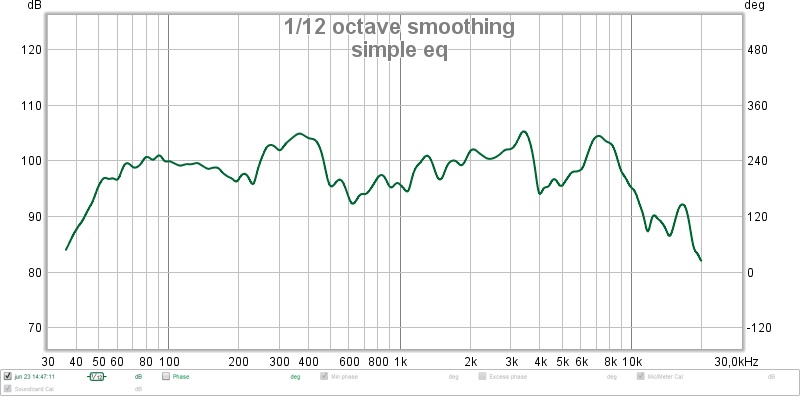

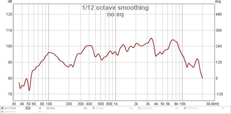

Hi guys,
This weekend I have build a small monitor cab around 50L and ported like simulated a few posts back.
So the first measurement outside gave this:
So the bump around 100Hz was simulated.
Another thing that got to me is the fact that there is no baffle step compensation.
So calculating this should be around 200-300Hz.
If you look at it and leave the bump out this is noticable.
So I applied a shelving filter around 200-300Hz
And then I put a parametric EQ to even out the 100Hz peak.
The result is the following measurement.
I did add a high pass around 50Hz.
The result is not bad I would say.
The microphone I used was calibrated so the decibel level is correct. But the position of the microphone was more like 2Meters and I didn't measure the power that was send to the speaker.

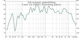

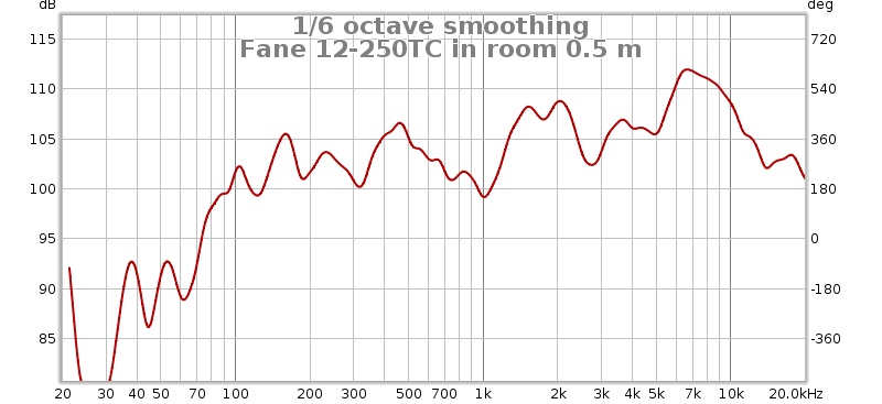

I put my pair into boxes made for some other 12" speaker, ca 42 l and 7 cm dia x 8 cm length port. First quick listen at low volume is promising. These definitely deserve a proper and nicely finished cabinet. I do not regret buying these instead of the 15" version. I am looking forward to trying out with my horn subs and compare to the current three way horn system.
Here are some measurements in my room. 0.5 m distance and listening distance (around 2.5 m and 30 deg off axis). The boxes are placed in a way that the center is at ear height. Both 1/6 octave smoothed. I think this is really not bad. There is a 10 mm diameter hole in the side of the boxes (was meant for a stand) and the second 6.3 mm jack in the back is also open, so it is not too air tight.
These would be a great pair of party loudspeakers, and a small sub can be added if needed. I may play around with the EQ, but in the room I have, this sounds pretty good as it is.

Yes, this room is a cellar workshop, the speakers are on the short side 2.5 m apart, the ceiling is only something like 2.1 m low, concrete floor and not too much furniture. I actually plan to refurbish it and apply some acoustic treatment later.

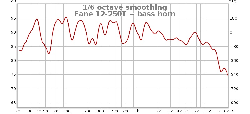

In the attachment, there is measurement of the left side using my bass horns, crossed over at 120 Hz and time aligned. I intentionally left the response sloped not to have too much treble. Now I only need to build some smaller subs to make this into garden party speaker system. After the speakers will be burned in, I will try to do some outdoor measurements.

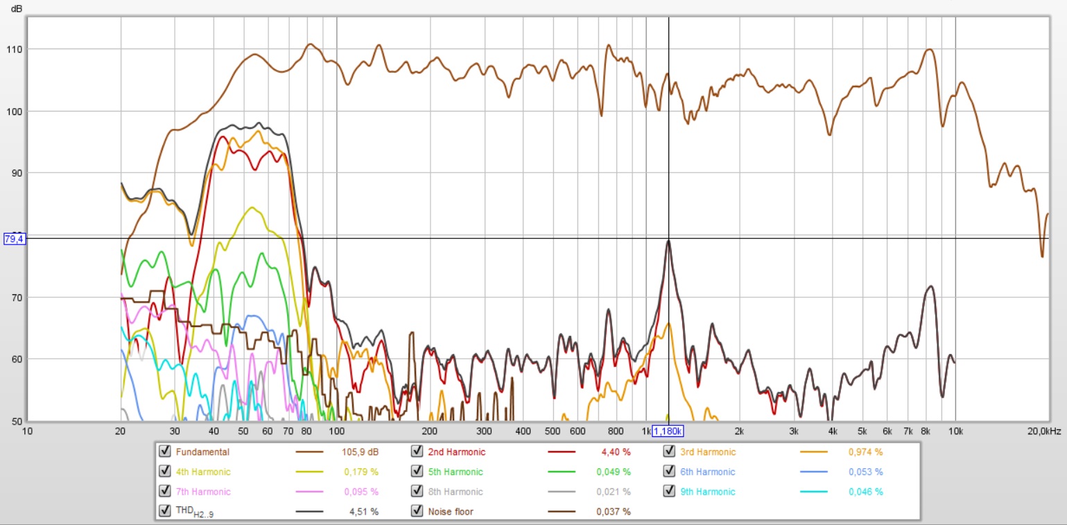

Dinolobe, I made a ported enclosure for the 12-250TC, it works just fine, slightly smaller than your 4cu ft. The reason I do not see the point of making a huge enclosure for this driver, is that if/when you decide to push it really hard, you'll have rising distortion in the bass region just before the high frequencies start running into trouble.
The 12-250TC can do bass for sure, but not ridiculous amounts of it.
Much better than you can get with any 8" or smaller though.
Here's a distortion plot just as its limits measured just over 1.5m distance from speaker,ca 5 degrees off axis, half space, some small eq with a regular minidsp.

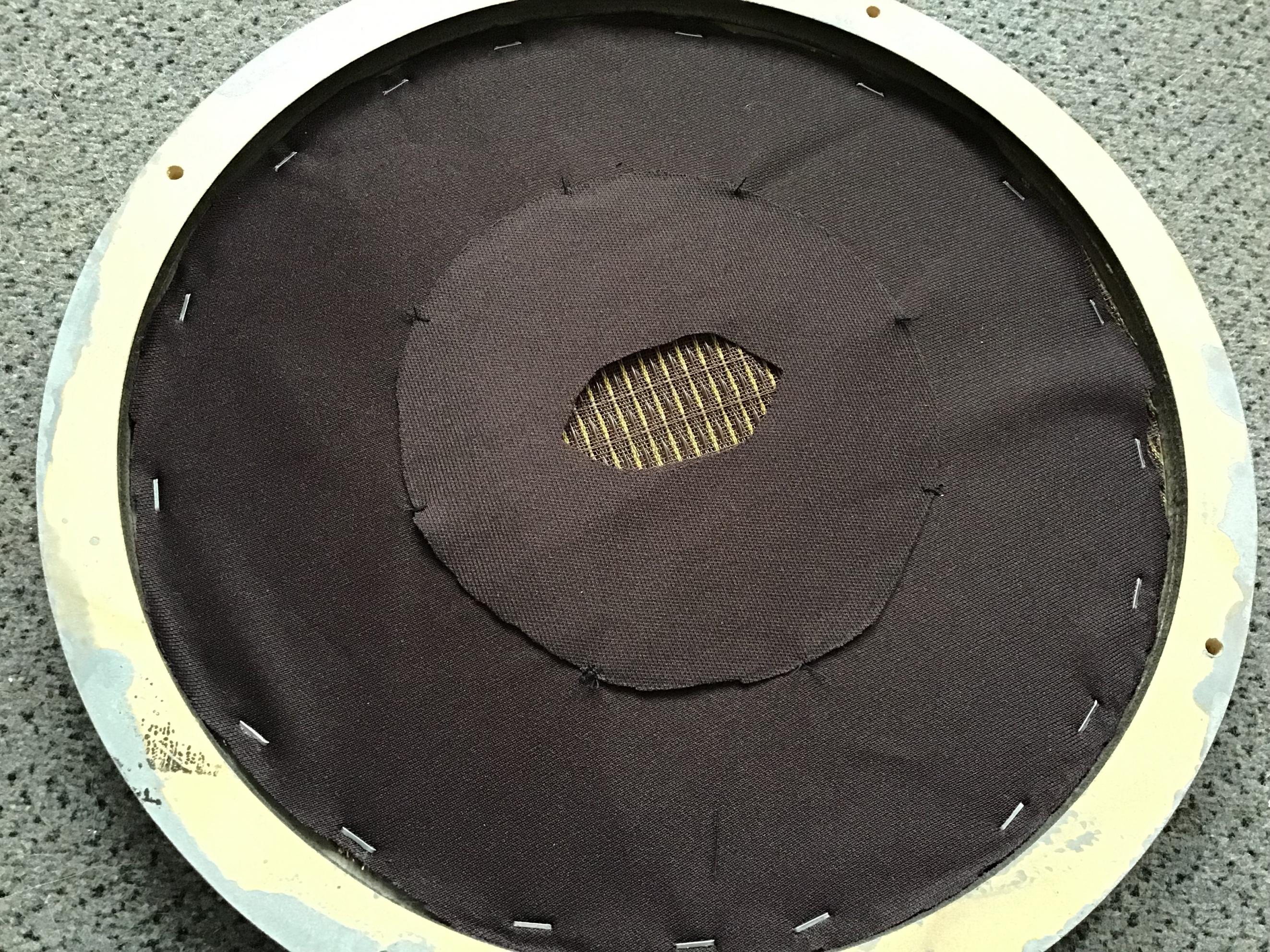

Decided to do something about the hot treble from this otherwise excellent driver. This has been mooted on here before but I can’t remember who suggested it.
My sealed box Fanes have a circular grille comprising a Fender Tweed guitar amp grille cloth. This is better than nothing, but I figured there was still a lot of room for improvement.
I installed a couple of secondary grilles behind the Fender element. One covers the whole rear of the Fender cloth and has a vertical, elliptical slit cut into the centre. This slit resembles the pupil of a cat’s eye and allows the treble from the central whizzer to pass.
A further, smaller circular grille is placed to attenuate the larger whizzer, relative to the main cone, and has a slightly smaller cat’s eye slit than the one in the preceding grille.
The result of these three grilles, is to tilt the rising response to a flatter profile and the listening results are great. The sound is better balanced top to bottom and sounds natural and unforced at both high and low levels.
Attached is a pic of the grille arrangement, plus a 6th octave pink noise, in-room spectrum taken at 1.5m and 10deg off-axis.
The spectrum shows the flattened response and the bass performance of the 80L sealed cab, hard-up against the rear wall of my room.
Not a bad result from a couple of bits of cloth, some staples and a needle & thread.
