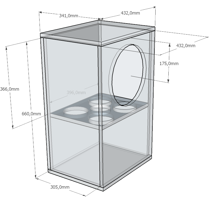

Nuno, read back through this thread and you will find all the details from the horses mouth (sorry). In addition, i made a quick model in sketchup as the project is in my future to do list, based on Steve Cresswells stated dimensions. 3/4" (18mm) plywood. Im more bracing wont hurt as long as it is well holey.

thank you for the measurements, but at 432mm wide front panel, is wide for the place i have to put the speaker.
do you think is possible to make a little narrow and taller? and keep the 78~80L capacity?

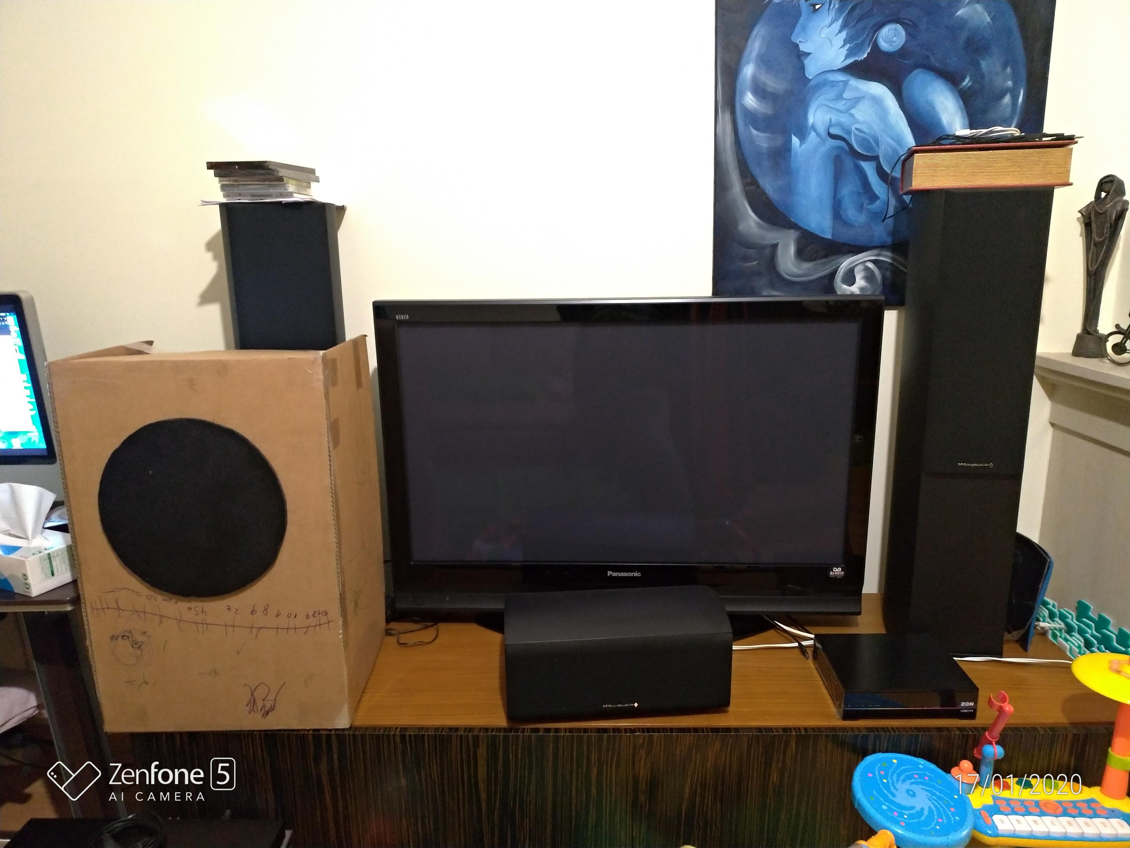

I made a template of the cabinet and as I suspected is big for the space available.
Is possible to build it narrow and taller and keep the 75-78L inside volume?
The floor standing speaker in the near the wall is to remove.

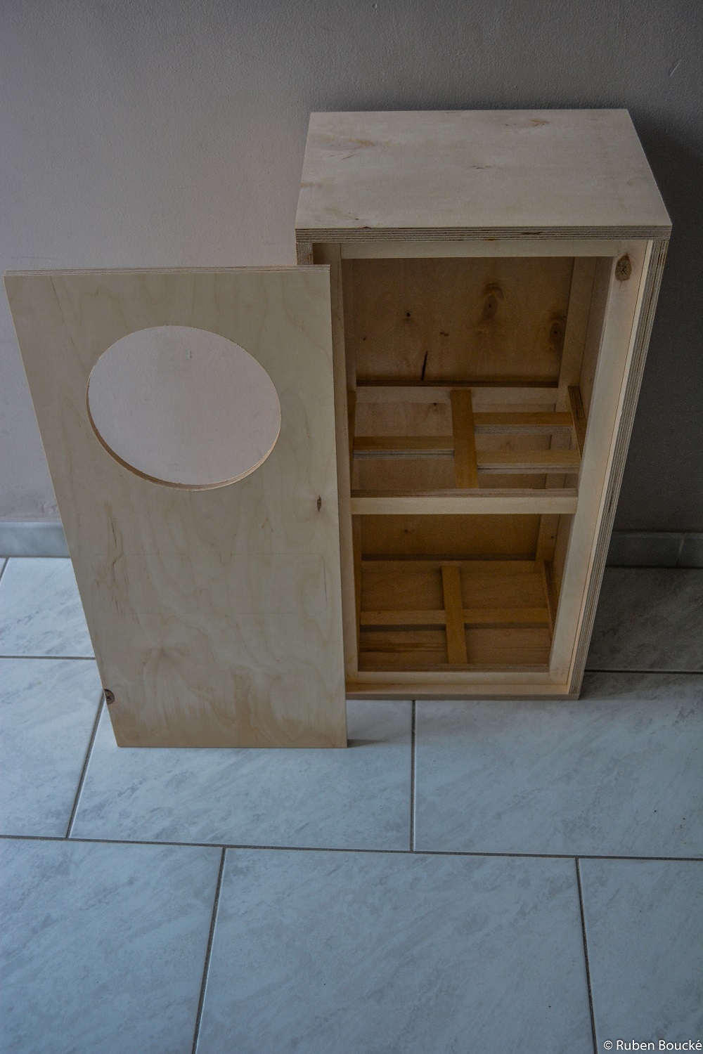

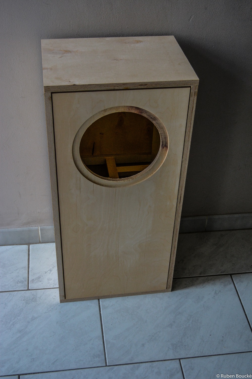

Off course you can, i did build a speaker for a client for the same driver, it's a sealed mass damped cabinet with 12mm for the top and sides and 18mm ply for the front and back an a whole bracing frame build in and it was 40x80x30cm, with more or less that volume.
I'm now building a sub that use more or less the same box size, all in 18mm ply for a scanspeak 26w/8534G00 sealed sub (that is a 10" driver), the exact measure are 40cm wide, 836cm high and 30cm deep. These picks are of one of the 2 i'm building before sanding (just assambled from plywood). It also uses the frame i'm more and more using in speakers to brace it, because it works very well, and can be build from remains of plywood from this and other builds (cheaper than a full plate with holes drilled in).
wow, they look very nice. the measurement are exterior?
Tganks, and yes, they are exterior

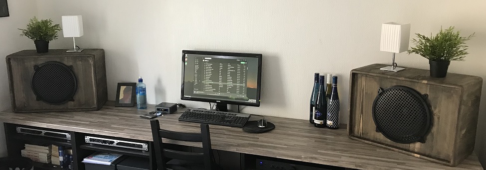

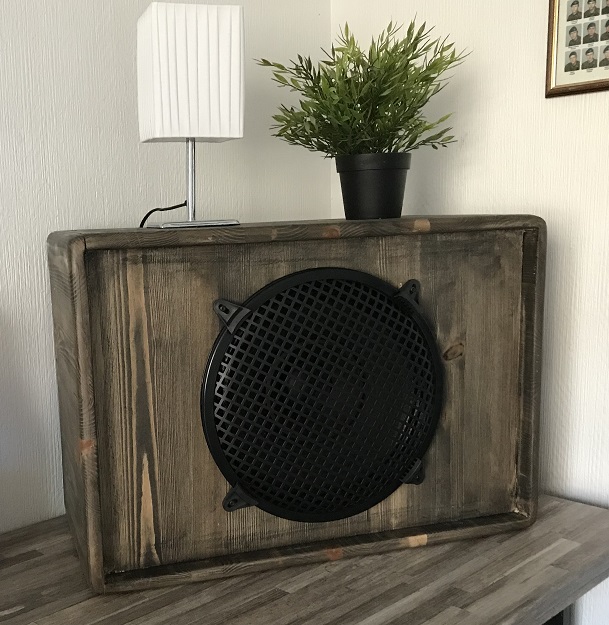

Here is my 12-250tc fullrange build: a couple of desktop speakers for the home-office about 50l ported. I like the live and big sound in them but agree that what many says the 1-4kHz needs a notch.They are very similar sounding to last years 15" projects. Will let them play in before doing anything drastically with filters, I like the efficiency.
