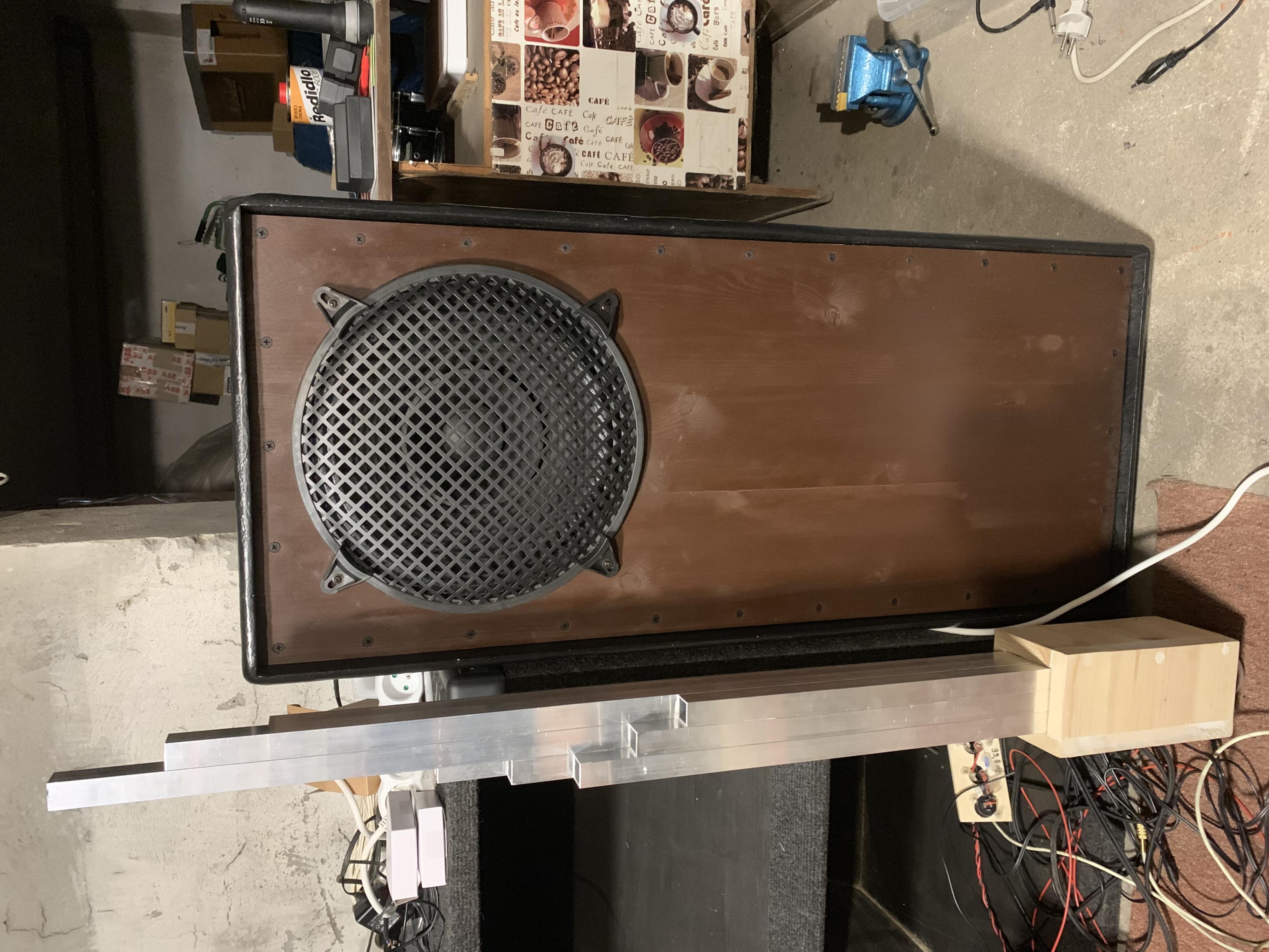

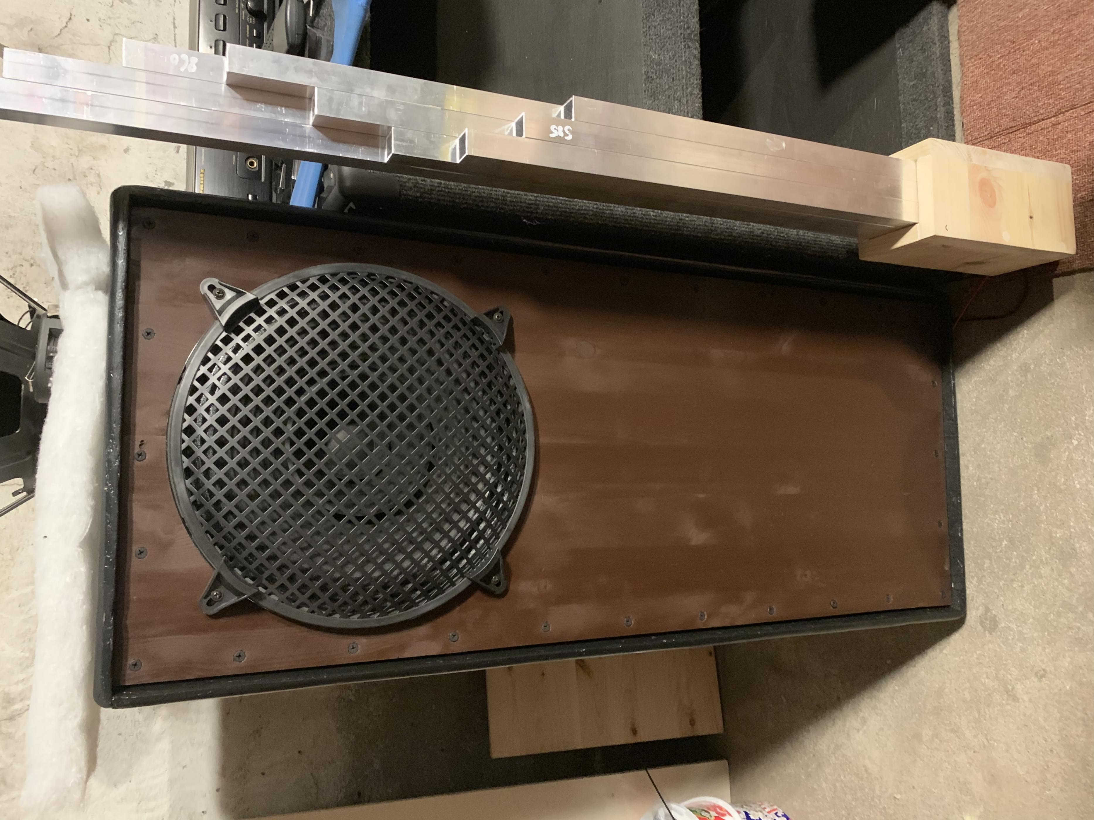

Fwiw, here's my tiny thread on a 130 liter ported box I made for this driver.

I was not after extreme bass, then I'd have chosen something else entirely. I had some trouble adjusting for EQ because I had less problems with rising HF response than the datasheet says, and limited opportunity for measurement and building, as this was during my short vacation in Bali. So in case you are referring to the measurements in the beginning of the thread, they where merely prelimenary results.
I had the opportunity to measure the speakers at close to 1/2pi and test the limits of what this driver can do completely by itself, in a relatively compact enclosure, so I did just that.
Look at post #15 and #16, they sounded very neutral and not bass heavy at all. I can see if I can find some videos when I get home if you have any interest of it.
Remember this is halfspace in very noisy surroundings, so in order to get any reasonable noise floor I had to run perhaps 5 sweeps at stupid loud volume to get half decent results, and just choose the ones that wheren't completely ruined by outside-of-my-control noise sources. So in-room it would be a much easier story.
