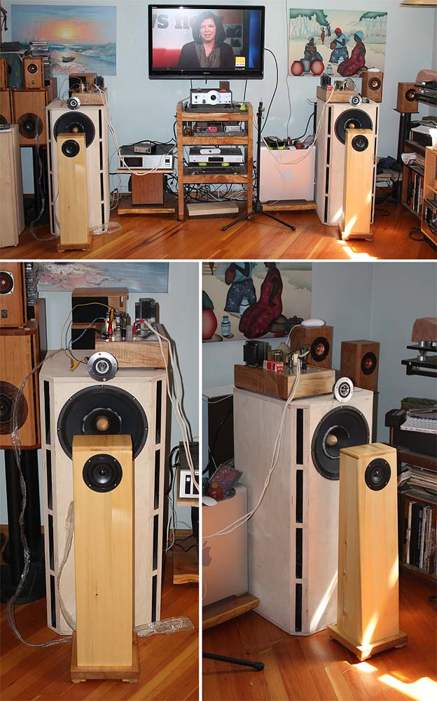

Perfect build. Just the right amount of handmade rustica to not make it a try-hard. Near exact match of colour of driver and wood.
Got my 7.5 liter reflexes done. Quite happy with how they turned out and sound.
Nice work.
