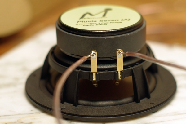

Should I be worried about soldering with the P7? I'm using the 4% silver stuff...
Just pre-tin and don't use any thicker wire than #20 for internal wiring, and you shouldn't be there long enough to worry about softening the wiring tabs' molded retaining clips. If however, they do soften a bit, just lightly clamp them with needle nose pliers while cooling. Our first pair of Alpair 5.2 protos were swapped between 5 or 6 enclosures, and I found that to work well.
The Pluvia baskets have a much higher temperature resistance than the Alpair baskets.

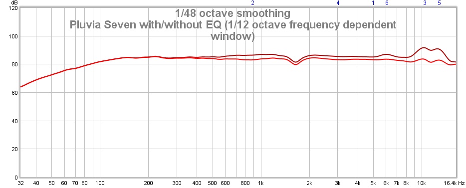

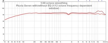

I ran a quick measurement of the speaker. I'm showing with and without 6 bands of parametric eq and with a 1/12 oct. frequency dependent window. Unfortunately, there is a pretty severe breakup at 20.5khz that makes the impulse response look ugly. I don't think it's an audible issue. I did some listening (just one speaker) with the eq as shown along with a Linkwitz transform and some linear phase baffle step compensation. It sounds really good.
