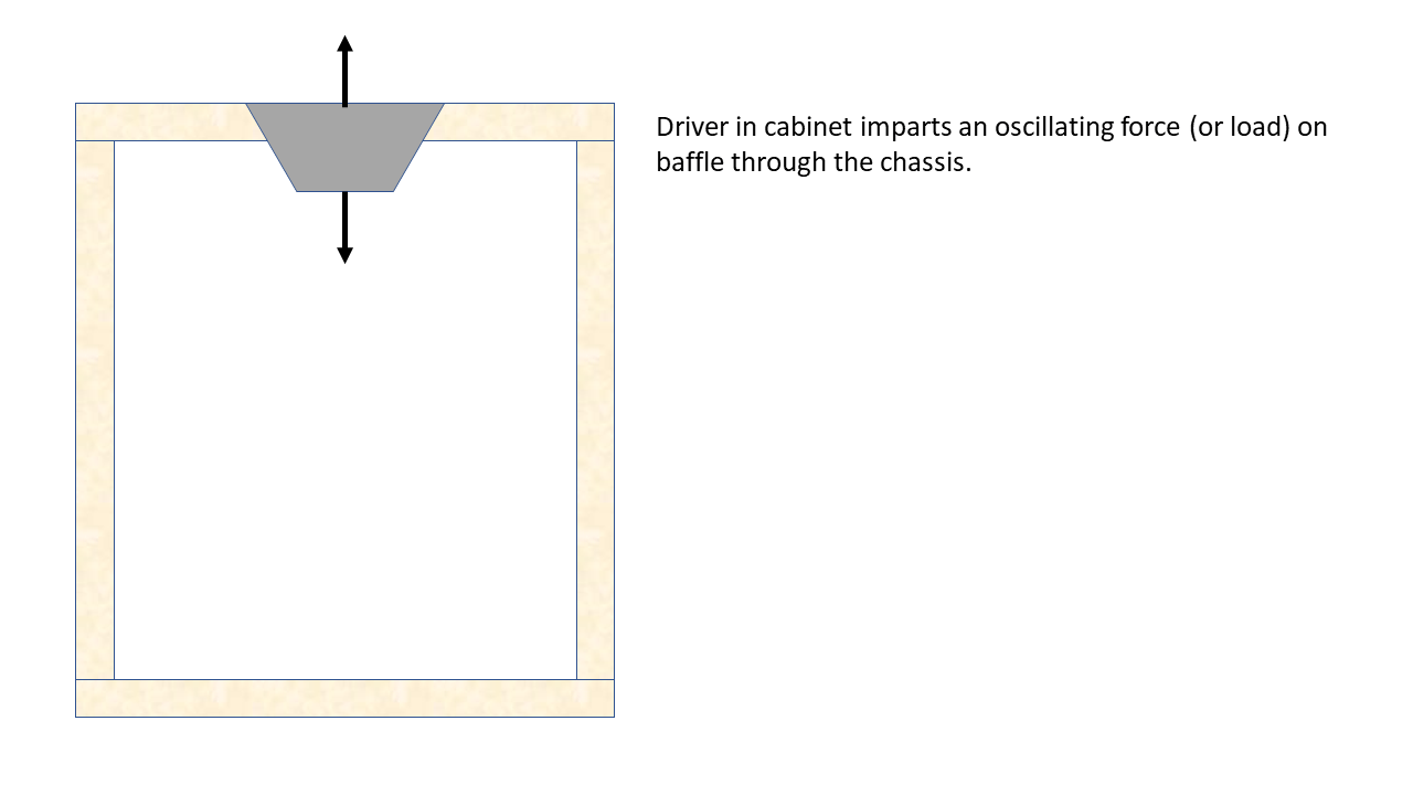

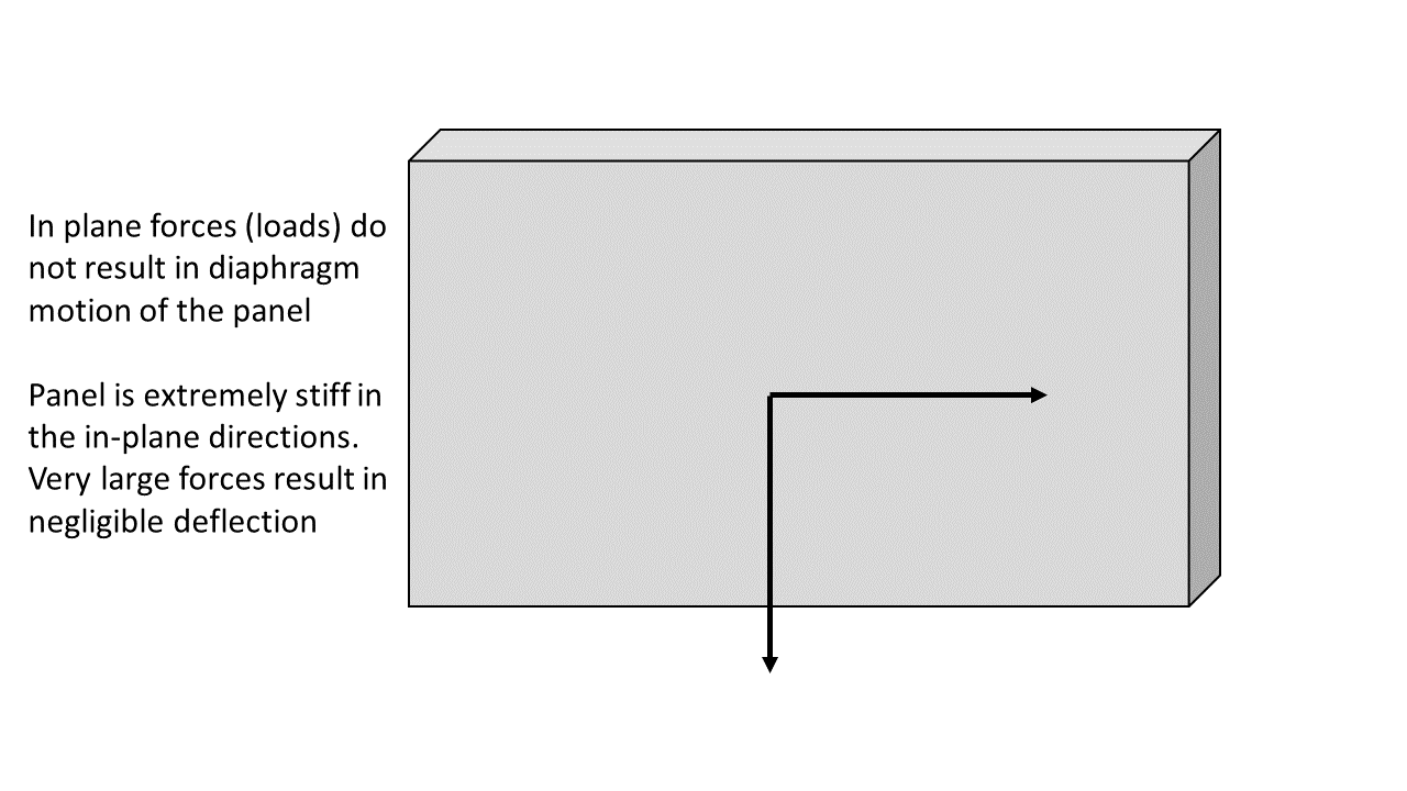

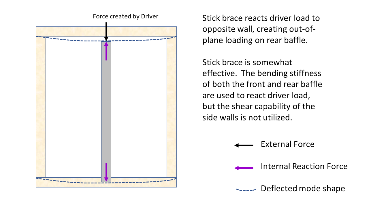

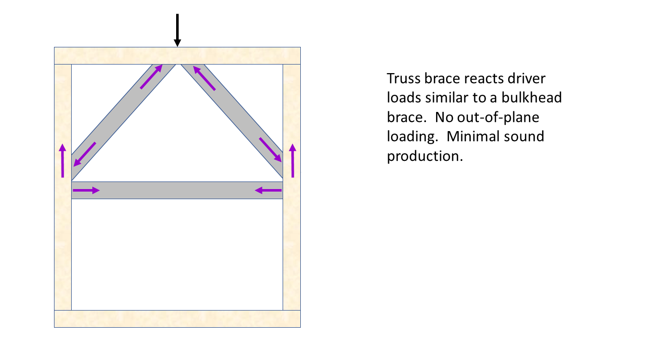

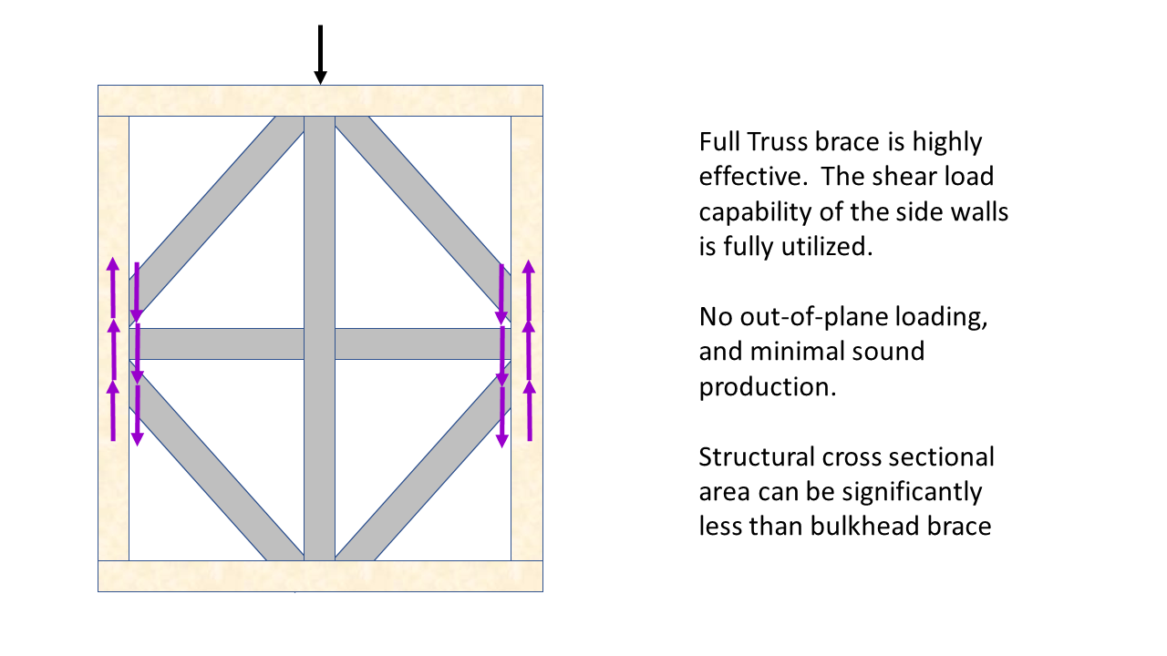

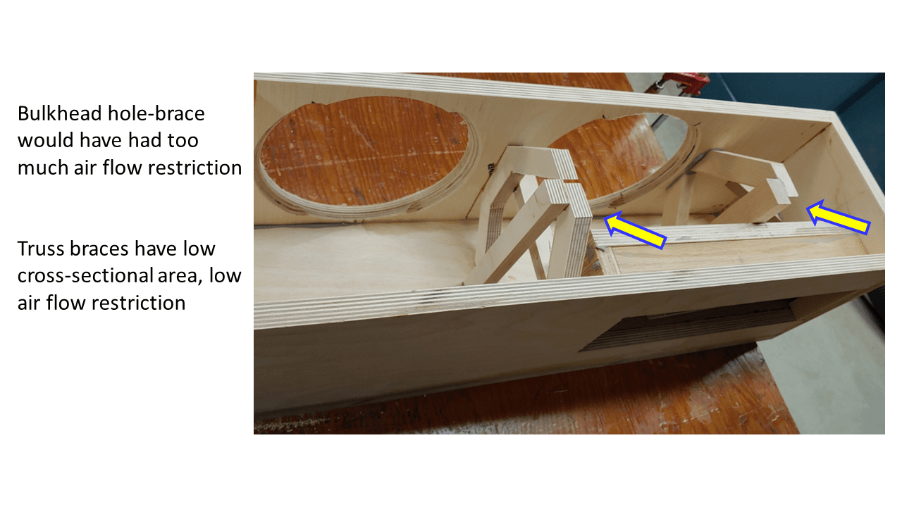

A little discussion about bracing...

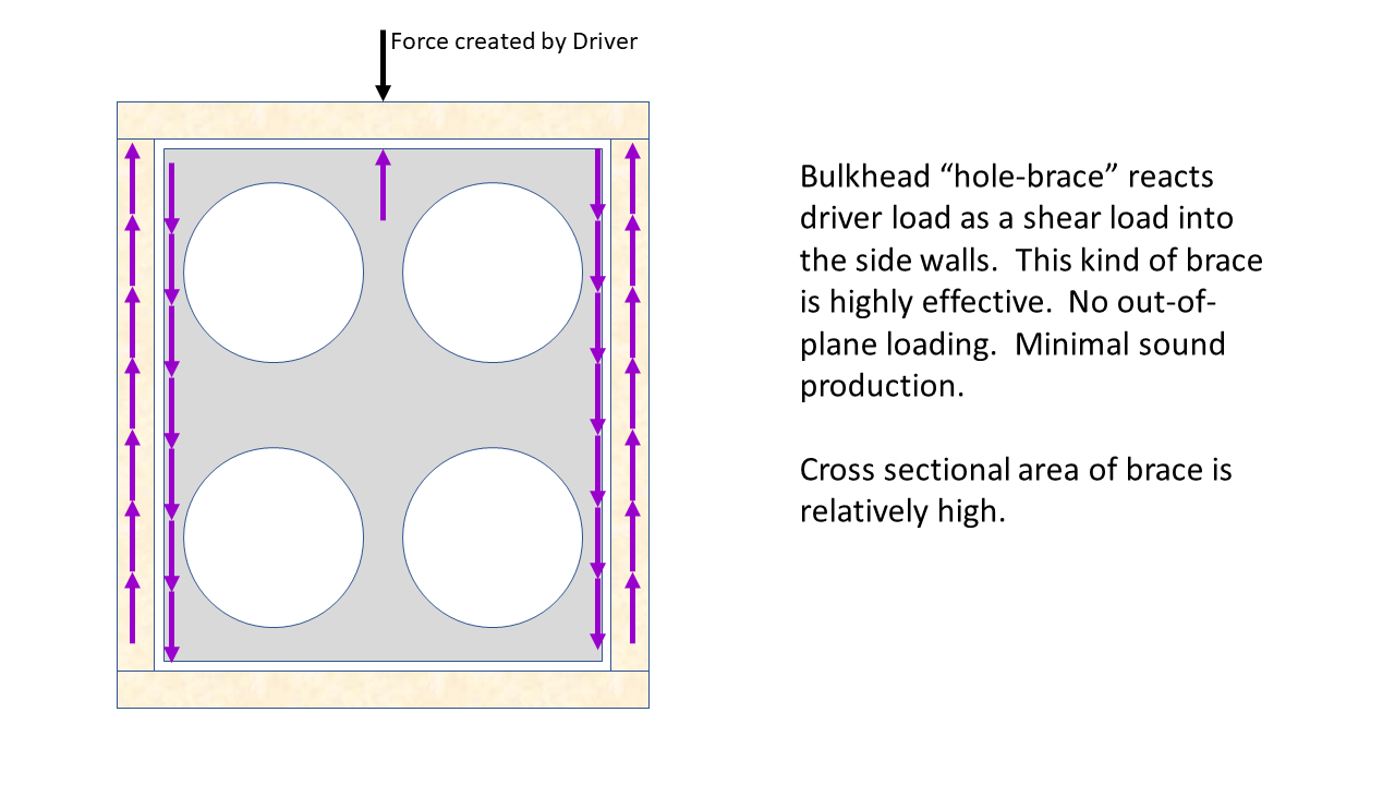

Normally I prefer to use a bulkhead hole-brace above and below each driver. This kind of brace rigidly connects the baffle to the side walls. However, this enclosure is very tall and very narrow. A bulkhead hole-brace with 4 or 5 holes would have had a small open-air area. I prefer the open-air area of a brace to be at least as large as the woofer Sd, and with this very tall very narrow box, that was not possible.
Instead, I used a truss brace. The attached graphics explain why a truss brace achieves the same result as a bulkhead brace, but with a lower cross sectional area.

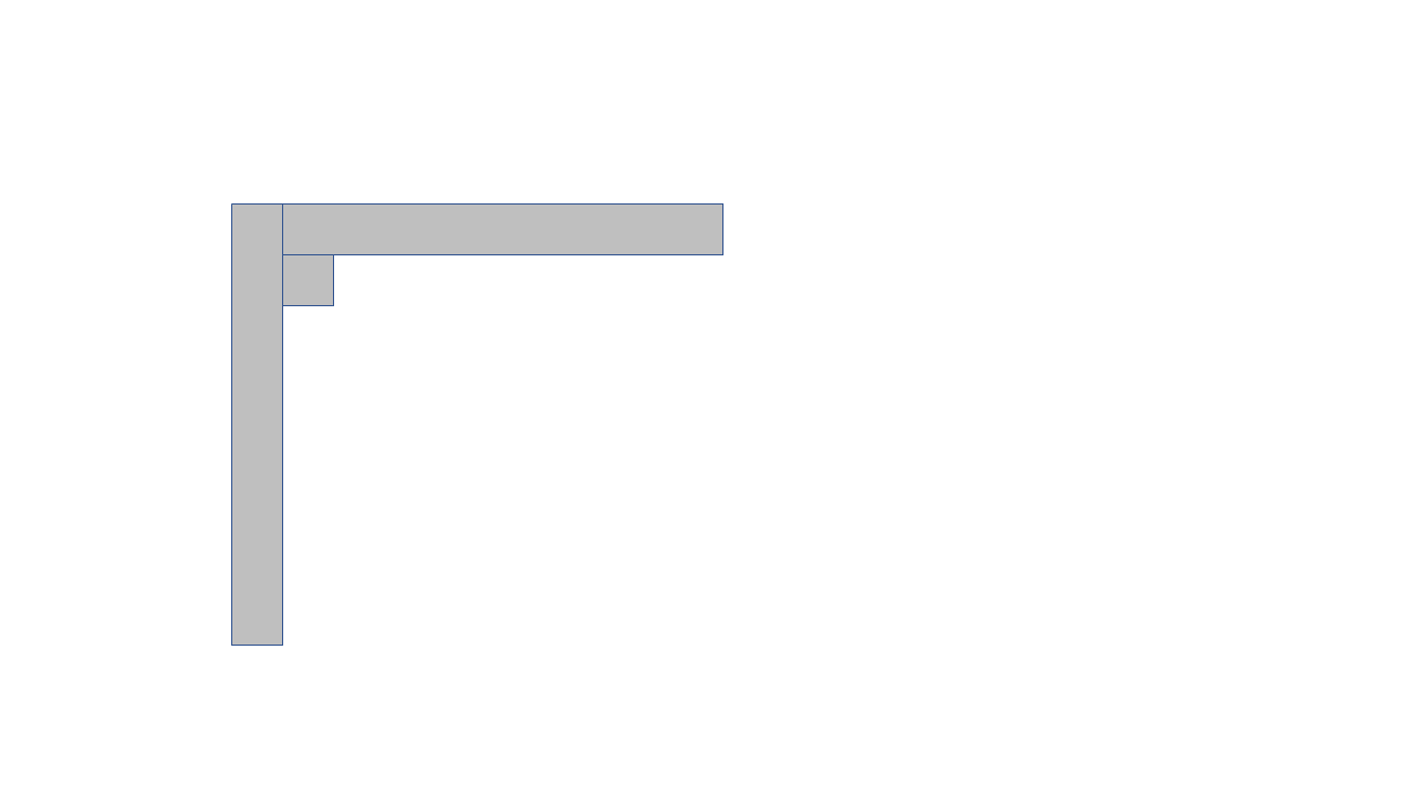

Just read this. Think it’s ok in general. Two remarks:
- adding corner wood stiffens the junction of the panels and thus the panels themselves. That Is why I would pick the normal approach.
- keeping the openings as large as Sd isn’t necessary. Considering the required volume displacement, air speed ‘through’ a perforated panel isn’t problematic in terms of noise or flow resistance.
I wonder how much percentage of Sd is necessary? 25% is almost certainly not enough... 100% is almost certainly more than enough...I don't know the answer, and I could not find guidance. Since I have two woofers, I decided to play it safe and assume I needed an open-air space equal to the Sd of a single woofer.keeping the openings as large as Sd isn’t necessary.

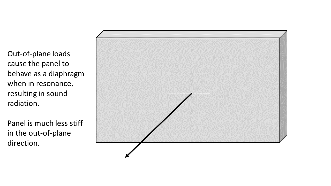

Adding corner braces (see graphic) will stiffen a un-braced cabinet, I agree with you. An un-braced lightly built cabinet may have separate resonant modes for each wall. Corner bracing can help couple the panels together, and push all four walls to a single resonance mode. This is an improvement. But in a highly braced cabinet with bulkhead or truss bracing, I believe the corner bracing will have little benefit.
Cabinet resonances are difficult to predict with modelling, and difficult to measure. cabinet bracing is a matter of diminishing returns: Simple bracing is a big improvement over no bracing, and the more bracing that is added, the smaller the incremental benefit becomes. Since cabinet resonances are hard to predict, hard to measure, and very hard to fix after construction, I want to be well into the region of diminishing returns. Going "overkill" on bracing adds little cost and little time. And this project is not a high-end build, so I am doing the minimum level of cabinet bracing that I am comfortable with.

As for percentages, I think 50% would do, as it’s only relevant for the fundamental frequencies and a bit above. Air speeds are very low there. Ports for vented enclosures seldom are more than 25% and 17m/s seems a safe limit, so we could calculate it from there.

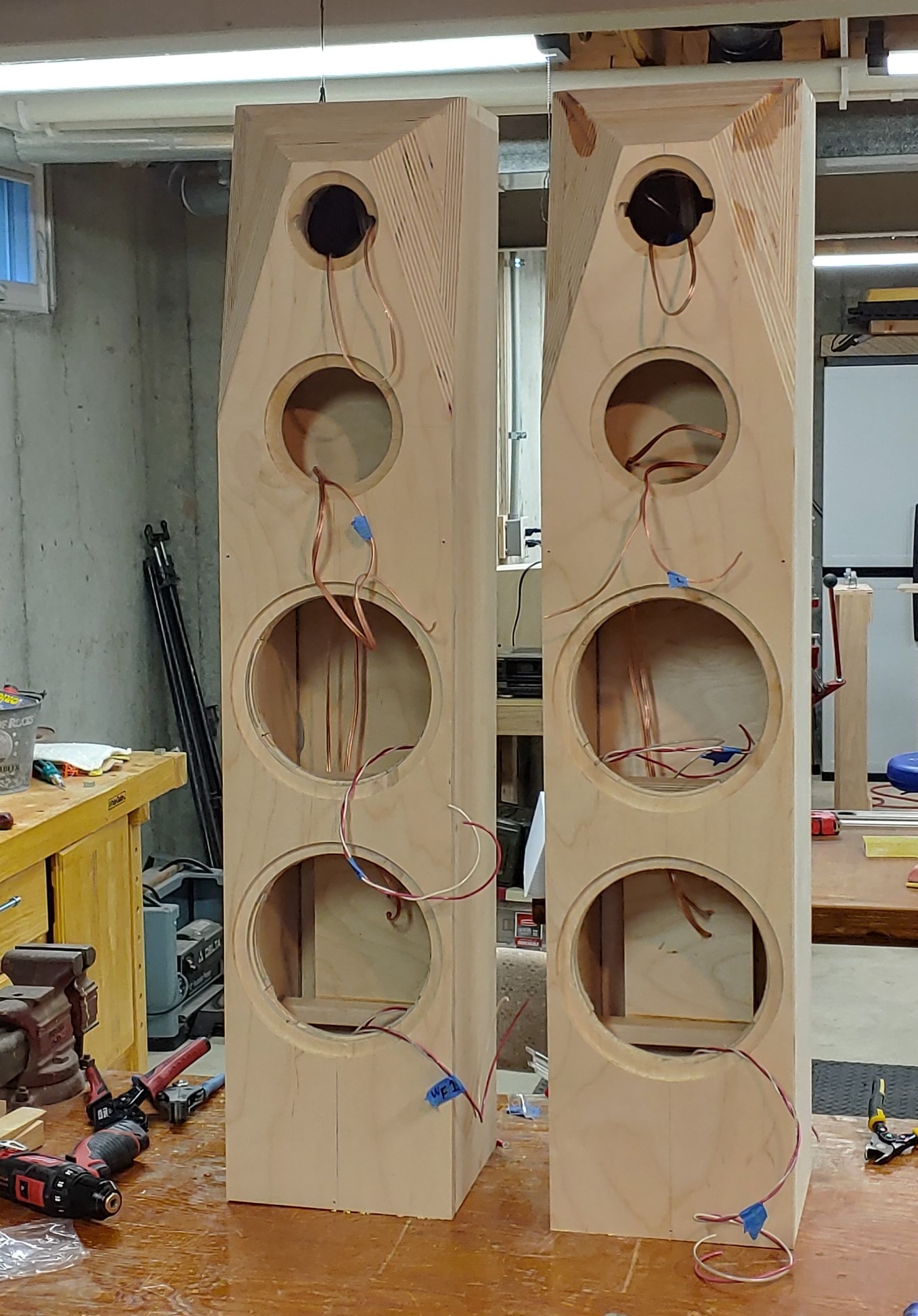

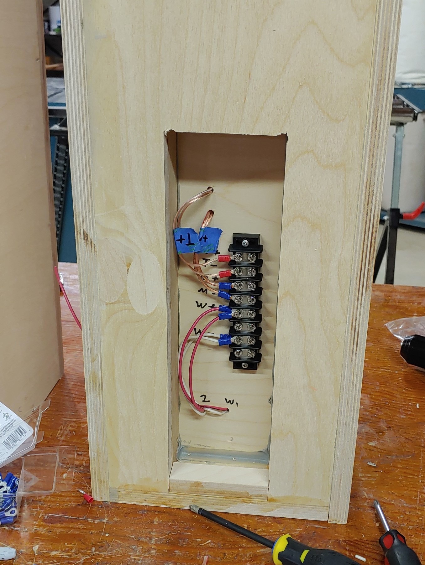

I started wiring the boxes in preparation to install the Hypex FA123 amp, then the drivers. My plan is to do a full set of driver measurements before I start any cosmetic finishing. One reason is that I need a break from woodworking for a while, and the other reason is that I have not decided how I am going to finish these cabinets. I am leaning toward cherry veneer with a satin finish, but I am not sure just yet.
After the driver measurements, I will begin the process of VituixCad simulation to design the DSP crossover.

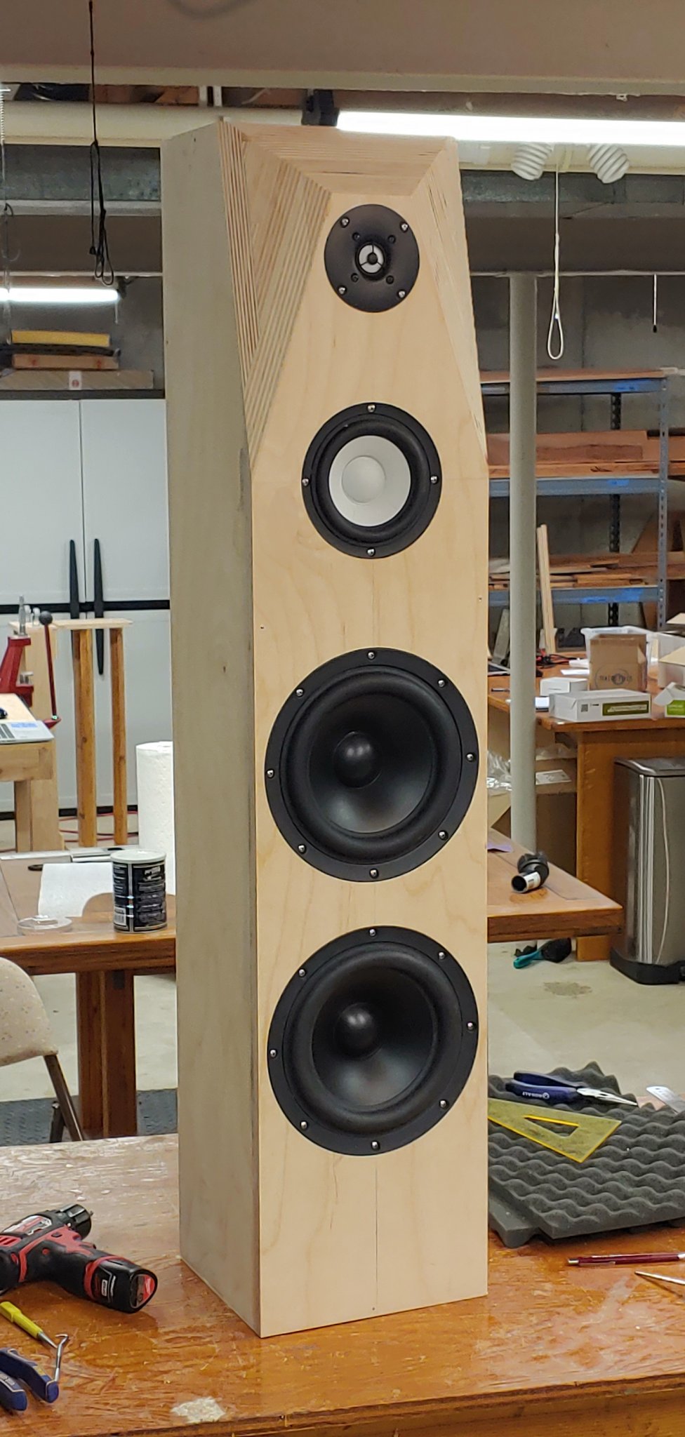

Fine work hifijim.
At first glance the distance between mid-range and tweeter catches attention, but the reasons have already been shared by you in post #106 of this thread.

Amazing is a big word... I am satisfied with the quality so far, but this project has stretched my wood-working skills. The "system pictures" sticky thread has some photos that put me in awe.... we have some really talented cabinet makers on this forum.Amazing work. Congrats to reaching the all-together-now project level. Cheers!
Yeah I am curious to see how this sounds. It sure looks odd, but it simulates well.
