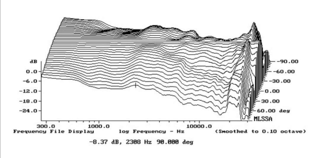

I fail to see any logic between baffle dimensions/edge contour and measured performance (B&W with minimal baffle has most ragged response...)

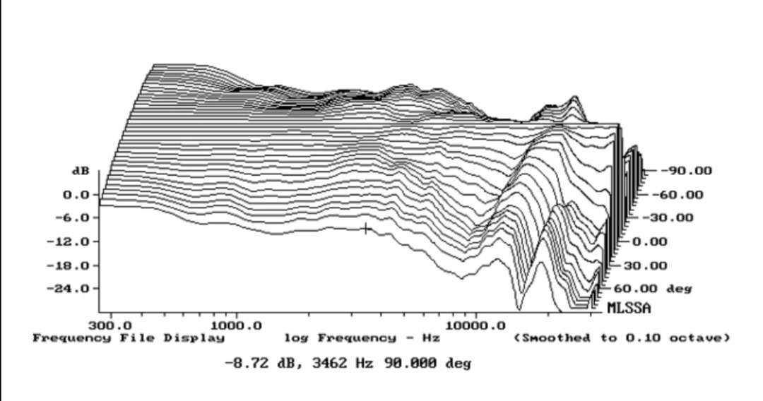

Check put the normalized horizontal plots. B&W is smooth as butter diffraction wise up to ~6kHz. It is hard to see from the pictures if the tweeter is with roundover. Perhaps that grill makes it. Response narrows past 2kHz because the mid driver is too big and crossover frequency so high.

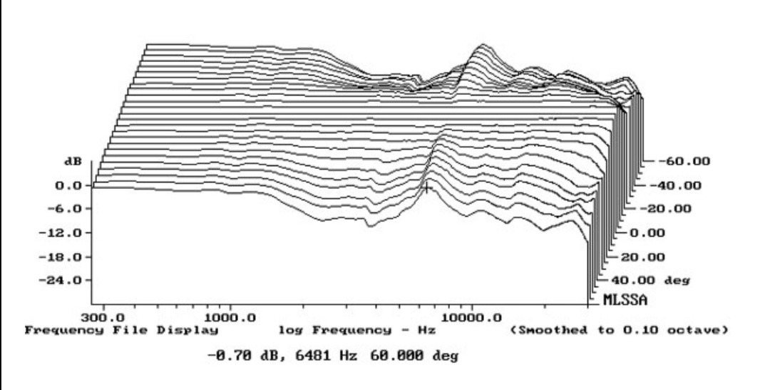

In comparison the last link Stenheim, mid driver diffraction seen all the way from 1khz up until its response narrows until tweeter kicks in and makes its statement
Here is the monitor audio silver, diffraction nicely all the way from mids to top.
Main diffraction hump shows as smooth narrowing, first on axis diffraction dip after that makes the nice off axis ridge (b&w). Offset drivers make the bumps here and there instead of ridge (stenheim).
If there wasn't any diffraction the lines on these graphs would be much smoother and not much ripple. Unless some nasty cone breakup but those sound bad and are usually suppressed so a lot of the wiggle in these graphs is just diffraction. Or narrowing response of some mid woofers.

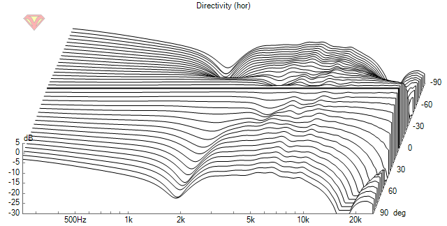

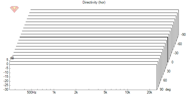

Played with VituixCAD and it can do close the same graphs as the Stereophile normalized horizontal graphs are. Attached is a VituixCAD project that can produce the images below. I urge anyone play with it to gain some insight how the speaker construct relates to various things on the graphs.

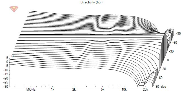

Here is ideal point source, this is the best that can be, straight lines. This is omni and all off-axis angles have same level. If it was narrower directivity but still constant directivity, the lines to off-axis angles were just lower in level but still straight.
![ideal-point-source.png ideal-point-source.png](https://www.diyaudio.com/community/data/attachments/966/966560-8be78e3154bb5b832f3c06accf2e0d42.jpg)

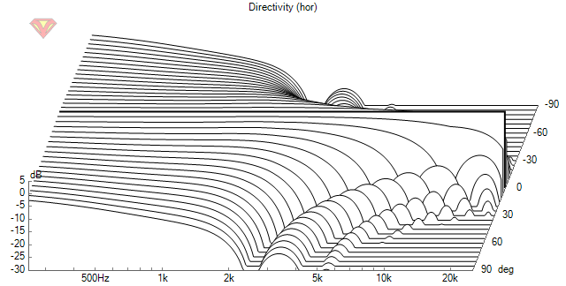

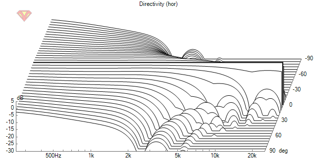

Below responses are ideal 1" and 8" transducers on ~minimal 20x40cm baffle made with VituixCAD diffraction tool.
Here is only the tweeter with and without 25mm corner radius on baffle. Response is about omni on low frequencies until baffle starts to narrow it, eventually the transducer beams as wavelengths get shorter than the diameter. Diffraction in between which almost cleans out with 25mm radius roundover on the baffle edge. The baffle is quite large for the tweeter and roundovers are needed to reduce diffraction.
![ideal-tweeter.png ideal-tweeter.png](https://www.diyaudio.com/community/data/attachments/966/966561-b676493b944a9768a6b43c9d01d8524c.jpg)
![ideal-tweeter-with-roundovers.png ideal-tweeter-with-roundovers.png](https://www.diyaudio.com/community/data/attachments/966/966562-a48879894c15b875cda5ff21997d9b31.jpg)
This is ideal 8" woofer on the same baffle without and with 25mm roundovers. Its minimal baffle for the woofer so not much effect to its response.
![ideal-woofer.png ideal-woofer.png](https://www.diyaudio.com/community/data/attachments/966/966563-acc139cf44f2e9e33067166f52144392.jpg)
![ideal-woofer-roundovers.png ideal-woofer-roundovers.png](https://www.diyaudio.com/community/data/attachments/966/966564-78ab9e6b2d07b82cc14e938db4e32eab.jpg)

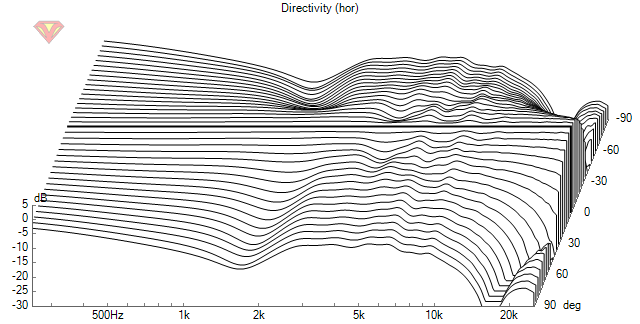

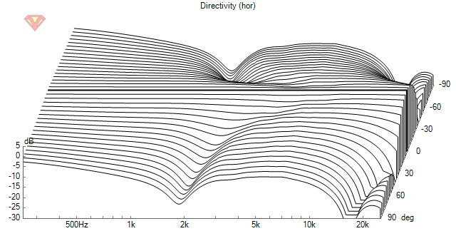

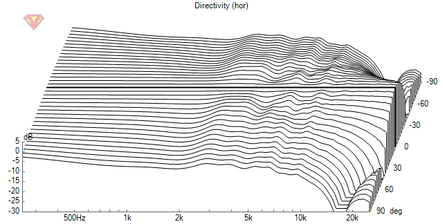

And here is the system with 3kHz LR12 crossover, with and without the roundovers:
![LR12-3000Hz-no-roundovers.png LR12-3000Hz-no-roundovers.png](https://www.diyaudio.com/community/data/attachments/966/966567-577812f26918da772fb241dfcb1ed426.jpg)
![LR12-3000Hz-25mm-roundovers.png LR12-3000Hz-25mm-roundovers.png](https://www.diyaudio.com/community/data/attachments/966/966568-2677c96a6b36e9b27e0a68ac47387d32.jpg)
Yes its not too good of a system, 8" and 1" with 3kHz crossover, just something arbitrary to give more data whats what on the graphs.
Is there anything to learn? Yeah, do roundovers (and EQ) if you wanna make your graphs look better than in Stereophile! Pay attention to driver sizes and locations, structure, the construct.
Note the graphs are Normalized to on-axis, meaning that the on-axis response is "EQd" perfectly flat to show off-axis angles response in comparison to that. Perhaps Juhazi observed from the graphs he linked on post #113 the B&W really has kind of wild on-axis response and came to conclusion minimal baffle didn't help. The ragged response is not due to diffraction though, except some on the tweeter but less than with the others, and could be EQ:d pretty nicely.

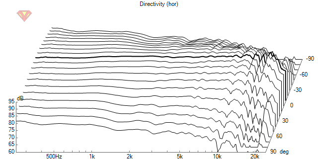

Here is simulation with real system measurements. Its not normalized but just EQ:d quite flat, the construct is made low diffraction without roundovers, basically its no baffle cardiodish with freestanding waveguide. Wouldn't be so nice without help of DSP, would have ragged on-axis response but normalized graph would look about the same as this. Btw there is two crossovers here, its a three way system.
![a-system-not-normalized.png a-system-not-normalized.png](https://www.diyaudio.com/community/data/attachments/966/966574-e9e6f321ace0a186425322968340b02e.jpg)

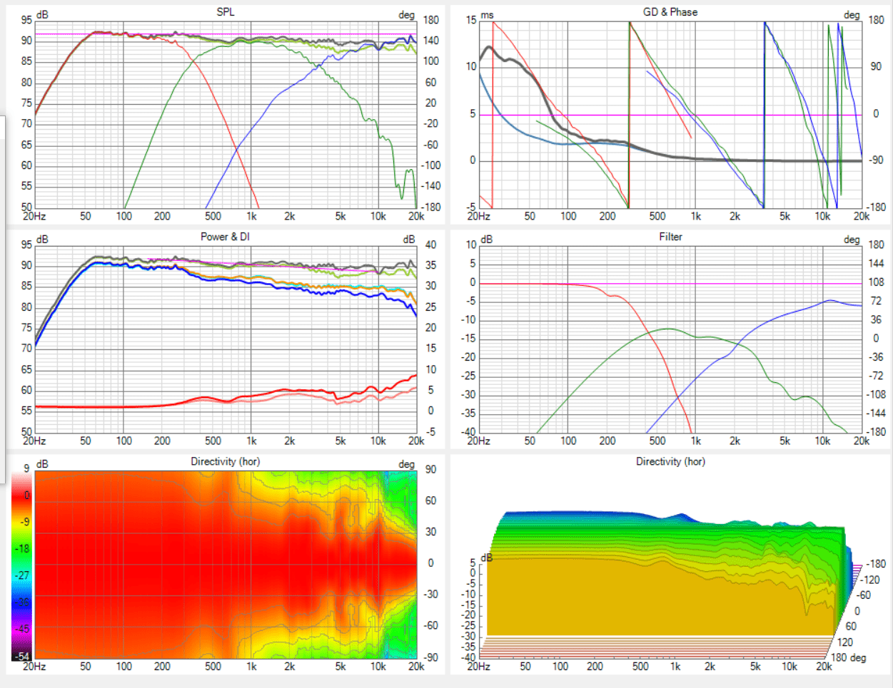

Here is a measurements of my 3 way,
The reason for this is not because I am a good designer, but because I followed Kimmo/VituixCAD's directions and took real measurements in 360 degrees BEFORE I started the crossover.
And before that I also simulated the baffle dimensions and driver positioning with VituixCAD diffraction modeller.
