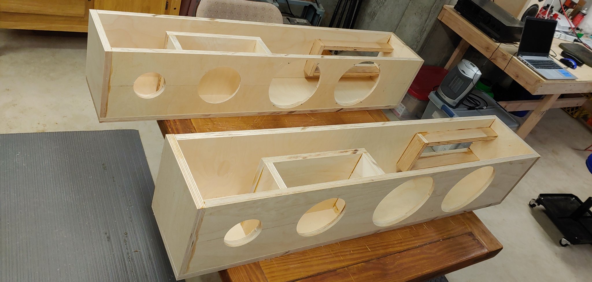

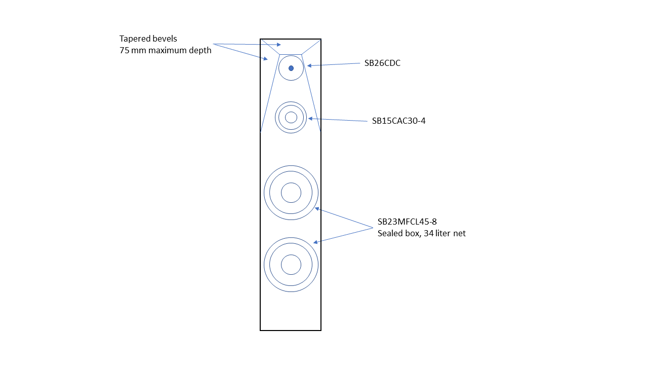

Construction has begun. I have cut all the panels except the outer baffle. I have glued the inner baffle, top/bottom, and one side. The next step is to install all the interior bracing, then second side wall, then finally the outer baffle.

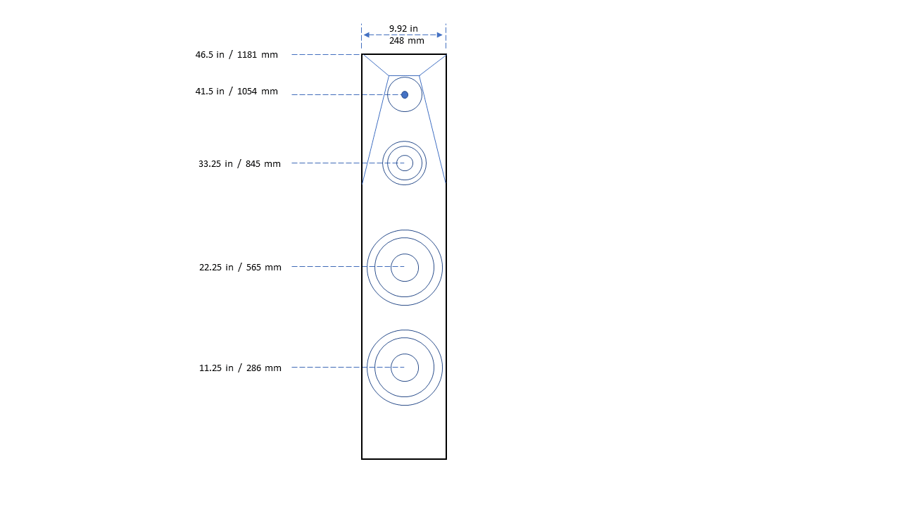

This project has evolved since the start of the thread. The only parameter that remains the same is the driver selection. The cabinet dimensions have changed, the diffraction control strategy has changed, and I am no longer using the Wondom JAB5. A Hypex FA123 will be installed in base of each speaker.
I am now using tapered bevels, based on what I have learned in the course of this thread https://www.diyaudio.com/community/...tions-with-ideal-drivers.380658/#post-6880731 .
J.
J.

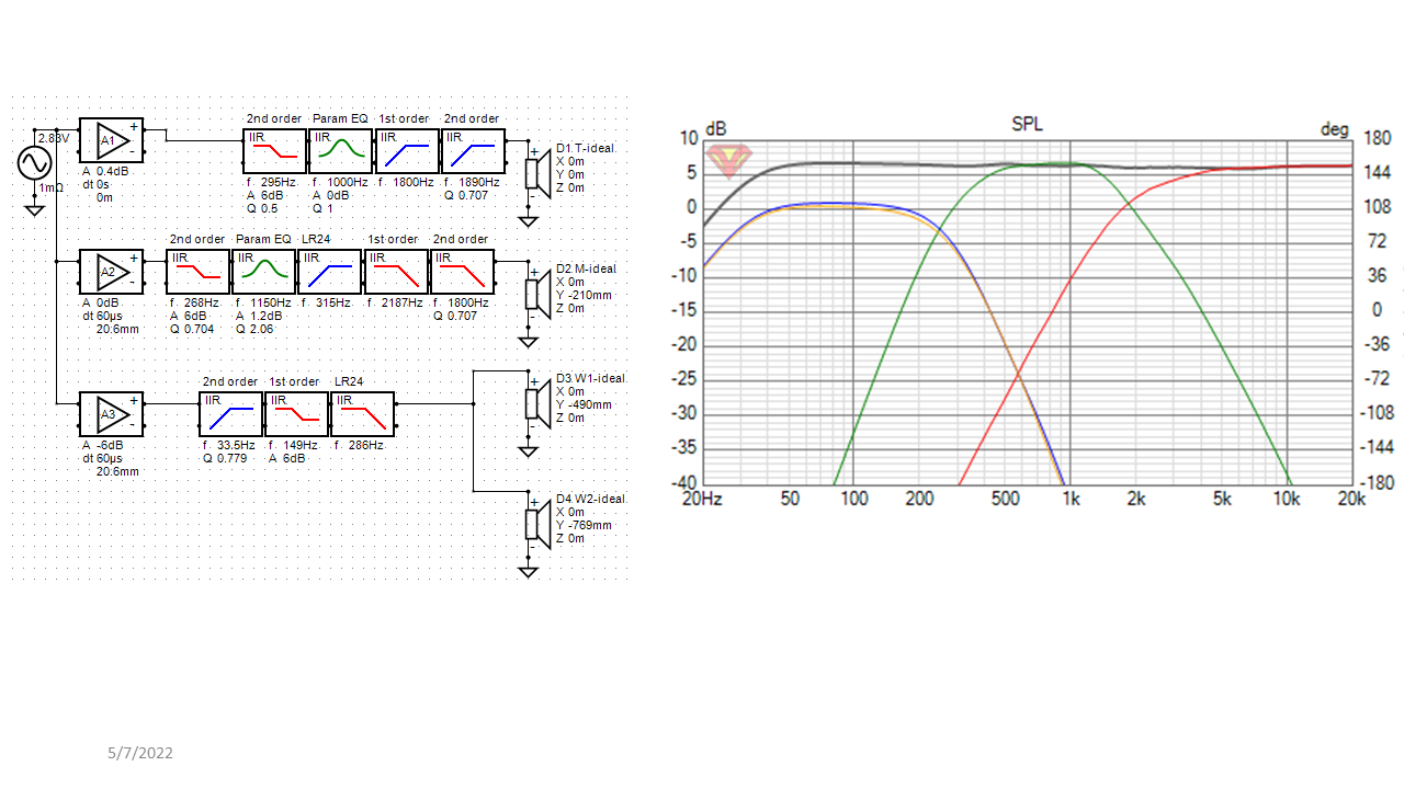

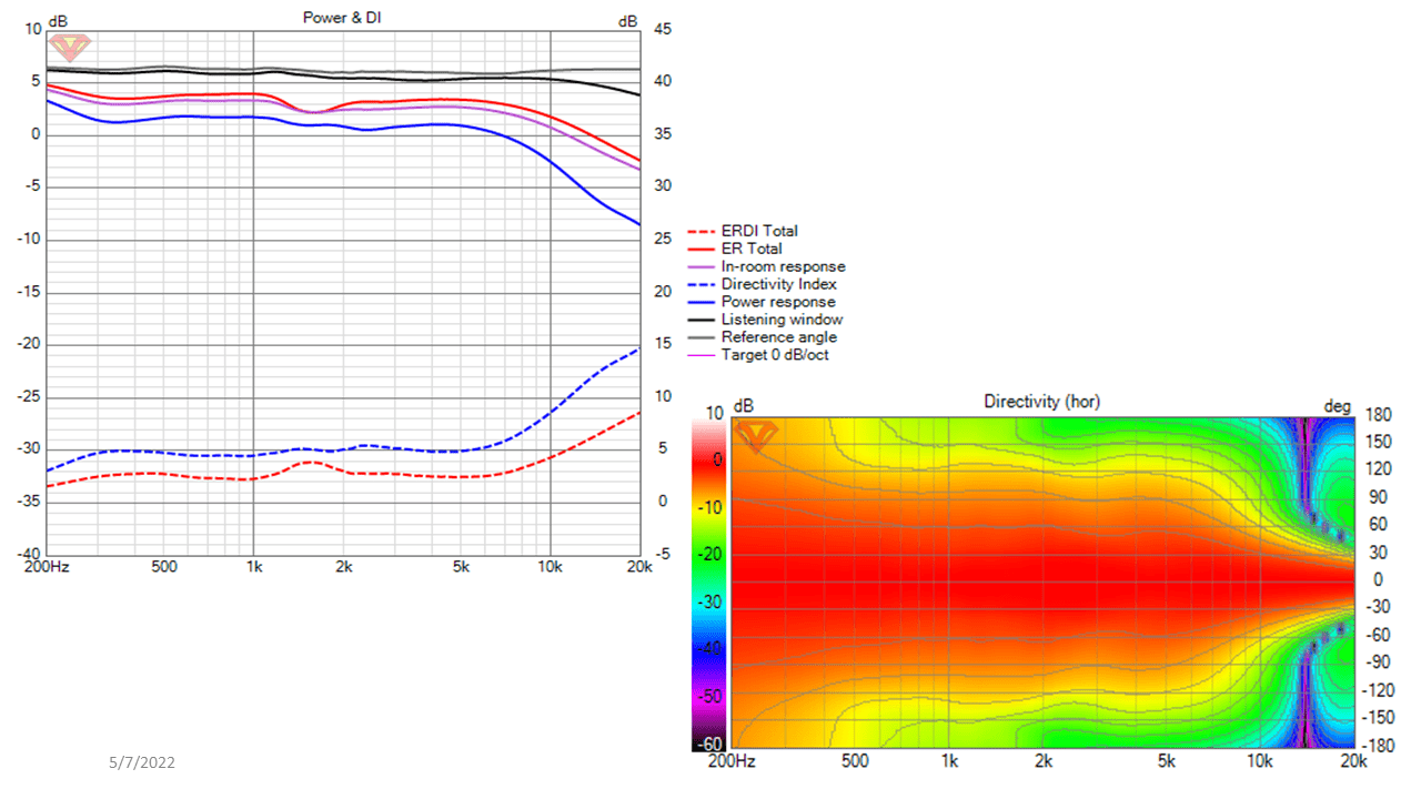

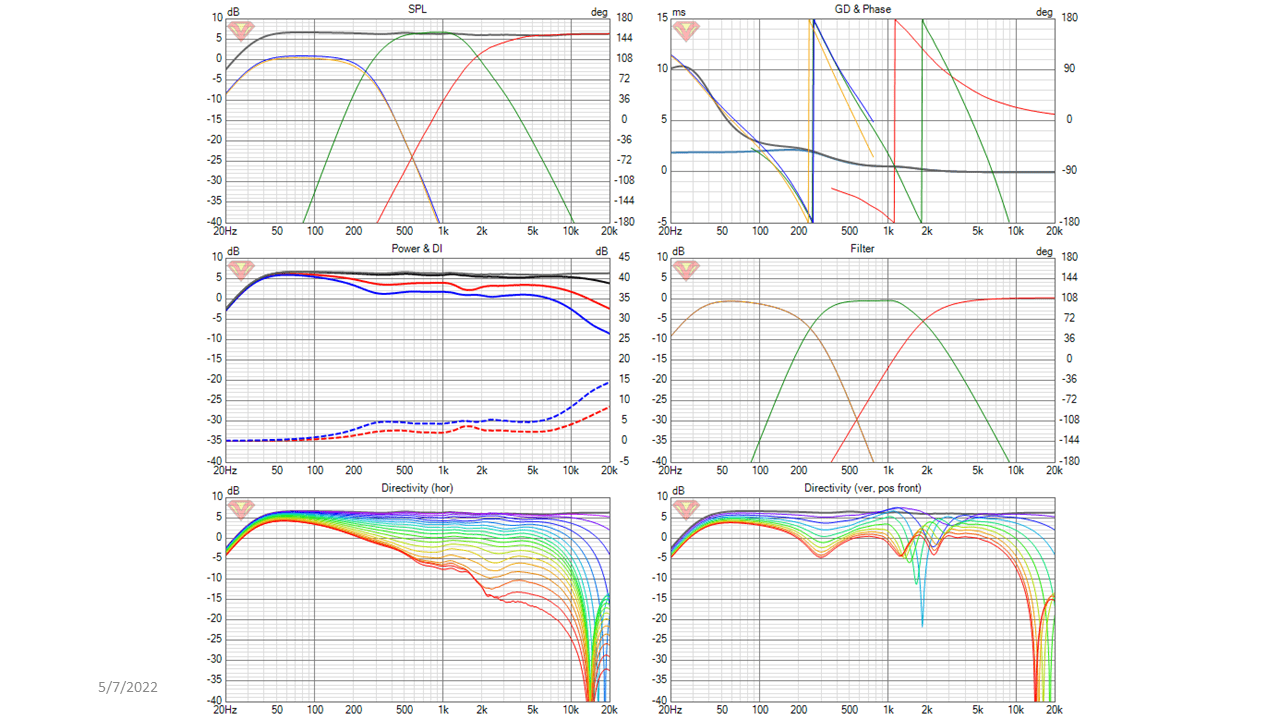

When I simulated this cabinet design using idealized drivers, the response looks pretty good. "Diffraction is destiny", and if the cabinet does not work with idealized drivers, it will probably not work with real drivers. I really appreciate the power of VituixCad because it allows me to construct a "final" cabinet without having to make several iterations of prototype cabinets. The actual filters I end up with after measuring and simulating my real drivers will no doubt be different from this idealized model, but that does not detract from the usefulness of this simulation. It gives me confidence that the concept is viable and feasible.
j.
j.
Looks good Jim!
i did the same with my 3 way- simulated the cabinet dimensions and driver placement first; based on idealised drivers. As you know, Vituix’s models are based on flat piston drivers, not cones and domes.
After installing the my drivers and taking full spinorama measurements, I definitely had to adjust my theoretical crossover because although one can massage the drivers to be flat +/- 0.5dB with a dozen biquads, the off axis measurements of real drivers different from those based on the idealised drivers.
Initially I set my crossover point based ona combination of factors such as smooth off axis response and power response, as well as distortion (I aim for minimal non-linear distortion at 96dB/1m- because as you know, you can equalise for linear distortion but it easily for non-linear distortion)
But my crossover points had to change slightly.
My targets are idealised predicted in room response (+/-1 dB) of a gentle linear downsloping curve of 7.5dB from 20Hz to 20khz, whilst maintaining a listening window of +/- 2dB.
I also adjusted my crossover for a different design axis (modelled was for tweeter axis) but it turns out I could get better phase alignment between midrange and tweeter if I used the midrange as the design axis, without compromising on other (actually between listening window at 3m) as well as better predicted in-room response.
then after lots of listening and being relatively I then took full spinorama measurements again, and it was very close to the model. Just enough for of minor tweaks.
Finally listening in the intended room I add my preferred room curve (minor tweak to treble level with a shelf filter, or a resistor change)
