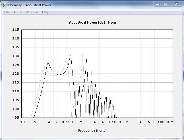

Hornresp really like multiple drivers in this "size", now to figure out how to mount multiples most efficiently.
Scratch that idea. I just realized that I can shorten this to ~39 inches tall external and get a 38 Hz tune that helps 35-50 considerably more than the 32 Hz tune I had previously spec'ed. Before after in attached image.
External size 17.5 wide 20.25 deep 38 tall
After the "peaks" smooth out a little bit as I expect should be looking at 121-123 dB full spectrum (33-100) with an extra 5 mm xmax to spare (out of thermal power at this point) only a 25 Hz HP 2nd order and 100 Hz LP (4th order) to keep exursion/response looking good.
Posting hornresp file in case I screwed up L34, being a flat mount I assume these to be equal, check me on that.
P.S. I assume that anywhere these are being used will have parametric equalization so flat response is less important to me.

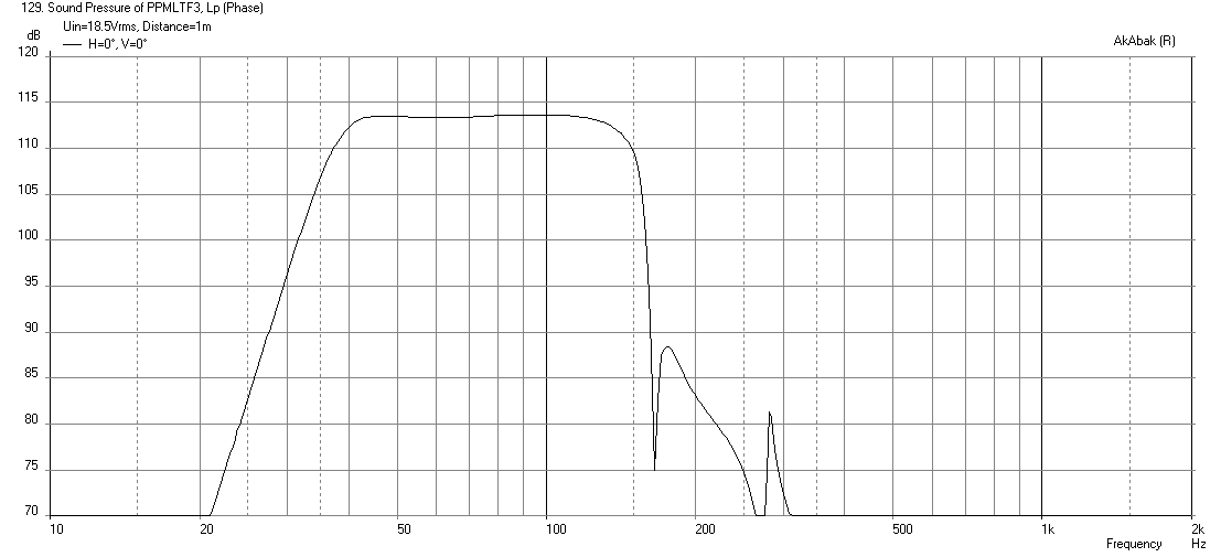

Compact PP ML-TF using W5-876SE's

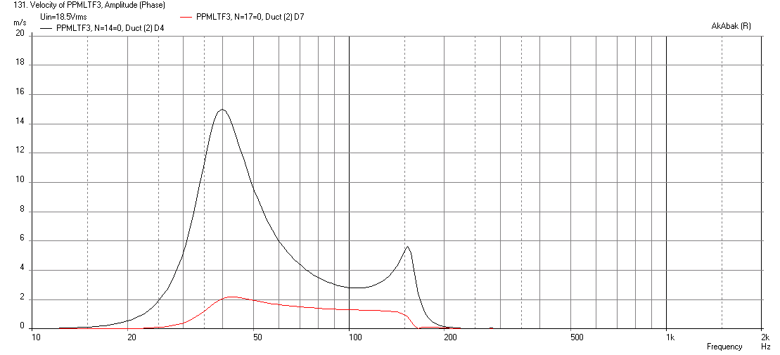

I came up with a design using this alignment for the 5 inch Tang Band W5-876SE drivers. It is a push pull design so that 2nd order distortion is reduced. The drivers are 16 ohm so putting them in parallel gets 8ohm nominal load. The box size is 16in x 16in x 12in (external). Here is the predicted max SPL freq response in corner loaded setup:
More info here:
http://www.diyaudio.com/forums/subwoofers/258433-light-air-slot-loaded-band-pass-sub-8.html#post4032728
Also, no chuffing here to worry about, here are the velocities:
![434384d1408678351-light-air-slot-loaded-band-pass-sub-ppmltf-velocities.png](https://www.diyaudio.com/forums/attachments/subwoofers/434384d1408678351-light-air-slot-loaded-band-pass-sub-ppmltf-velocities.png)

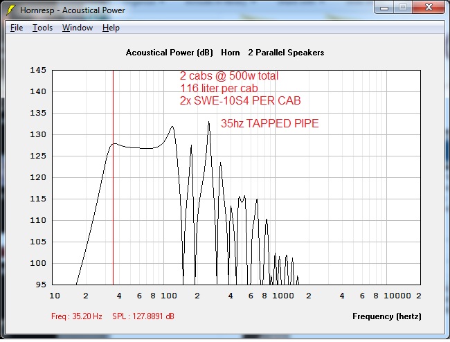

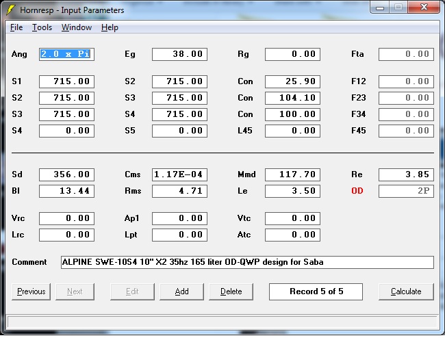

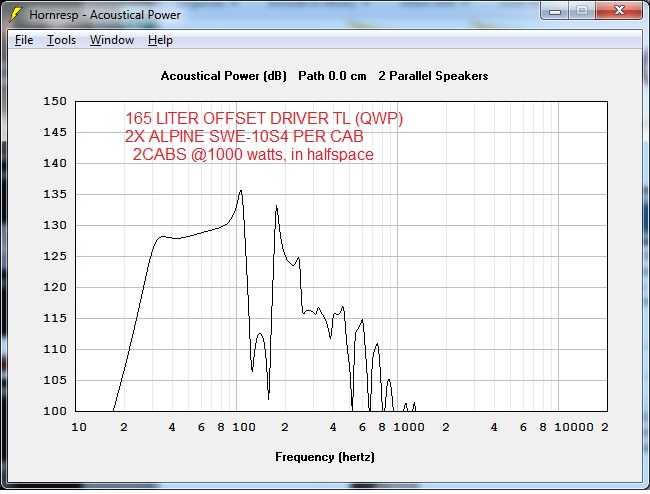

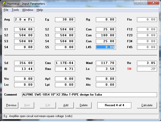

SABASPEED ,
Take a look , i put some sims together for you .... All non-tapered/non-expansion pipes ... Single fold sort of stuff , very simple ... very effective .... All tuned to 35hz.
I used the 10s in these, but could be scaled up to work with 12s...
The tapped-pipe version is compact, and the Offset Driver Quarter Wave Pipe is significantly larger with more output according to sim ..
