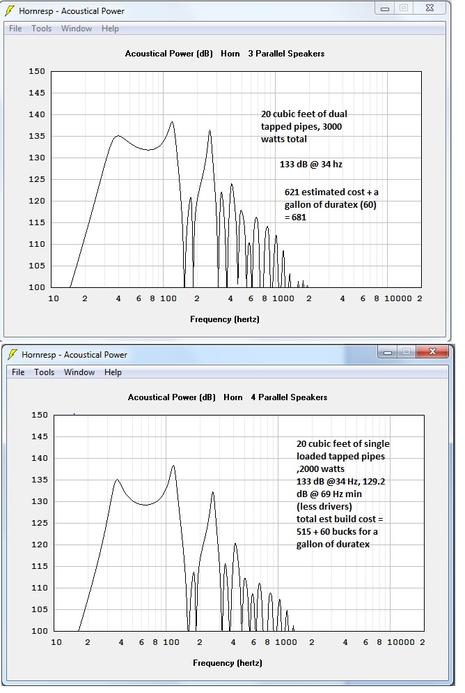

Your welcome and no problem ...These sims are quick and easy , i should be able to crank out a few more for you and then i will get back tinkering and updating the ML cabs ..
The drivers in those traditional pipe sims i made for you are "spanned" along the line meaning they would be placed closely one above the other with S2 and S4 being the midpoint between drivers ... This works well enough with smaller drivers but larger drivers being spanned in this way require the S2 & S4 points to be moved further into the pipe which can take away from performance in some cases, so in that scenario it is better to make two smaller cabs (one for each driver) instead of trying to put both into one cab ...
Build complexity is still about as simple as it gets except for the fact that you may have to create an access panel for the upper driver in the dual driver cabs since that upper woof will be somewhat concealed..
Here are some more juicy details with a standardized pack space of 20 cubic feet (about half my 4runner) ~ 1 20 inch wide T60
. Cost estimate rough of course, haven't cut sheet anything, could use more than a gallon--not sure yet.
***Ignore the dual driver loaded one's after adjusting the l12 l45 to what they actually are it's no longer viable. single loaded cabs still are though.

Brian has never said anything about chuffing or noticeable compression in his design either, although im not sure how much testing he did for the latter ...
I find it really interesting that his DFD vent filled in the midbass dip so incredibly well, this phenomenon should be studied further ...
If i recall correctly i think he used a 3:1 ratio squeeze which is what i am approaching now with the new revisions of the ML-Transflex cabs ...
In Brian's case it was a novel and inventive way to fix a problem. I don't think it's a good idea to use the concept as a design feature in a new design.
Not sure which Alpine box you are referring to but "grossly" you say? Thats a bit much ...
The design Saba built had 30 m/s velocity (26 m/s with hpf in place) and Flare It said the safety zone for that port size was 9 m/s. Weltersys's number were 31 m/s with an 18 m/s safety limit. That's a big difference.
20hz?!? Really?!?! Ok come on now JAG , now you are just grasping or trolling with this point that you are trying to make here .... To be fair that box has an FB of 39hz and it is obviously vented so you would never want to use it as low as 20hz, it's output down there would be insignificant and with no loading the cone would just flap around ... Your argument is invalid , and i mean that in a nice way, really.... I do enjoy a good debate but lets keep it reasonable ..
BINGO! In other words you are saying: "I would rather not use this example because it is unorthodox and ports/vents do not behave in a classic textbook manner when used with unusual alignments" ......
I explained twice now why Weltersys's example is not a good one to study for port compression. The reason is not that it doesn't compress, his tuning is high and his port output is very blunt and broadband so it's very hard see the compression effects. You HAVE TO go outside the passband a bit to see that there is actually significant compression happening because inside the passband it's happening everywhere, not just a Fb. The theory and/or physics of the compression phenomenon does not break down in the Shoehorn, it's just hard to pick out the effect because of the unusually flattened and broadband output of the port.
So then you have to come to terms with the possibility that ports/vents may not suffer from as much compression or chuffing in certain alignments (which would also imply they could potentially suffer even more in some other alignments) .....
In the Weltersys example those ports/vents didn't appear to have any issues, in your own words: "only minor compression" so from that i would have to draw the conclusion that those ports were NOT undersized for his alignment after all, at least not at that power level .....
Could it be that those same ports are undersized for some alignments , marginal for some alignments and fully acceptable for others? ...
It is really not unreasonable to suggest this is a possibility when so many other qualities or parameters vary from design to design, it shouldn't be a surprise that port behavior may vary too when used in different designs.. .
Yes, I've said several times now that his ports were only marginally undersized, that's why there's only a bit less than 2 db of compression inside the passband.
Sheesh man ... Is that really your impression of me?
At one point or another you did actually say each of those things and you seem to maintain that there are real world examples that don't adhere to the laws of physics. Small ducts introduce losses, there's no way around that.
I feel that this thread has been hugely derailed by very specific discussions on port compression. I think we get it JAG - lets get back on topic of designing, building, testing and listening and not get so hung up on whether it is turbulent or not and if compression is happening or not.
I didn't notice any audible chuffing for as long as I had POC2 in operation, and I have used it at high levels from time to time. I still have the box around so I could do some more extensive tests, but it that might require a bit of work to get done.
The DFD was created totally by empirical means. Its effect was confirmed by an Akabak model afterwards however. A search on the forum for the thread in which it was discussed should turn it up.
I still don't know why it worked in POC2. An attempt to duplicate the process on my TP build failed miserably.
