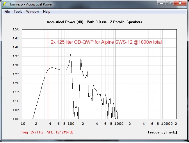

ok , the compound pipe version looks pretty outrageous ! Bigger box though .....
Your OD-QWP box is now down to 124 liters , not bad =) .... The offset sweet spot seems to be around 15 to 20 centimeters so the driver wants to be located near the closed end of the pipe (S2=20cm) .... As a single fold it is 46" tall with 3/4" ply .... the only way to get it shorter is to use additional folding or add a small amount of mass-loading (constriction) but it wouldn't require much since we only need to shave off 7 inches of height ... Footprint would then be square-ish ...
Im attaching some HR screenshots of (what could be built as) the 46 inch single fold ..... Could be made larger (fatter) if you want to give yourself a bigger and deeper response bump on the bottom end, but i wouldn't go any smaller than 124 liters in this alignment with the SWS-12 .....

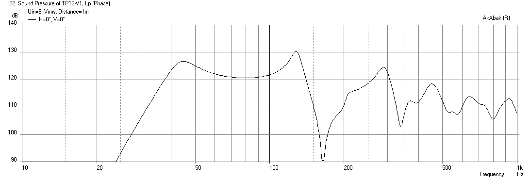

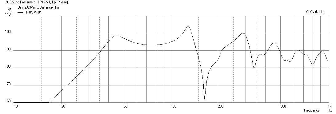

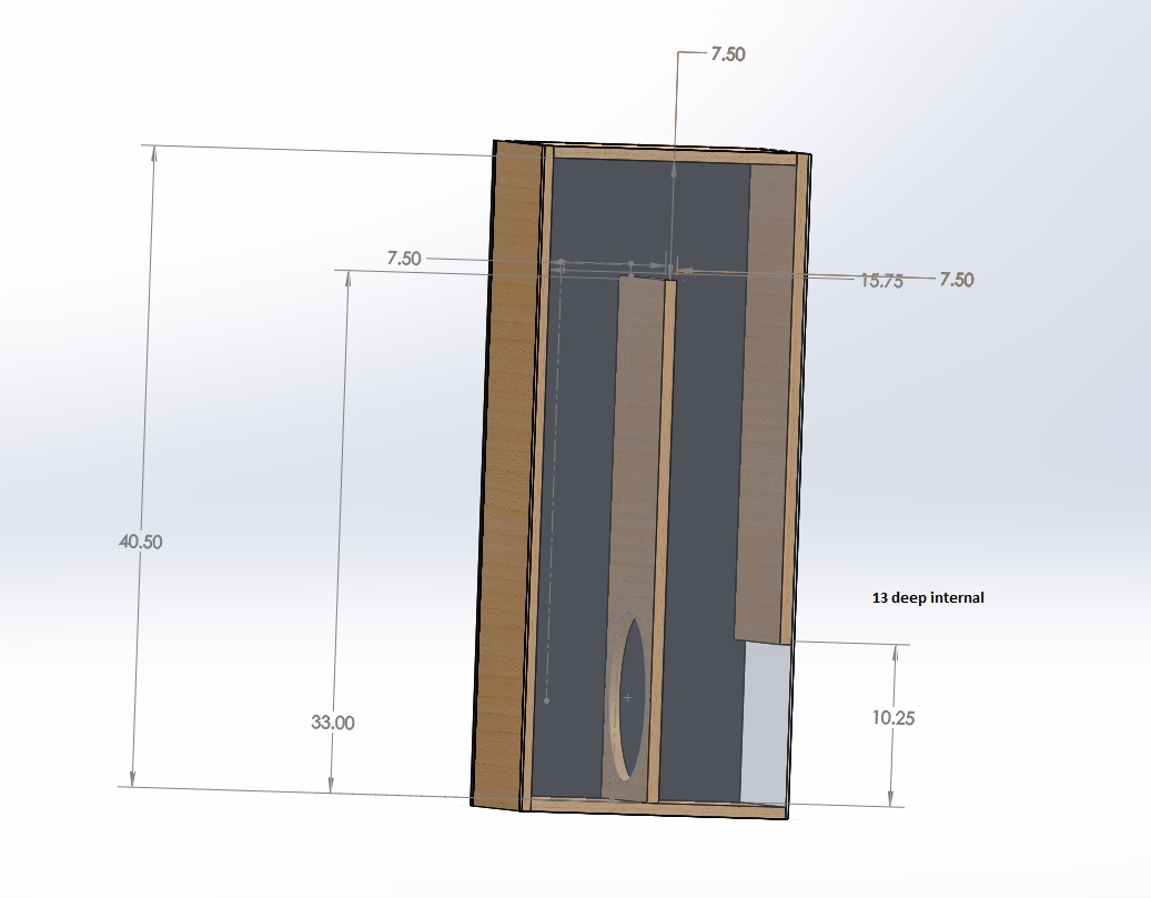

Tapped Pipe with Alpine SWS 12D4

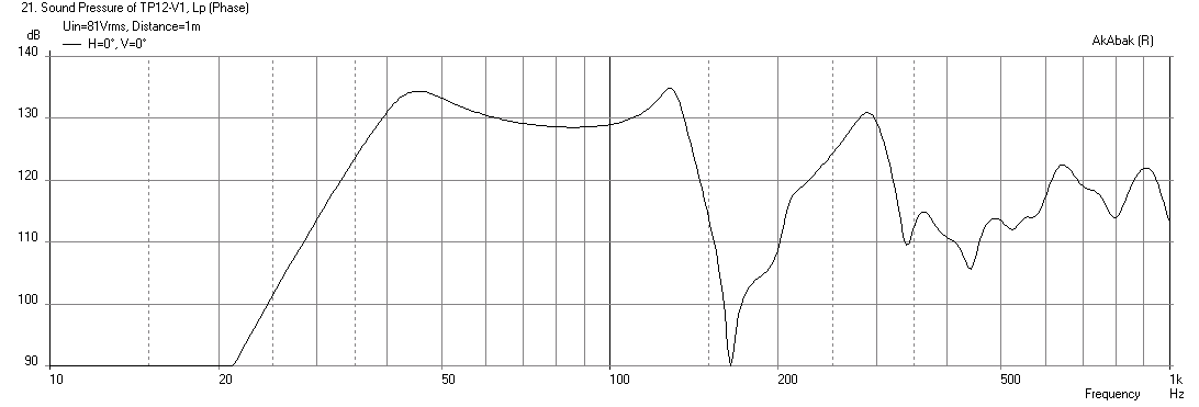

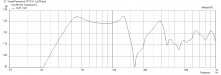

Here is the design by Sabaspeed:
I have never modeled a dual voice coil hooked up in series before. The Re changes, but doesn't something else in the TS params change too like BL doubles? No BL was specified by the manufacturer though. Let me know what T/S params are when in DVC mode. I am not sure if I spec'd the driver T/S params correctly given that it is a DVC wired in series. I have included stuffing in first part of TL all way through the turns.
Anyhow, the sims show kind of a saddle in the response in 2pi at xmax.
It looks better corner loaded (20 in from both side walls):

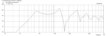

Here is placed 36 in from back wall (at 2.83V):

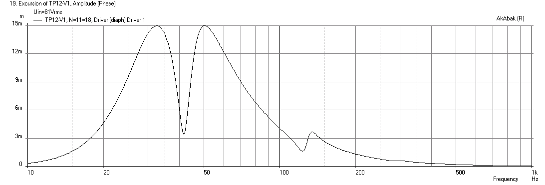

Here is cone displacement at xmax (with 34Hz -24dB/oct HPF):

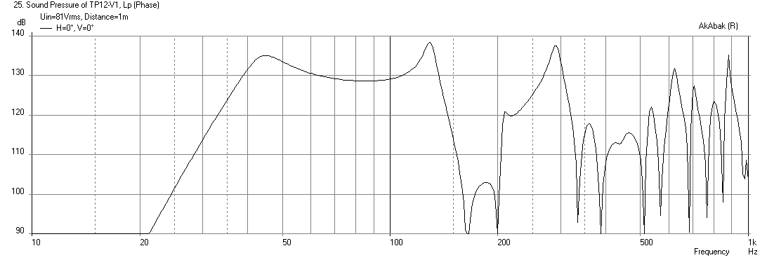

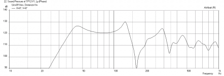

Here is what it looks like without any stuffing applied for the corner case:
The Akabak script is attached as a txt file.

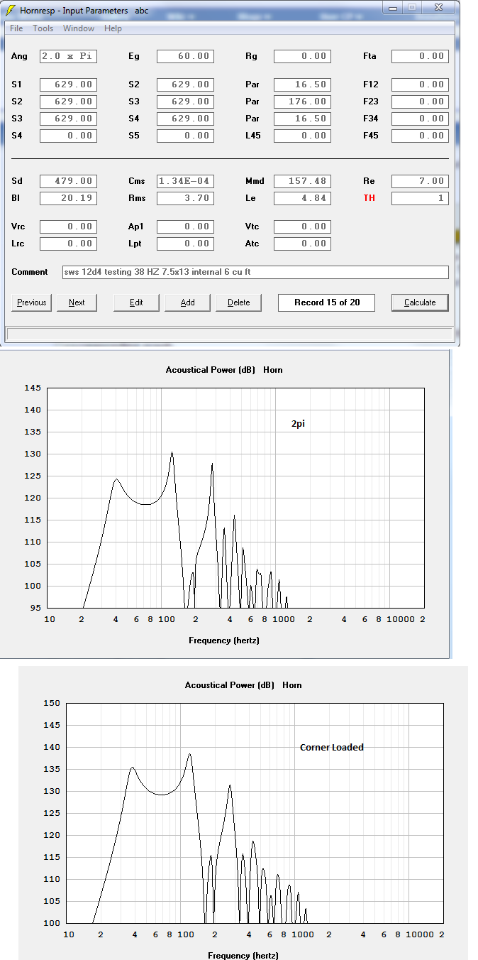

sws 12 d4, I put the ts params a few pages back (i think 2 but not sure) also here is the spec sheet.
http://support.alpine-usa.com/products/documents/OM_SWS-101215_D4_2.pdf
Assume series voice coils. (8 ohm nom, 7 ohm re)

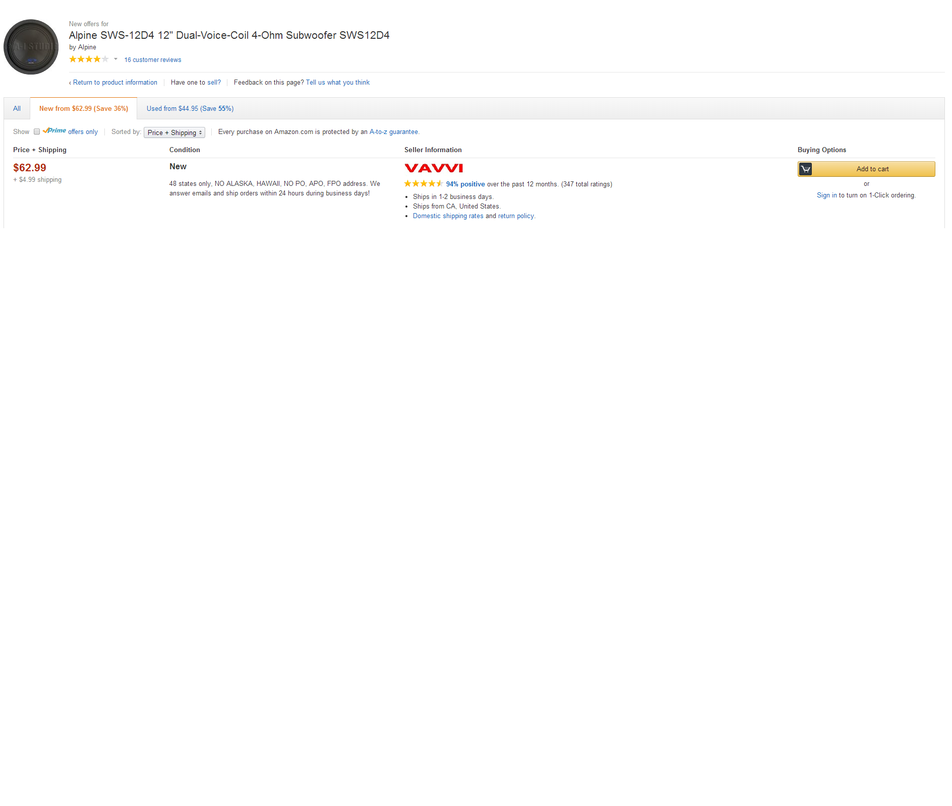

did I misunderstand that there is/was an Alpine 12 for $75 at creative -?
Freddi,
I was trying to figure that out as well ... They aren't advertising that deal on Creative's website as far as i can tell, and i have been searching elsewhere but still haven't found that kind of steal ...
So far the best deal i have found is $85 with free shipping for the D4 , the D2 is around $90 for some reason ..... Even at $90 it is not a bad deal at all really , but still perusing the webz ...

I agree the volume should be smaller to flatten it out. I am just modeling design as drawn by Sabaspeed. Wasn't sure if my TS params were so far off due to DVC that I did my want to proceed until that is correct. The things is quite damped with stuffing in all figs except he last.
It's not at creative car audio. I got it off amazon, can't remember the sellers name but they are based out of california i.e. ships fast for me.

Flat doesn't matter . Here are the T/s parameters I simulated with, and the corresponding graph.

Here is the sale
You have to click "new from 63..." it's not the default seller.
