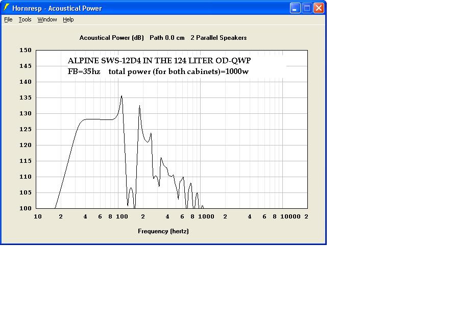

Initially with the published specs it looks like each one of those drivers will require around 90 liters of internal box volume in something like a tapped pipe , so about 30 liters less than what is required for two SWE-10S4s in the same alignment but the output is significantly down when compared , this doesn't seem to be the optimal alignment for this 12 , besides , it physically has an overly tight fit in the cab, so that's not ideal either.....
In an OD-QWP the 12 needs about 135 liters ...
So far a straight (no taper , no expansion) Offset Driver Quarter Wave Pipe (OD-QWP) seems to perform the best with this driver , requiring a volume of 135-ish L (only 15 liters larger than the dual 10S4 TP) and performing with about as much output as two SWE-10S4s but the response is not quite as flat as i would like ... Some stuffing in the first 20% to 30% would help tame the bump at FB ...

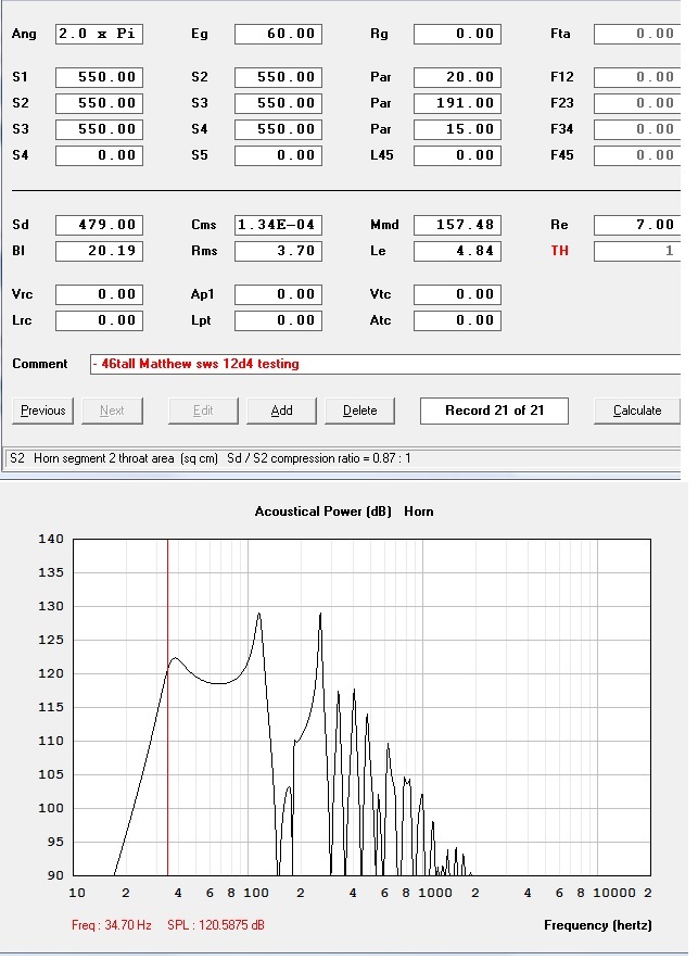

Matthew, the TS parameters I used (as I calculated off the spec sheet) are much different than yours. Here is what I get using "your box" with it's parameters as I understand them. The reason I didn't go any smaller in depth as it appears you chose is I limited myself to driver depth + 1 for venting/headroom because this assumes mounting it the way I've mounted my alpines previously, flipping it around and I could make it ~1 inch shallower all the way around (2 inches less total). After math I see that your box @ 550 sqcm correlates to a total depth of 15.5 inches, mighty nice for me, considering switching and then from mounting the driver.
<see image attached>

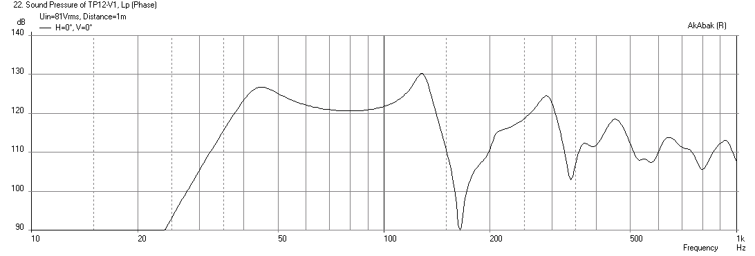

XRK:
I can't understand how our boxes simulate so different in different programs seeing as I checked your ts parameters and they seem fine... P.S. I'm not concerned about flat and would rather have that bump for low end "head room" assuming i'm not sacrificing too much 50-100 output.
Why does yours appear to be a 45 Hz spike when mine quite clearly is a 38 hz spike?
Looking at the script it looks like you may have simulated the 39 inch tall version (just going over some of the lengths now)? I grew the design by 3 inches to "properly" get the tune under 40...
Forgot to mention, 81 volts would fry this voice coil right? I mean it's rated for 500 rms so maybe peaks of 1000 would be alright but rather bold to simulate that high...
68 is the highest I would go as that is 15 mm excursion at 45 hz according to hornresp in my version of the box.

Ok , you have a few things going on here, first be sure to click on the little red "TH" just below "Re" until it turns into "OD" ... This puts us into Offset Driver pipe mode instead of Tapped mode ...
I am just now loading the parameters for the 12D4 in HR (i was using the 12D2 before) ..... Upon entering the T/S figures i see that the motor strength in this driver is actually stronger ! which is a good thing
Now, my advice on the saddle shaped curves and "ringing" resonant peak at FB is that you have to keep in mind that Hornresponse always shows an exaggerated version of what you would get in real life when it comes to these peaks and saddles , however if that contour is bad enough in sim it actually will manifest itself in real life and then it is not really a good thing because it indicates that group delay is not as tight as it could be , cone control is also not as good as it could be and the bass reproduction will tend to sound less-than-natural and not very musical ...
If you notice i will always raise my LE in simulations (which often reduces the saddle shape of the response) and gives you a better idea of what the bass response will be in the real world , however this is just a "hack" and only just helps to approximate things (but its not perfect by any means) , when instead it would be great if David Mcbean could add a "lossy" option to his simulator in order to accomplish the same thing with more accuracy ....
If the saddle (also called "underdamped" response) does show up in real world measurements then some stuffing can be added at the beginning 25% to 33% of the pipe to straighten things out .....
In the end you really don't want a severely underdamped response because a lot of heavy EQ will reduce your headroom .... Keep in mind that if you have to EQ boost 50hz through 80hz by even 3db then you are asking for double the amount of power from your amplifier in that range ...... As a general rule shooting for a flat-ish response and using minimal to no EQ will always provide maximum headroom ..... Its really a shame that crummy room acoustics make us have to use EQ sometimes..
If you are someone who always tends to want to add a little bit of EQ around FB then making the response slightly underdamped might not hurt if it means that you don't have to apply any EQ ..

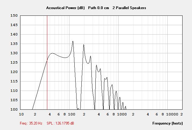

OOH, Loving the Nd setting, haha, so a pair of sws 12's in a 19.25 deep 13 wide 58 long (dual loaded single cabinet) is looking usable down to 27 Hz!!! Albeit it's rolled off a bit by then but the excursion is kept down until 26 Hz. 126-127 db 50-100 Hz with a nice slow taper all the way down. (124 at 35 hz).
Also, my new simulation with the 15 inch version looks mighty appealing at 126 dB of output 40-50 Hz

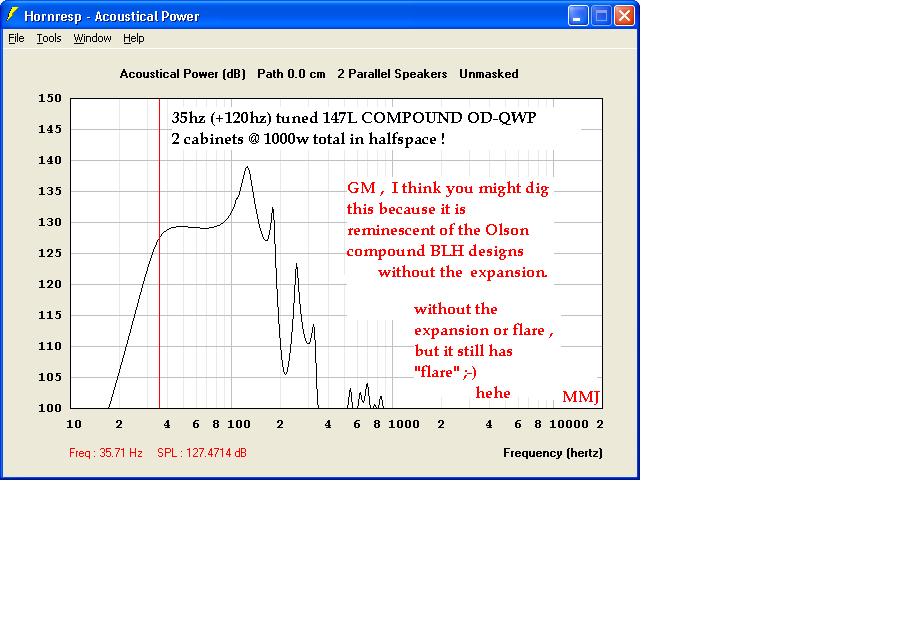

Here is the Alpine SWS-12D4 in both a OD-QWP format and also COMPOUND OD-QWP sort of alignment , both with raised LE for more realism in sim purposes .... 72..5 volts ... Just barely touches 15mm ..
I like this driver , good results here
Absolutely competitive with two of the E series 10S4s ..
Saba , to answer your question from earlier a compound alignment just means more resonators ... So in this we have a resonator on the front of the cone as well as the back ... The one on the front can be very small and is just used to fill in the gap between the 3rd and 5th harmonic but appears to add a little bit of extra gain throughout the midbass range and even a smidgeon down low .... It also seems to add some damping well below the FB on the smaller resonator, at least that is what it shows in sim ..
Also , i wanted to make sure that you know (because i think you will appreciate this) the woofer is mounted on the outside of the box with the magnet inside ( the driver is not hidden inside of chambers like the tapped alignments we were working on) so there are no issues with ease of access , and no need for removable panels !

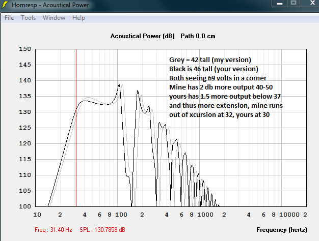

Comparison, 46 vs 42 tall, everything else constant (69 volts corner loaded, cross section). I'll take either
Semi-final decision is your 46 tall version, with a 32 hz HP 2nd order and 8th order lp at 98. Makes it razor flat and <20 ms group delay from filters!
Now I need to come to an agreement with XRK as to what panel dimensions will accurately represent the sim. I'll be posting a side view with lines drawn to show how I measured the segments, hopefully that will shed light on any discrepancies.
