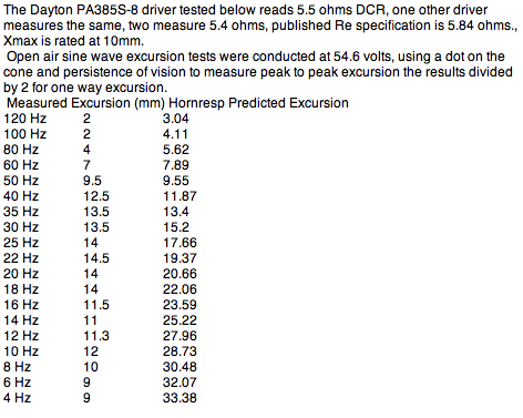

As stated, the 15" Dayton PA385-8 excursion measurements were open air, as was the simulation, done as an open baffle equal to Sd.
But that driver will be an outlier when compared to drivers with more linear suspensions

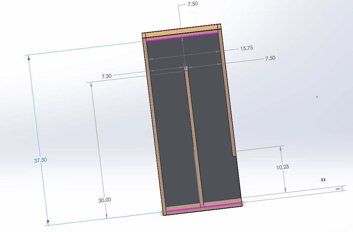

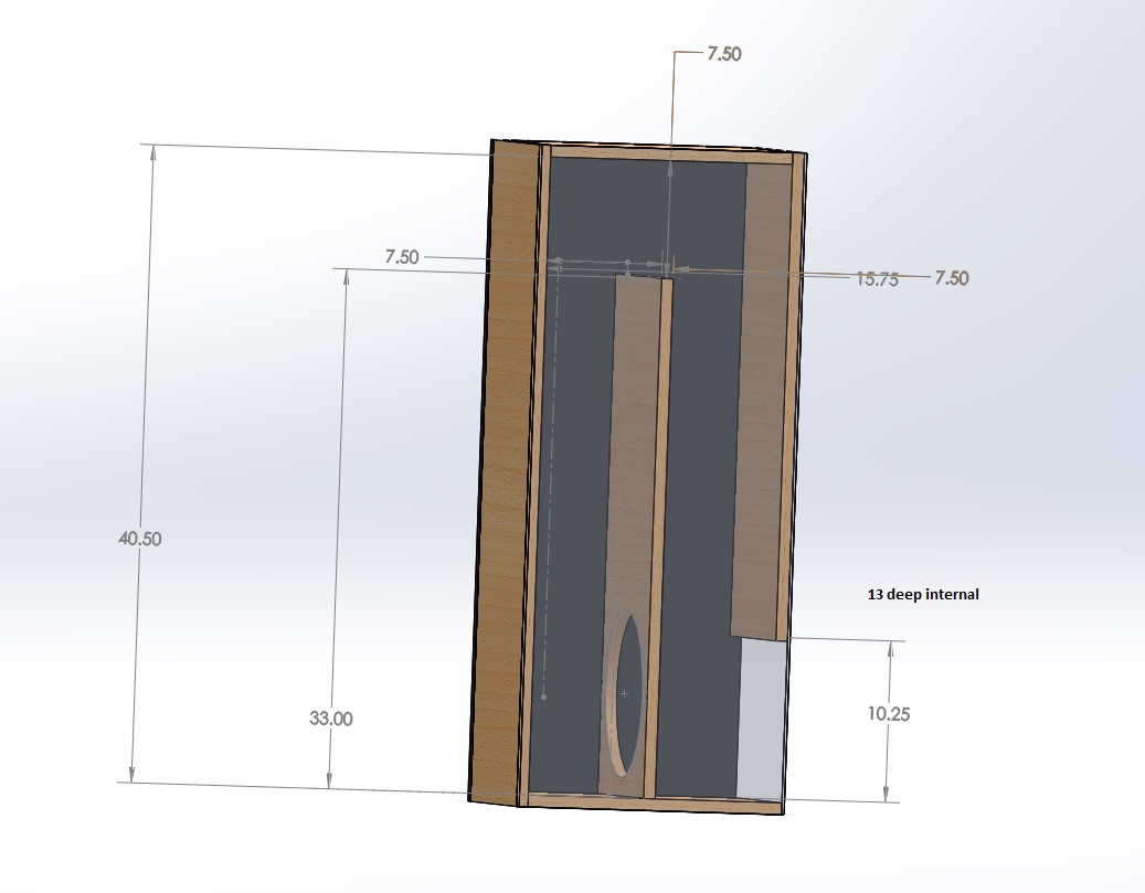

anyone else excited as i am to test out the sws pipe? In fact, I'll post a fully labeled side view so anyone with akabak that doesn't mind simming it can give me a better picture of what "actual output" I should be looking at both in a corner and open space (ground plane).
And... here it is. 39x17.25x14.5, 5.6 cubic feet, a little bigger than I thought it was (previously must have confused internal/external). This is accurate.
damn recalculated path length and it's not quite enough... L23 is center of chamber path distance center of driver to other side of center of driver right?
Well the previous post needs some modification, did a more accurate path length calculation and my previous simulation was in the 140 cm range (l23) whereas I need ~180. Below is the 178 cm path length version, 42 inches tall, rest unmodified.
What driver is this for? Should be pretty straightforward to model.
sws 12 d4, I put the ts params a few pages back (i think 2 but not sure) also here is the spec sheet.
http://support.alpine-usa.com/products/documents/OM_SWS-101215_D4_2.pdf
Assume series voice coils. (8 ohm nom, 7 ohm re)

I think there's a problem in your measurement procedure, well at least if you're trying to compare the measured results to what HornResp or other box-modelling programs predict in that scenario. Hint: what happens to a driver's voice coil when you drive 45 or 76 volts continuously through it?

Brian,I think there's a problem in your measurement procedure, well at least if you're trying to compare the measured results to what HornResp or other box-modelling programs predict in that scenario. Hint: what happens to a driver's voice coil when you drive 45 or 76 volts continuously through it?![]()
Since the open air impedance was generally quite high (at least according to the sim), not much heat was generated at 56.4 volt input, the magnet structure had hardly any increase in heat after testing (even after applying 76 volts), though a slight rise could be felt around the dust cap. Believe me, I know what drivers suffering from thermal compression feel like, of course box-modelling programs ignore thermal compression issues as well as suspension and BL non-linearities.
At any rate, this was the first time I had done extensive open air excursion measurements, what are you suggesting was the problem in my measurement procedure?

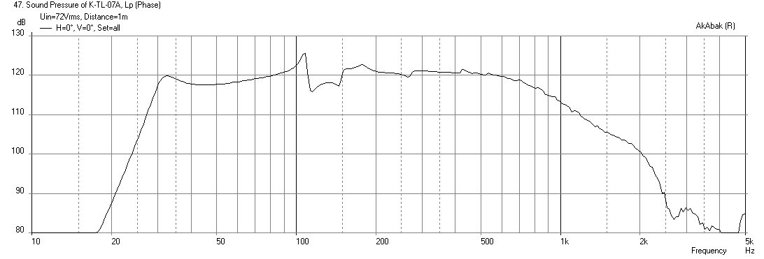

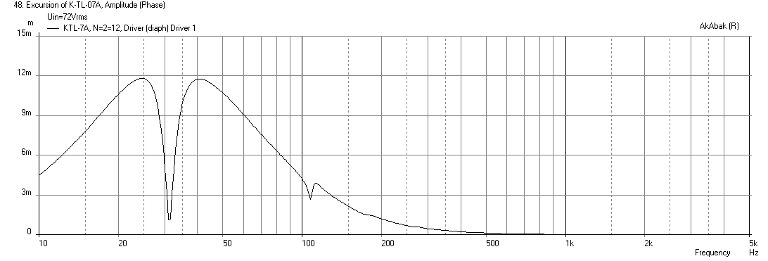

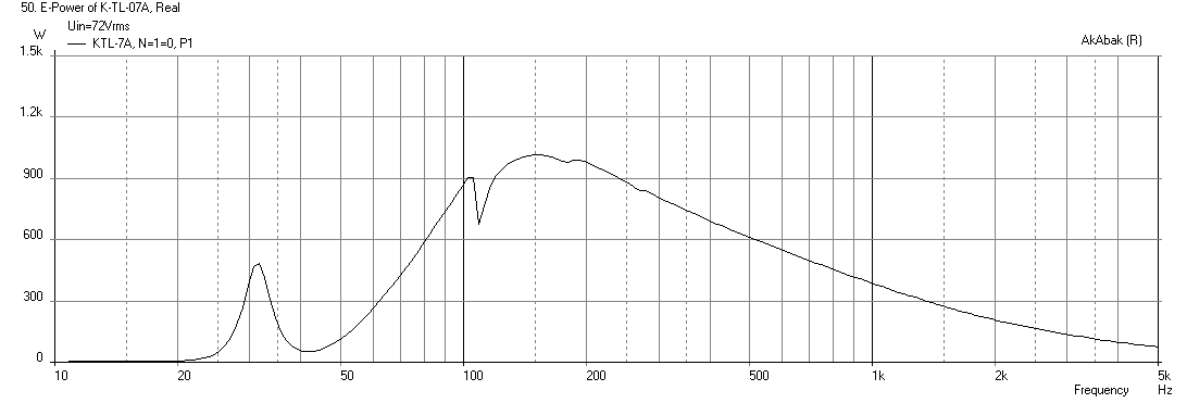

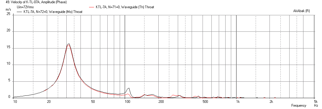

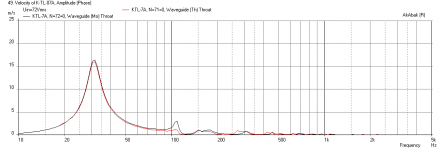

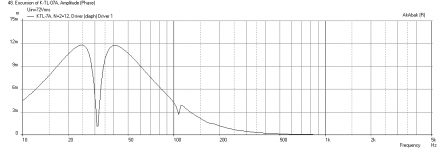

Karlsonator scaled to 1.5x with Lab 15
Here is the Karlsonator, scaled to 1.5x high and deep and 1.1x wide with a Lab 15 8 ohm. That is a 45 in tall x 17 in wide x 24 in deep This is for 2 pi sitting on floor.
Max SPL at 72v with -12dB HPF at 31.5Hz:
Cone Displacement:
Max throat velocity is 17m/s, I think chuffing is not an issue here:
Electrical power (1kW if you want it to serve as high bandwidth driver with no LPF) but very efficient if high-passed below 100Hz:
I think that this actually looks pretty impressive for a sub to be able to reach such a high bandwidth of 1kHz smoothly. The reverse taper ML-TQWT with 6th order bandpass seems to work well. Like I said, the K-nator box is very versatile and easily scaled for just about any driver.
Well, the first one that popped into my mind is that the driver's ability to dissipate heat probably varies with frequency (i.e. the cone moves a lot more @ 20 Hz than it does at 100 Hz). With rising heat, the voice coil's impedance also rises, which will shift the driver's performance a bit from the predictions, and this shift would be different at different frequencies.
Also, there are more accurate ways than using persistence of vision to measure excursion. One way I've heard of is to use a laser pointer and a small mirror attached to the dust cap. Bounce the light from the pointer off the lens and onto a piece of cardboard or something similar, and then you can measure the deflection right off the cardboard.
Way back when I had a lot more time on my hands, but no laser pointer or mirror, I rigged up something that looked like a slide-rule that I basically fastened in front of the driver for measuring excursion. The center piece of the slide-rule could be extended to touch the driver's dust cap. My idea was to just extend the center piece at different driver excursion levels until it touched the dustcap, then measure the differences in deflection straight of the slid-rule. It actually worked quite well, though of course it only measured the cone's forward deflection.
Finally, your measurements suggest that there was some sort of rolloff on the input signal somewhere below 30 Hz. Did you measure the voltage at each frequency measurement, and how did you measure it - with a true-RMS meter?
