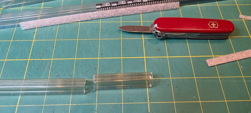

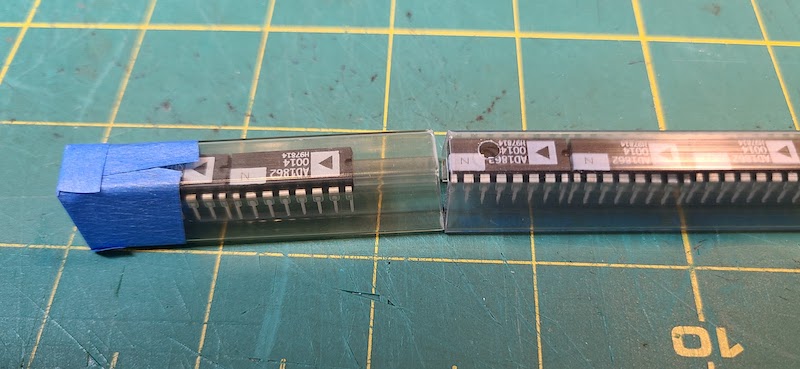

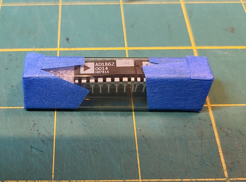

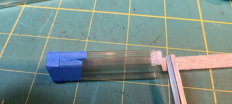

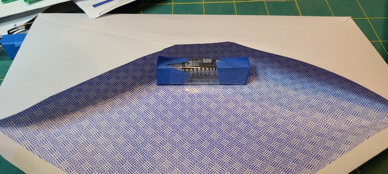

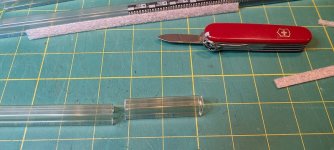

Once you have chips, you have to pack them. I cut the antistatic sleeves they come in down to about 2 in/60mm length, tape one end, and use some of the supplied antistatic foam to keep the chips from rattling. There's no need to touch the chips at all - slide a pair from one sleeve into another. The low-tack blue painter's tape isn't essential but I like to think it generates less static than packing tape if someone peels it off.

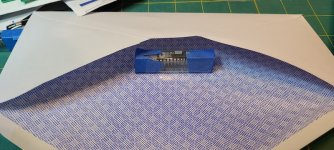

It's hard to see, but I tape the sleeve and/or any boards to the front side of the envelope. This way, if the envelope gets torn open there's a chance that the chips will stay with the address label. It's a long shot but I got a package of op amps back this way so it's at least helped once. I completely tape the outside of all envelopes going international, to protect from both postal sorting machines and sticky fingers.
