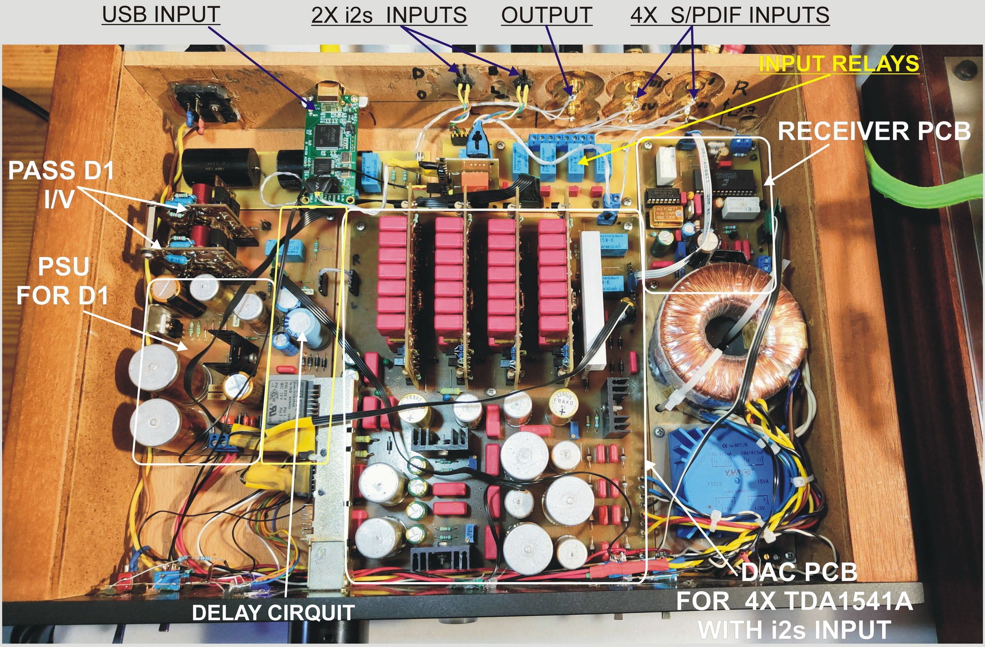

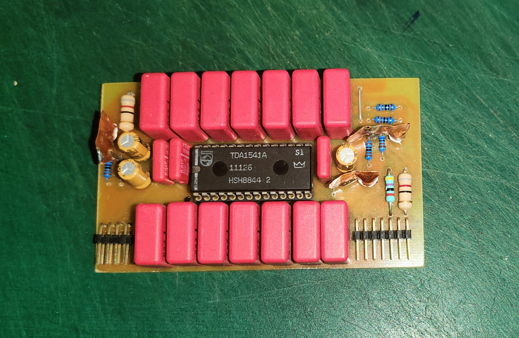

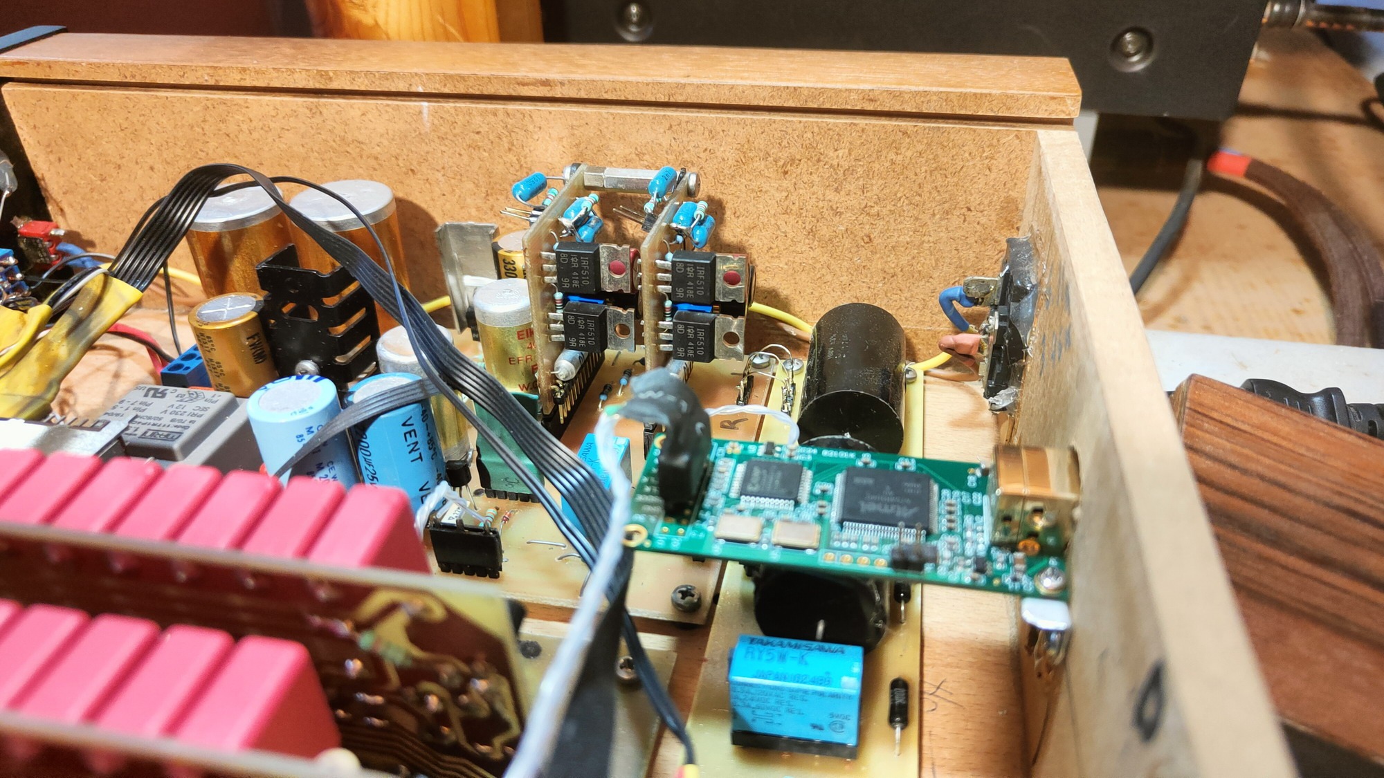

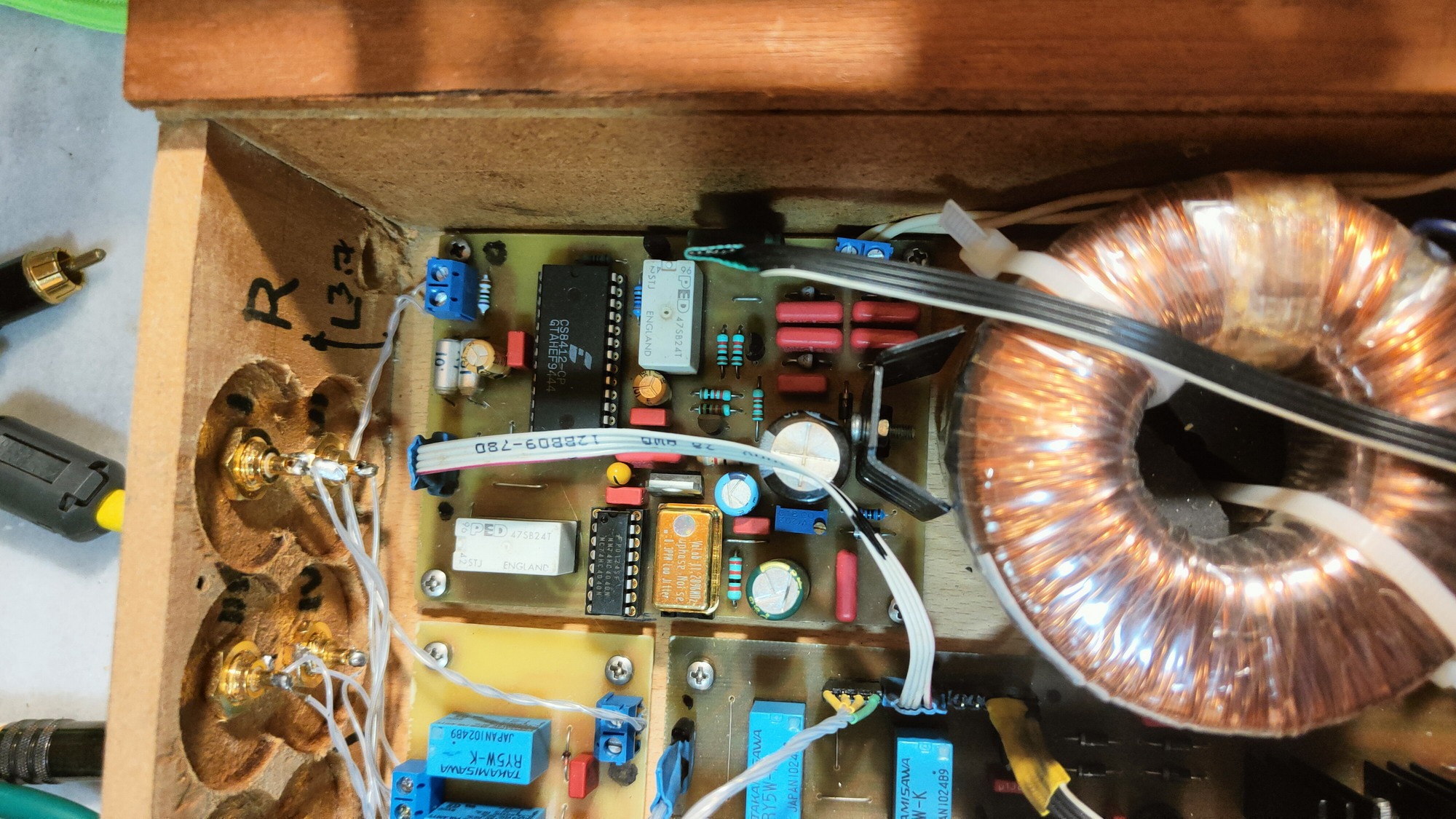

Dear friends
I was using a diy 2X TDA1541A S1 with the D1 i/v, from 2008 until last year. It was direct connected to my diy CD pro2 player with the i2s port.
The sound was great and much better than any other DAC I had test. Last year I finished a DAC (starting from 2014) using 4X TDA1541A, with 4x coax s/pdif , 2x i2s and a USB input. The only change on D1 was to put parallel, to R4 and C2 , a 1k5 and 2.7nF because of the four dacs. The sound is much better with higher levels of music especially when I use the B1 as a preamp.
I also use PCBs with the TDA1387 instead of 1541a, but there is not comparison, because 1541a is much more natural. I think that only the bass of 1387 is a little better with more presence. And a few pics of it. The enclosure was from a previοus active x/over.
With kind regards
Kostas A. Vazakas
Greece
