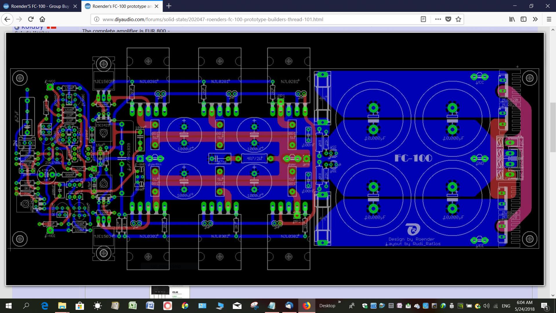

Yes but the Roender does including the MUR120 equivalent diodes which run around the outskirts in the image I posted.
These connect to the bases of a 2SC3423 NPN equivalent to Q1 in your simulation and a 2SA1360 PNP equivalent to Q20. These are in TO-220 packages and serve to increase compensate for the MUR120 temperature mismatch with the NJL transistor part of the die.
Having the sense element at the heat source is important to maintaining the correct level of bias which is difficult enough with one power device per output half let alone three.
Your choice of Q1 and Q20 transistors in TO-39 packages are small signal types as are D7 and D8. These are cheaper than the above mentioned parts, so consider why has extra money been spent on bulkier ones.
The next question is how to cover six temperature spots on the heatsink with a complement of four devices.
One possible answer would be to emulate the Roender by drilling holes adjacent to the power transistors to take MUR120s and fit TO-220 devices in lieu of TO-39's.

This is not Roender's layout. Perhaps you took it from FC100 builders thread. It's made by Rudi Ratlos from Germany, if I'm not wrong.
If I remember correctly, Roender said that these diodes works as they should only when they are built in on the same die in the transistor like the thermaltrack is, all other solutions with separate diodes attached are just not effective enough. The only choice in our situation is Vbe mult. I guess. If we would go the way you offer, simpler option can be to use diode in a small smd package glued to the collector lead instead.
Btw, it's TO-92 package, not TO-39 I'm currently using.
