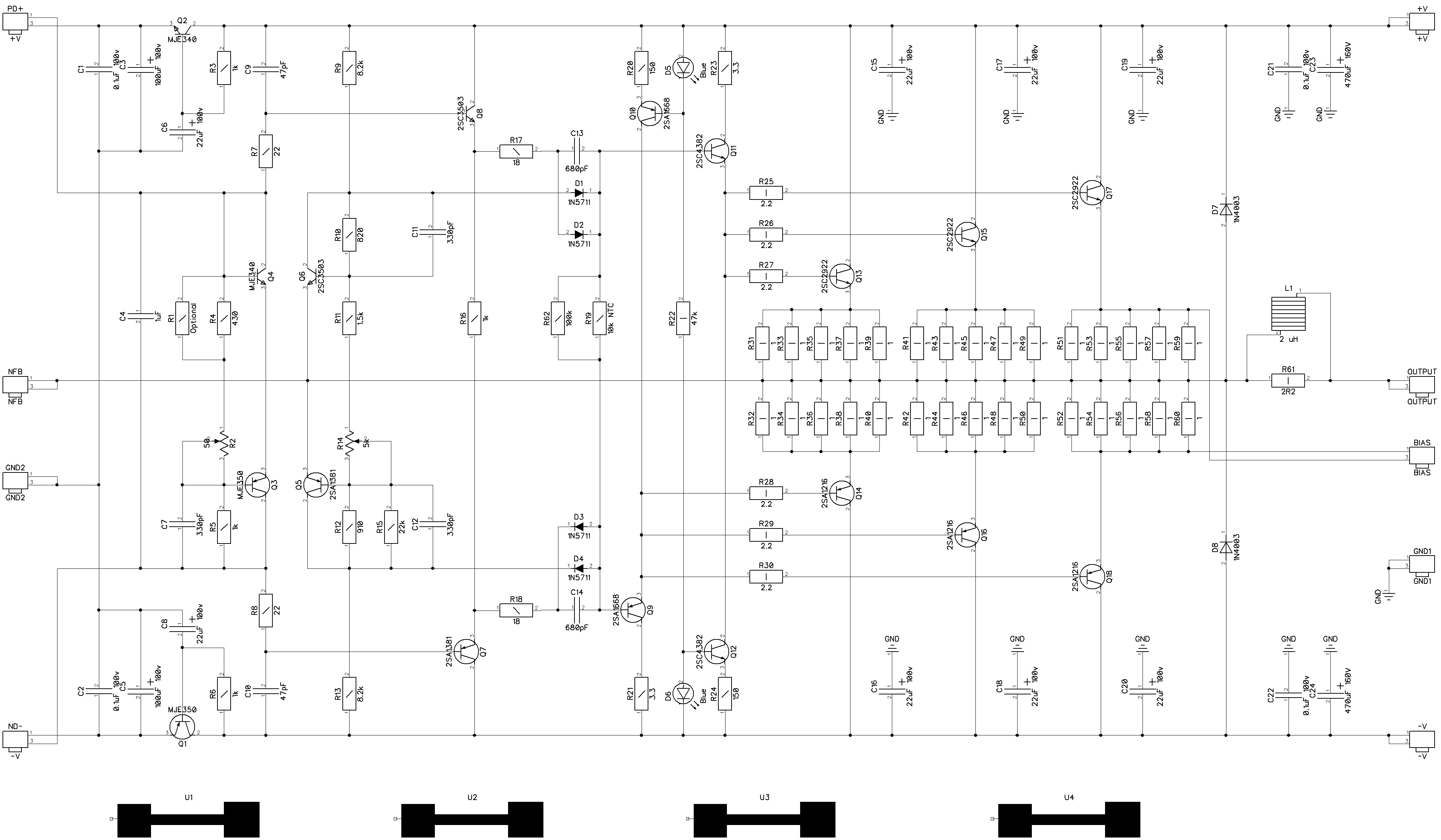

Re-drawing for clarity reveals a couple things. C9,C10,C11,C12 are counter productive and only serve to couple supply noise into the signal path. Of course simulation using "perfect voltages" will not show a problem. R8 and R9 have been super tweaked to cover a poor bias design that is super sensitive to tolerance. Probably the best solution is to scrap the DC feedback gain since the input is not DC coupled anyway, ie put large caps in series with R2, R4. This amp lacks output protection, etc, etc.

If I remember correctly, C9, C10 were recommended to suppress rf ingress if Q16, Q17 base traces exceeds 3-4cm on pcb. Don't know about C11, C12.

C13 is in parallel with C19 and they could be replaced with one small cap. 100n (C13) may be enough. C14, C19, C20 are cross coupling caps which couple the opposite polarity drive so that especially the larger slower transistors do not float on when driven fast (aka "shoot-through"). I would swap C19 and C20 but R21 is only 12 Ohms so that is another way to pull power transistors off fast. Only 12 Ohms at R21 is going to get Q19 and Q18 a bit warm because that will require about 100mA or 4.5 Watts each, and 80 Ohms at R22 and R23 will call for about 0.4 Watts in Q21 and Q22.

Without C19 THD doubles. Perhaps it can be reduced in size to 50-100uF without any change in sim.
R21 12 Ohms value have the lowest distortion and a little bit contribute to stability, but can be swapped for 16 Ohms without any harm I think. I chose R22, R23 80 Ohms as optimal value in stability\THD balance for current CFP output set.
Redesinging input stage for more predictable bias considering simplisity and outcome of current circuit isn't reasonable I think. As I have tried in real built, it's possible to set the DC offset not more than +-10mV without too much efforts. Alternative option could be to swap for more complex and robust CCS, which was mentioned a couple of pages back.

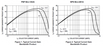

If you consider thermal issues and getting the output devices biased at optimum ft I wonder how useful the Oliver bias point is in practice.
Most datasheets for transistors suitable for audio power amplifier output stages that I have seen, graph an "optimal ft" in the region of several amps Ic. Unless there is some other meaning to your post which I am missing, a consideration of the thermal issues resulting from that much current would generally render such biasing impractical.

I simply meant more ft not peak ft, and by thermal issues I meant the 26mV number is directly proportional to temperature so at high dissipation it's the wrong number. Just saying maybe biasing a 100W amp at 50W quiescent is a better deal. The Oliver bias point has no use in IC's in general because the same emitter resistors are used to sense short circuit current and the 26mV makes the short circuit current limit too low over temperature.
But you wrote "optimal ft". In the context of a typical class AB power amplifier, how is there in any way a point of optimal balance between ft and the number of mV dropped across the emitter resistors?
Regardless of the number of mV dropped across the emitter resistors, more Ic = more ft all the way up until maybe three or four amps, at which point, for a 100W/8-ohm amplifier, we are approaching nearly an order of magnitude greater than 50 watts of quiescent dissipation.

I never made that connection, yes of course you can change the emitter resistor to match higher Ic but the 26mV number is for the output devices operating at 300K not their actual quiescent temperature.
As for optimum ft I simply meant having the speed of the output devices as an independent handle on frequency response and stability with no regard to the implications on the open-loop transfer function.
