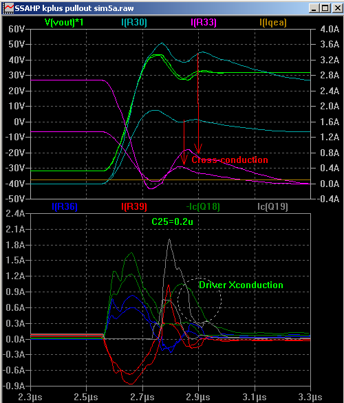

As for non-switching circuits I can't get them to slew safely at anywhere near the speeds of most amps today and this means worse dynamic XOD. I developed a charge pull-out method for my CSD (Current Source Driven power stage) amp which included a non-switching bias. One problem I had with the pull-out circuit is the capacitors to remove transient base current can be adjusted to work for normal loads but isn't right for no-load or vice versa since charge changes with load current. It appears that the charge pull-out process needs to be under very-fast negative feedback to work well with different loads -- and that's one reason why the Locanthi-T arrangement works well.
Now to AndriyOL's amp. I found the SSAHP pull-out current can go as high as 1A with a 4 ohm load and 100ns rise-fall time squarewave. The circuit I used (sim5) has a Locanthi-T resistor of 12 ohms giving a driver bias current of 120mA and each driver dissipates 4W, nearly as much as each of the 3 power transistors idle dissipation.
This gives 700V/us slew-rate that is high enough to deliberately provoke cross-conduction to analyse what is going on, and then to see if cross-conduction can be reduced. Note: with a rise/fall time of 500ns the cross-conduction currents are well controlled and safe and peak pull-out base currents are then 300mA.
There is also a shunt R+C (0.8R+1uF) across the Locanthi-T resistor which provides 10 times the peak pull-out currents than just a 12 ohm resistor because the Locanthi-T resistor swings about 1.2V swing and with 12 ohms the pull-out current is limited to 100mA.

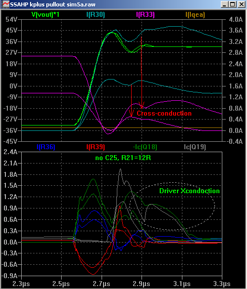

See the first attached plot for the original (Sim5a attached) showing:
Top traces, the power transistor emitter currents (one of 3 in parallel),
Bottom traces, the driver transistor currents (Q18 upper driver). R36,R39 are the net base currents to the power transistors (R36 upper, +ve is pull-out current).
The tail region has ringing with a protracted time of cross-conduction (300ns) in the power transistors (1A) and also the driver transistors (1A) -- again this only occurs when the squarewave rise/fall times are less than 300ns.

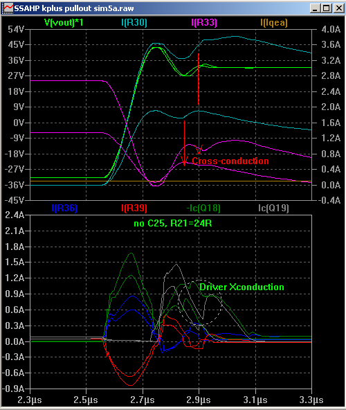

The second attached plot shows the effect on the cross-conduction currents when the Locanthi-T resistor (R21) is increased to 24 ohms (by opening jumper X1). The driver cross-conduction currents in the tail end is reduced slightly, not increased as might be expected. So does this resistor need to be so low? And what is the cause of the drivers' cross-conduction anyway?
The third attached plot shows the effect on the cross-conduction currents with the same 24 ohm Locanthi-T resistor but now a capacitor (C25 0.2uF) is added to couple the two bases of the CFP driver transistors (Q18,Q19). I know this is not recommended due to power rail ripple injection, but it serves to uncover the main reason for the drivers' cross-conduction. Both the driver's and power transistors' cross-conduction reduces with this capacitor due to faster charge pull-out of the driver's. Notice the two base currents are now working as opposite phase. There is still some cross-conduction in the driver currents but is less and decays faster with C25 added.

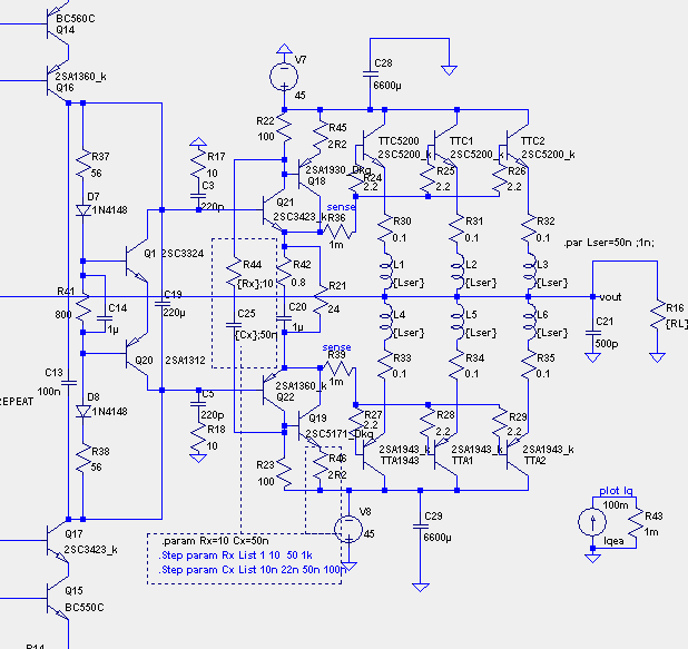

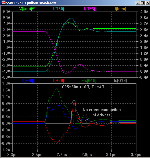

Optimized CFP speed-up capacitor
A bit more simulation to optimization of C25 gives 50nF +10 ohms when the Locanthi-T resistor is 24 ohms. I also found adding 2R2 degeneration resistors in the drivers helps to reduce cross-conduction.
The attached plot shows driver current and base currents are now well controlled with no driver cross-conduction with 4 ohms load, a 100ns input step and the same compensation as before. Now with only 50nF +10R between the driver bases the danger of damaging the bases is probably not an issue and power rail ripple injection is quite small at 20kHz.
So it looks to me like a worthwhile modification unless someone can show why it should not be used.

...AndriyOL, it would be nice to be able to add C25 to speed up the CFP transistor's turn-off and greatly reduce the problem of driver and power transistor turn-off for worst case situations ...

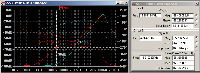

R44/C25 will cause rectifier pulses and load surges from the output transistors to modulate the driver slaves. This could have variable unintended consequences depending on board layout. If you do this I would suggest feeding the driver section with an RC to reduce the influence of the output transistors on it's supply voltage.

Keantoken's concern (Post 626) is "rectifier pulses and load surges from the output transistors to modulate the driver slaves" so I did a simulation to check the PSRR 1) before adding C25/R44 (50nF +10R) between the driver bases, and 2) with C25/R44. At 20kHz there is 30dB less PSRR (first attached plot).

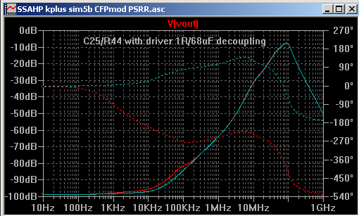

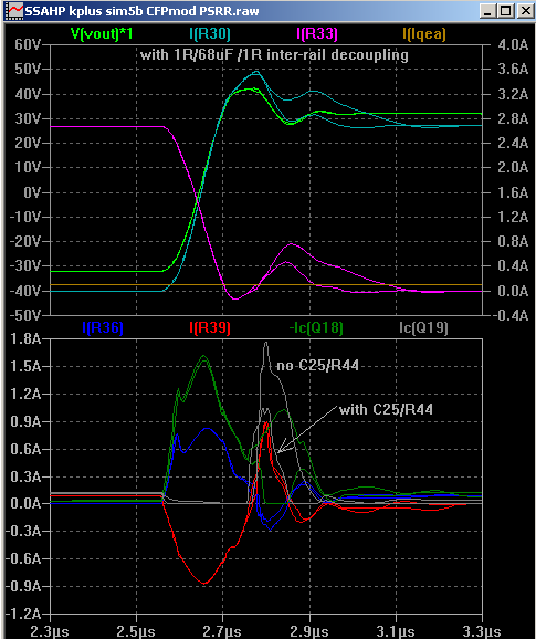

To get the PSRR back the same as without C25/R44 I added 1 ohm resistors in the emitters of the drivers and ran another cross-rail capacitor (C26). without C25/R44 is the minimum needed to stop the PSRR being degraded (second plot). The third plot shows the circuit.
The last plot shows the difference of cross-conduction with and without without C25/R44 and with 1R/68uF decoupling (as previous post worst case with 4 ohms and 100ns input step, and two 220pF+10R comp).
Notice, in particular, how the power transistor turn-off tail is reduced (IR33), simply by making the drivers turn off faster with less driver cross-conduction.
If this works in practice then it means it is not necessary to stop the ringing by using more compensation, nor is it necessary to add an input filter to keep the slew rate low enough to stop excessive cross-conduction. If this works in practice it should be safe enough to test your amp into 4 ohms and drive it to the rails at 100kHz, something that few bipolar power amps can do without overheating from cross-conduction. Here's for hoping.

Hi keantoken,R44/C25 will cause rectifier pulses and load surges from the output transistors to modulate the driver slaves. This could have variable unintended consequences depending on board layout. If you do this I would suggest feeding the driver section with an RC to reduce the influence of the output transistors on it's supply voltage.
Thanks. See Post 627, it covers PSRR tests and a way to filter the rails so PSRR is not degraded by C25/R44.

There is quite a lot of added complexity in the circuit. The most straight forward way to deal with the base charges in the outputs is to get the CFP units to work independently in push-pull this is not happening because the first transistor in each CFP receives a emitter signal from the second and from the cross-coupling to the opposite half CFP.
Who would not have trouble listening to three conversations at once.
In short the first transistors in each CFP need a resistor inserted from its emitter to the collector of the second transistor. The cross -coupling between output halves needs to be fixed at the collectors of the second transistors in each CFP pair.
The attached simulation illustrates how this is was done by a well respected manufacturer.
Mjona,There is quite a lot of added complexity in the circuit. ....
Thanks. I tried adding your 15 ohm resistors in the emitters of the pre-driver of the CFP and the 2R2's in the emitters of the drivers and without my C25.
Cross-conduction peaks in the driver's are not reduced and the recovery time is lengthened.
Maybe the 15 ohm resistors in the emitters of the pre-driver's that you saw were for solving a different issue of the CFP?

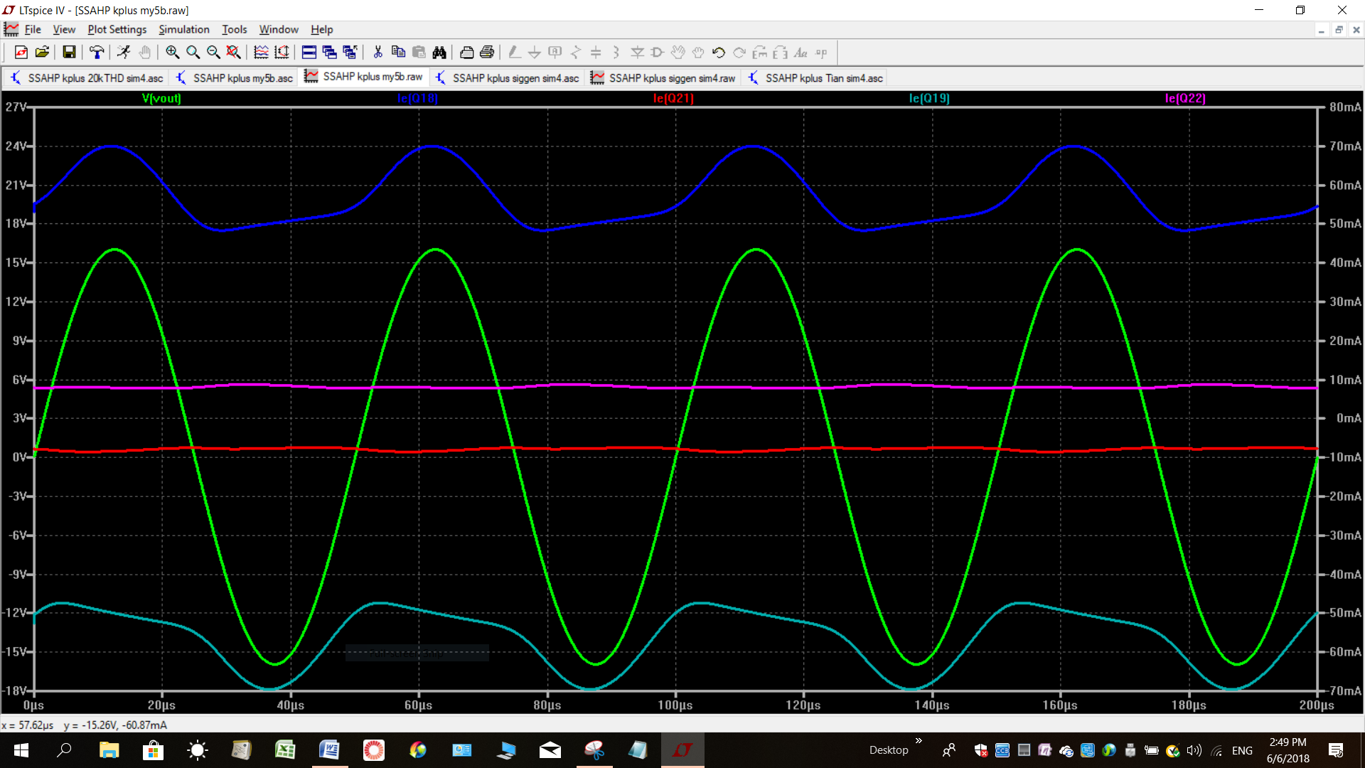

I looked at the CFP emitter currents for your circuit at 16 volts peak out and noted something odd with Q18 and Q19 voltage levels.

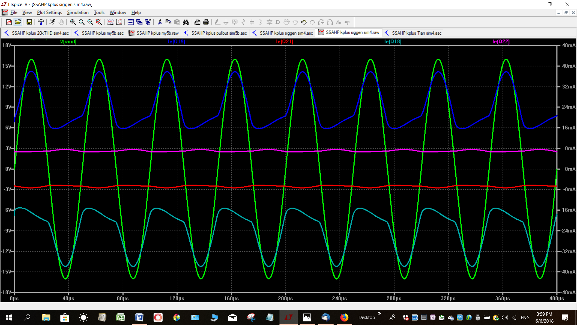

The test signal was at 20 kHz.
The modified CFP equivalent is attached. I have made a couple of changes to improve the symmetry - increasing the output transistor emitters to 0.33R and decreasing the Iq to reduce heat dissipation - an issue which AndriyOL is becoming concerned over.
Mjona,
