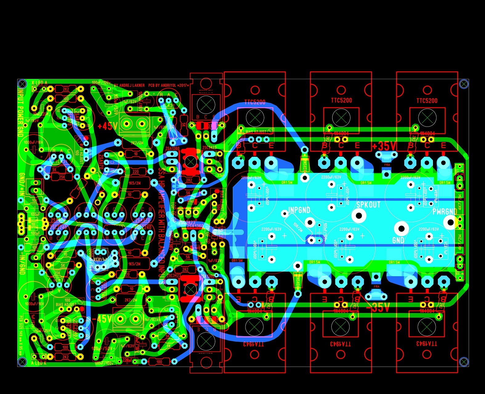

I don't know if there is salvation for your boards but they may still serve a useful purpose to see if the compensation method suggested by R Dijk has any impact.
While you have concerns about board layout - apparently over a wide area looking at your prototype I have a memory of seeing something like this illustrated by Nelson Pass in his A40 amplifier that could only be described as a lash up albeit this was a prototype for a cleaned up version.

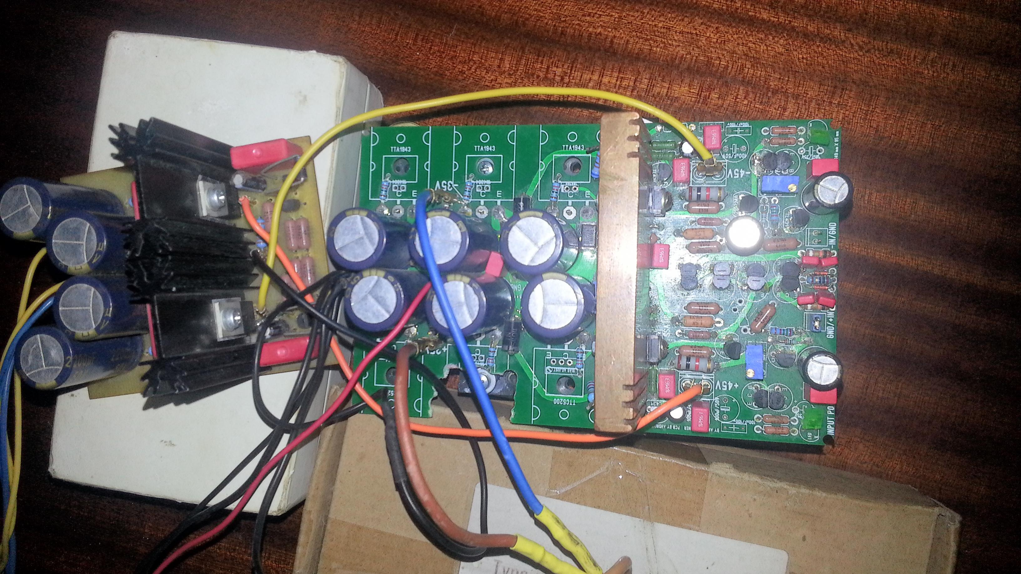

It is not clear still if you are using a safety bulb or a variac to reduce the supply voltages but you can run the whole amplifier for a test with 5W 100R serial resistors between the supply and the board - just using the larger transformer and its' supply.

Part of the set up process involves setting trimmer for the appropriate level of output stage Iq by measuring the voltage drop across the 5 W resistors shown in my simulation between the supply rails and the circuit itself. The current draw can be calculated from the voltage drop across these resistors from Ohms law. For example a 10 volt drop equates to 100 mA.
If the circuit is stable you should be able to reduce the current drawn from the supply to a level that would be safer to remove the resistors and apply the rails directly.
The circuit board outline shows where the trimmer is. In your actual hardware I see a capacitor which is smaller than the other trimmers so it has to be absent.
If you have replaced this with a resistor for a current drawn by the output stage of roughly 500 mA as indicated by some simulations. That could explain a few things - so you need to see this is not the cause of your problems.
Increasing the trimmer resistance will reduce the Iq and if you have a resistor instead of a trimmer you can even cut the end of one lead to reduce Iq.
Keep a finger on the body of the 5 W resistor and the other on the power switch. If you feel this rapidly getting hot as in a surge turn the equipment off immediately.

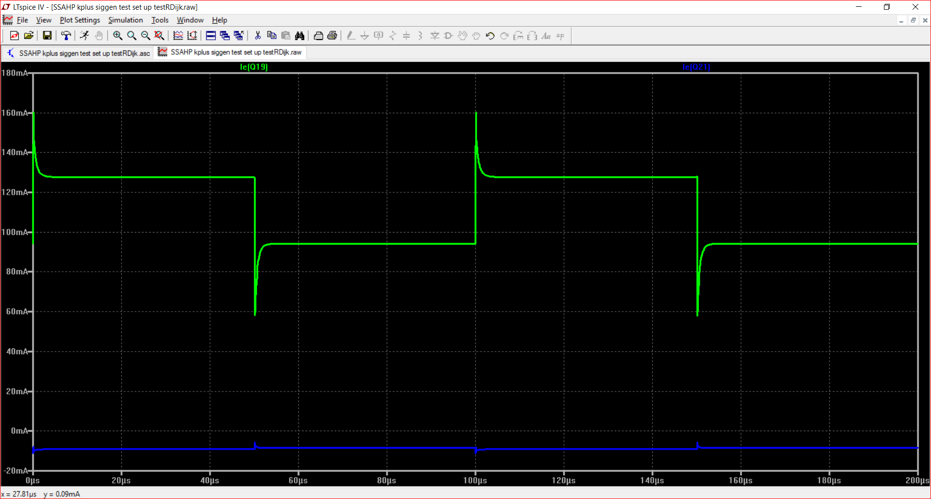

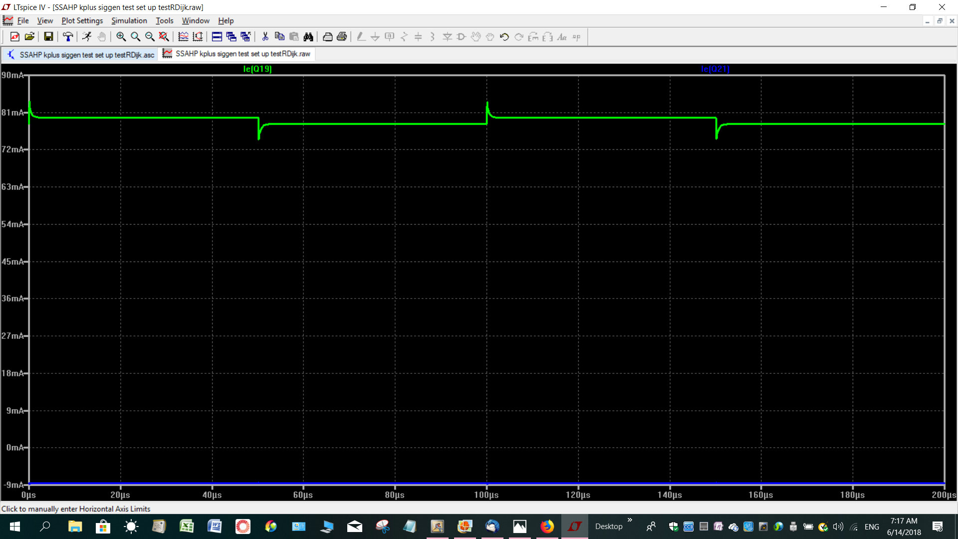

Obviously, Ft of the BJT transistor isn't the same as switching speed, which is the sum of Delay time (td), Rise time (tr), Fall time (tf), Storage time (ts) Limiting factors are parasitic capacitances, inductance and operating conditions. So, smaller transistors should be faster than bigger ones.It seems that drivers are usually slower than pre-drivers (is it due to die size?).
FETs are faster and perhaps can be advantageous in this regard.
Agreed. Here's perhaps a better way to speed-up the CFP driver's turn-off. Reduce the value of the driver's base-emitter resistors.
With 25 ohms they turn off as fast as my previous base-base capacitor method. And there is no rail coupling issues with lower base-emitter resistors. But the pre-driver now dissipates 4 times the power.
To keep the simplicity, I suppose 1W Pd with heatsink should not be a problem.

The trimmer is behind the heatsink 10K, as I wrote before. 500R was too low. With 10K trimmer setting and 4mA input bias I have 2.5mV on output emitter resistors
If you are still using the safety bulb test method try measuring some base to emitter voltages which should be roughly 0.6 volts to see where the shortfall in conduction is - quite likely it will be wide spread.

Nice simulation - an ideal model in my view.
Looking into this - two plots attached show 1. square wave in test set up minus parallel capacitor to the load first in test set up and 2. at high power.
Others should note the switching time for Q19 as compared with Q21 which has more to do with the amounts of emitter current than comparisons of transistor speeds.

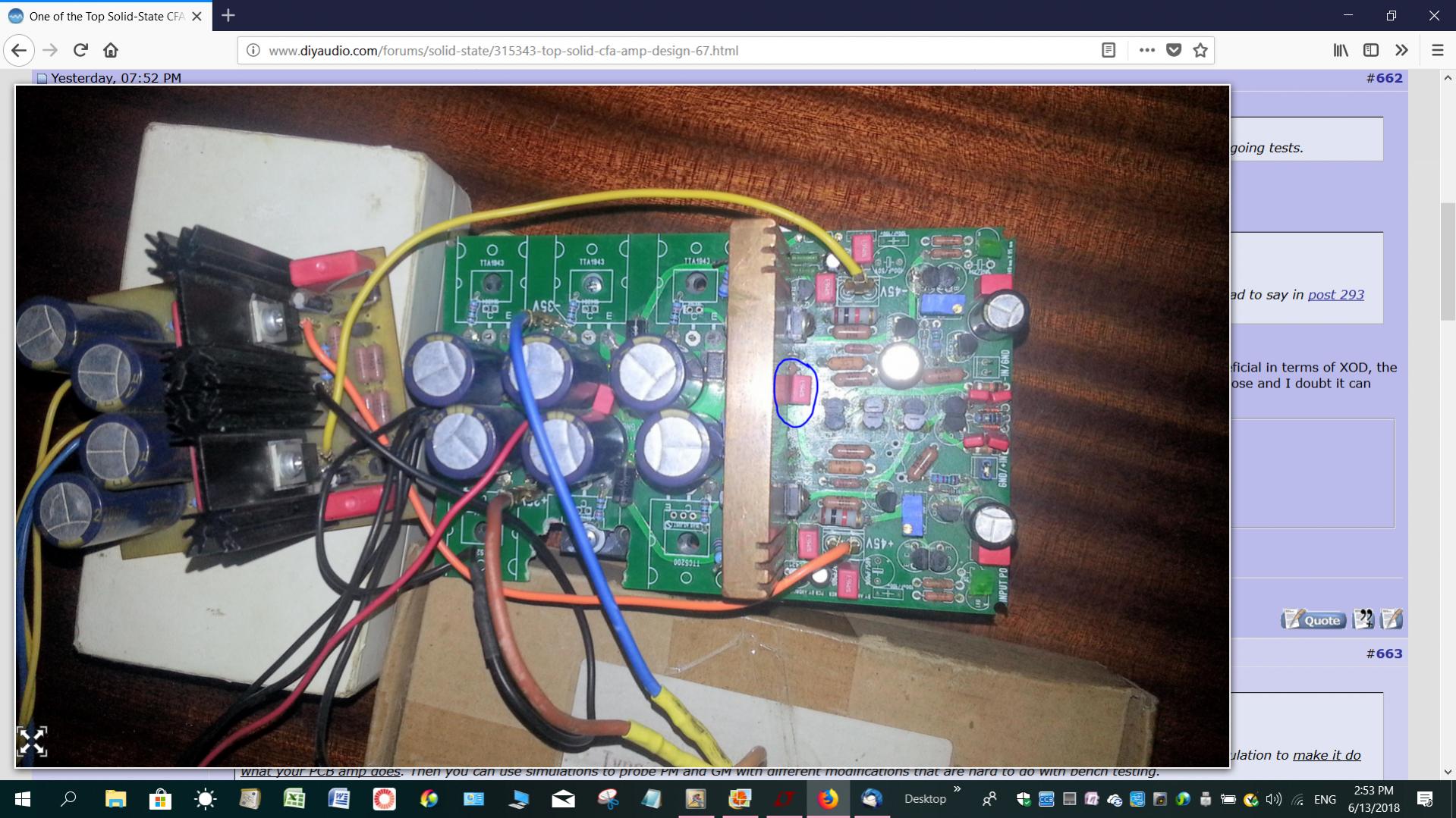

Input bjts have 0.560-0.567V, small VAS bjts - 0.62V\0.627V, bigger VAS bjts - 0.65V.
With 3mA input bias the differens between PSUs 10V, with 4mA bias front end voltage sags to the same voltage as at output.

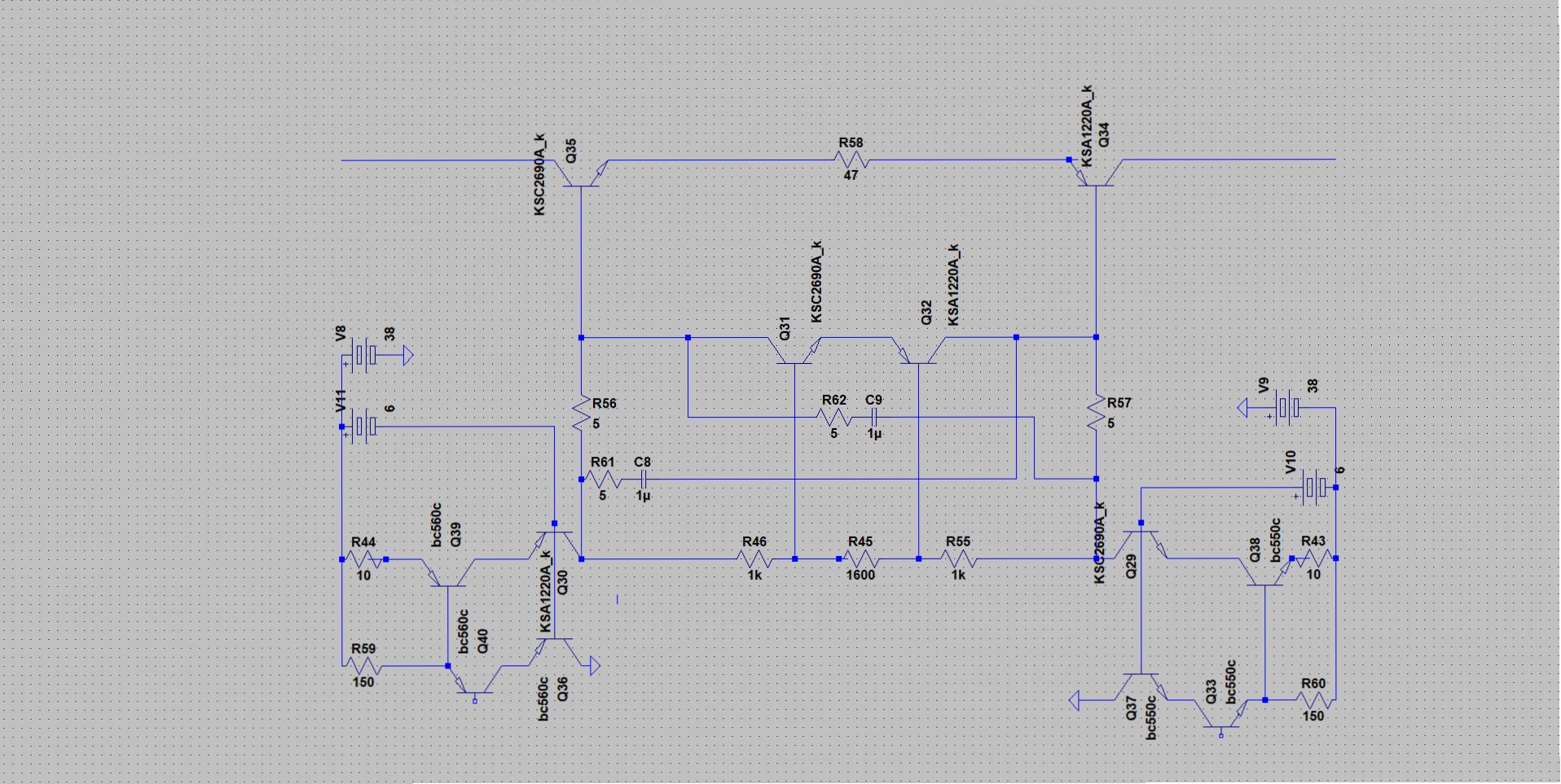

Mentioning current sorces!!!! They are part of your circuit problems.
The collector emitter capasitor in the current sorces ( Q27 and Q28) is here making for an oscillator as it "delayes" the feedback.
Putting at least 1k in series with your current sorces will help a lot.... SoOOO i mooved them to the rails.
On 5V zeners should there be 5V drop from initial voltage or 5V on output of zeners? I'm using tl431 instead of zeners.
The TL431's contain an op.amp and have a bias network around them to work as shunt diodes.
It is possible in your set up mode a restriction of supply current is is having an effect on the biasing of the TL431's - reduced current flows through whatever resistor network you might have set up.
Your transistor measurements suggest these are in working order under current restricted conditions and that the output stage is hogging most of what is available.
If you don't have enough emitter current that means less base current and less Vbe.
Your measurements are close but not quite where they need to be.
