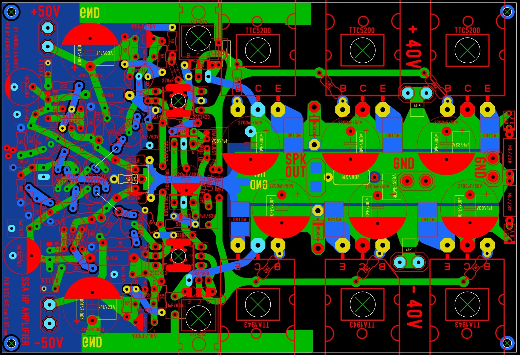

ur'e shure the psu is wired like this? see att.
I find that redusing R5 and R6 should give more "LED bias".
Yes, I checked it. The pcb layout corresponds to this schematic.

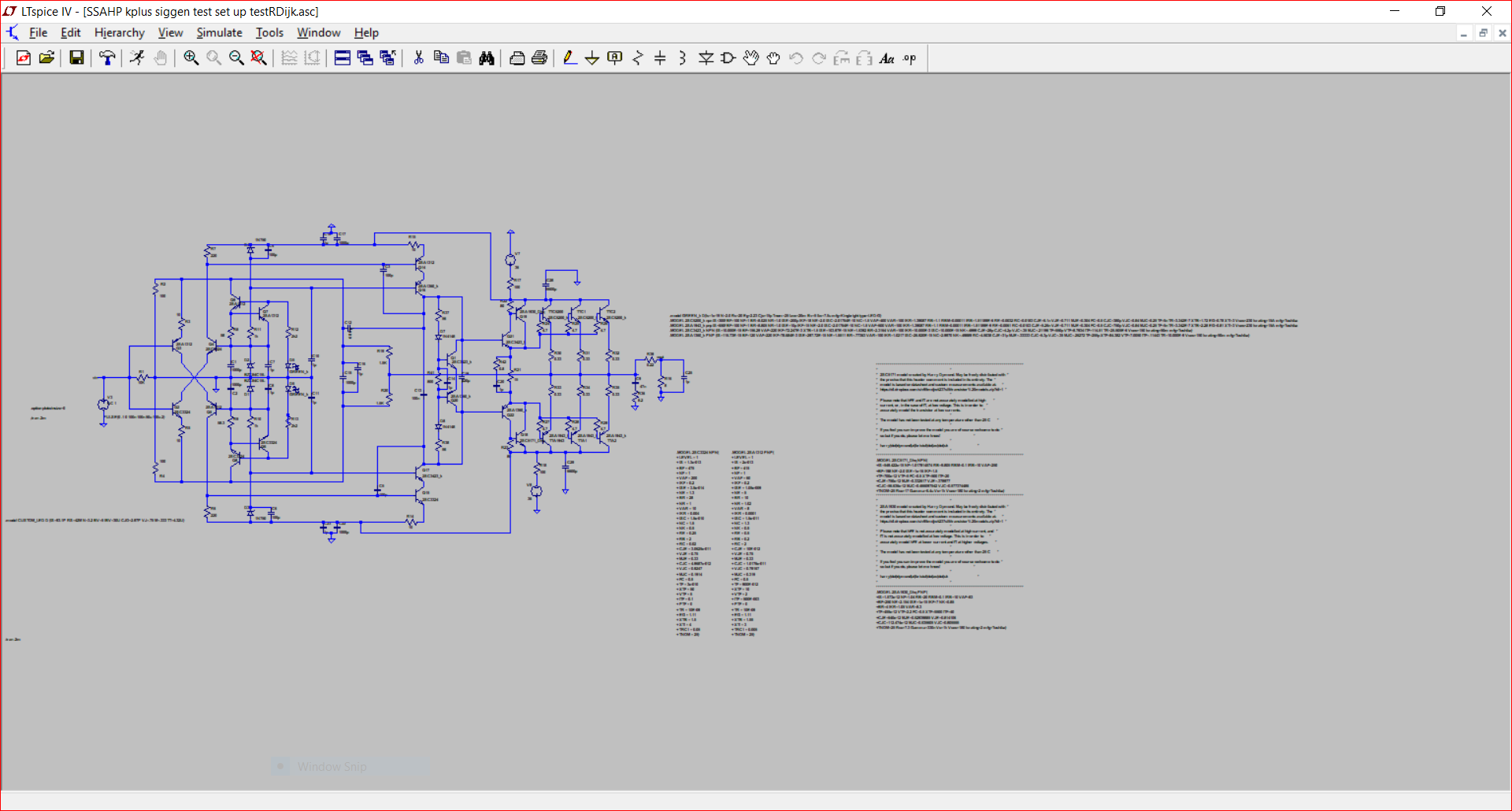

Simulation in my case lies about bias current and stability.

For the amp circ it seems like you are looking for a contact fait at the same time as dc ofset varies so much as you type her.

Do you mean there could be a contact failure in the pcb or psu? I'm 90% sure that power rails contacts are firm and reliable, OP tr-rs soldered well, but I will check.For the amp circ it seems like you are looking for a contact fait at the same time as dc ofset varies so much as you type her.
Yea somthing like a contact fault, but can bee almoust anywhere, even local oscillation may happen in som designs measures like dc with a multimeter...

I think the trouble here is to find out proper compensation method, but first I have to make new pcb for this SE schematic, as every layout requires its own compensation places and values. I almost done it, still left to refine it, remove some drc errors. I can show it for basic estimate.
I don't know any CFA design threads. I've read before SSA thread, but it wasn't about design.

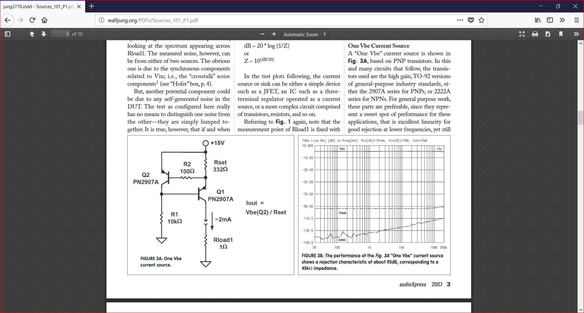

R Dijk's mention re Constant Current Sources prompts me to refer you to an article by Walt Jung on this subject where various types are considered. I have illustrated Jung's approach to the two transistor type which includes an additional resistor to ensure stability. For a fuller explanation you can follow the link at the top.

Notice the smal changes and how muct it affects frequency responce.....
Pleace notice it is NOT renamed.
Yes, very big difference from compensation capacitors placing change. R36, R39 have very little effect on frequency responce.
Why have you added C13 and changed R37, R38?
Why do you think there is such high discrepancy with my measurement results and simulation?

The placing of compenssation was my point, and has the same placement as the first i showed when you did not get it stable.....
Whatever ... C9 and C12 now has the correct placement.
I added C13 to avoid anny discrapency between C3 and C5. and the possible influence on bias and freq induced dc/bias if C3 is not equal to C5 and R17 is not extactly R16
I belive its enough with 2 point measurment, they also measures inviroment.
I changed R37 R38 to giv the it more sensitivity to temp cause two diodes are removed to avoid unwanted temprature (read bias) swings due to termal delays and multiple measuringpoints. here R37 R38 may bee high.

The simulation in post 773 shows that at -180 degrees where the gain margin needs to be below this one shows the gain as 5dB so there is no stability margin.
That in post in post 775 is somewhat better since there is some gain margin of - 6dB and a phase margin of -32 degrees.
One of the problems in approach common to both is the strategy of adding compensation capacitors in two circuit locations.
The notion of a single dominant pole will be compromised if the main choice is less than 10 times greater than any others.
Thanks for your clarification. I missed that you removed the diodes, but then there are 3 resistors in series. if so, can only one trimpot suffices?
Just noticed you shifted C13 from VAS collectors and reduced C20. Will try all on board.
