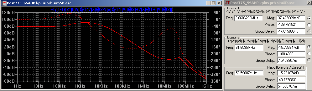

The simulation in post 773 shows that at -180 degrees where the gain margin needs to be below this one shows the gain as 5dB so there is no stability margin.
That in post in post 775 is somewhat better since there is some gain margin of - 6dB and a phase margin of -32 degrees.
One of the problems in approach common to both is the strategy of adding compensation capacitors in two circuit locations.

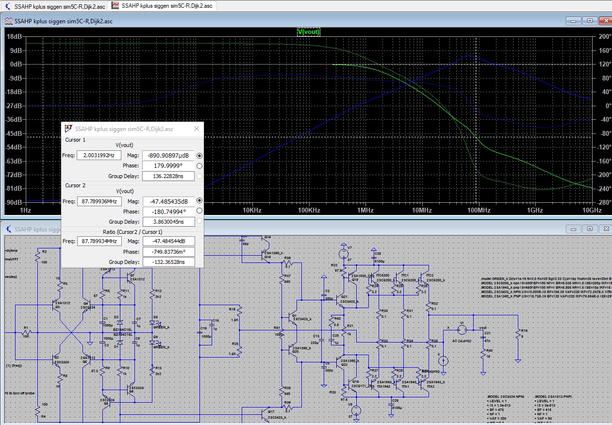

Before it was stable with enough margin in simulation, according to Ian post: One of the Top Solid-State CFA amp design, but not in reality. However I changed some resistors in OP stage.
Did you measure it PM with Tian probe?
Your offer is to use C12, C3, C5 as in post 668? What do you mean by 'any others'?

What I meant was to pick the most natural pole in a circuit and make it ten times greater than any other pole in that circuit.

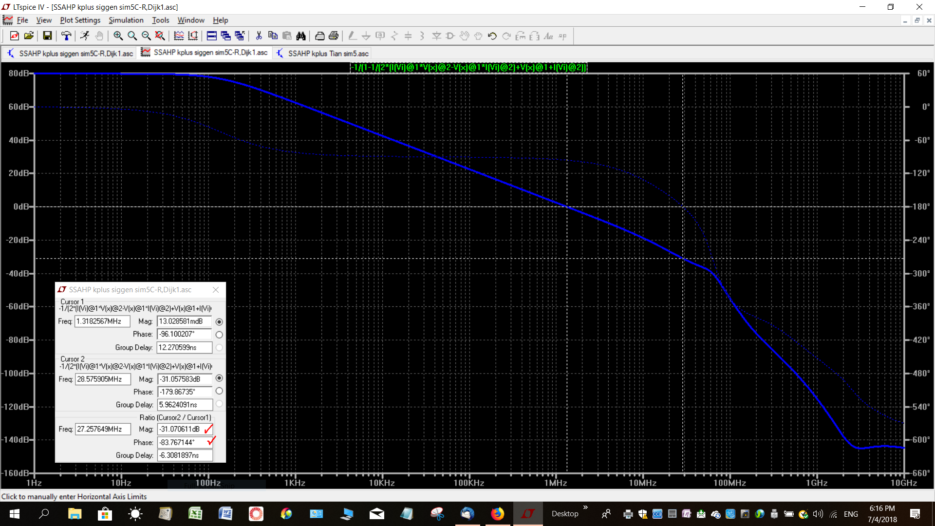

I have not tested the circuit in post 668 by the Tian method. Your results are too far off what the simulations suggest to be doing that when things are so unsettled.
C12 is in a position where it is in parallel with the impedance of the feedback network so it bypasses any change in phase due to the output stage.
Try 680pF there and if that doesn't do it increase the value to see where this gets you. Re C3 and C5 don't increase the value above 100 pF.
I was referring to your post 778. You wrote there was not any PM. So I'm curious how did you measure it?I have not tested the circuit in post 668 by the Tian method. Your results are too far off what the simulations suggest to be doing that when things are so unsettled.
This is not my result, Ian suggested the circuit had 60 degree PM.
You would do well to take more control over direction by doing your own Tian simulations. Don't use the simulation method in posts 773 and 775.

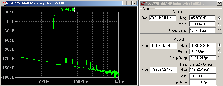

Second thoughts. Turns out the THD without these capacitors is slightly better! Seems the extra gain with the capacitors makes the VAS distort more but the extra 12dB gain from the capacitors does not fully offset this extra distortion. Interesting....100uF capacitors have been reintroduced across R14, R15 (VAS emitters) to give an extra 12dB feedback at 20kHz.

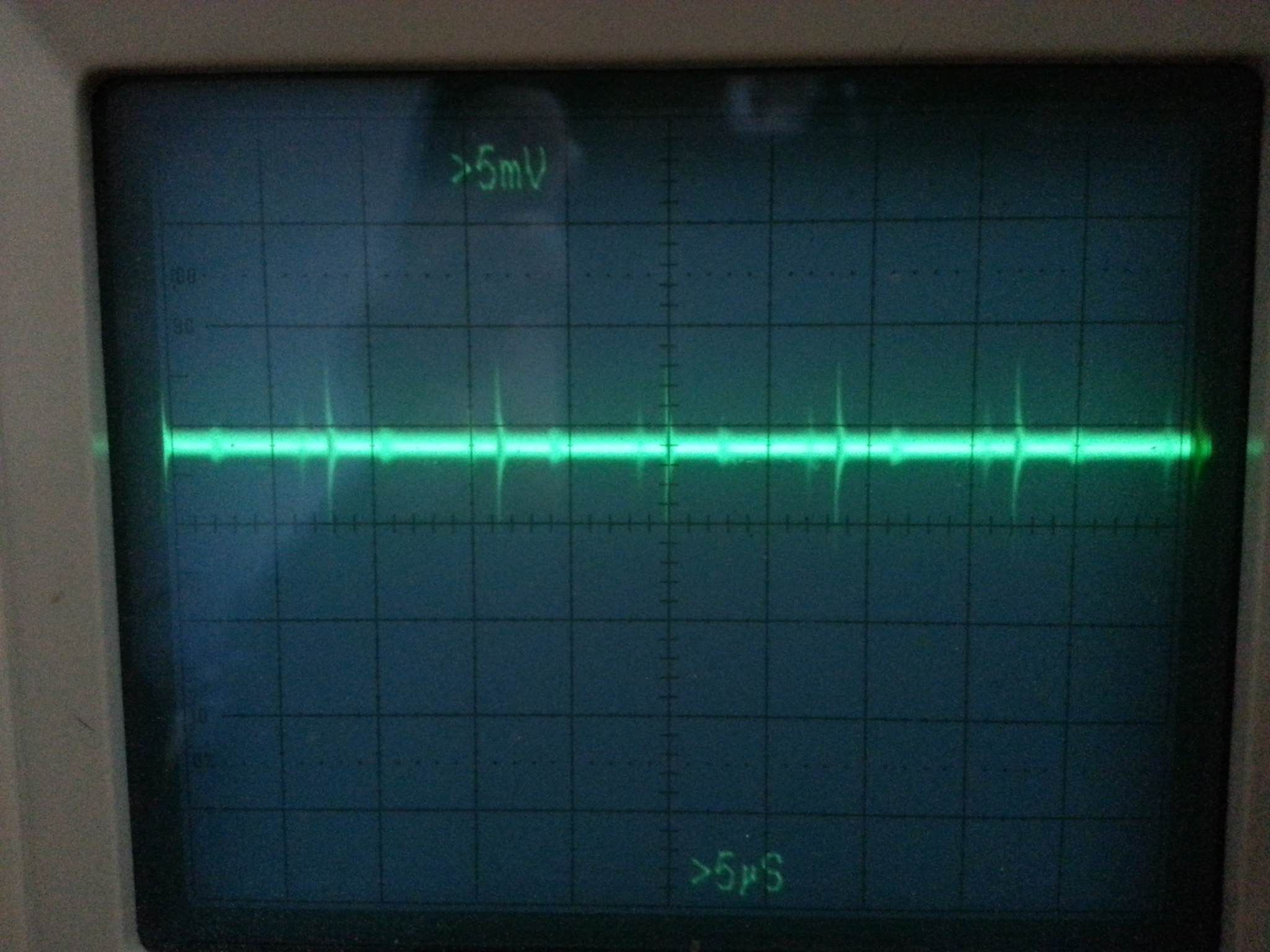

I tried with values from post 775. Them amp from the start have little instability which fades in a minute. Scope pics added.Well i suggested thiese values in an earlier post, then driving 1u...
So as a starting point regarding stab i suggest the same values as a starting point.
Also without C10, C11 the amp isn't stable. It must be with those 1uF caps.
I noticed the main contributors of higher THD are R39, R36, output capacitance C21 and the value of R22, R23 where higher value produce better THD, but little less stability margin. Also without C19 THD is worse, sim says, at least 100uF must be present.
For testing I'm using a bare sp driver with short cable, thus no any output capacitance should be expected. However I noticed the sound became a bit distorted or lower fidelity, I suspect because of R36, R39. DC offset almost hasn't changed.

Is this correct PM GM measurement procedure?

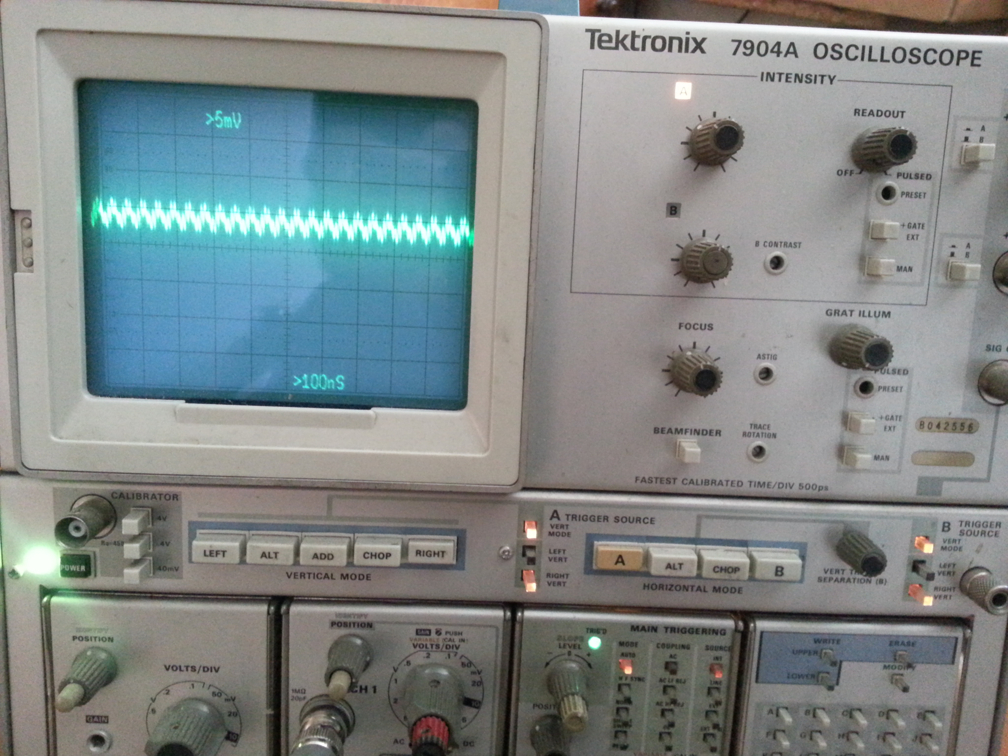

It is not clear if you are powering the amplifier with a direct connection to the mains. Whatever the answer is don't use a 1uF capacitor as a load.
The values of compensation capacitors in simulations don't allow for stray capacitance in the layout and it comes down to experimenting with values increasing these in steps and monitoring the results as you go.
You could try 100pF as your next step.
