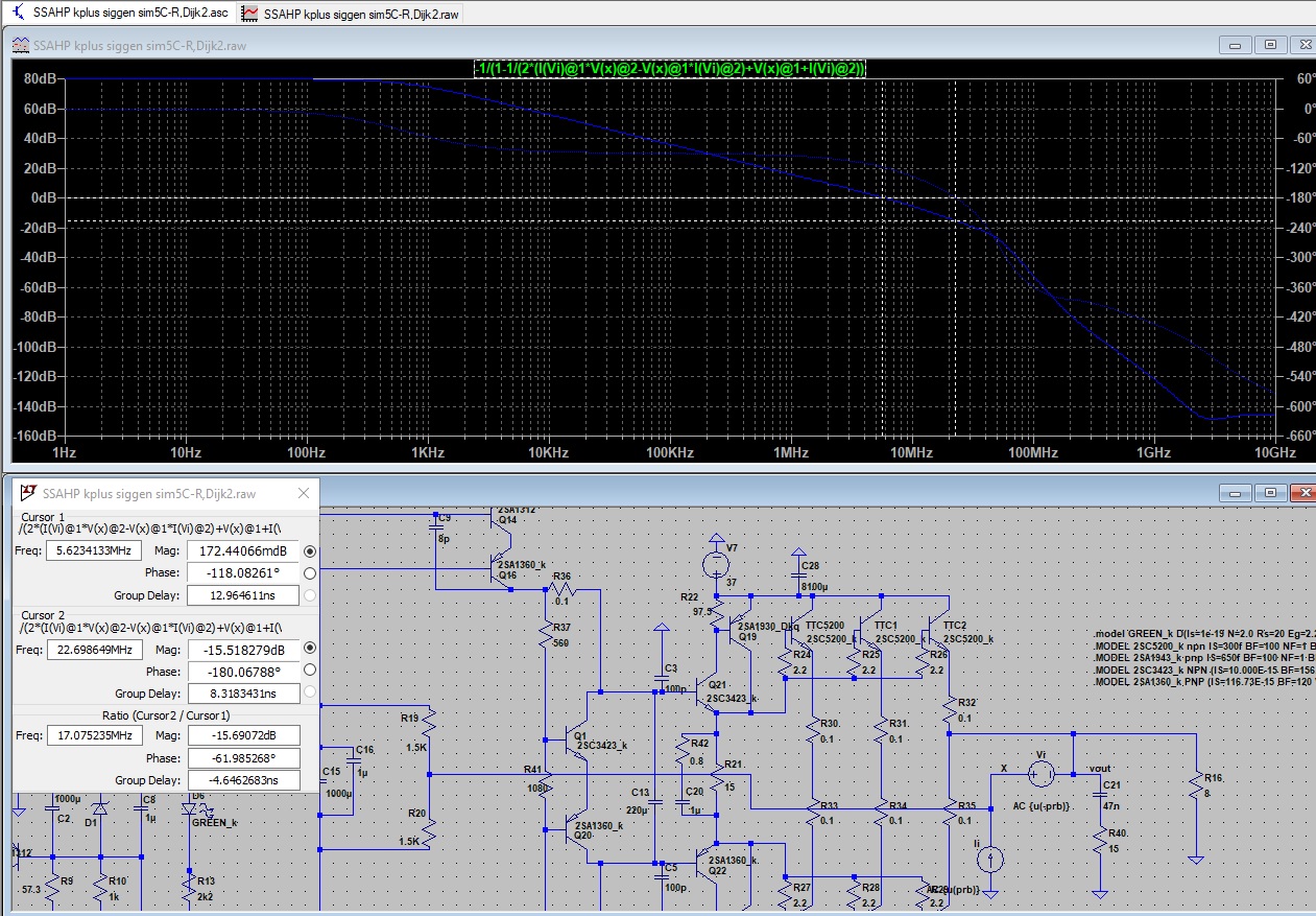

Is this correct PM GM measurement procedure?
About Zobel at the output, someone wrote here the amp should be stable in the sim without Zobel. I have it on PCB, btw.
If a 1uF capacitor is used for testing with the speaker, the proper cable itself can have 0.22R series resistance
For the purposes of the simulation make the 0.22R a resistor and not part of the speaker lead.
To make your simulation work copy the following expression and use the .op command to paste it somewhere on your .asc file as a comment
-1/(1-1/(2*(I(Vi)@1*V(x)@2-V(x)@1*I(Vi)@2)+V(x)@1+I(Vi)@2))
From this convenient access point you will be able to paste this in the title field of the .raw file when you run this. The title field at the top of the .raw field will be in green and read V(vout). Click on this and a dialogue box will appear - delete this and substitute the expression given above.
From there the same procedures you applied to set the cursors.

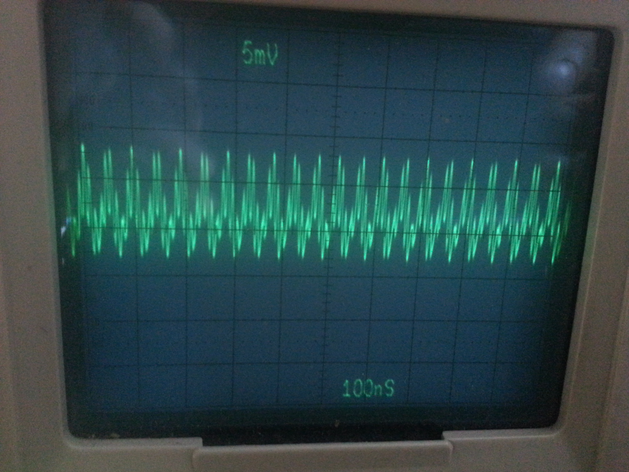

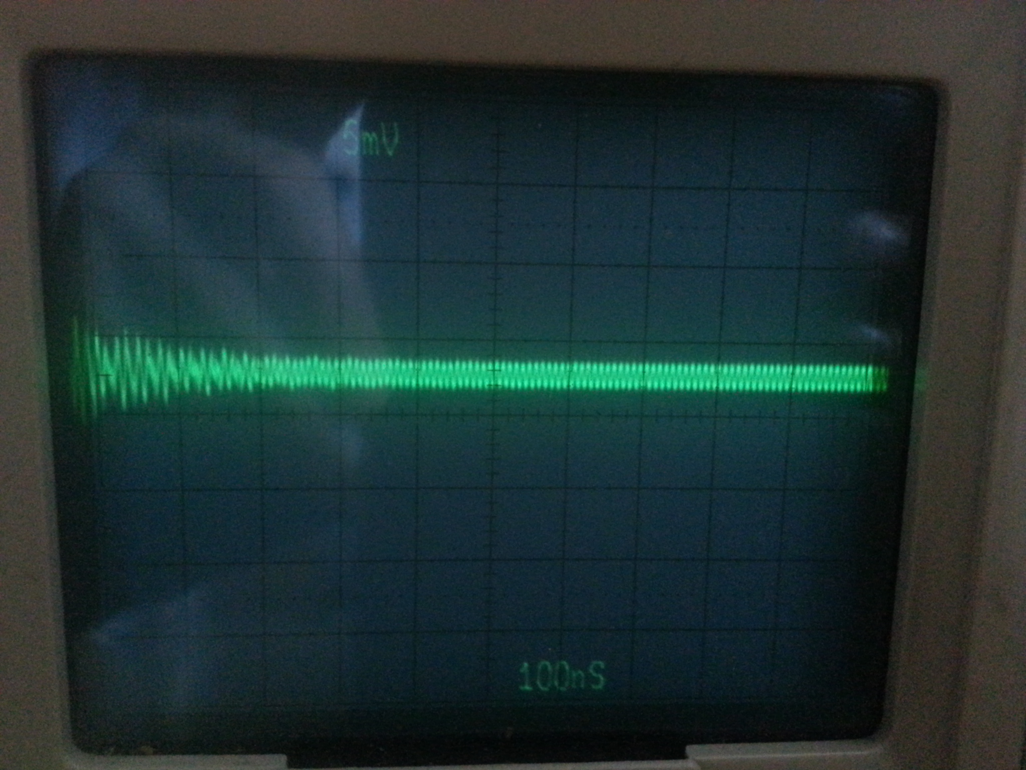

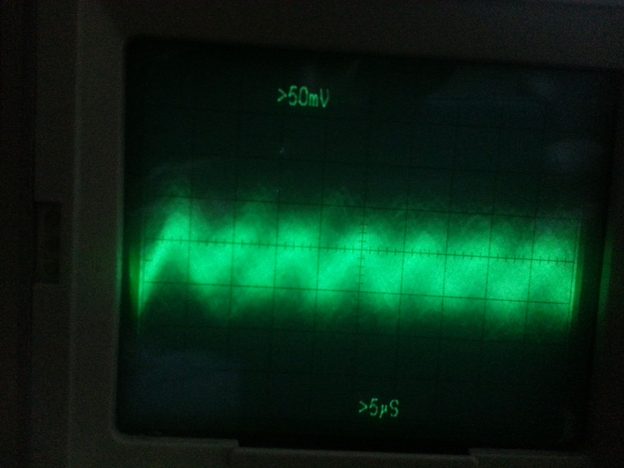

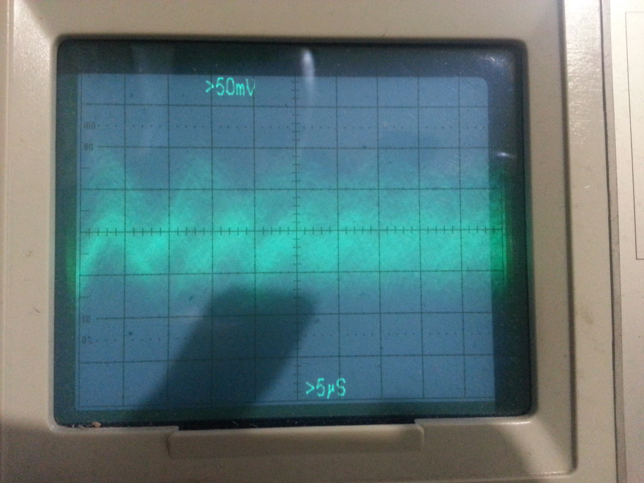

I changed predrivers' base compensation to 165pF and removed R36, R39 10 Ohm VAS collector series resistors (replaced with jumpers). With these caps the amp starts with scope's 10mV (2 rows at 5mV deflection) oscillation and -110mV offset, which (osc and offset) fades out almost completely in 5-10 min, when offset stabilizes close to zero. However when offset changes at least to -45mV due to forced aiflow on the IPS\VAS, osc. appears again and eventualy disappears after a couple of minutes even at -50mV offset. From this observation I can come to a conclusion that osc is highly dependable on thermal (or beta) disbalance of IPS or VAS tr-rs. Btw, my VAS and predriver TO-126 tr-rs aren't matched as small input ones, they have 160 vs 210hfe between npn and pnp.
What do you mean by this? I'm not using 100R 5W and I don't have such resistors to try.
Seems like 44p VAS compensation is enough. Perhaps I should try lower 30p value.

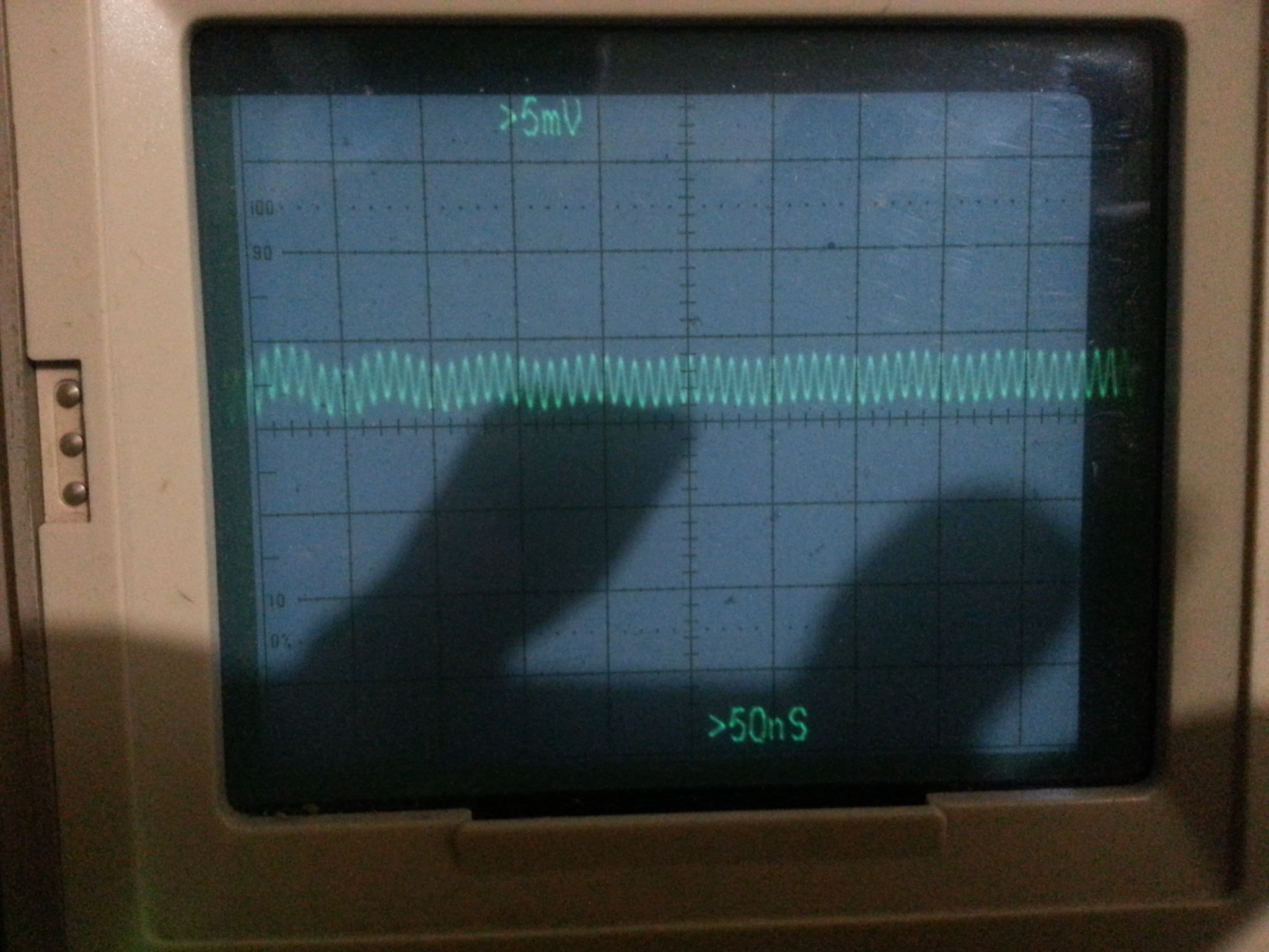

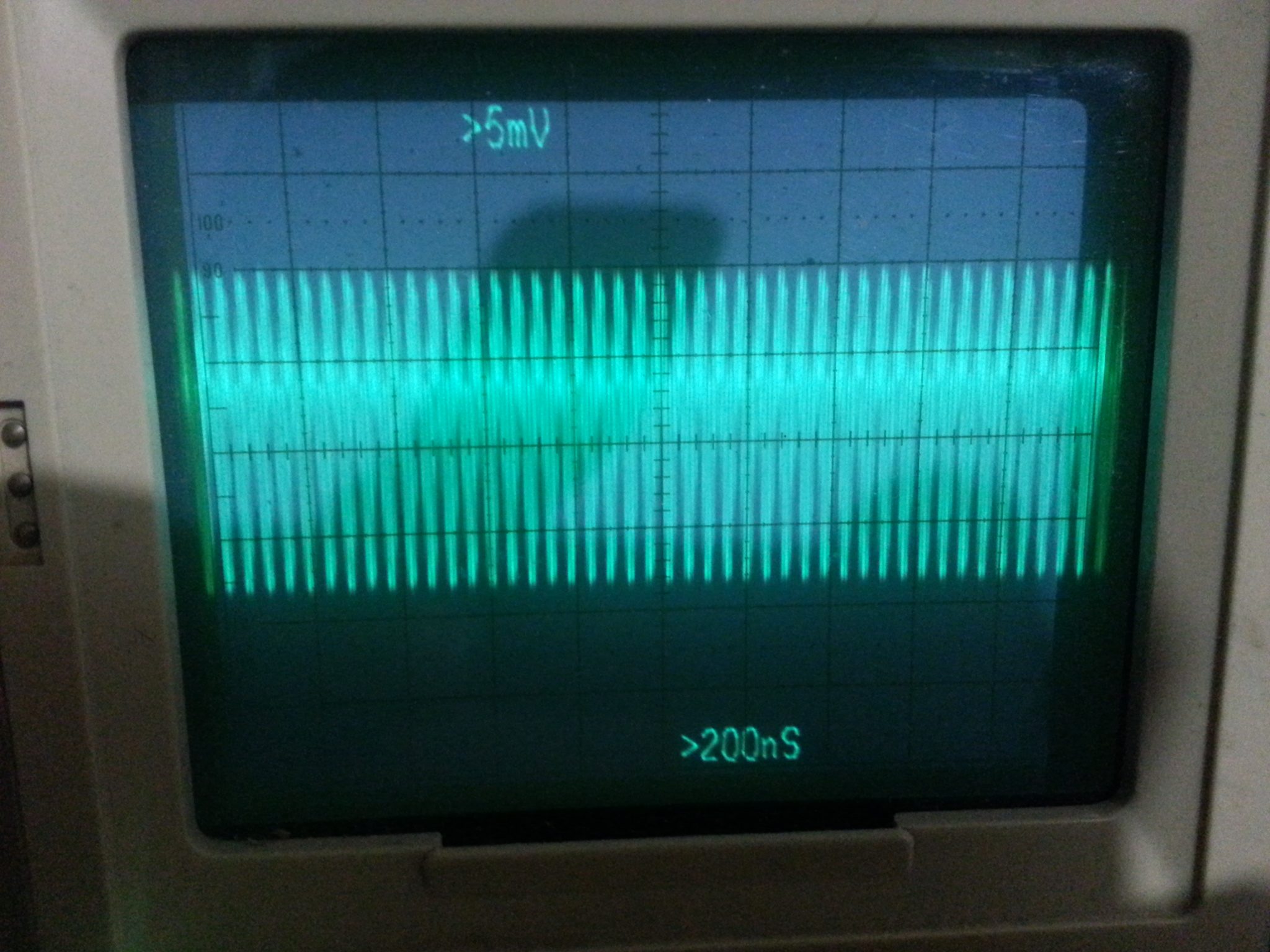

Is it safe to use the amp with such oscillation as I described and showed?
There are 15A SMD fuses on PCB just after terminal connectors.
You are still strugling with this ?I changed predrivers' base compensation to 165pF and removed R36, R39 10 Ohm VAS collector series resistors (replaced with jumpers). <snip>
And stable without load or signal.... ??
Have a nice "trial and error" weekend (???) unless you folow somthing already suggested.

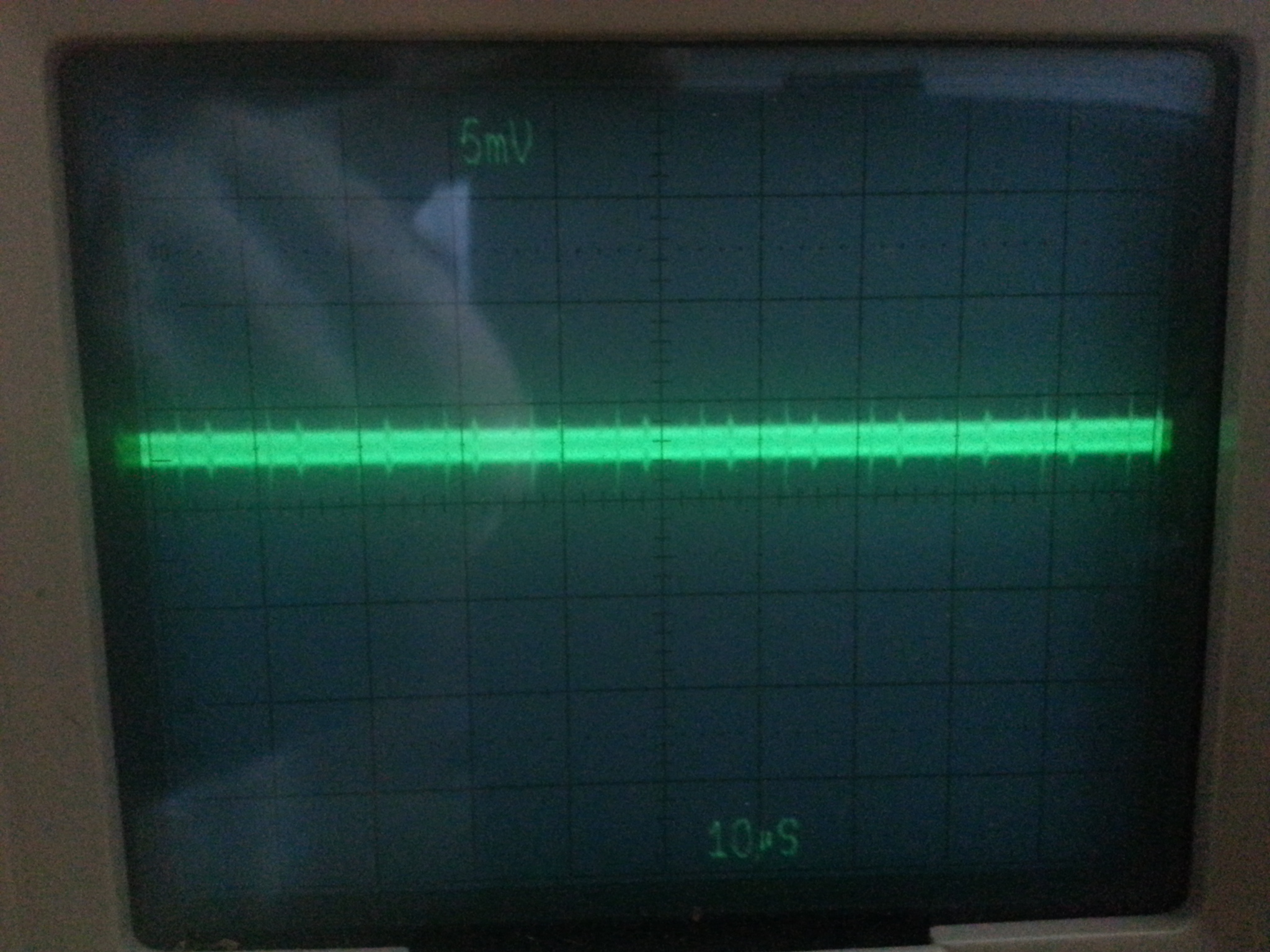

Not exactly strugling, but have a lack of understanding of current behaviour of the amp. Roughly I can say there is no osc, as it disappears in time, that means compensation works. I put back again 200p base comp btw. From other side, why osc appears at power on and with DC offset or tr-rs temperature (beta) change? Perhaps there is some tr-rs partial damage from overheat or overload. I don't have curve tracer to check.
With 4-8R load and without input signal.
Btw, I rebuilt the second channel exactly the same as this first one (with vbe multiplier bias current) and it's totaly stable at power on on the scope with stable DC offset.
I followed already sugested and chose the best out of it.
Anyway, taking into account perfectly stable second channel in my current conditions, we may consider the problem is solved.

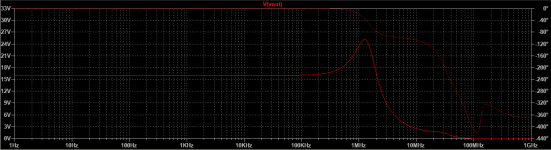

I tried to check the PM\GM with the RDijk file from post 786 and found 62 degree of PM and 15.7db of GM (where the lower limits are 60degree\12db) wih 100p base and 8p VAS compensation. Have I done it right? Does it difficult to check pm\gm in real circuit?
You have executed the graph correctly. There will be elements of stray capacitance in the layout that you cannot account for in a simulation.

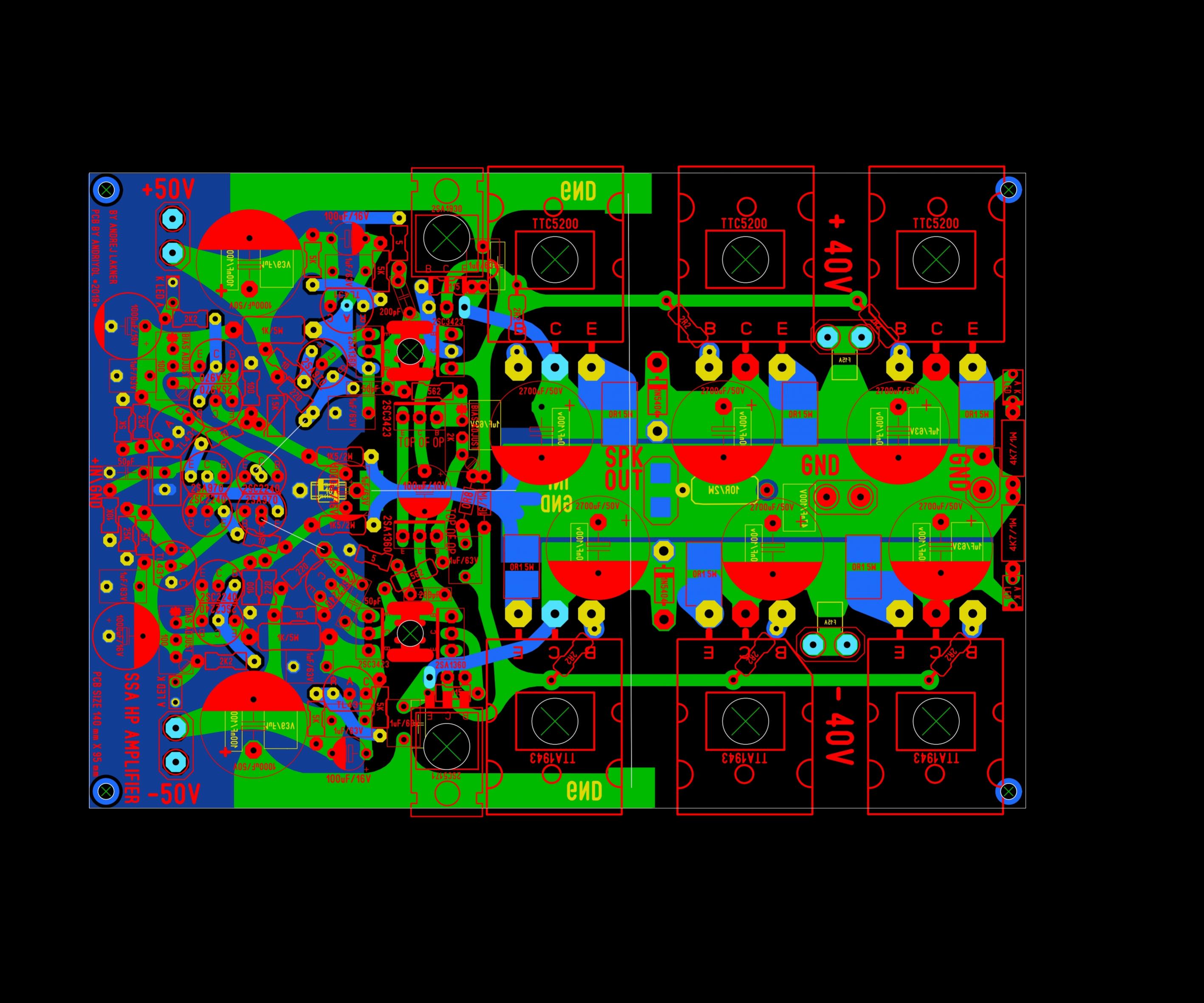

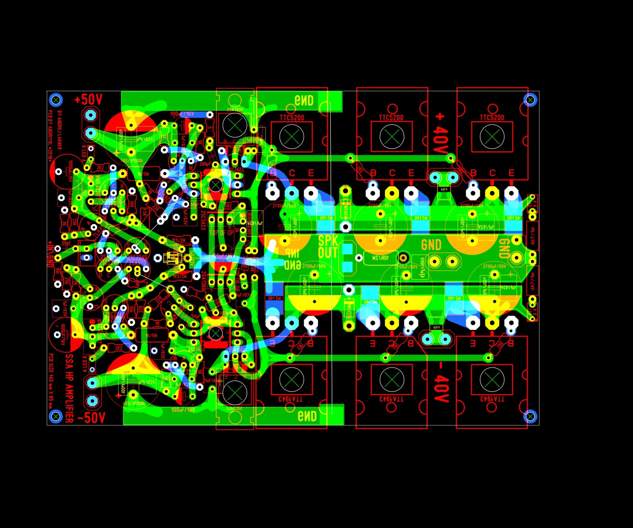

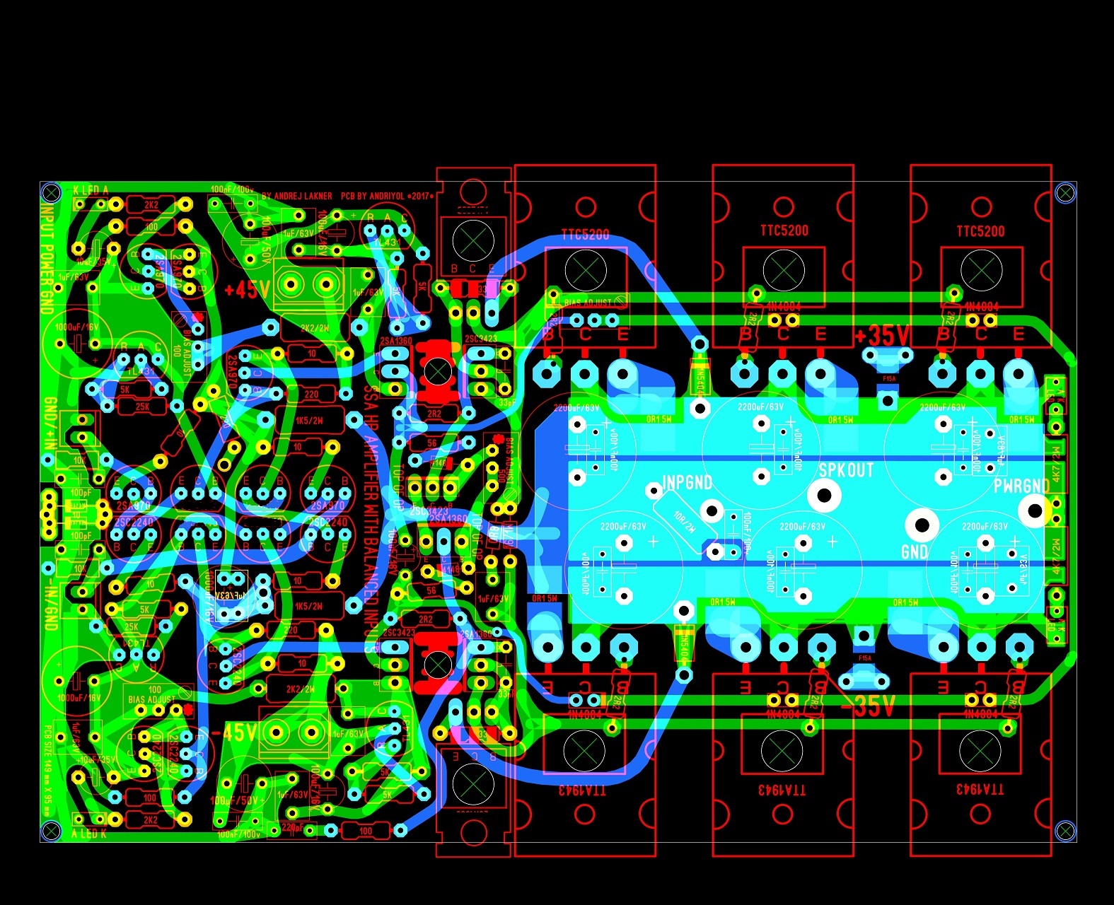

I've made a layout for this sim file. I added 10R GND resistor as per original schematic. There are two gnd planes, at IPS section and as output zone. One thing I'm not sure with gnd planes, as this is not visible in the layout, is how opposite layer components go through these gnd planes.
Comments and offers are welcomed.
I may believe that it can be true, but using gnd plane turns out with much compact and easier layout than if I route gnd tracks separately. It's beneficial in two points: simplicity and noise immunity.
In fact Douglas agreed as well gnd plane can be beneficial in post 115, as I understood.
Sorry, previous image was without GND plane, I thought I uploaded the correct one. Chris, please replace the image with this one. Thanks.

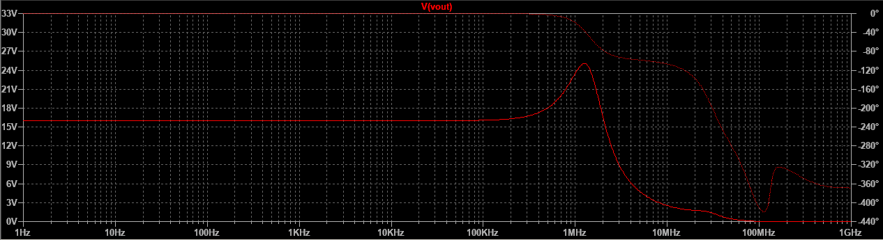

if you still have motivation, OITPC appears to offer up to a factor of ten lower THD at 20kHz but in practice there are likely issues hidden from us using our inadequate simulations so it may take a lot of effort to succeed with OITPC. But it would be nice if OITPC works well first try!
I tried this compensation but I left C13 as 320uF, forgot to replace it. The results are worse than with previous compensation. The amplifier is a bit unstable, I can only bias the input only to 3mA, likewise too much noise from the speaker. Here are the scope screenshots without input signal (first start up and couple of minutes run) and two with input signal.
Ian, have you checked that compensation for overshoot?
The phase margin is increased by the means of a resonance after the unity gain frequency. Are you sure the Q of this resonance will remain stable under dynamic conditions considering the Ft of the output transistors may vary 5x or more?
Furthermore this compensation provides a path for frontend rail noise to be injected directly into the VAS input. The simulation does not include modulation of the frontend rails. To fix this the compensation would need to be split into two sections, one for the positive VAS and one for the negative VAS. R44 will be split into two resistors going to their respective rails rather than to ground.
The VAS uses the rail as it's reference node, therefore referencing the OITPC to ground through R44 causes a reference conflict.
