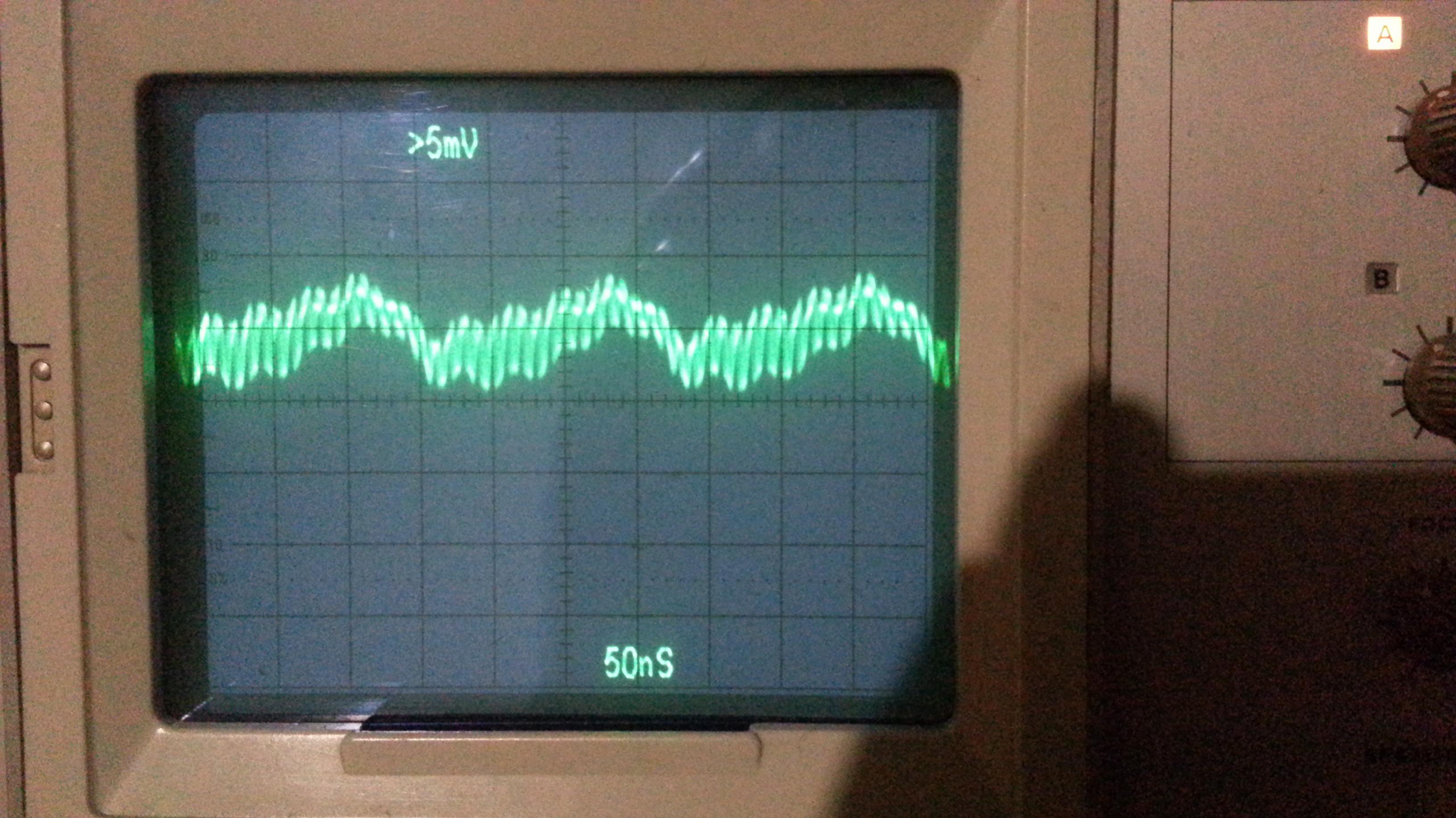

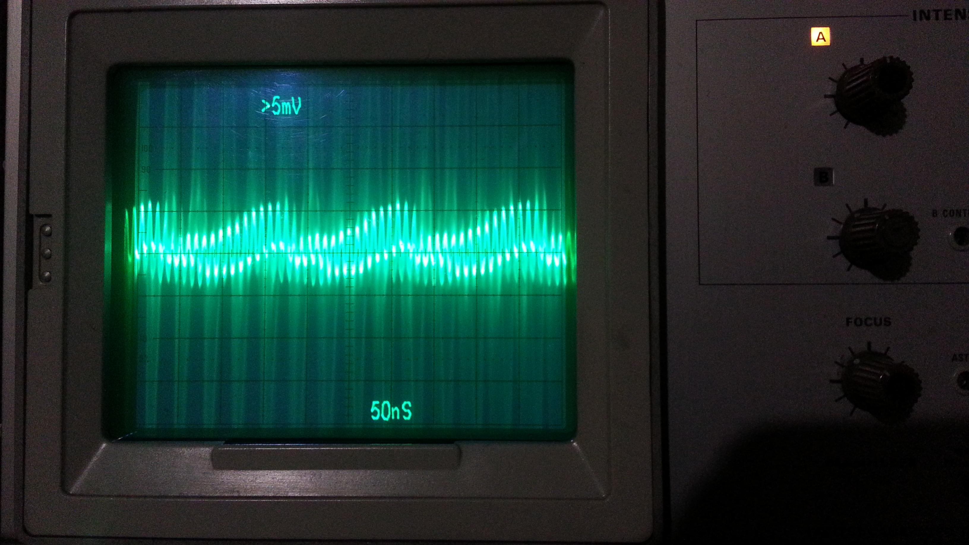

I've made the changes: added 100uF decoupling capacitors to the pcb main PS, resoldered 100pf cdom capacitors (50pF cdoms on another channel) after 220R of the bases of small VAS transistors (due to long distance) to the collectors of another VAS transistors. Here is the result. I remind that this is other channel with different bias schematic which is shown on pcb layout.
In the past I already tried to place cdoms this way, but observed worse results than at B-C of TO126 transistors.
Perhaps the problem in the input stage, maybe due to long leads of input transistors or pcb traces signal coupling?

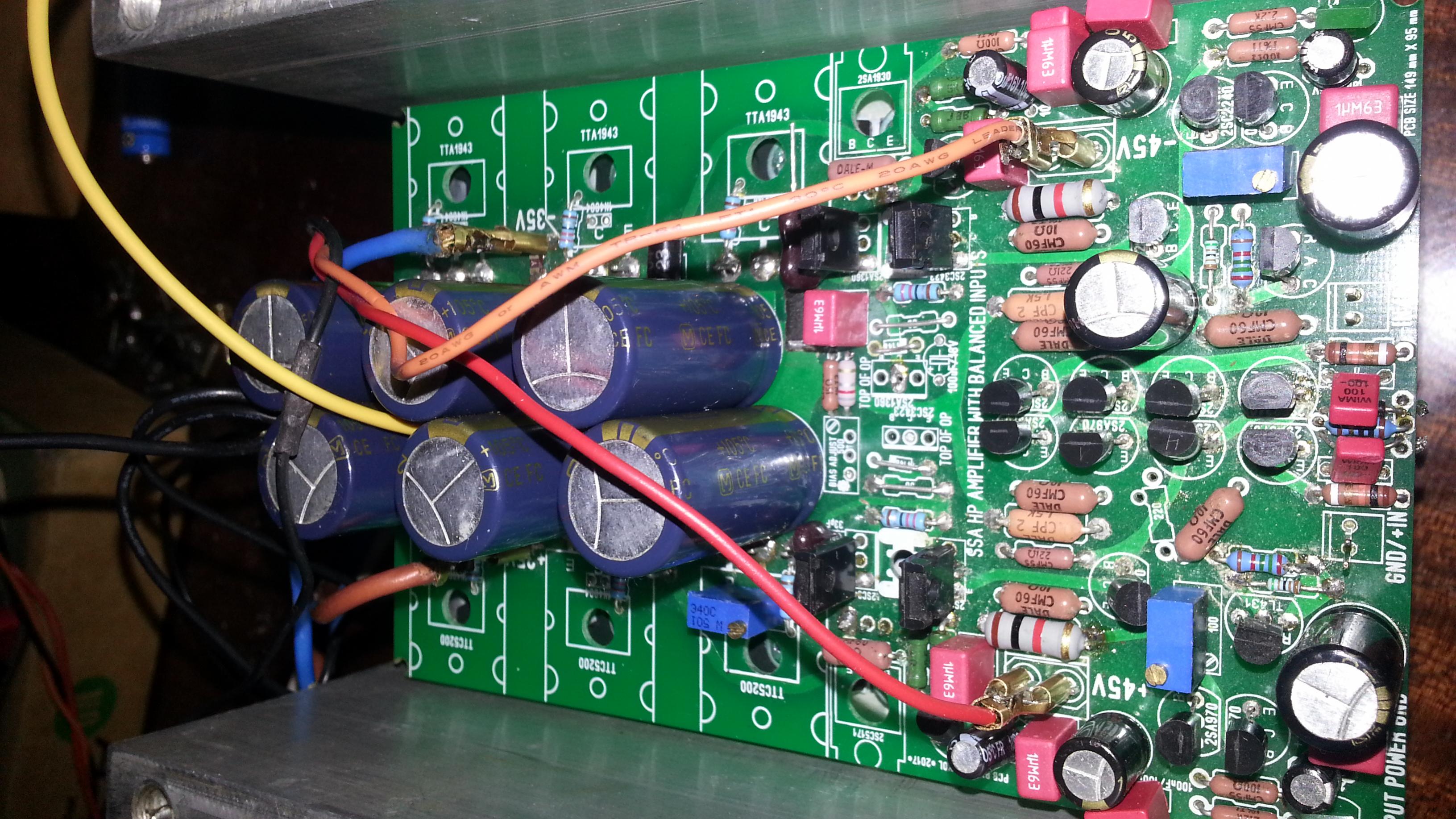

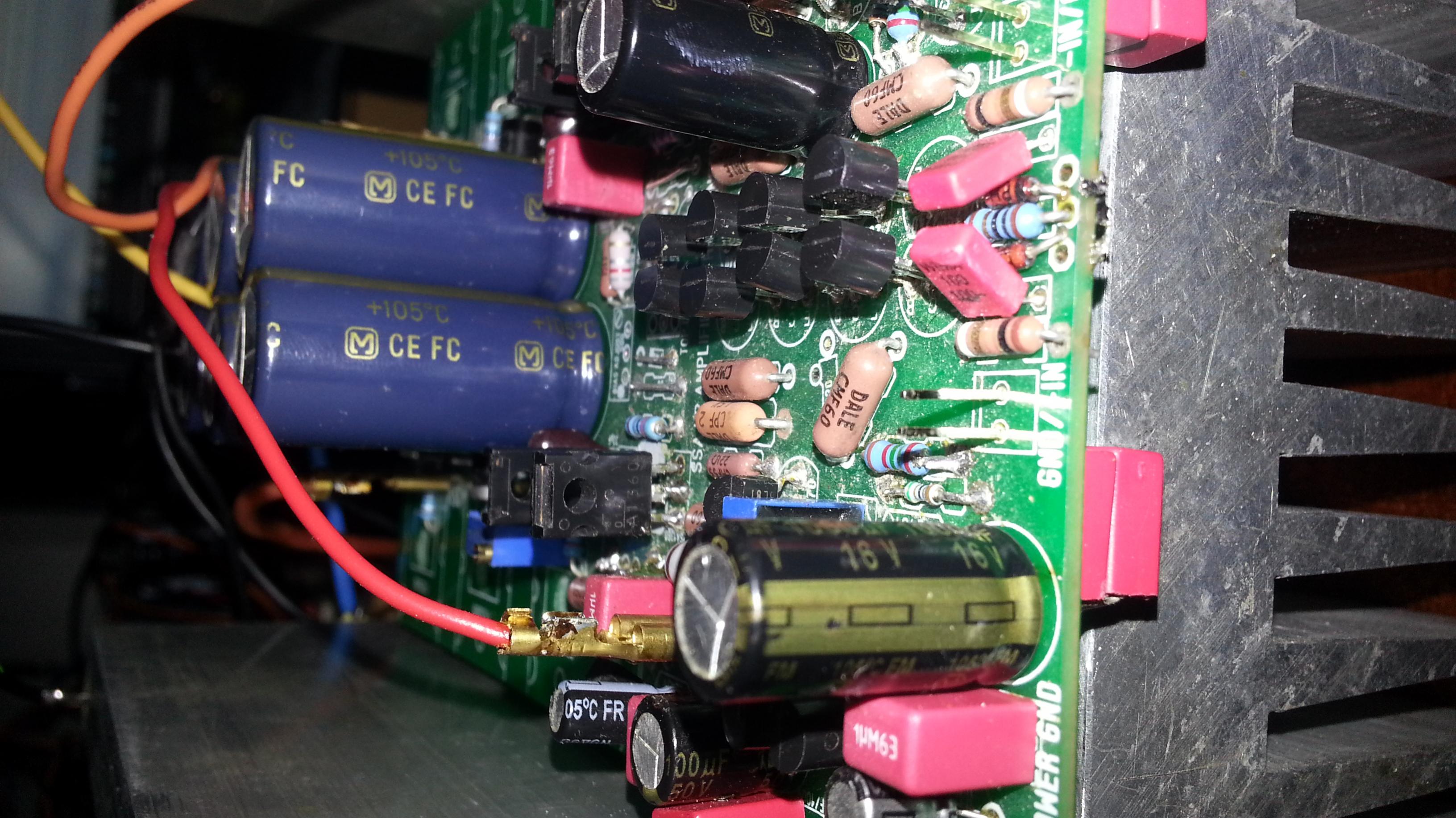

I can't help but notice from the pics of PCB that board look very contaminated with bits of solder. The soldering look rough with usually means it cold.
You need to clean away all the contamination and heat you joint until the solder flows smoothly.
It was drilled into me many years ago by electrical engineers to not route trace underneath components particularly in power circuits. Avoid it at all costs.
Additionally It a good idea to leave more space between components. This from EEs who designed high speed data collection and transmission systems for particle accelerators (cyclotrons).
Sometime the shortest routing is not the best approach if it leads to component crowding. If you look at Douglas Self's successful designs you will notice ample space between components.
I repaired audio power amps for 15 years. The one's that failed the most where the high density layouts.
