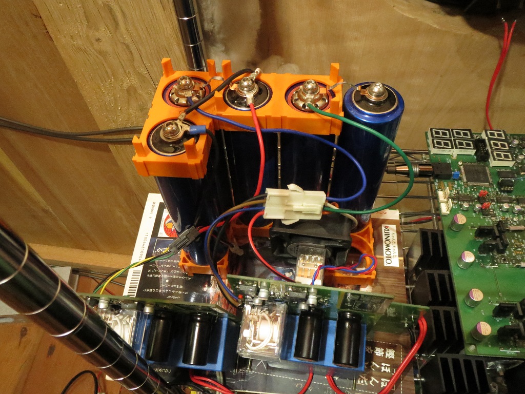

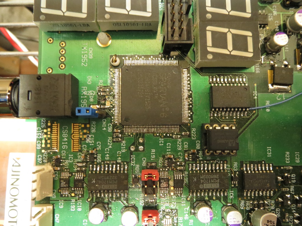

Everyone has their standard which is not usually explained in detail. Mine is simple. The ground potential must be equal wherever you connect a scope. But this is almost impossible in a power amplifier because 16 volts(8 ohms load) means 4 amperes peak to peak which ends up 0.1 volt(0.025 ohm ground resistance). 0.1 volt is not acceptable.
I use class A BTL which doesn't have current flow into the signal ground. Current flow is through both power rails only. Furthermore, class A decreases alternating current from power rails practically by 40dB. So, current flow into the ground plane is almost ignorable, and power planes are 4/100=0.04 ampere in my circumstance.
But I still use ground plane because I need a digital circuit for temperature monitor, bias current control, short circuit protection, and DC offset control. I'm sure a power amplifier must have such monitor system to prevent it from a various dangerous situation. I know many people dislike a digital monitoring system in an audio system because it uses digital ICs which tends to make digital noise.
That's why I need a multi-layer PCB which has ground plane and far better noise immunity than two-layer. I don't need a multi-layer PCB for an RIAA equalizer because it has no digital stuff at all. A digital monitoring system is very effective than an ordinary analog one. The disadvantage is digital noise caused by poor ground routing. My solution to a power amplifier is class A BTL and a digital monitoring system realized by a multi-layer PCB. I usually forget to explain the former and say the conclusion only; a multi-layer is better. What I mean is of course both. The pics are my power amplifier designed by this concept. One more thing I forgot is mine has DAC on the board. The reason is to prevent common mode current problem caused by the mains. This is off the thread.
It's worth pointing out that all of those functions can be easily carried out with analogue circuitry, and in the absence of anything more complicated that would be the route I would normally take.
However, sometimes you really need a microcontroller, say for decoding RC-5 IR commands. This is accepted reluctantly because it adds another level of complexity, introduces software control issues, and threatens digital noise.
But... I have designed many preamps and power amps for production that had a microcontroller, and in no case was digital noise measurable. All the PCBs were 2-layer.
Far be it from me to say 4-layer is never required. But for me it comes in with tightly packed SMT analogue PCBs where you need at least one more layer for routing. If that's sufficient the remaining layer will very likely be set as a ground plane, to reduce ground resistance and so reduce inter-channel crosstalk.
