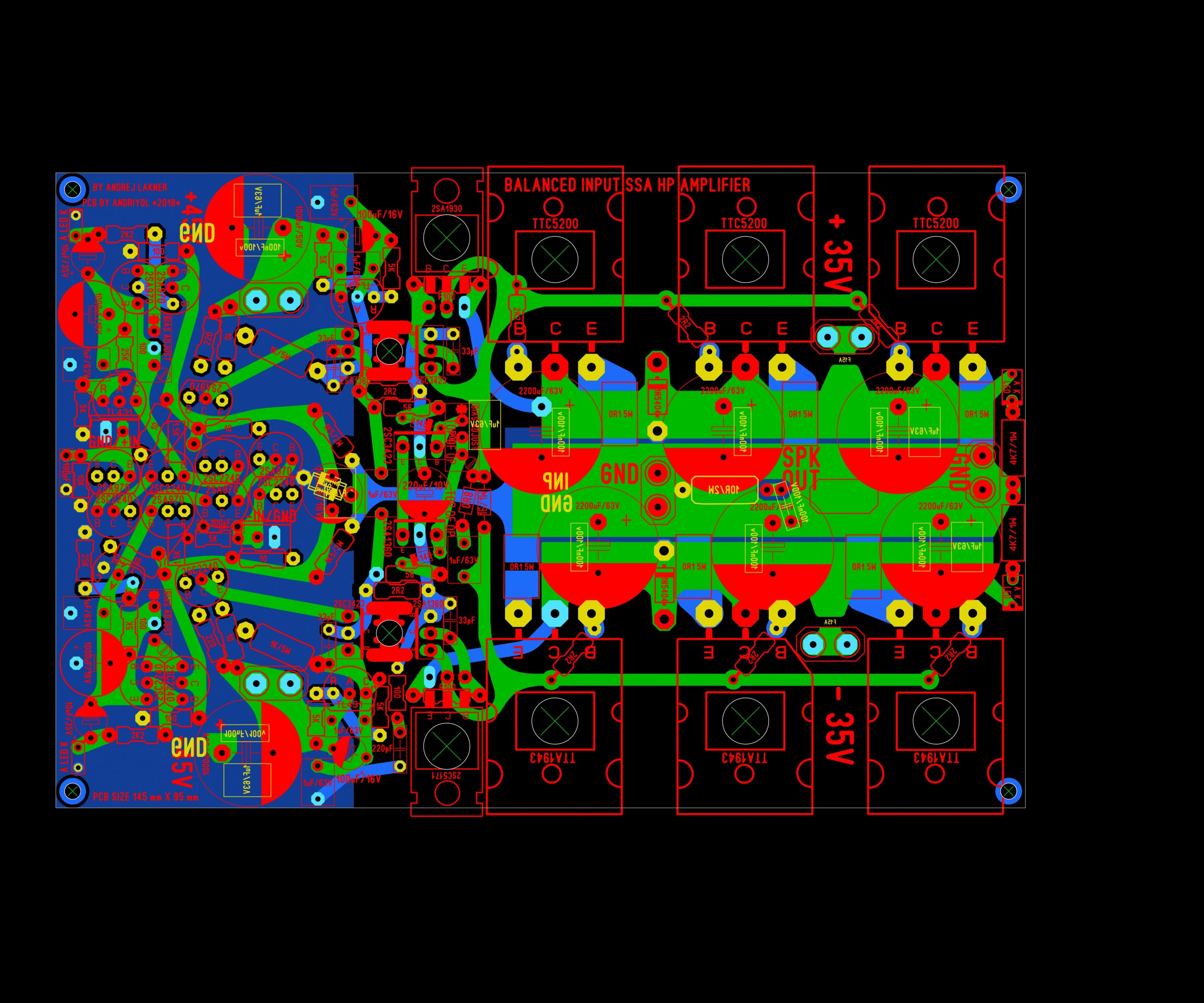

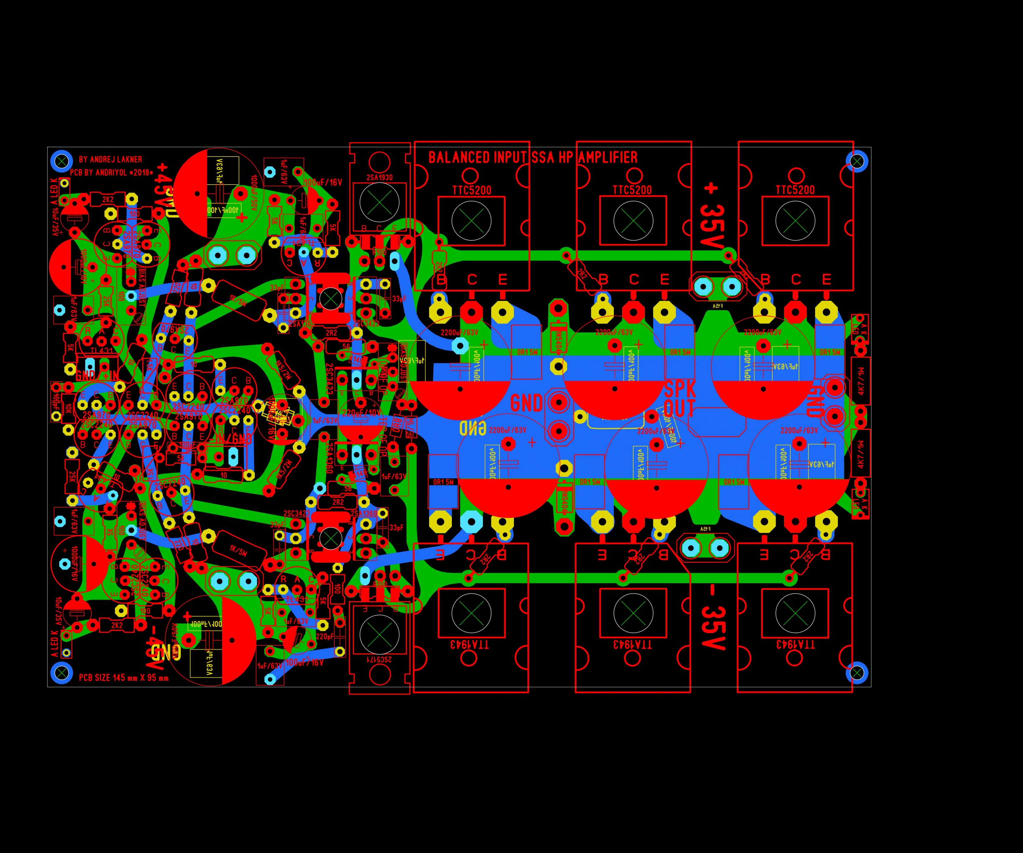

I've made the layout with ground plane in the input section on double-sided pcb. Instead of missing traces jumpers will be used. Is it done right? Any thoughts?
Second image is with top layer missing traces. Missing GND traces haven't shown.

at audio frequencies low loop area has to be enforced by trace geometry - pairs, power/gnd bus interleaves
this is most important when you have Class B output Q and PS rectifier/cap nonlinear currents
in the frontend a gnd plane is convenient, the diffusing of the currents only gives tiny gain differences when they are all Class A and small

Yes, I've read it.
I did gnd plane on input section only to avoid couple the high current output stage to the input stage, which may change the potential and cause oscillations.
Do you offer to create another gnd plane after the 10R for the output stage?
Do you mean multilayer pcb will be better or gnd plane for full layout?
On a two-sided board there is often not enough space to do a full ground plane without increasing the power stage loop area by large amounts. Since the ground plane only starts working at 5KHz or so, the increased loop area of the power traces will result in more distortion than if the traces were routed intelligently without a ground plane to minimize current loops and cancel fields.

In low frequency audio application, as long as we follow the basic theory, I don't think we need multi layer PCB or even a ground plane. Thick trace only needed for high current trace when PSU is on board.
Why have you focused on the layout when the source of the oscillation is still unknown? If you follow the basic theory on the layout implementation and the amp still oscillates, the design is simply unacceptable imho. In your spice analysis you should have shown the Nyquist stability criteria (I think I haven't seen one).
Let me digress. Every time I have thought that oscillation might be caused by a layout issue, except for once on someone else's board, it has turned out the problem was something else, sometimes a miswire. Do you have your PCB linked with a schematic so it will keep you from making errors?
Doug Self has a lot of experience, if he gets good performance without ground planes, then your problem can't be because you didn't use a ground plane. Make sure that the layout matches the schematic first of all.
On your latest layout the PSU cap return currents will pollute your feedback signal. This is something you need to get right before trying to use ground planes. It would be better if your output/ground points were right next to the 16 ohm resistor, so there are no more connections getting between them and the feedback point.
BUT, again this is not the kind of error that causes oscillation. It's quite possible there is something wrong with the simulation and you built a faulty circuit without realizing this.
I confirm, I traced a pcb of the preamplifier RIAA of D.Self (Elektor 2012) without ground plane and this circuit is totally silent and "cherry on the cake" it is of a superb sound.Doug Self has a lot of experience, if he gets good performance without ground planes, then your problem can't be because you didn't use a ground plane. Make sure that the layout matches the schematic first of all.
A common technique on low frequency power boards is broadside routing for high power pairs. That is one wide track on the top, with the return routed directly underneath it. This gives a low impedance path for the current delivery with tightly coupled fields, minimising the effect on other signals and return paths. A ground plane for low frequency power can be counter productive. On multilayer designs where we will use more than one pair if required for current delivery or a low impedance/low voltage drop path for higher switching circuits.

Hi AndriyOL,
see, what I do not understand is that you want to apply the new knowledge you gained from the papers to only half of the board.
Yes, I mean ground plane under the entire board is better.
Consider, you have reduced the loop area of your input section by putting the ground plane underneath, this is good and it will make your input section less receptacle to electromagnetic stray fields. Great.
But what about the possible source of unwanted electromagnetic stray fields, e.g. the high current section of your design. If you were to leave it as is, you would still have large loop areas on these traces and so you would allow the 'love' to spread to nearby traces and cause grief.
For the point I am trying to make, I am sure you have heard of the concept of loop antennas. If not feel free to google. Yes, I mean RF antennas. As with RF antenna application you generally have a receiving antenna and a transmitting antenna. (lets imply these antenna are loop antennas for the point I am trying to make)
Now if you have two very good such antennas (RX and TX), your 'RF system' works very well as you can receive a signal that is transmitted from far away.
Btw. good loop antennas have large loop areas.
In audio application, I believe it is not desirable to have 'build in' loop antennas in the design which could possibly radiate or receive signals, the amplifiers very own signals perhaps. Therefore it may be best to avoid any structures in the design that make loop antennas.
E.g. we want the smallest possible loop area to achieve at best a very very poor loop antenna on the 'receiving' as well as 'transmitting' side..
This is where we bring copper e.g. ground plane as close as possible underneath the traces above. This results in the smallest possible loop area between the trace(forward path) and ground (return path). With a small loop area there is very little electromagnetic fields which could possibly enter or escape between the forward path and return path and so we have achieved a very poor 'loop antenna' action.
Afterall, we do tend to twist wires to get them as close as possible to each-other. There is a reason for this, it is not only the 'neat factor' but so we minimize the loop area between them. Does this make sense to you ?
Let me ask you this, what do you think happens when an amplifier -magically- 'transmits' and 'receives' its own signal and amplifies it ?
SL6 I used for layout doesn't have such feature. But I had checked it before making pcbs. Will check it again.
I'll try to redesign so there will be clear path between feedback input and speaker out/gnd connections. Thanks.
