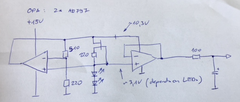

The intention of this thread to be able to provide a High quality (low noise)VREF mainly for DACs based on the starting circuit.
(in the Thread of ES9038Q2M a discussion started for AVCC Voltage source - battery based)
In this thread I would like to discuss an OPA based circuit.
The very base circuit is not a completed one, naturally filtering capacitors, (or against oscillation), component selection, etc is in front of us)
It should be modelled and built and measured too.
If someone willing to participate feel free to comment and modify.

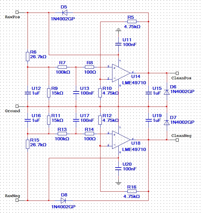

Also, for clarity I will copy the "4th picture down," as referenced in the first post by the OP. As can be seen, opamps are used directly as power supply regulators, similar to the ESS recommended opamp VCCA circuit only with 1uf output capacitance instead of 47uf (or 10uf), and a little less loop gain.

You have some resistors in the circuit, one in series with the fet and one at the output of the 2nd opamp. How would you quantify their effects on noise?

The output resistor thermal noise definitely counts. For 50ohm it is 1nv/sqrt(Hz). For 100 it is 1.4 roughly.
Since a capacitor is used this will be devided, varying with the frequency. So a pink noise is generated by the output. Definitely an L could be better. But this R also limits the max current. Of the OPA. (At Starting it is high).
Also the input part can be lowered to a certain value. The ad797 has quite high output current. 50mA. For OPA1 the resistors +(FET +LED) +the 2nd OPA base current+ 2nd OPA output current are the load. 14+2+8 are the first three. So for output roughly 10-15mA can be calculated. It would be also possible that the 2nd OPA is a different type which operates from 2.5+2.5V. And in that case the VCC for 2nd OPA can be reduce to 7V. (Ad797 minimum is 10) but here the PSRR is decreasing and other properties too. (Can’t find diagram for the Ad797, just for LME49720)
BTW In the original circuit the BE has higher thermal effect then the FET sourced LED.
Besides these I have a big question mark referring to the whole circuit:
Will it start at all?
I modelled the DC operation in Spice and it showed normal expeted values. But if at starting time the OPA1's output is at 0V than it never will start. (this was not discussed in the original Walt article).
depends on the particularly bought OPA1's offset (positive or Negative)
But in this circuit the situation is even worth since the FET source will not work under 4V. so likely a parallel resistor/Cap is needed there. ??
I considered a pull up resistor, but it could be done only from the unfiltered VCC which would dramatically increase the noise.

Basically good idea. With a transistors+capacitor can be easily done a starting circuit which is “closed” after a certain time. I will try if it will not start. Thx
You can not put a capacitor directly on output of the OP because a stability problem.
Yes you right this is why the output resistor were considered. Inspire of its noise effect. Possibly it can be decreased.
In addition Mark raised earlier to have capacitor for OPA2 VCC. If it is needed for stability then there an R component has to be considered too. Let’s see from the tests.

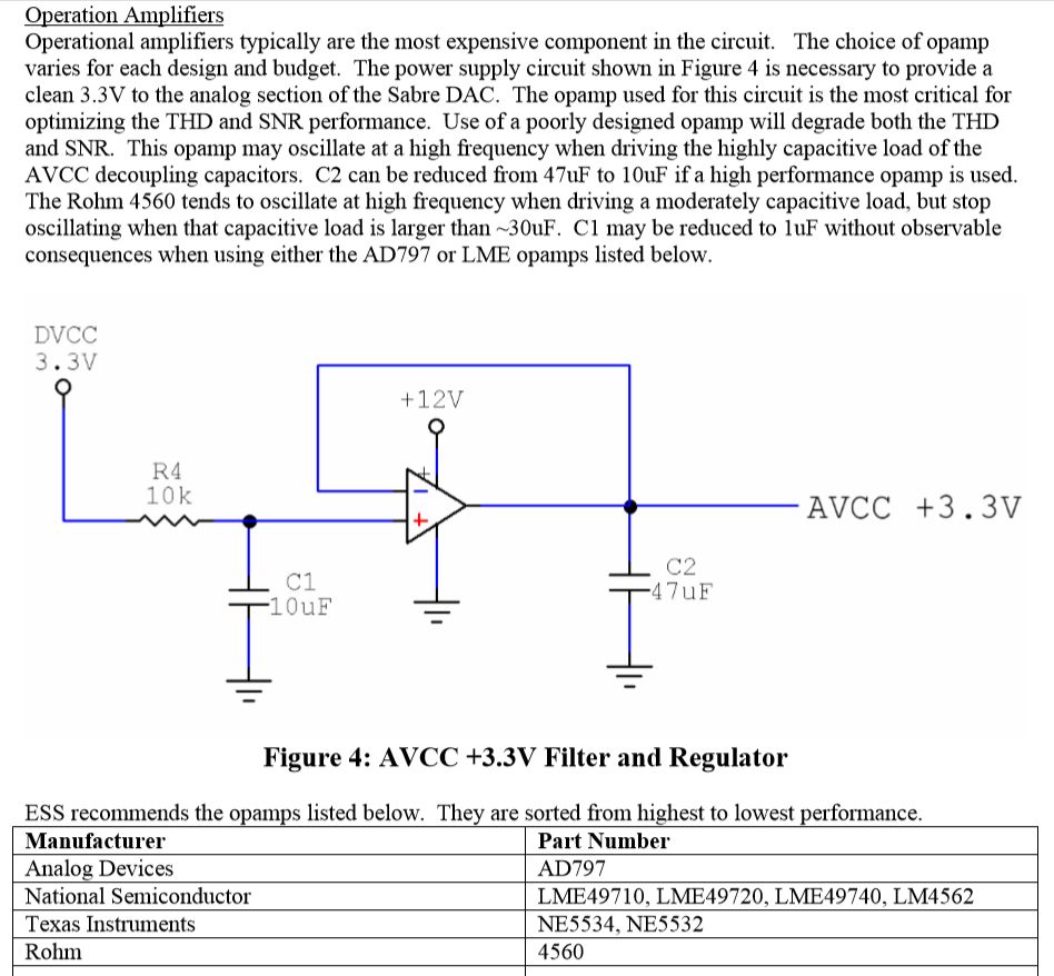

On page 4 of this application note one can see what it says about stability of an opamp and output cap with no resistor for an AVCC supply for ESS Sabre DACs: http://www.esstech.com/files/4514/4095/4306/Application_Note_Component_Selection_and_PCB_Layout.pdf
babolcs: You should have read the application note already before agreeing it can't be done. To be a good designer you have to do your homework. Right?
After seeing that it actually can be done in some cases, can either of you guys now explain how it can be possible in terms of loop gain and phase shift?
For convenience I will attach a copy of the page below.

Once you figure out why a cap can be attached to the output of an opamp in the ESS AVCC circuit and not cause oscillation, you should be able to figure out it should be likely to cause oscillation in the case of the Vcc supply you mentioned.
If you can't figure it out, I will give you the answer, but you should try first. That's part of learning about design. There won't always be someone who can tell you all the answers, even today with the internet and forums, it can still happen. I will tell you this: it depends among other things on layout and types of capacitors used, information that may not be included in a schematic.
