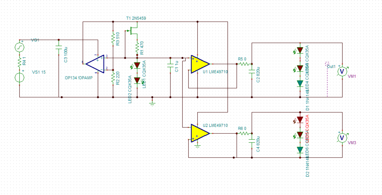

Hi guys!
I have a greate news!
As I mentioned yesterday I had finalized a built which could have been attached to the ES9038.
My first impression was terrible. I fought several hours during nights for nothing.
BUT:
Today I changed the OPA2 from NE5532 first to OPA2134 and afterwards to LME49720.
Here - as Mark suggested to eiminate the output resistor much earlier - I could decrease it to 0. Furthermore I could increase the capacity on the AVCC. (there is roughly 800uF (as a sum of different CAPs).
Furthermore I replaced the OPA1 from NE5534 to OPA134 (originally I wanted to have some high current output one (like LM7171) but nothing was in the small shop in our town.
And a small miracle happened:
The dark bass disappered!
I have a really clear voice.
The bass is very bright, the stage is really wide.
Currently the phisical state is terrible, I tried several things - you can see the result . I will clean it up, but the voice is a really huge step.
Soon you can see the finalized circuit. OK not finalized, since always can be developed further ;-)

So here is the circuit The LEDs are red ones.
Capacitors a Nichicon Muse and the 1uF is a ceracmic X5R
The output LEDs and the 1n4148 is a very simple protection (so it is good if the LEDs can lead some mA.
The fet is 2SK170BL - just I couldn't manage to put it into Tina
I've forgotten to mention that the whole ES9038 board supplied by a SALAS shunt reg V1.3

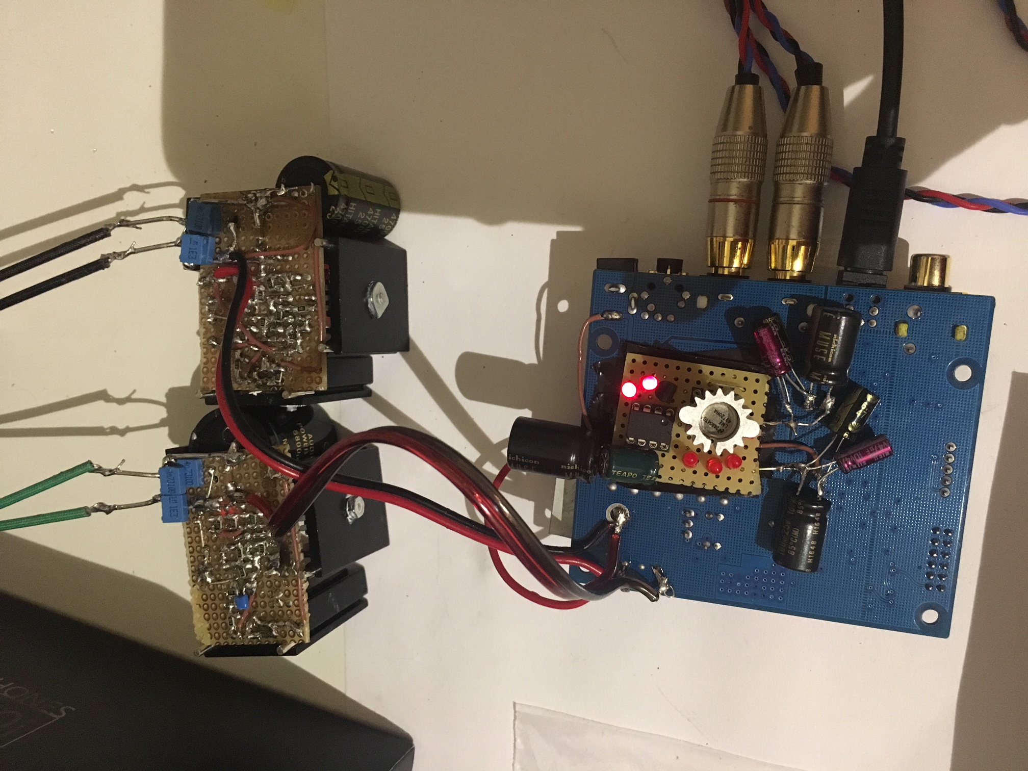

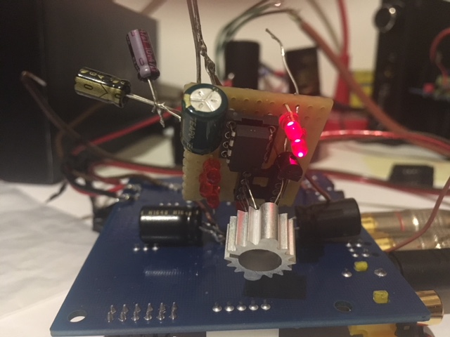

And here is the cleaned up the build.
Important: you can see a lot of CAPS - later it will be cleaned up - just played a lot and not yet done (in total ~720uF)
likely I will try to buy bigger ELNA silmic II-s to achieve only with them at least the 470uF.

Hi Chris. on the simple ES9038 board I measured 23,5mV on 4.7Ohms. It is exaclty 5mA. I don't know the PRO version data. Where the 90mA comes from?
for the 5mA the OPA is sufficient.
OPA versus LT3045:
If you consider/simplify the whole situation for yourself OPA is like a shunt Reg. (I know it is a very strong simplification, but in the outout stage the upper transistor is the current source, while the lower is the draing.)
And the shunt reg most cases sounds better then the traditional serial REGs.
