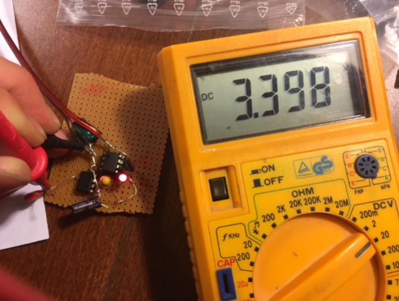

Meanwhile I built the very first version without additonal caps.
At least it started.
1)
I checked with 6pcs 5532 (only 1 side) in OPA1 pos and TL081 in OPA2 pos. (this was fixed) I also checked with an OPA2134. Here I experienced some instaility (Currently I don't have a scope so could measure 16mV AC accross a CAP -so likely it oscillated.), so I put a 10uF tantallum next to the LEDs.
2)
with the tantallum i Retested and in 2 cases with the NE5532 it hasn't started. (wiht others yes)
3)
The DC stability seemed quite OK. VCC was varied from 9V till 19V. and measured the output of OPA1 and OPA2. (currently I put 560ohms instead of 510) so the output of OPA1 should have been alomst 12V.
But between the normal range (from ~13,2V for 5532 and ~13,8V for the 2134 the OPA1 output changed between 11,983 and 12,009 and OPA2 output remaind stable 3,398V.
(Side comment: Naturally at very low OPA1 VCC (9V) the output of OPA1 can't reached the required value (was ~7.8), but still the OPA2 output was quite stable (3,248).)
I tried to measured some thermal stability with a very simple way: heated 1 leg of LED and experienced a negative coeficient. I measured 20mV decrease for 20C increase (likely it was not punctual enough, since it should be 2mV/1Celsius/LED.
As I mentioned I don't have a scope currently so I can't tell exactly what noise or oscillation AC is on the output. Definitely I will buy something and built a noise amplifier.Afther that I can play more with the filtering caps - how it behaves for different scenarios - considering the different CAP behaviours you described.
1)
2)
3)

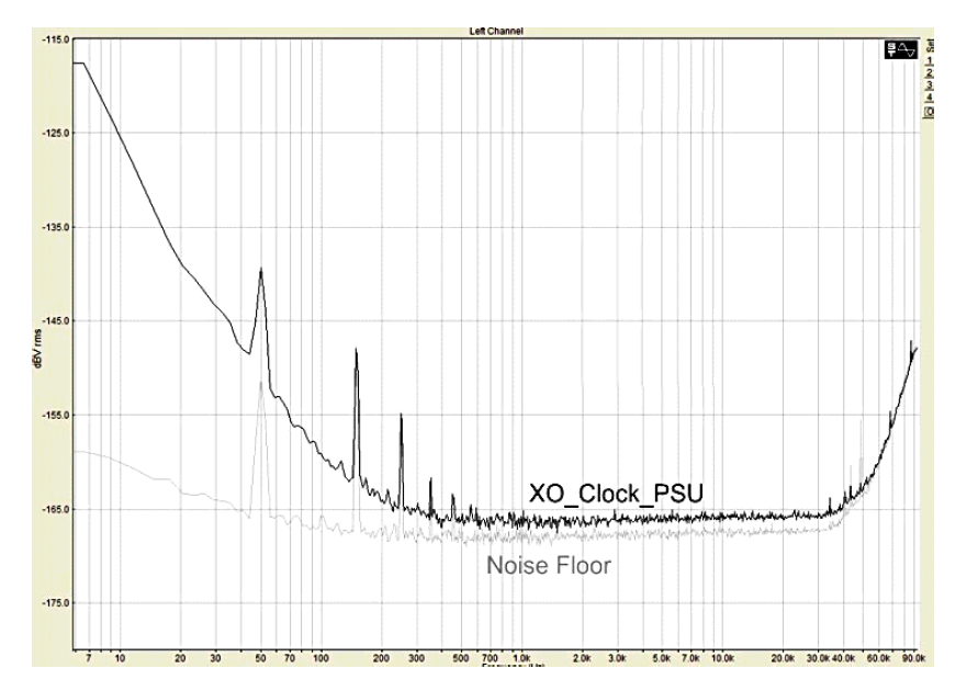

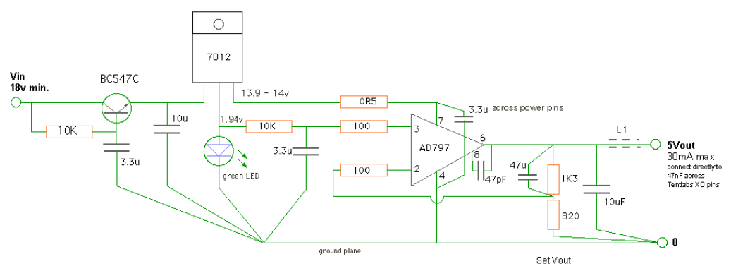

Someone have proposed similar idea many years ago. The FLEA regulator is similar to yours. It even has capacitance multiplier & pre-reg at the input plus LPF at the Vref.
The test figure.
As the noise floor going up from 40Khz, we don't know the real performance of the FLEA at higher freq.
The test figure.
The test figure.
Dear Canvas,
Thanks for your comment. It definitely worth to consider some ideas from it.
The cap multiplicator and the filtering around the base source (LED) here.
BUT obviously the main difference, that in my circuit the 1st stage is an OPA too. and the LED is powered from the already filtered output of OPA1. Definitely the OPA has much better performance over a quite wide range of frequency compared to the 78XX/LM317.
And in addition I don't know how noisy the common point of these REGs are.
(Although I suppose it is low, since the guy who suggested the circuit definitely put the LED consciously there.)
(Now it is morning in HU and just wanted to have a quick look, so don't have time to check in details)
The output noise has 2 main sources: the VREF and the Power rail (and definitely much more, the internal noise of OPA/REG, the capacitors, the resistors, etc.)
In this original circuit (let's call it 00Reg -thanks for the inspiration to give a name) nothing on the original power rail, just the OPA1.
As Mark wrote in the next post LT3045 can be considered as first stage.
OR the suggested LTC6655 can be used instead of the LED (noise - worth to compare of it with the earlier suggested Resistor solution - increasing the current of the Current source and lowering it to somewhere 470ohm. Which has roughly 3nV noise )
The nice thing here is that really there are a lot of opportunities and several can result something good.
I would stick to the original 2 OPA concept - considering all the suggested ideas.
