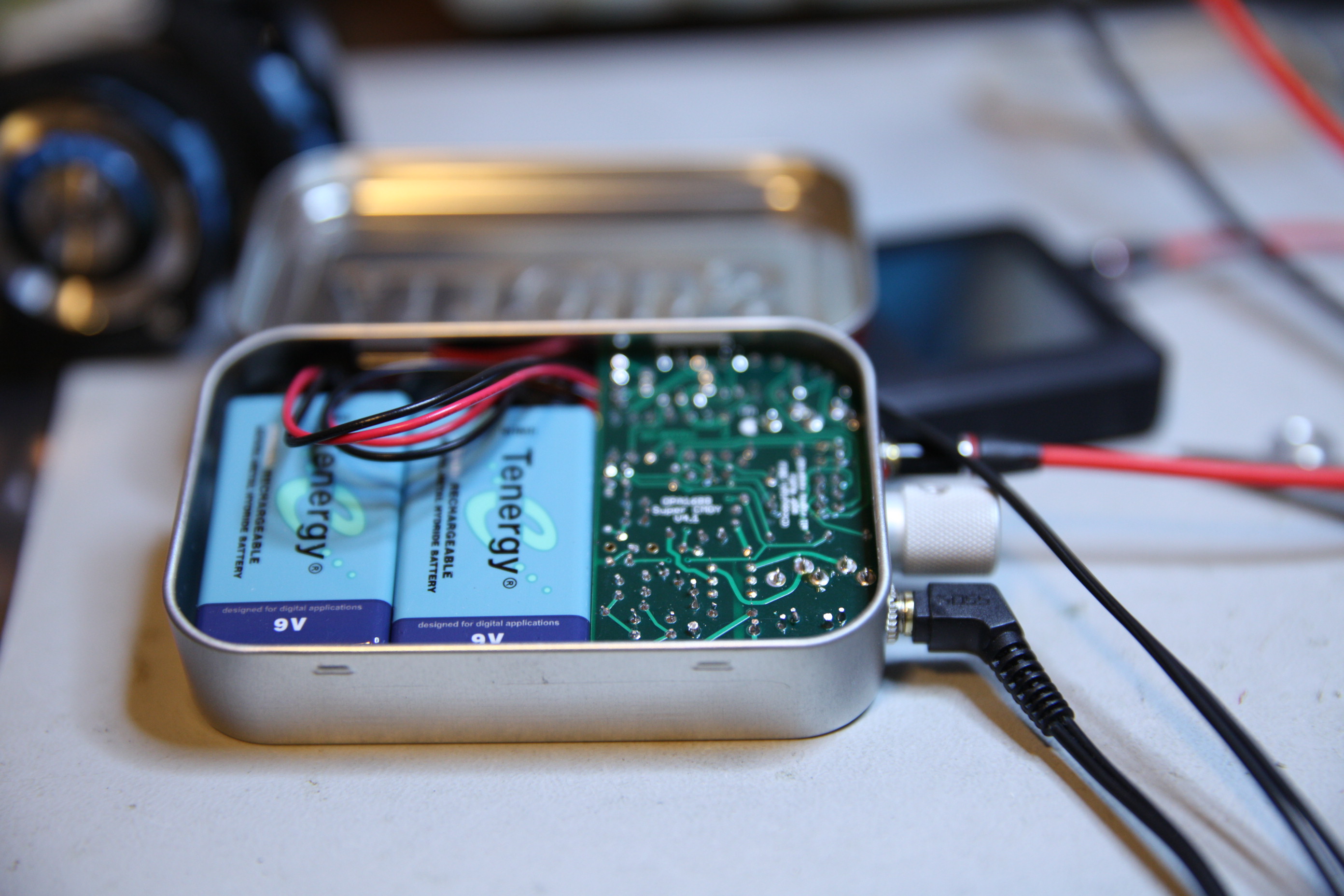

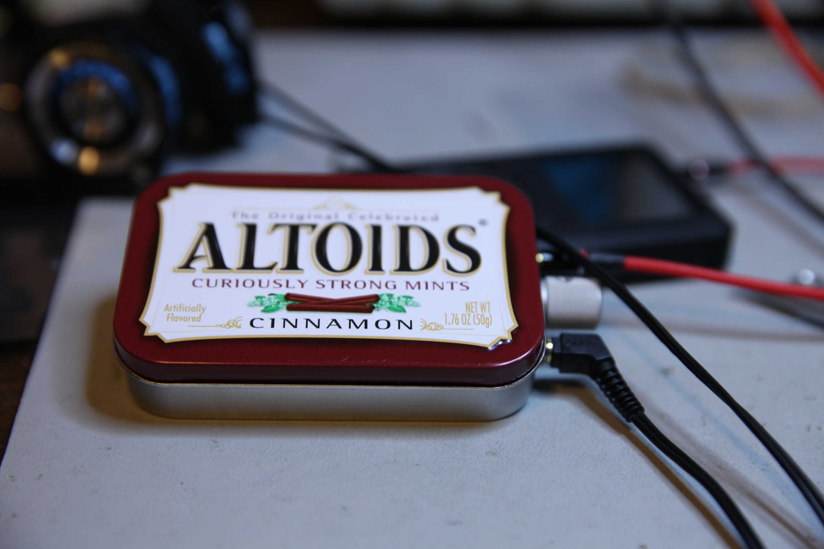

Another birth
Another successful build. Birth certificates (snapshots) attached as proof.
Soldering on the comparator chip was a humbling experience. I thought I was fairly decent with an iron until I started that task. Thank goodness for a bench-mounted light/magnifying glass and solder wick. My geriatric eyes aren't what they useed to be.
As you can see in the pics, I mounted the PCB upside down in the tin. Rather boring when opened, but doing so completely eliminated any interference between the lid and the phone jacks, knob, and LED. The lid closes tightly without objection, and looks good when closed.
The sound is, as expected, excellent. I like the OPA1688 very much. I've tried that chip in other projects, and have not been disappointed. I don't see how anybody could dislike these little wonders, but as always, YMMV.
Finally thanks to agdr. For the design, for publishing and maintaining the docs, and for making boards available. Thank you.

mlackey - looks fantastic! :) Congratulations on your build. One suggestion I would make is to twist the battery leads.
You are right, the board mounts upside down on top of those 3.5mm jacks. I abandoned aesthetics for functionality on this one! Like you say it all works out just perfectly with no need to insulate the back of the board and plenty of clearance to the top of the can. I kind of enjoy coming up with weird mechanical solutions in my stuff, like the O2 Booster Board.

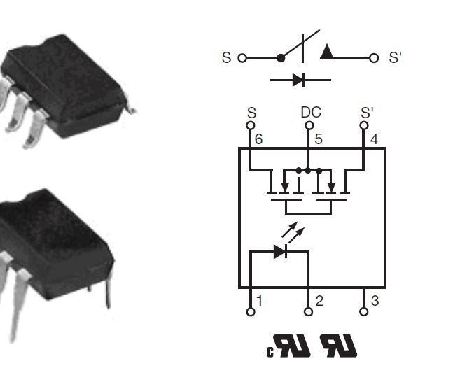

Very nice design. Could the SSR's be used on the headphone outputs?
I actually tried that in V1.0! That first version had a place to solder on another small daughter board that either had an OPA1622 or another pair of SSRs on it. The board could be wired up to loop the OPA1688 around the OPA1622 (that was my original vision for the board) or the two additional SSRs could be used as a muting relay. That V1.0 didn't have the mechanical headphone relay. The output SSRs were AC-wired, while the battery SSRs are DC-wired (AC = both SSR mosfets in series, DC wired both in parallel).
I expected to see some crossover distortion with the output SSRs and sure enough, there was some, but it was surprisingly small. I still have the QA401 measurement photos here somewhere. Adding the low ESR after-battery-SSR power rail electrolytics (by the output jack) reduced the crossover even further (over having no electros at all) for reasons I still don't understand. This is crossover caused by the output SSRs, not the OPA1688.
But in the end it came down to money. The two SSRs wound up being more expensive than a mechanical relay and the SSR's internal LEDs pulled nearly the same current (3mA each SSR which were in series, 4mA relay coil) as the coil on the relay (the one being used now has a high sensitivity coil). And the mechanical relay has zero added distortion, of course. Also, rather interesting, I expected the SSR would switch a lot faster than the mechanical relay. Nope. One direction (off or on, can't remember) is about the same speed as the mechanical relay. At least that was the case for these SSRs with mosfets controlled by internal IR LEDs.
I did go with the SSRs for the battery control though due to the expectation that the on/off tracking (make/break synchronization) would be better with the SSR than with mechanical contacts, and that seems to be the case. For the power management circuit it is critical the two power rails turn on and off at exactly the same time to avoid thumps. That is one of the problems with the O2 headamp in the basic design, I have come to believe. I should say the existing DC-wired battery control SSRs don't introduce any distortion at all, I tested it with the QA401. I measured the output with the SSRs jumpered straight across and with them in circuit. Exactly the same result.
As for the second use of that early add-on board, the OPA1622, I couldn't solder it! About then I also came to realize the 75mA out per channel of the OPA1688 was completely adequate for most headphones. For the few headphones that needed more I could parallel them using the OPA1689, but since that wasn't a product yet I used two 1688's in the current dual version. As things turned out I prefer the two 1688s now. Better spreading of the power dissipation and routing is easier than the single quad chip.

Btw, not sure how SSR adds xo distortion as it stays on. Xo distortion happens in output transistors because of zero crossing (unless class A). If a MOSFET stays on fully throughout signal cycle it never goes through zero.

Hi, just sent the PM. :) With the "AC wired" SSR I think there is a handoff from one internal mosfet to the other at zero crossing - the two are in series.

Ok - I don't know the topology of what you are talking about but will take you word for it if there is a hand off then of course there is switching.
Good question! I've posted the diagram of the SSR wiring below. So the two mosfets are flipped with their drains connected together for "AC wiring". For "DC wiring" the two sources are also tied together to put the two internal mosfets in parallel. For AC wiring the signal goes in one source and out the other. For DC wiring the current path is through the common drain and out the common source. Since its an opto-mosfet SSR, there are no polarity concerns at the gates.
With discret mosfets I believe they dope the drain region much more heavily during fabrication than the source. So I think you can actually flip the source and drain, but the part won't be as efficient. There also might be a body diode formed in certain parts. I could be wrong about that though! There are likely a bunch of folks working in semiconductor fab on the forum, if anyone has some thoughts and insights here, please post. :)
Here is an interesting set of posts about swapping drain and source:
MOSFET drain / source difference
The amount of crossover distortion using the SSR for output muting was pretty small from my measurements, as I recall, most of it under -110dB and just one peak at -95dB. So yep that would probably work fine for a power amp and speakers. The headphone amps are probably held to bit lower THD numbers jsut given the proximity to the ears.
Another interesting thing that popped up in my testing was just how "off" the muting was, since it essentially forms a votlage divider between the "off" resistance of the SSR mosfets and the impedance of the headphone. It was good, but not vanishingly zero. There was a tiny amount of audio pass-through with 32R headphones, but the level was below the audible threshold. Again something that probably wouldn't matter at all with speakers, but might with some very sensitive headphones or IEMs.
