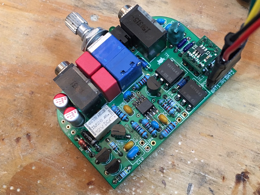

Hi Agdr,

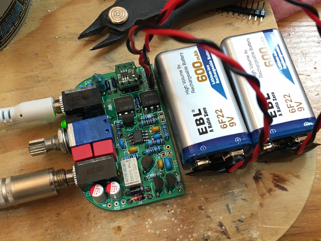

I just finished assembling the amp with the new OPA1688 you provided me. I am still waiting for the 9v battery terminals to come in but in mean time using 0.100in pitch header pins and some 9v (nnon-alkaline cells mesuring 8.25v (used)). I measure voltage at the pins on the solder side but nothing turns on. Voltage at test points on left side is zero. Can you help me to debug or is this a case of batteries too weak and SSR's are shut off to protect headphones? Here are photos of top side and backside to help.

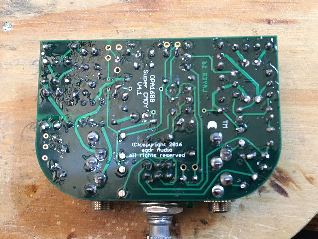

The amp works - I got the Li-ion 9v hooked up with proper connectors and it seems like the jacks need to be plugged in for the LED to come on? Listening to first song now. Very nice - just about the perfect gain at 2x for my DT880-250's.

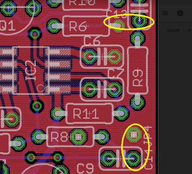

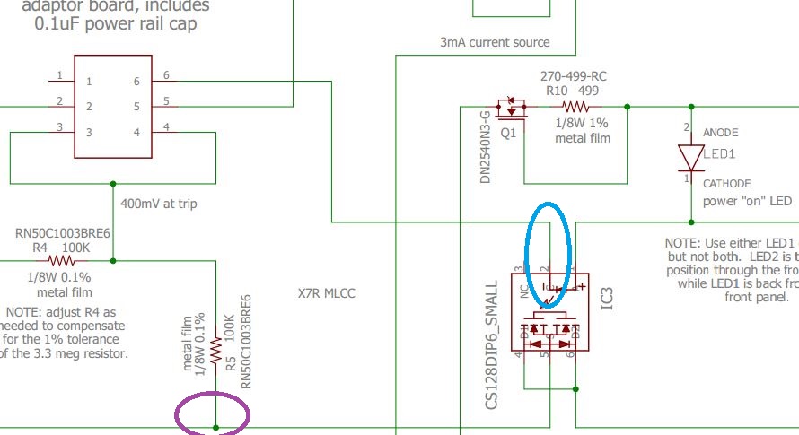

Congratulations on your build! :) Sorry about the delayed reply, I'm just now getting back to the computer. The symptoms you were having at first are what happens if the tiny comparator chip on the little PC board doesn't turn on. If it were still dead I would have had you measure voltage at the points in the first two diagrams below. That part of the circuit is referenced to the negative power rail rather than ground, so your negative meter lead would go were the purple circle is (one end of R5) and the red lead where the blue circle is. When the comparator turns on that blue circled point is brought down to the negative rail, and then all the stuff in the series string turns on. Both SSR internal LEDs, the front panel LED, and the current source.
With the batteries connected (charged up, of course), the front panel LED should light any time the switch on the volume control is on. When you rotate the control all the way counter-clockwise and turn off the switch the front panel LED should go out.
I see one problem though, in looking at the photo of your PC board. :) For a gain of 2x there are two jumpers (just pieces of wire, cut-off resistor leads works fine) that have to be installed where the yellow circles are in the 3rd picture. As you have it right now you are getting a voltage gain of 1x, but it should have the capacitors installed differently for 1x to give you good phase margin for capacitive loads.
SO... first thing to decide is if it is loud enough as you have it right now, or if you need it twice as loud. Sounds like 1x here is working fine for you, which doesn't surprise me given the high sensitivity of your headphones. If you do want 2x gain then install those jumpers in the yellow circles and it will become twice as loud. That upper jumper goes from the hole where C13 would have been to the installed lead of R6 next to it.
If however you like the 1x gain you have now, you first need to remove C7 and C8, those blue 47pf capacitors. They are only used for gains greater than 1x. You can unsolder them just by heating the lead on one end and pulling the part up on that end, then the other end. Or you could take your flush cutters and cut the part off at the leads. :) Then once C7 and C8 are out you would need to install C13 and C14, two 1nF capacitors. I think we included those with yours in case you decided on 1x gain, but I can't remember. If not just let me know and I'll send you a couple. And that is it! Once those capacitors are in you are done. The purpose of the capacitor change is to prevent any chance of oscillation with typical headphone loads.

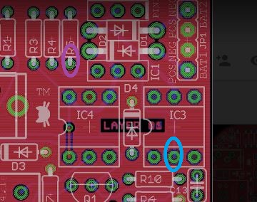

Hey one question, I see something green where R3 is at, near the back of the input jack, between the jack and the edge of the board. I just noticed that R3 and R4 are resistors that Digikey doesn't have. I'm guessing you put two in series there to try to make the 2.7 meg. It is important those resistors (R3, R4, and R5) be exact. If they are off by just a little bit it will mess up where the comparator turns on and off. That could be part of the trouble you were having. I have all those resistors here. I can send you two if you don't have the correct values in there, the 2.7 meg and 332K, both should be 1% tolerance or better.

Hi Agdr,
Thanks for the tips. I just got it boxed up and it's working fine when powered from a DAC but could use more gain when fed by my iPhone. So I think I would like those jumpers. Funny thing is that thought 2x was not enough so I installed smaller R8 and R9 values (330R since I did not have 412R) and of course, there is no difference. I guess I will just install the jumpers and see if it is now too loud (maybe 4.5x?). The amp sounds really nice - surprisingly powerful and clear little package.
I actually used 4 resistors in series to get exactly 2.7Mohm and 330k instead of 332k - hope that is close enough for the comparator. I think it did not turn on before due to old batteries or a loose connection between the battery and the PCB at the header strip connector I installed. Seems ok now and turns on,

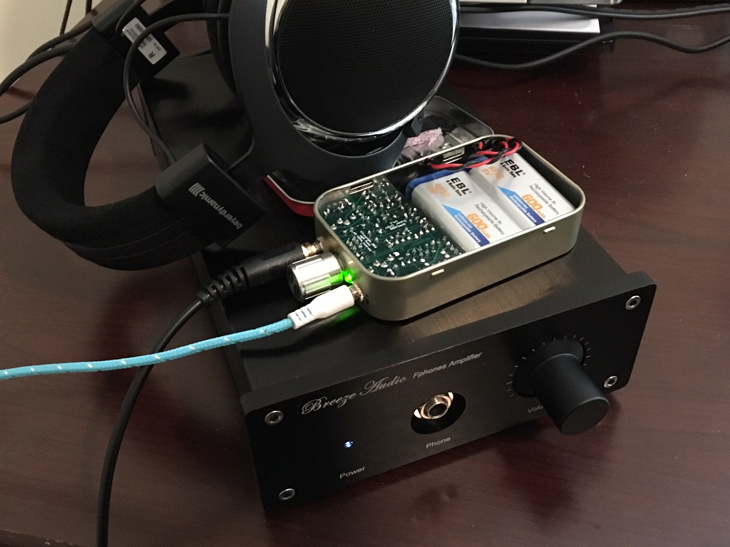

Here is the amp sitting on top of my single ended Class A dual JFET amp (yes, just two transistors in the amp!). This amp is currently my reference amp as it has a very clear sound, is super quiet, and has a very powerful and articulate bass. More info on this amp here:
http://www.diyaudio.com/forums/solid-state/301164-mosfet-source-follower-headamp-18.html#post4936115
589674d1483514266-opa1688-super-cmoy-2x-9v-real-ground-headphone-relay-pcbs-super-cmoy-1688-compare-aksa-xrk-amp.jpg
So I am listening and comparing back and forth between the two amps to get a feel for the differences in sound. So far, the little Super CMOY is sounding very nice in the mids and highs, but the bass of the SE Class A amp is very clearly better. Not surprising given the huge low ESR cap bank, cap multiplier, and output pwer JFETs with 3mOhm Rdson. I will give more listening impressions later but the bass is clearly different.

xrk971 - sounds good. yep if you need more gain do go ahead and add the jumpers. If you used 825R for R11 and R12 you would get a gain of (1 + 825/330) = 3.5x. Right now without the two jumpers installed R8 and R9 are not doing anything. So yeah that might suddenly become to much gain. If so replace R8 and R9 with the same value you are using for R11 and R12 and that will give you 2x gain.
Thanks for the listening report! Interesting about the bass. :) Does your class A amp have any resistance in series between the output transistors and the headphones/IEMs? That would change the damping factor and can affect the bass. You probably have the typical 1R or so balancing resistor in the emitter of each output transistor. that is OK, it would just be something like 5 ohms or 10ohms (or more) in the output lead that would matter.
And... 330K is OK in place of 332K. close enough for that one.

I finally hardwired soldered the 9v leads to the 4 pin header jack with strain reliefs. The connector was flaky and would cause the comparator to trip cutting out the amp at the slightest jiggle. The protection circuitry works flawlessly and I feel that with this amp, expensive headphones will never be damaged by DC rails or on/of thump.

Good test of the comparator circuit! :D This sort of thing is exactly why that circuit and the SSRs are on there. Just too easy for a battery with connection clips to have a bad connection, with the resulting large DC on the output from having one power rail "on" and the other floating.
Up until now all the other CMOYs out there used a virtual ground, along with all the resulting distortion, to insure that both power rails would go off if the single battery (or two batteries in series in some) loosened up. Not anymore! :) With the PM circuit and the SSRs, just as with NwAvGuy's O2 headamp, it can now have a true ground between the two batteries and true +/ power rails.
I don't have a dScope or AP unfortunately, no way to perform true THD+N measurements. But they should be pretty close to the chip's THD+N in the graph at the bottom of the first page of the datasheet, since the amp is just the single chip. I do have a "toy" QA401 THD+N tester (essentially a good sound card in a box) that I should try with the Super CMOY for the fun of it. :) I'll probably get one of JensH's new THD testers when those are released soon
