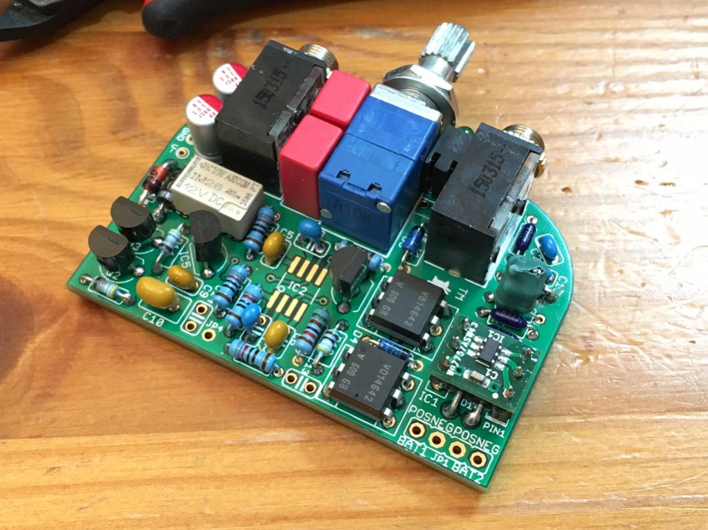

Is it really necessary to use 0.1% 1/10w precision resistors for R4 and R5? It sets gain right? Can I use 1% metal film ones? That's a $6 savings on a $34 BOM.
PM - and resistors - sent.
But good question, other folks building the Super CMOY and using Digikey will run into the same issue. I used those 0.1% just because they happened to be cheap at Mouser (likely an overstock) and the extra precision actually is useful in that particular circuit. The voltage divider sets the point at where the power management circuit cuts off the batteries. But I made the BOM really based on Mouser. Some of the parts are not available at Digikey (3.3uF film caps, volume pot) and that 100K resistor winds up pricey, at least in the 0.1%.
By the way, if anyone building the Super CMOY finds a part out of stock at either Mouser or Digikey let me know, I can probably come up with an alternate part number. If all else fails I probably have the part too.

I agree that this Super Cmoy amp is fun to build, the hard part was soldering the TPS3701 chip...and cap.....I managed to do two boards and they both worked!!! I was surprised! Getting a ready to go board here is the way to go.

I wonder if any other CMOY out there has done that? I haven't been able to find any in my searches so far.
I'm far from an expert, but I've not seen any mounted upside down either. My only other experience with an Altoid tin resulted in a lid that did not close well, so for this go-around mounting the board "the right way up" was the only choice for me.
Alex - you soldered up a couple of those! Your tape idea helped tremendously.
xrk971 - I've never heard of magnifying binocular googles! I'll look into that. Sounds like just the ticket. None of the desk magnifiers I've found come anywhere near being high enough magnification.

A cheap hot air station is also great for smt work. Al it takes it placing the chip somewhere close to where you want it, then you can just push it into place with tweezers. It also makes rework easy!
I'm old (school) and have no experience with hot air stations. Do you flow solder on the pads and then push the part in place, like "tack soldering"?

Well,I'm to cheap to buy solderpaste (and honestly, I'll never use one tube within its shelf life), I just tin each pad a little bit with a regular iron (with a fine-ish tip) using good lead solder. Then I just place the part on top and just push it into place when the solder melts (yup, its basically tack soldering with a fancy blow dryer
). The part just kinda slides right into place with no bridges. If you're using lead free, it might be a little dangerous for the part as it take much longer to melt (in my experience anyways).
