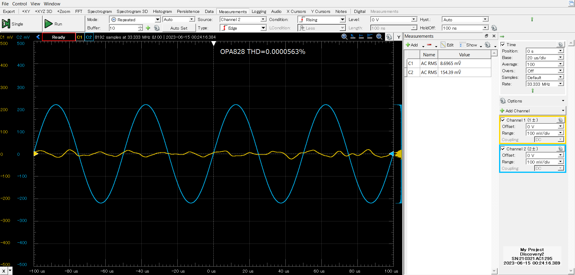

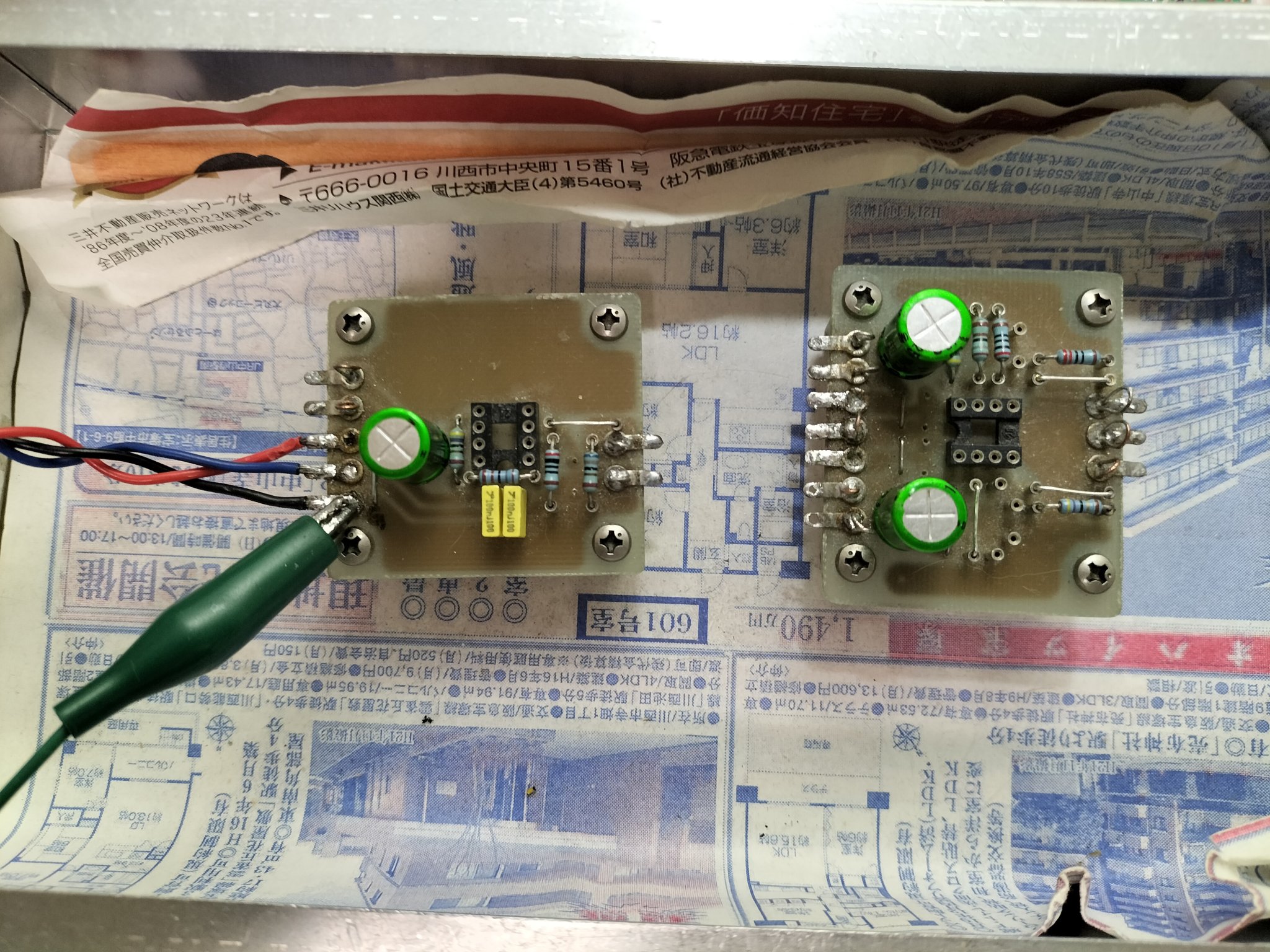

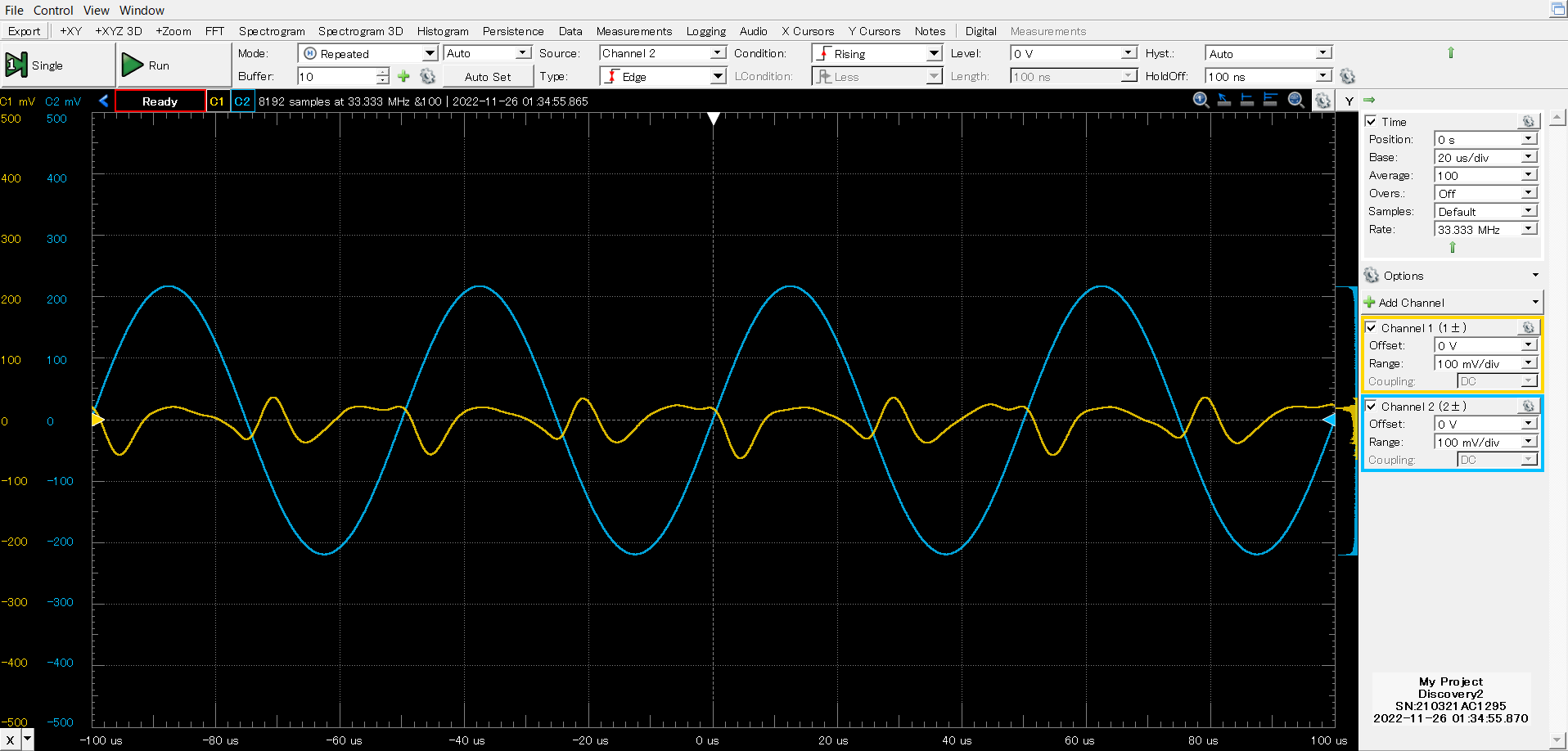

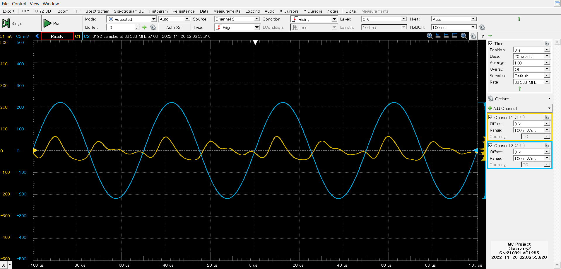

Below is what I always use to evaluate op amps
G=+10 (β=1/10)
The load resistance is the parallel value of the feedback circuit's 2kΩ and the distortion meter's input impedance of about 6kΩ.
The input signal is 20kHz 0dBu (0.775Vrms), the signal source impedance is 50Ω. Distortion at 20dBu (7.75Vrms) output.

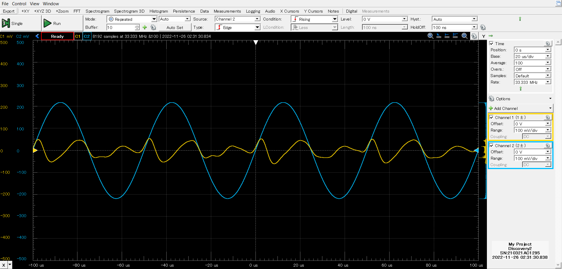

The cyan waveform is the signal input to the distortion meter attenuated to 1/50 (-34dB). Therefore, read the vertical axis as 5V/div.
The yellow waveform is the harmonic waveform with the fundamental removed, amplified 2000 times (+66dB). Therefore, read the vertical axis as 50 μV/div.
Also, since the average of 100 times is taken, the random noise component is compressed to 1/√100=1/10.

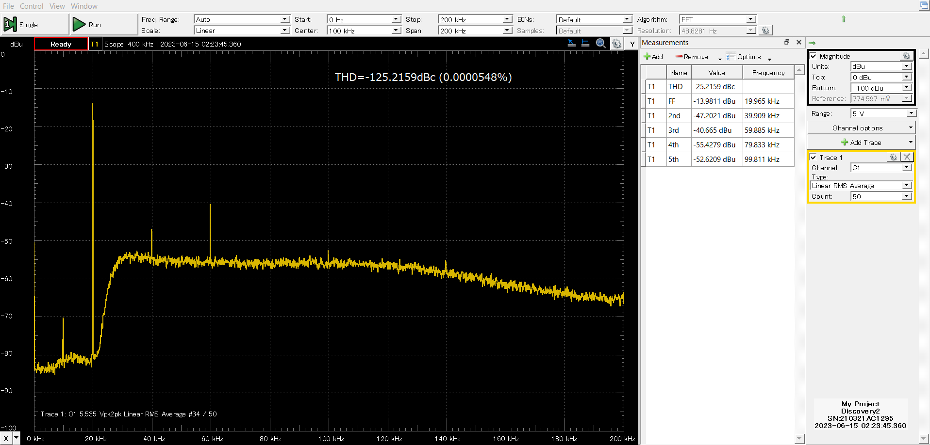

OPA828
THD is calculated as (8.6965mV / 154.39mV) * 0.001 = 0.0000563%

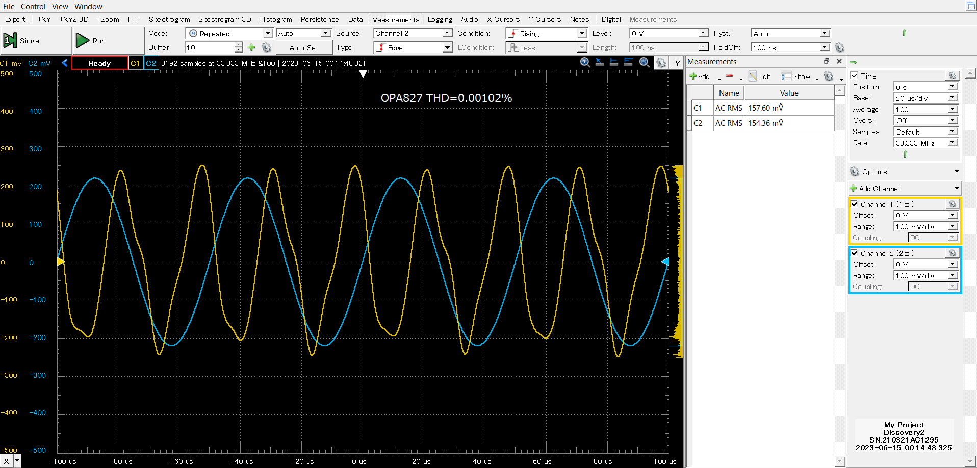

similarly
OPA827
THD=0.00102%

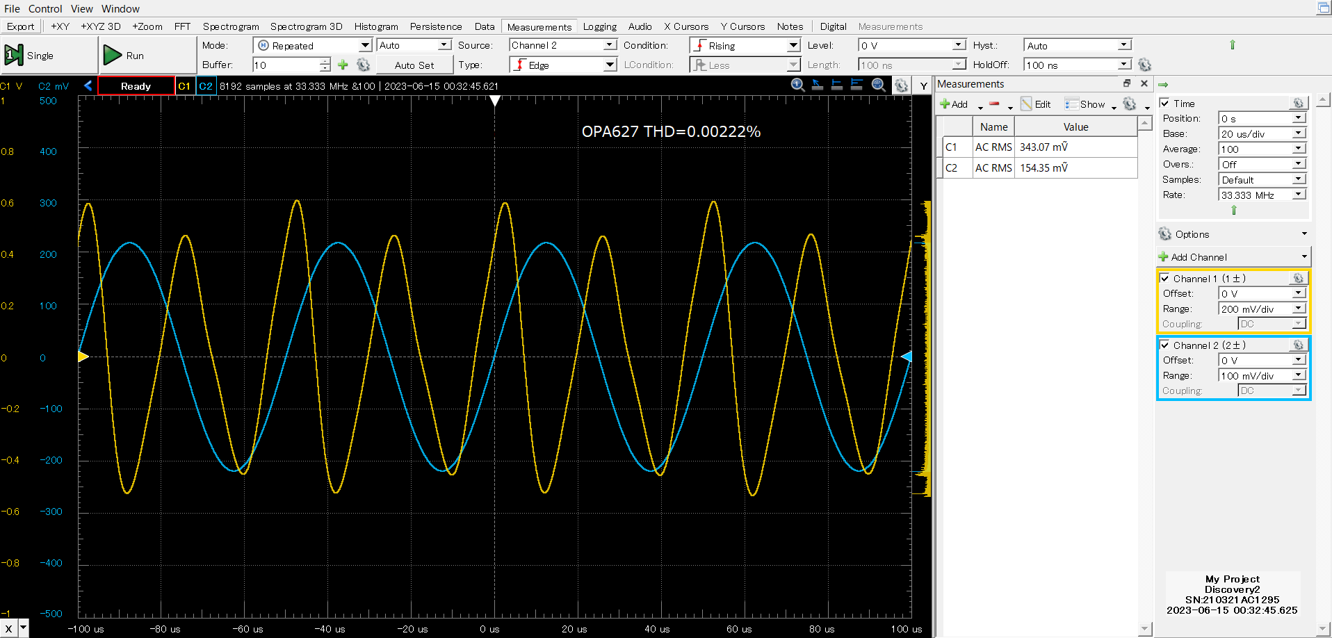

OPA627
The OPA627 has a large distortion component (yellow) and protrudes from the screen of the scope, so the range is changed from 100mV/div to 200mV/div. The yellow waveform is therefore 100 µ/div.
THD=0.00222%

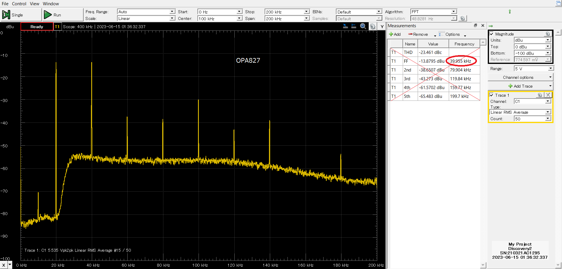

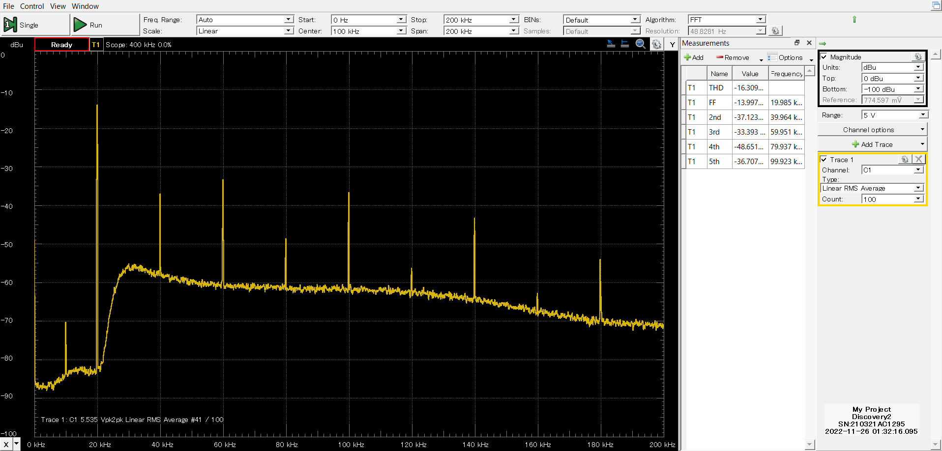

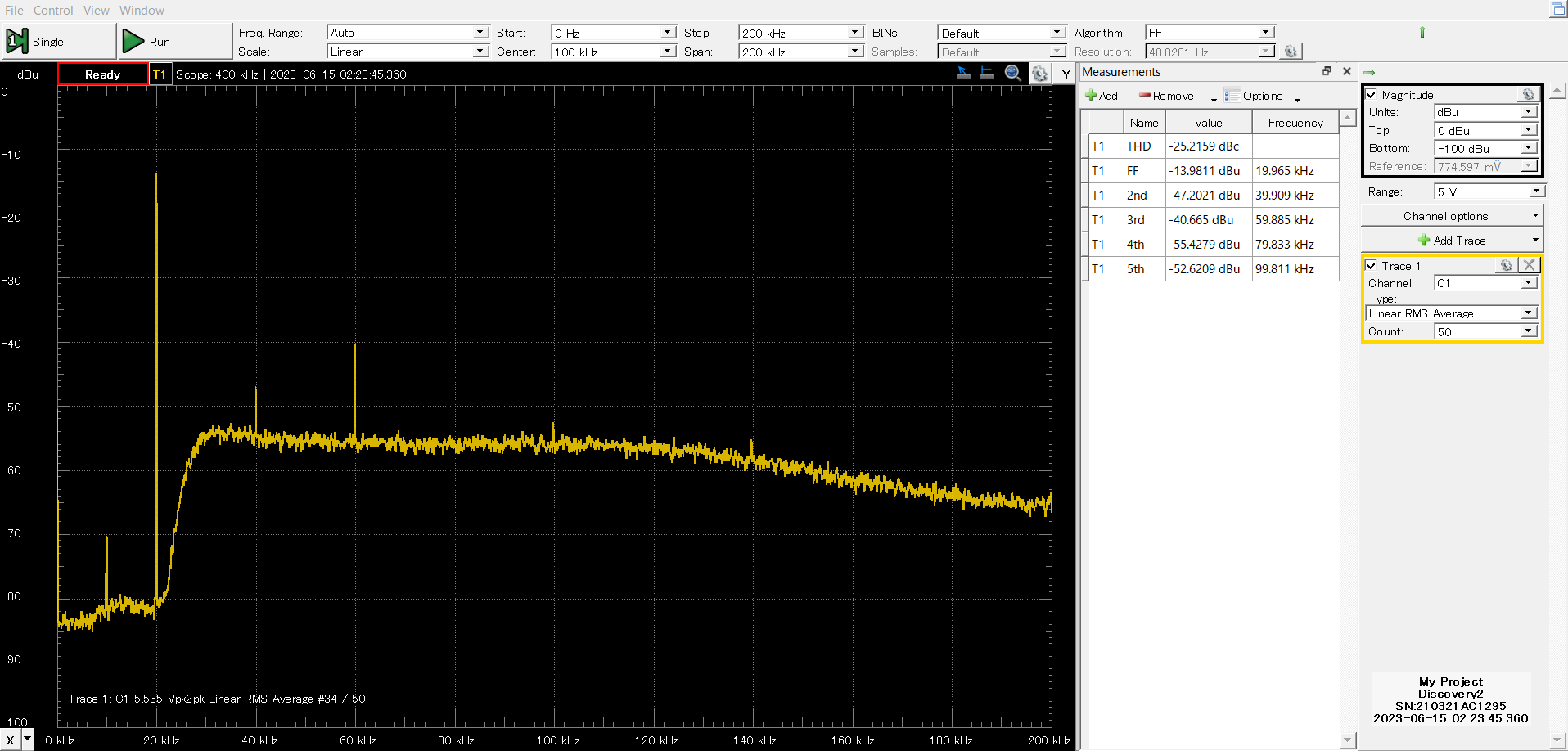

Below is the distortion factor measured using the FFT function.
Since the FFT of Analog Discovery 2 has poor resolution, it can only measure distortion of about -70dBc with raw waveforms. Therefore, FFT is performed on the waveform obtained by adding the above two waveforms.
OPA828
Since the input signal is -34dB and the harmonics are +66dB, the distortion factor is 100dB emphasized and measured. So THD measurement value of -25.22dBc means -125.22dBc=548%.
With OPA827 and OPA627, the second harmonic (40kHz) was larger than the fundamental wave of 20kHz, and 40kHz was regarded as the fundamental wave, so THD could not be measured.:ROFLMAO:
OPA827
OPA627
By the way, is this forum suitable for such individual OP-Amp topics? Or Analog Line Level?

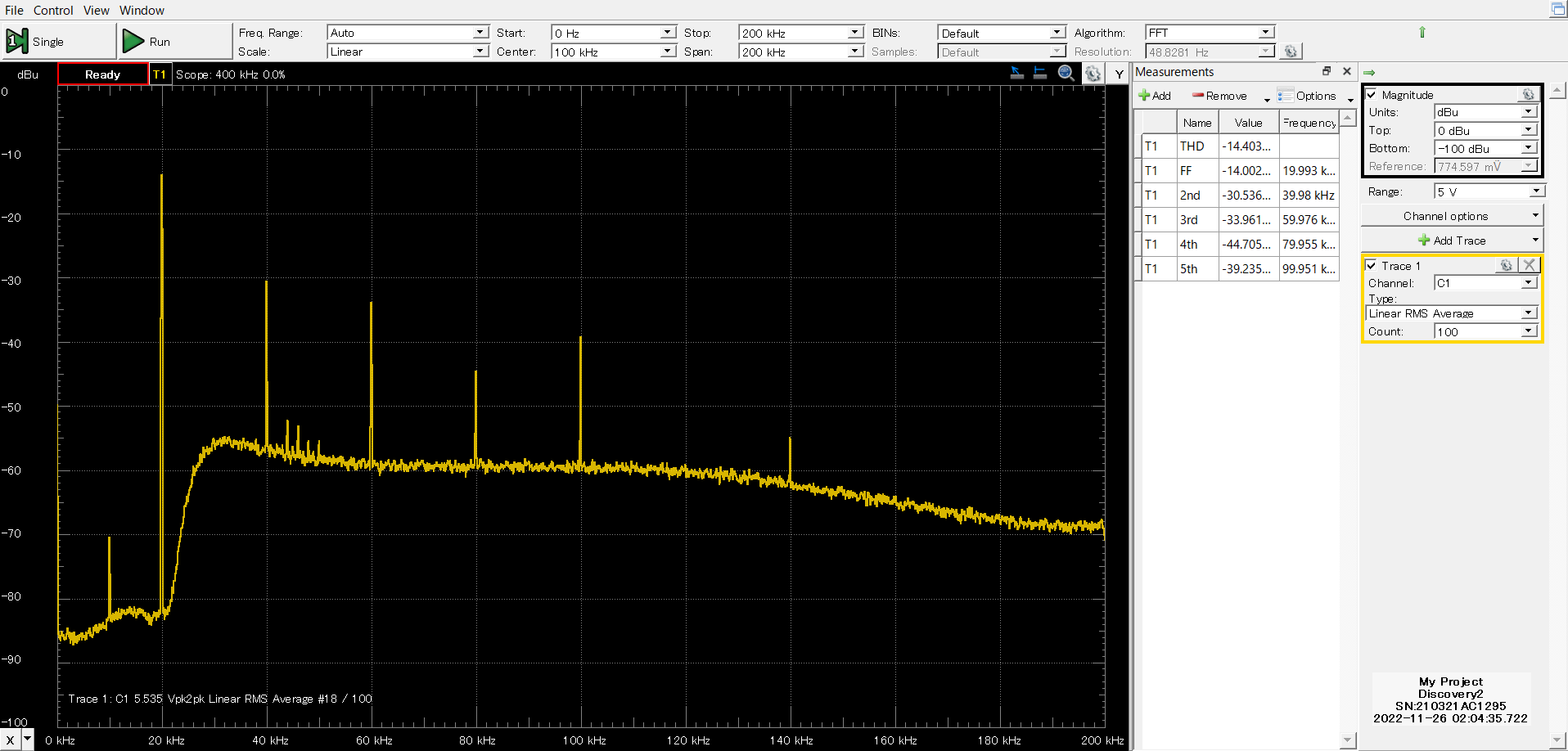

Until the release of the OPA828, ultra-low distortion OP-AMPs only had BJT inputs. Here's one I own with low distortion. The measurement conditions are the same as in #4 post.
AD797
THD=-113.157dBc=0.000220%

The JFT input OPA828 has overtaken all these low distortion OP-AMPs.
In post #4 ”-125.22dBc=548%” is incorrect and Correctly 0.0000548%.
Currently, only the OPA828 measures below -120dBc under these conditions.
Also, the main components of distortion are the low-order components of 3rdHD and 2ndHD.
This point is also different from conventional RtoR output such as OPA1611/1612.

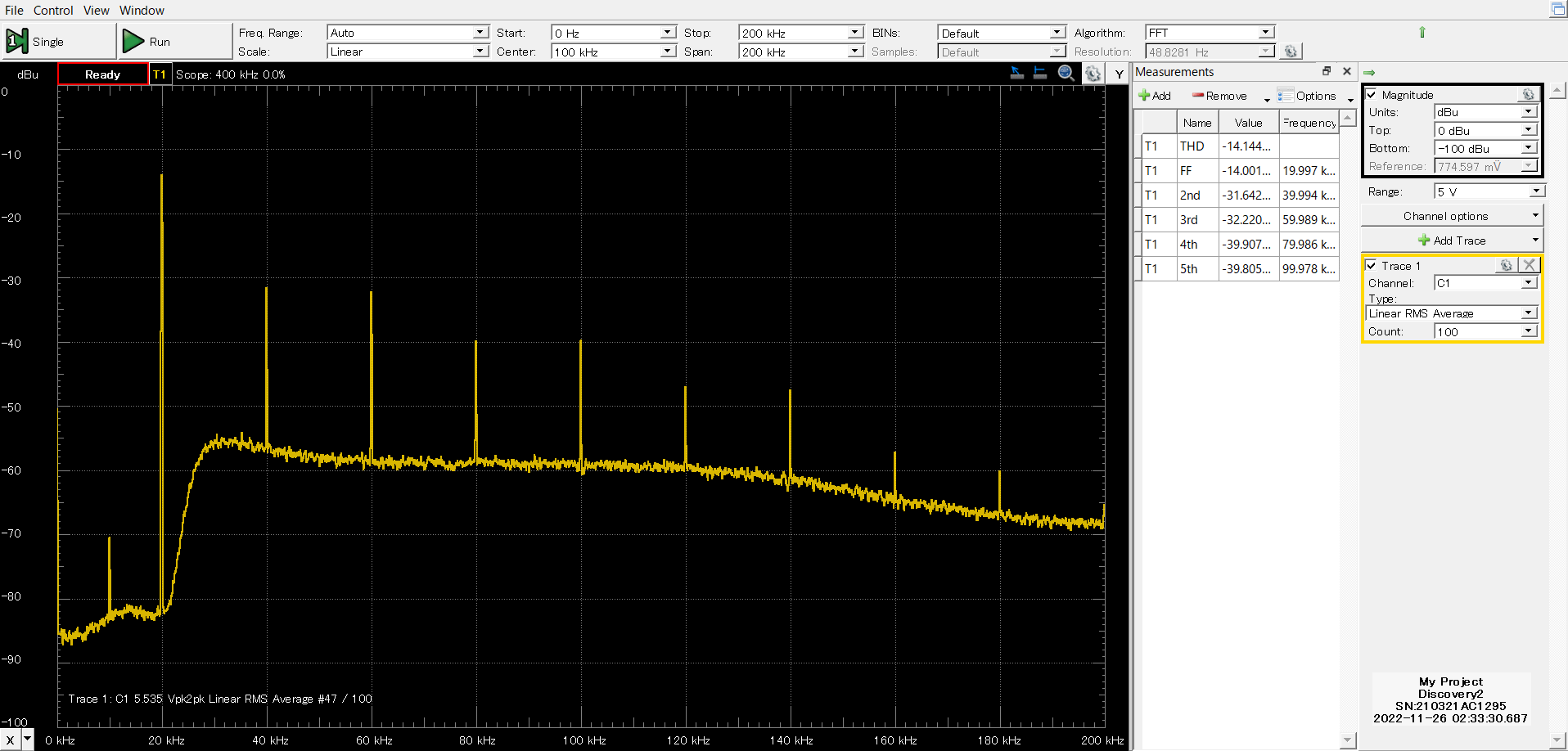

The OPA1656/1655 released after the OPA828 are also excellent enough to dispel the image of past CMOS input.
OPA1655
THD=-114.144dBc=0.000196%

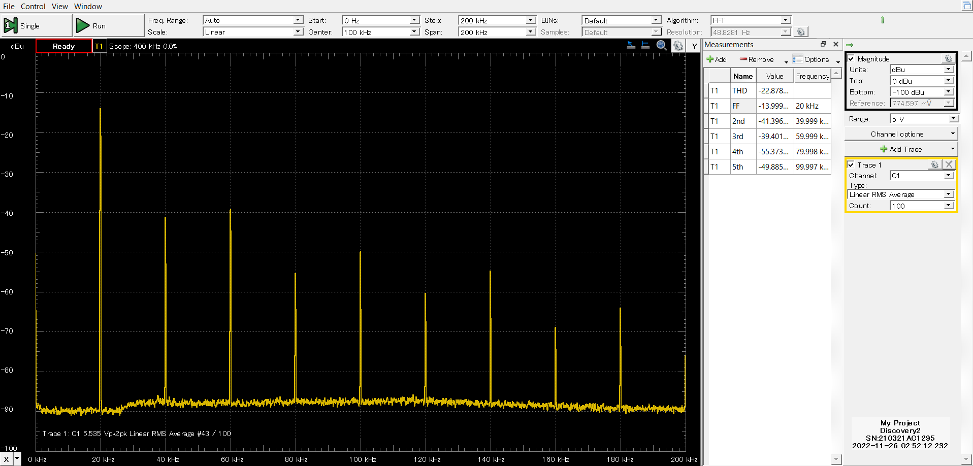

I am measuring OPA1641.
OPA1641
Since the distortion is large, the range of the distortion meter is switched to 20 times (+26dB). Since it is picked up at 10mV/div, read the distorted waveform (yellow) as 500μV/div.
Since the fundamental wave is -34dB and the harmonic is +26dB, the THD is emphasized by 60dB. So the -22.878 dBc measurement is -88.878 dBc = 0.00360%.
Since the OPA1642/1641 have improved common-mode input distortion since the initial release, they are very excellent, so I think they are suitable for the first stage buffer. I found out about it a year and a half ago.
