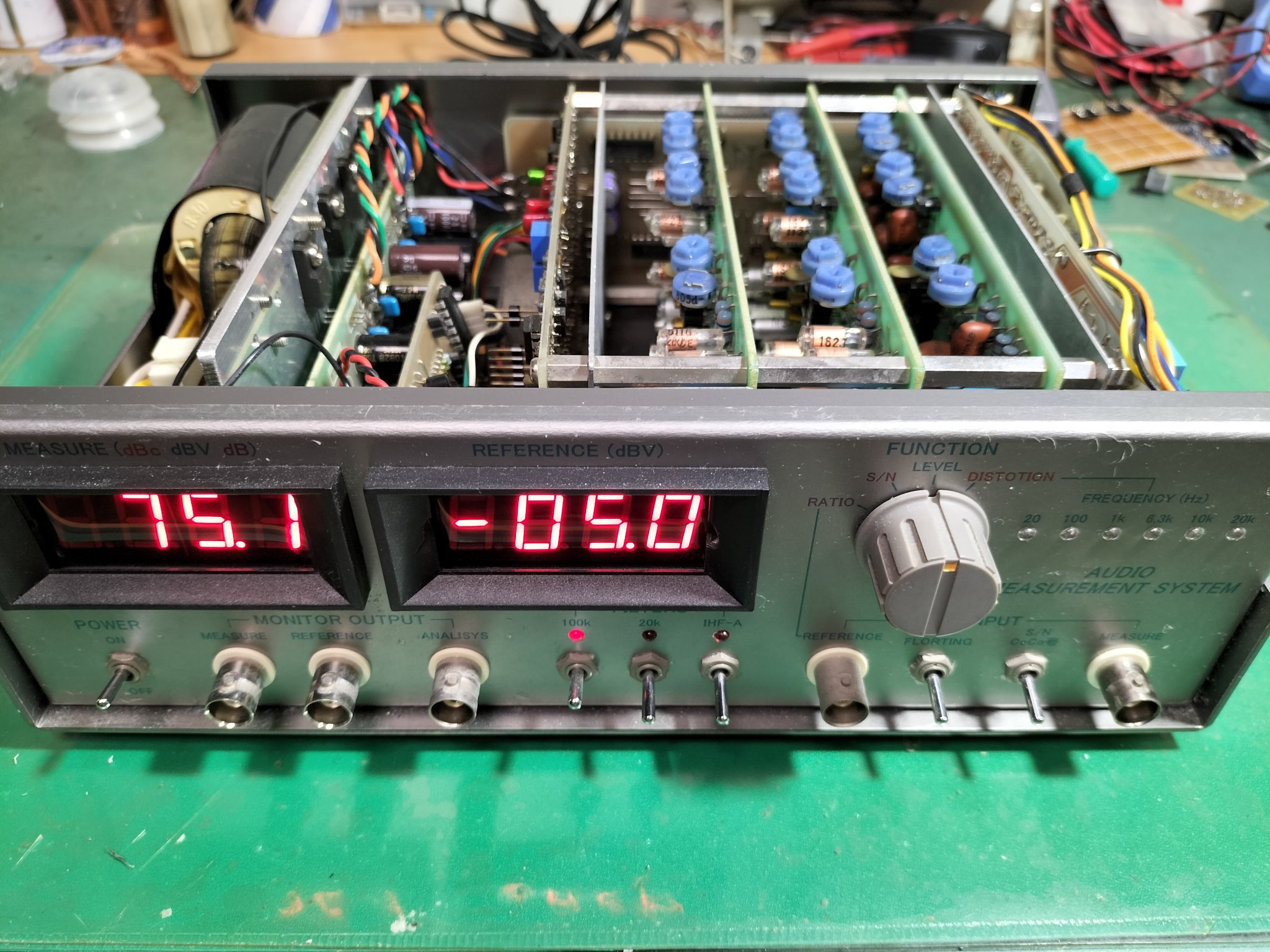

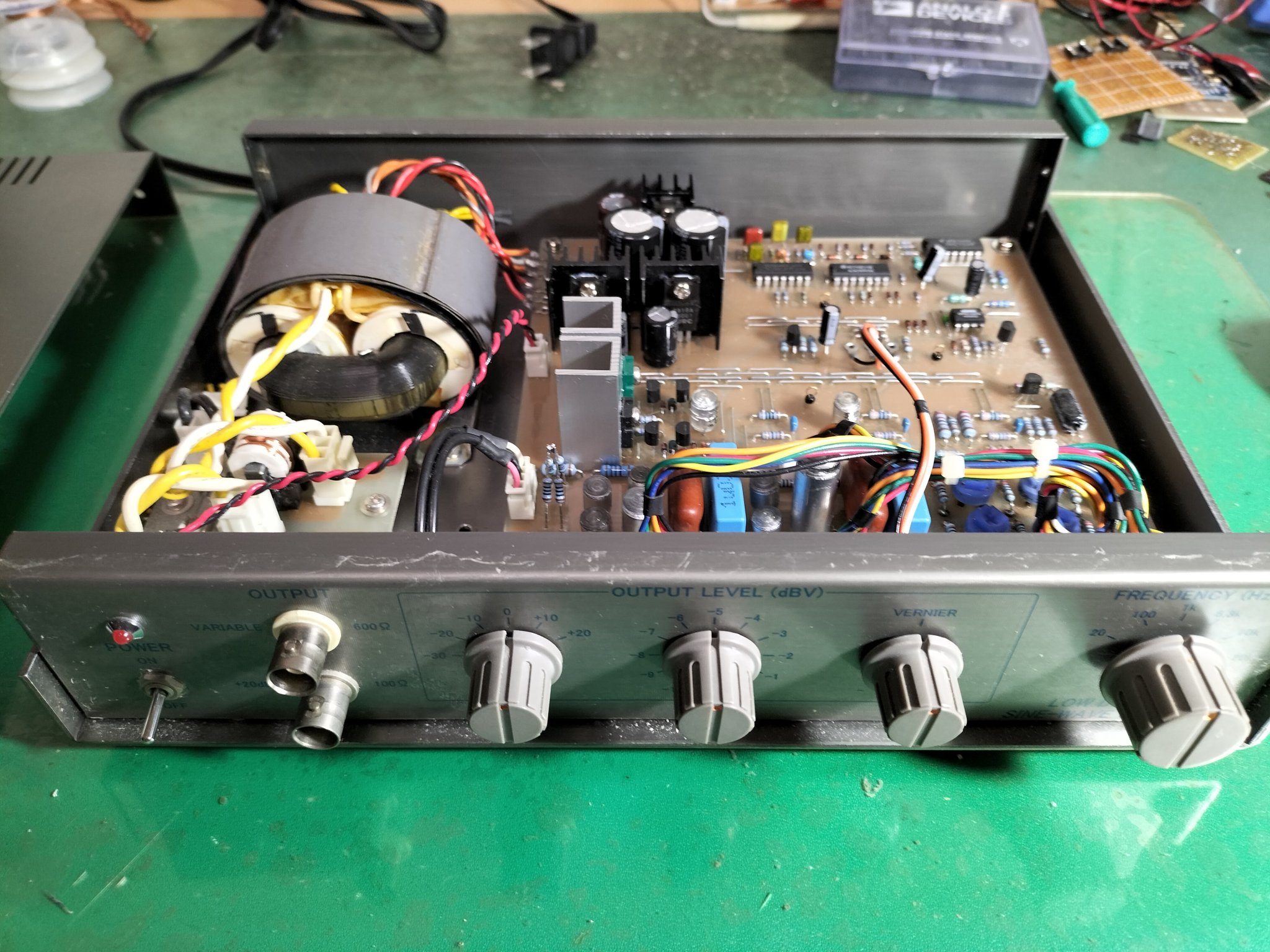

About eight years ago, I designed and manufactured a low-distortion oscillator and an Analyzer mainly for distortion measurement.
The oscillator is a 6-point spot oscillator of 20, 100, 1k, 6.3k, 10k, and 20kHz.
The distortion meter part of the analyzer consists of a notch filter (Twin T) tuned to those frequencies.
The handwriting is ugly, but here is a simplified block diagram of distortion meter part .
Three stages of twin T are stacked so that attenuation of 150dB or more can be obtained even if the frequency of the oscillator or the notch frequency of the twin T drifts due to temperature changes. (Amplified by 26dB after the first-stage twin T.)
This removes the fundamental wave.
After that, it is amplified by 20dB, and 100kHzLPF (3rd order), 20kHzLPF (11th order brick wall), A filter can be selected, and then it is amplified by 20dB.
In other words, the harmonic components removed the fundamental are amplified by 66dB and output to Mon Out.
When the harmonic signal is large, the attenuator of S2 operates and becomes the amplification of 26dB.
Bottom left is the path of the input signal. When the input signal is large, it is amplified by -34dB, and when it is small, it is amplified by +6dB and output from IN MON.
It can calculate the distortion factor by taking AC RMS measurement of these two signals with Analog Discovery and dividing them by considering the amplification (attenuation) of each.
The bottom right circuit sums these two outputs and outputs to ANALISIS.
Assuming all the switches are arranged like this block diagram, the input signal (which can be thought of as the fundamental) is attenuated by -34dB and the harmonics are summed with the signal amplified by 66dB, so ANALISYS outputs a waveform with 100dB distortion emphasized. FFT this signal with Analog Discovery and measure it with the THD measurement function. Subtract the 100dB boost from this value to get the true THD. This enables ultra-low distortion measurements even with low resolution FFT functions.
By the way, when I saw the circuit diagram for the first time in a while, I noticed that this adder has a jumper pin. And when the short plug is set to the 30kΩ side, the distortion signal is attenuated by -20dB and added. On this side...
With OPA827 and OPA627, the second harmonic (40kHz) was larger than the fundamental wave of 20kHz, and 40kHz was regarded as the fundamental wave, so THD could not be measured.🤣
THD can be measured without this happening!
I completely forgot about it.
8 years ago me, great!

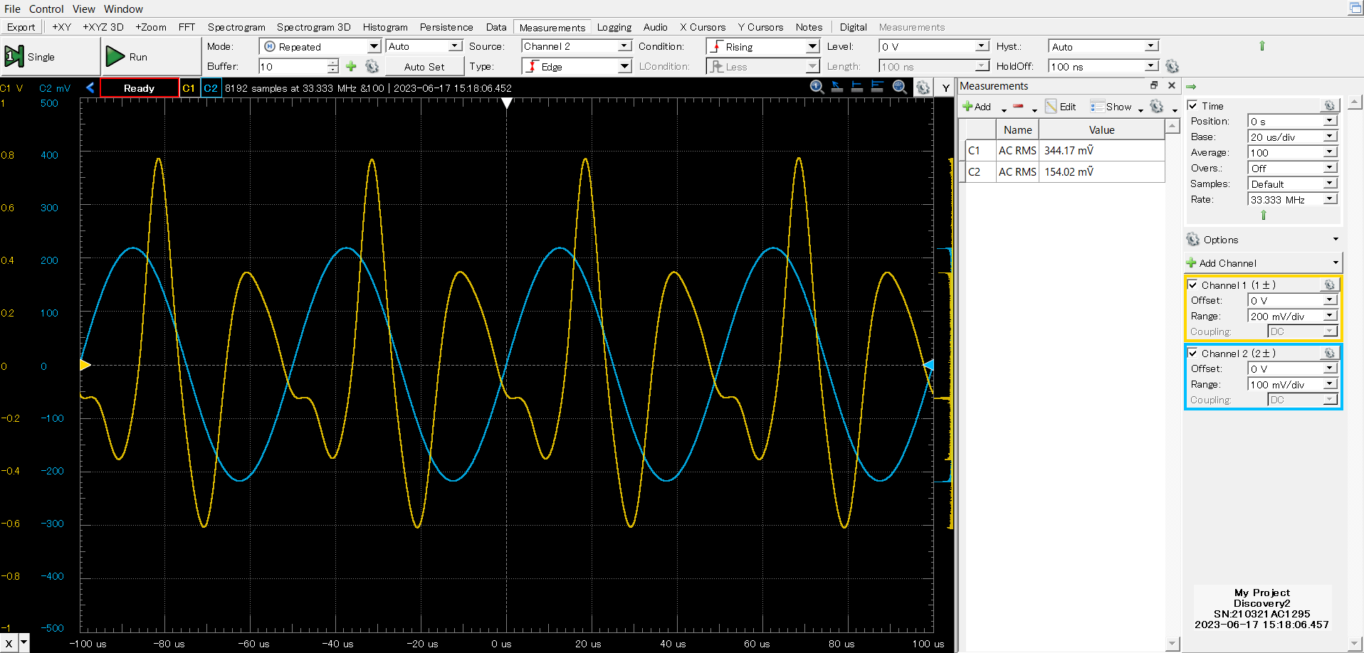

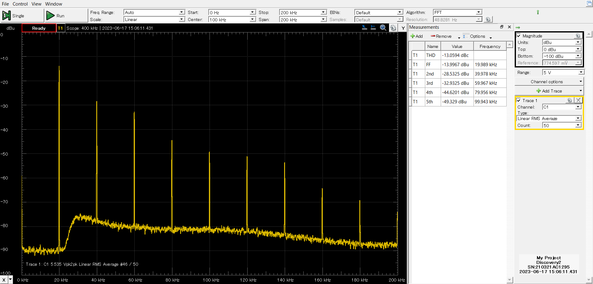

It would also be interesting to measure the performance of the ADA4898.
I had previously taken data of ADA4898, but because it was measured by FFT that emphasized the 100dB distortion rate, 40kHz was regarded as the fundamental wave and THD could not be measured.
So I switched the jumper pin mentioned in post #33 to the 30kΩ side and remeasured as 80dB emphasis.
ADA4898-1
Cyan is 5V/div, yellow waveform is 100 µ/div.
(344.17mV/154.02mV) * 0.001=0.00223%
80db emphasis, so THD=-93.059dBc=0.00222% (almost same as above)
AD (including LT) has not yet been released that surpasses the AD797 in measurement under this condition.

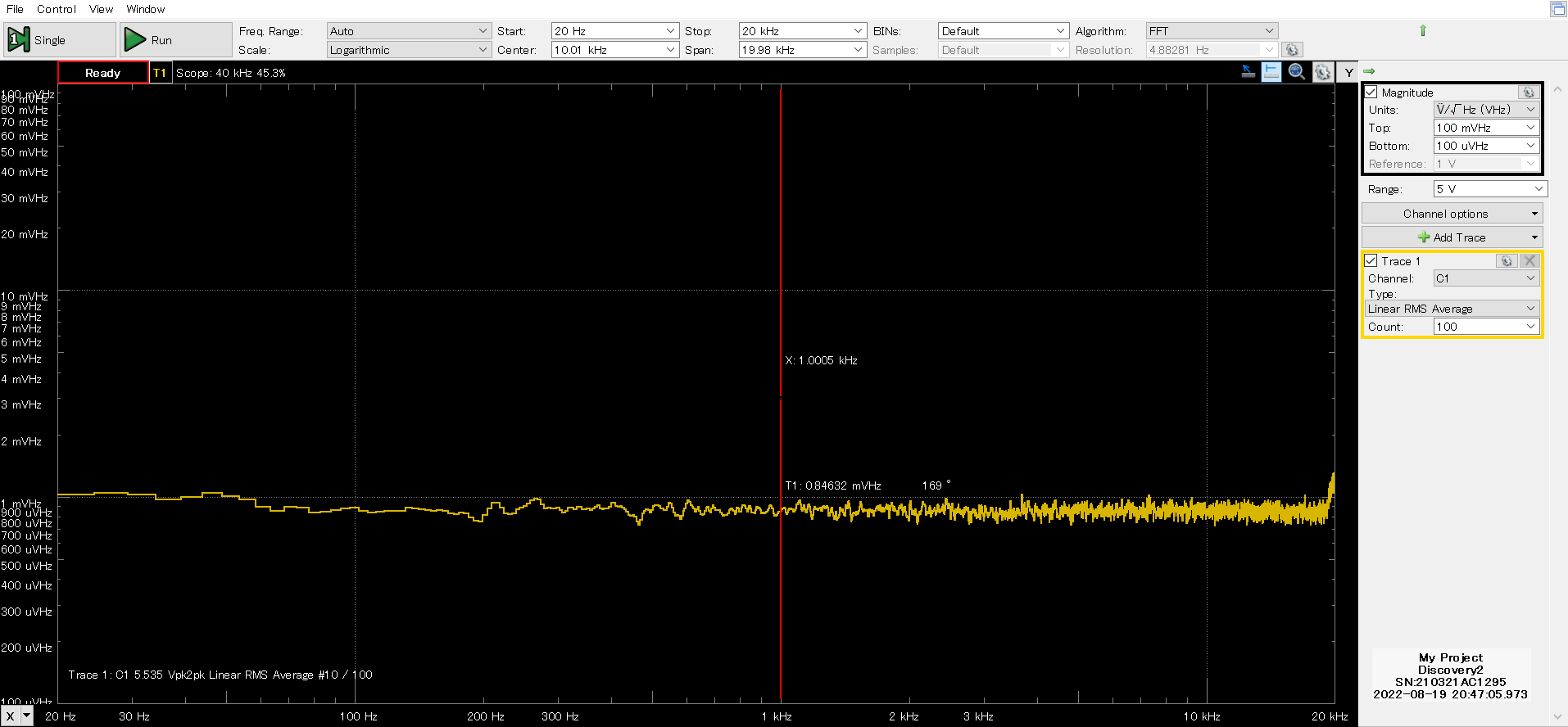

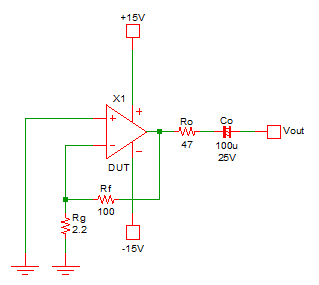

I'm sure there are people who are interested, so I'm attaching the data I measured for the noise density of an OPAMPs with a spec of 0.9nV/Hz (@1kHz).
Shows the measurement circuit.
In the subsequent circuit, adjust the total gain to 120dB across a 20kHzLPF (11th brick wall).
Therefore, 1mV/√Hz corresponds to an input referred noise density of 1nV/√Hz.
The rise around 20kHz is due to aliasing from the LPF (which was used for CDP in the days when there was no digital filter oversampling) decay start slightly above 20kHz.
AD797
ADA4898-1
LT1028
LT1115
LME49990
Repeatedly, pity for the discontinue.

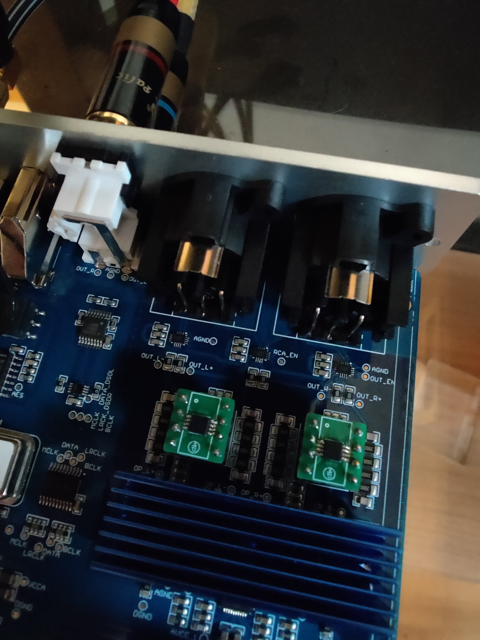

I made a small adapter for HVSSOP to DIP 8 including thermal pad for the 2828. It was a challenge to get it soldered. The sound of this OPAMP is indeed bliss, and extremely neutral with a very wide soundstage. I can understand why people, like the 627, might feel it sounds 'thin'. It's very, very transparant with lots of micro detail, yet it doesn't hurt your ears. Not a hint of sybilance when decoupled properly.
