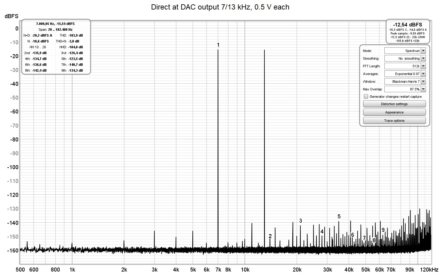

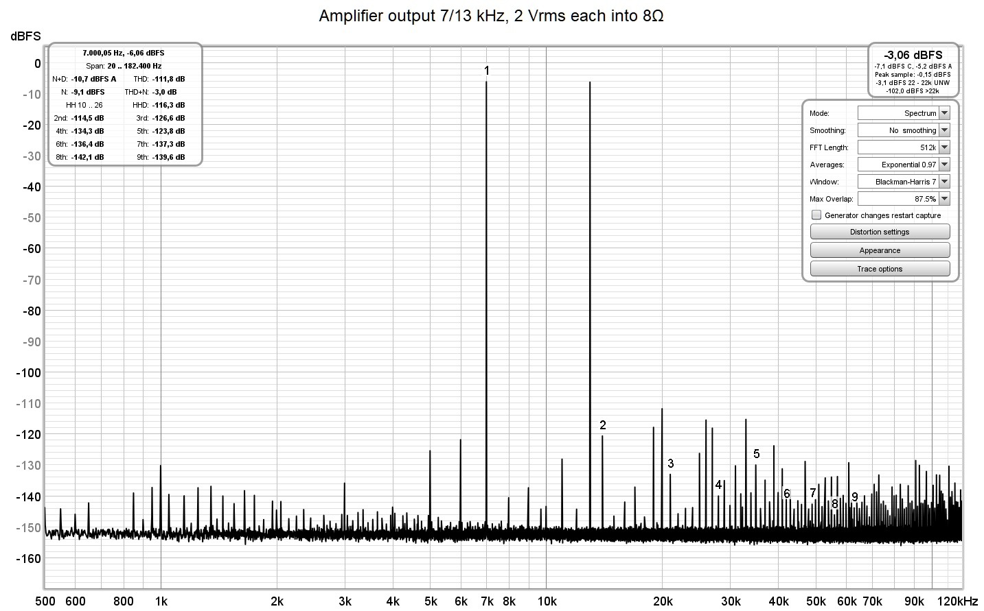

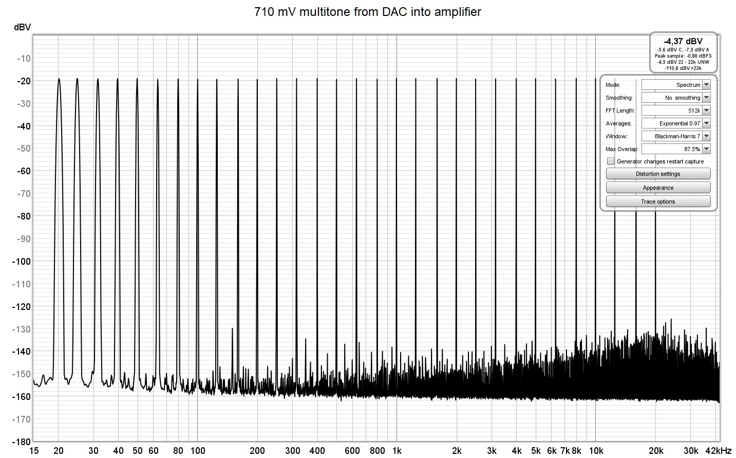

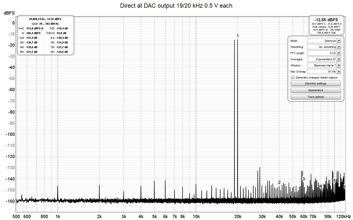

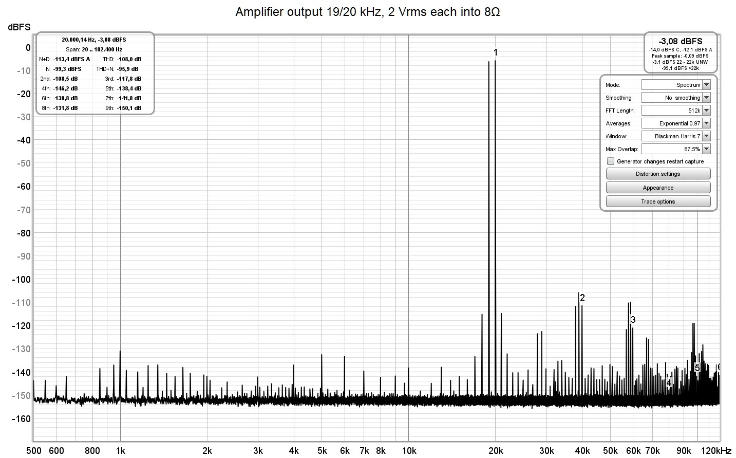

I’ve compared power amplifier measurements and don’t see, in this particular case, what better insight would 7/13 kHz test provide. I believe that, as is usual, it is better to make even more measurements and then try to draw conclusions. This can be considered as measurement of OPA828 as a first stage in power amplifier. Half of measured distortion is DAC contribution. 🙂
Final measurement is 31 tone signal which produces 16 Vpp at amplifier output.

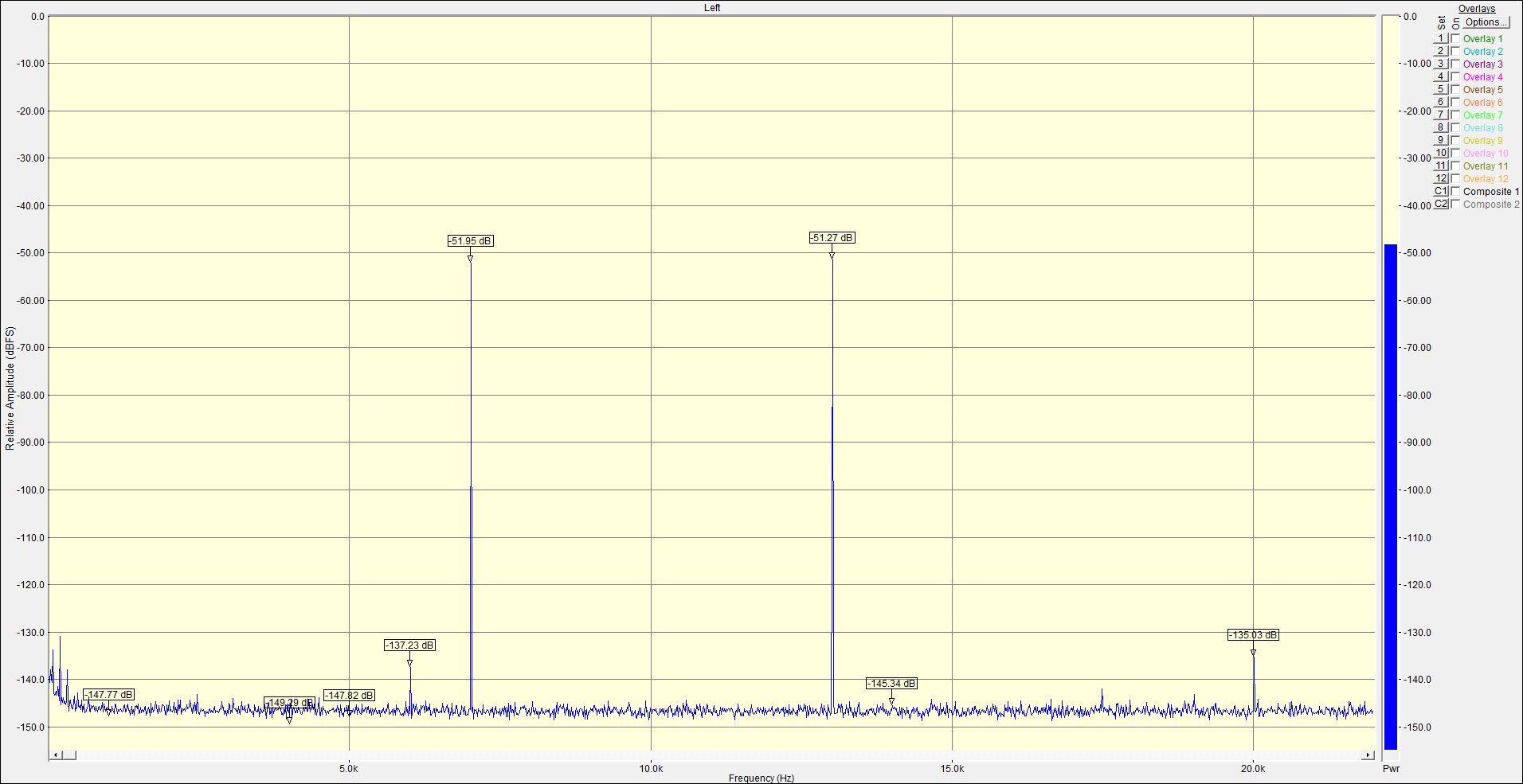

Anyway, to look at the residual, you'd need to completely notch out the test signal from the DUT output, and IMO that would be complicated. A distortion analyzer would normally use an auto-tuning notch filter to suppress the (only) fundamental. With a two- or multi-tone test signal, you'd need two or more auto-tuning notch filters, and I have not seen that done.
In contrast, it is easy to reduce the test signal in the DUT output by 50-60dB, enough to keep the ADC from adding its own IM products, so that the spectrum shows you IM products from your DUT and not from your measurement rig. However, the resulting signal is still dominated by the test signal, and that's what you'd see on the 'scope:

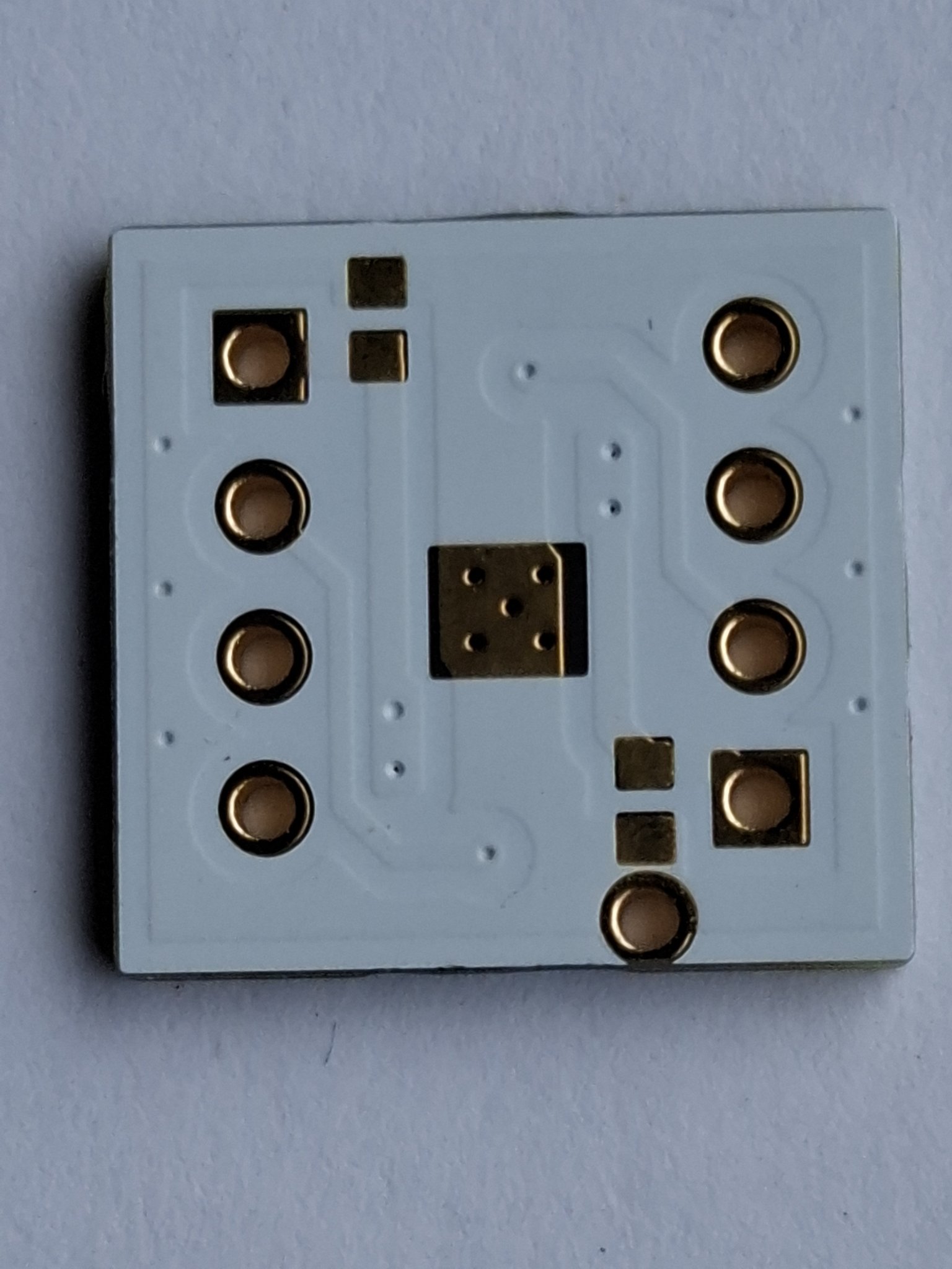

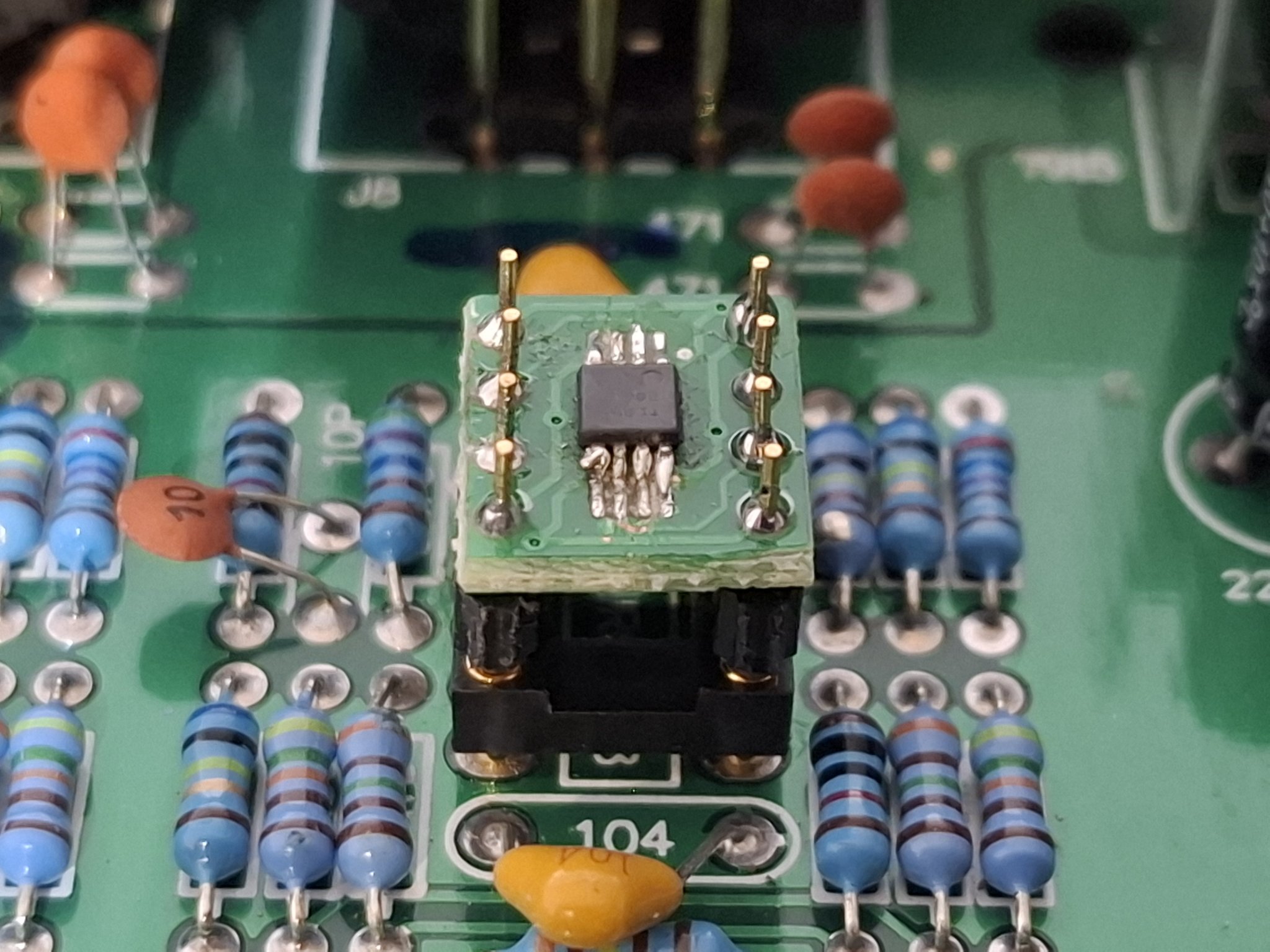

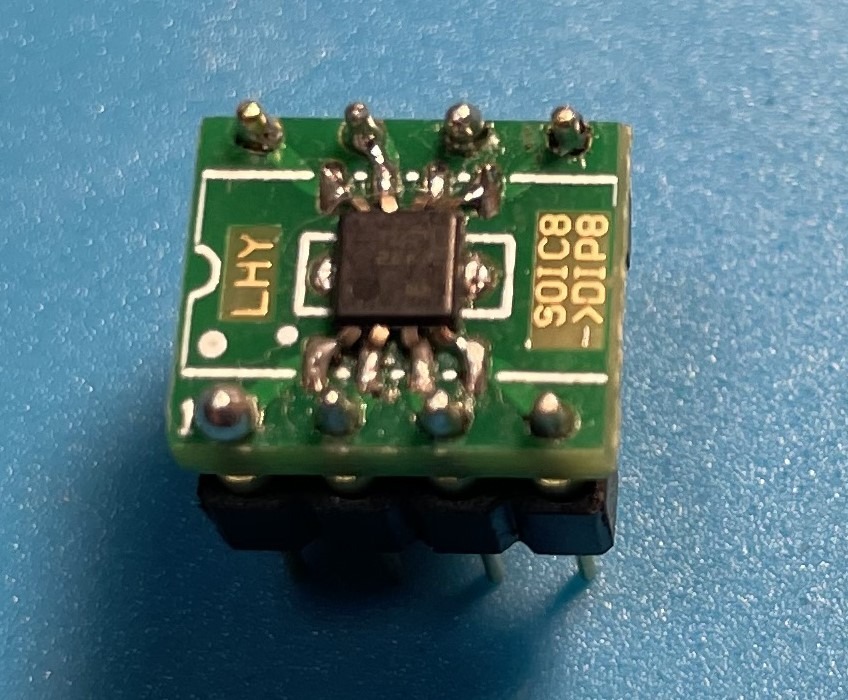

I made a small adapter for HVSSOP to DIP 8 including thermal pad for the 2828. It was a challenge to get it soldered. The sound of this OPAMP is indeed bliss, and extremely neutral with a very wide soundstage. I can understand why people, like the 627, might feel it sounds 'thin'. It's very, very transparant with lots of micro detail, yet it doesn't hurt your ears. Not a hint of sybilance when decoupled properly.
Any chance you could make the (adapter for HVSSOP to DIP 8 including thermal pad for the 2828) available, or the PCB design file?

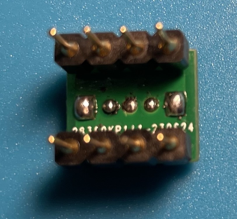

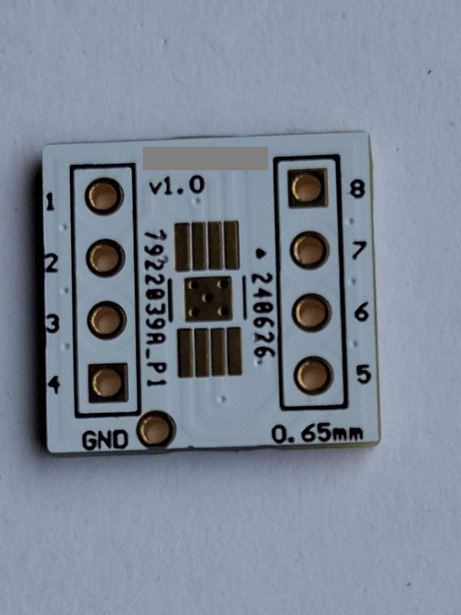

I did it using this adapter for soic8 with thermal pad. You need to bend the amplifier leads very carefully, it can easily be damaged. The soldering was done under a microscope. Without certain skills it is better not to repeat

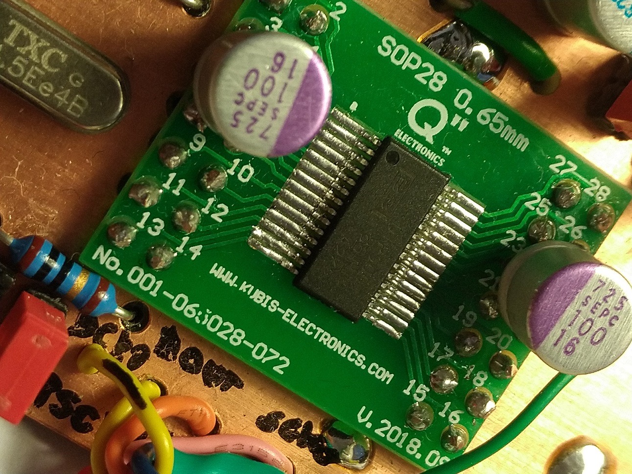

TSSOP, VSSOP can be soldered with ordinary hand soldering, but with the help of a vacuum pump and a lot of liquid flux.It is normal that experience with a soldering iron is required. Pictured is DIR9001, TSSOP28.

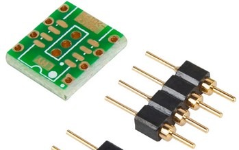

Mouser offers this adapter for op amps from TI that makes it a little easier.
