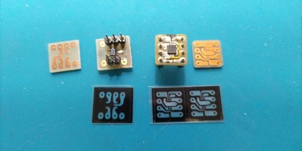

I made a small adapter for HVSSOP to DIP 8 including thermal pad for the 2828. It was a challenge to get it soldered.
Recently, the number of op-amps in packages that are not friendly to DIYers, such as SOT-23 and WSON, has increased.
The OPA1688 also has a different pinout from the standard.
I couldn't find a conversion board on the market, so I made a conversion board by exposing and etching myself.

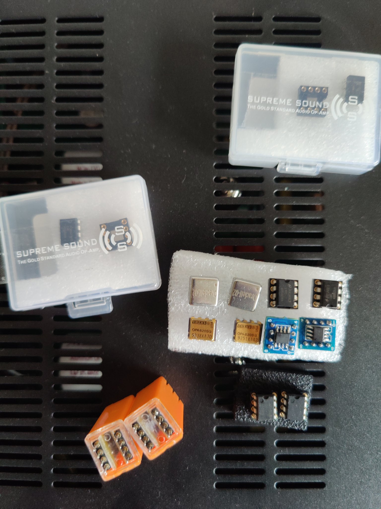

I have a line-up of different opamps I have been comparing. So far I have not tried the 1642, but I'll get some.Aint that right!
@mason_f8: no worries, I still like OPA1642
Okay, so I took your advise and ordered a pair of OPA1642. I have now listened to them for about half a day...
I agree they are great! Slightly less transparent when compared to the OPA2828, but they offer a bit more punch in the lower region, so they don't sound thin-ish like the 828.
I need to listen more, but overall they seem to strike a very nice balance. I don't have a clear winner, pros and cons. Time will tell....
