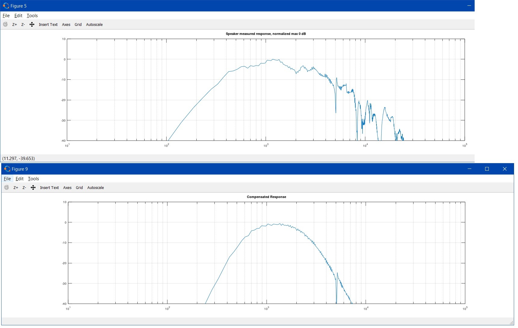

As you can see from my post I was referring to the plot in post 982 that showed a graph of the midrange response that looked rough. See it here: https://www.diyaudio.com/community/goto/post?id=6130046 . Other midrange drivers I have used had less variation in the response I've measured. An example would be the Aurasound 2" Whisper driver. I made no reference to your cross over filters when I talked about using an FIR filter to correct the response of the midrange, so I'm not sure how that is moot. As an example I created such a filter myself for the Volt driver. The figure below shows my own measurement of the Volt midrange and the response after applying DSP filtering to smooth the response and apply band limiting. I think that illustrates my point pretty well. I attached octave .m (saved as a .txt ) file used to generate the compensation FIR filter. The target response can be changed easily by editing the cutoff frequencies in the script should anyone want to use it. To run you would need to provide your own impulse response measurements for the system input to output loop back and the driver impulse response measurement as a .wav file. I think there are sufficient comments in the code to help someone get it to work. The calculations work but there is no error checking to make it robust. I was unable to attach example .wav files.I am not quite sure what you mean by "rough response" or "reflection response". I can't see anything unexpected with the Volt response measured in the OSMC baffle (see Fig. 2 here: https://github.com/mbrennwa/osmcdoc/blob/master/osmc_paper.pdf ).

Ok, I believe I understand what you did, makes sense. However one needs to keep in mind that the OSMC was not about a "perfect" on-axis SPL curve. The off-axis response is just as important for what we hear. The diffraction effects need to be factored in by looking at the dispersion pattern and the power response. Correcting diffraction effects in the on-axis response is usually not a good idea. (See also the OSMC paper.)
Not to put too fine a point on it, but at the upper end of the frequency range covered by the driver, it is becoming directional such that it isn't illuminating the edges of the cabinet with those frequencies, so there should be little or no diffraction effects for that range. Cabinet diffractions happen at the lower end of the range of each driver in a system when they become close to omnidirectional. Placing a microphone right at the cabinet edge and taking a measurement will of course confirm of deny this for any given design as the response there dips where the drivers become directional. Comparing the driver response with it mounted in a very wide test baffle vs the smaller finished cabinet will also show the effect. You are right that basing the equalization applied based on a single measurement isn't optimal. Averaging the response from several measurements over a small listening window is best. My simple script doesn't do that as most commercial software does. For a forward controlled dispersion design, I don't worry too much about the spectrum over a wider dispersion as sound reflected off room surfaces will have large irregularities depending on the surface properties and angles of the reflecting surfaces. Of course for an omnidirectional or very wide dispersion design an even response at all frequencies is more important. By the way, very nice work on the speaker design and cabinetry. My cabinet building skills are privative and the results often look like I used and axe. It's great when people go to the trouble to document and share designs and measurements for others to use.Ok, I believe I understand what you did, makes sense. However one needs to keep in mind that the OSMC was not about a "perfect" on-axis SPL curve. The off-axis response is just as important for what we hear. The diffraction effects need to be factored in by looking at the dispersion pattern and the power response. Correcting diffraction effects in the on-axis response is usually not a good idea. (See also the OSMC paper.)

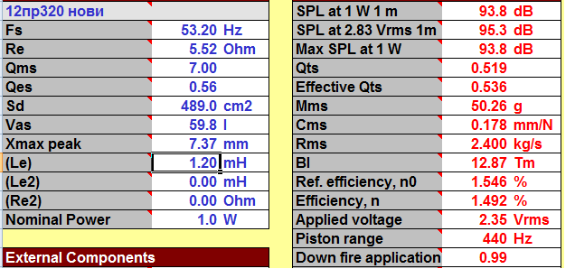

Here are measured TS parameters out of the box for 12pr320

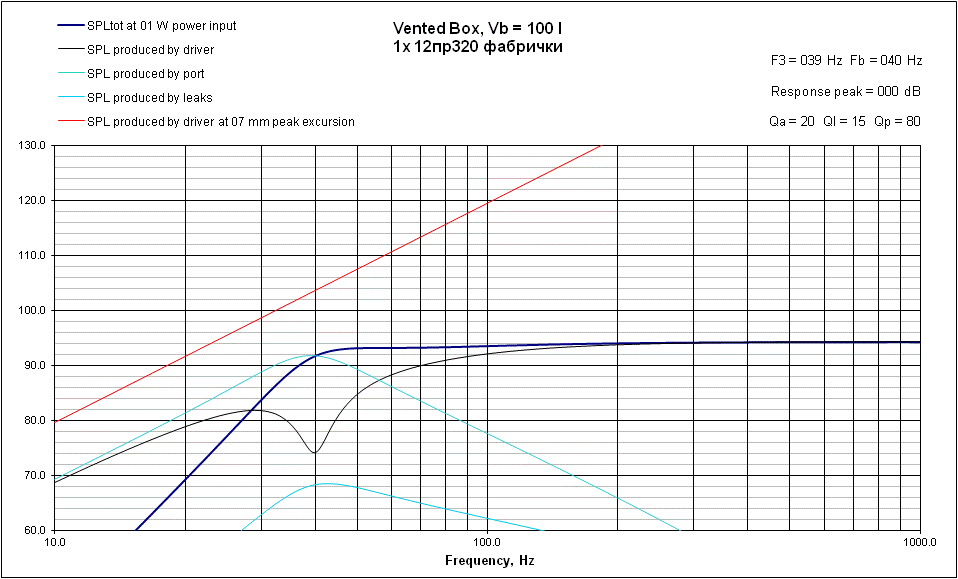

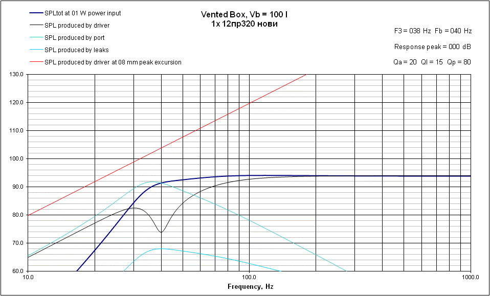

Here is simulated low frequency response for TS from datasheet and measured:
Measured out of the box
Factory TS
