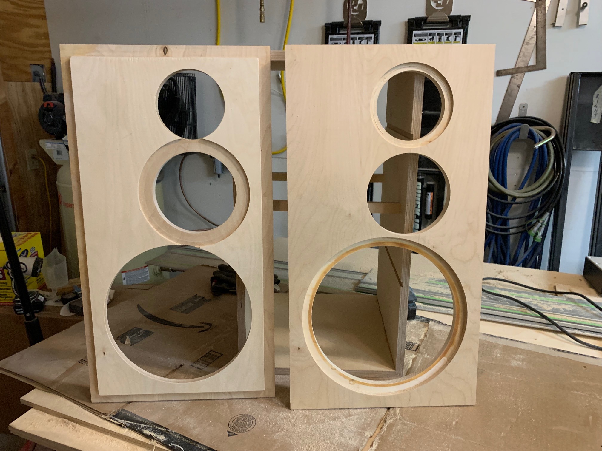

After 2 more surgeries, I am finally recovered enough to get back into my shop:
I could not find 20mm material for the front baffle. These measure 25mm. I had to "thin" the back behind the midrange to create the 20mm depth that it requires.
I found a sound absorption product (Owens Corning 703) that has almost identical absorption specs to the Basotect. Any issues using something like this?

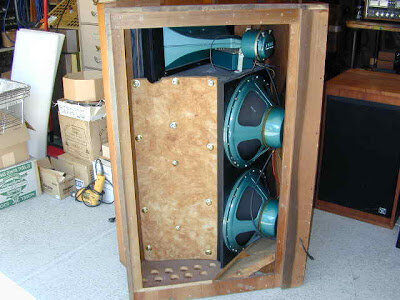

I am not familiar with the Owens Corning stuff. Looks like fiberglass. I guess that should work okay, just give it a try and see how you like it. You can always experiment with the amount of damping material.I found a sound absorption product (Owens Corning 703) that has almost identical absorption specs to the Basotect. Any issues using something like this?
Here is a link to the pdf for the 703 stuff: https://dcpd6wotaa0mb.cloudfront.ne...lation-Product-Data-Sheet.pdf?v=1644155734000
It is. Works great in lieu of the typical polyester fill, just install it flush with these nails. '50s era version of it installed.

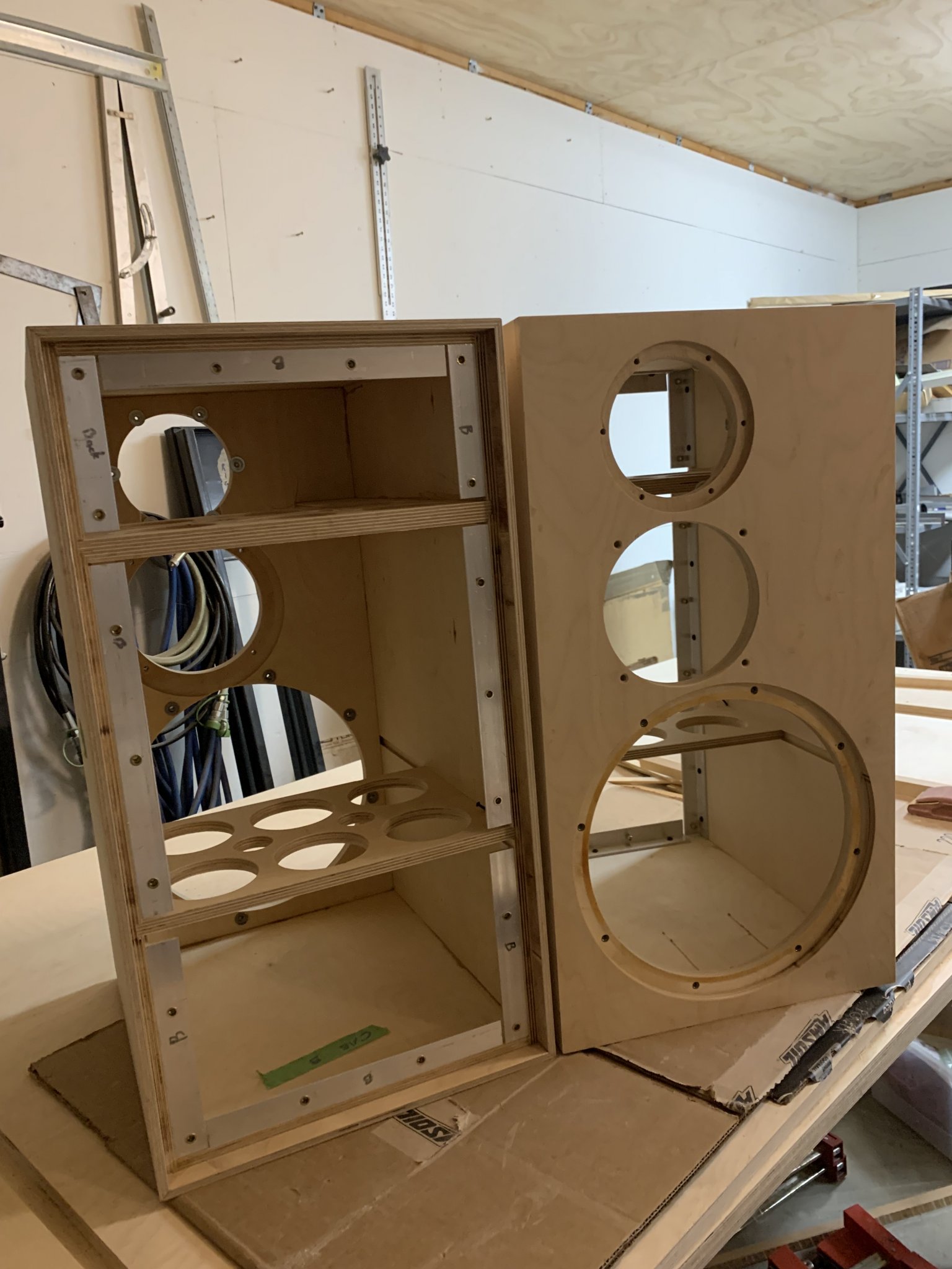

More progress (baffles and bracing are glued). Some sanding sealer in the near future.
