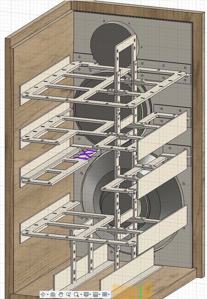

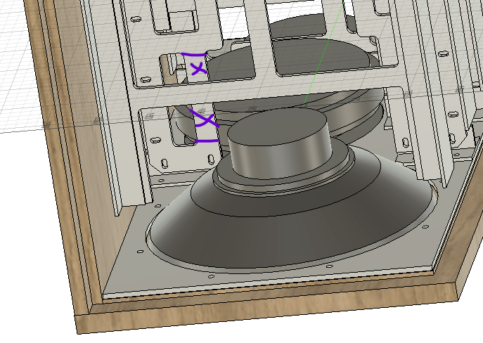

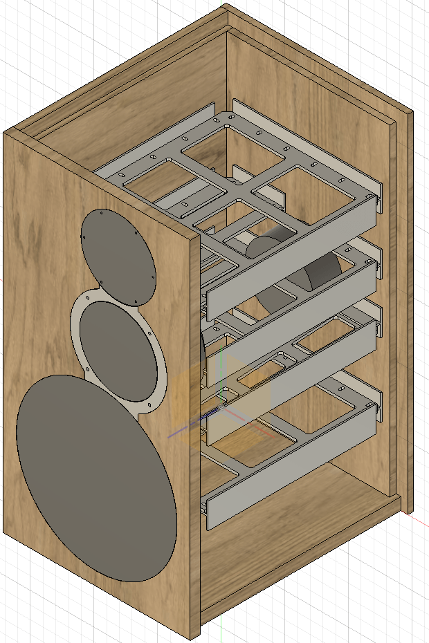

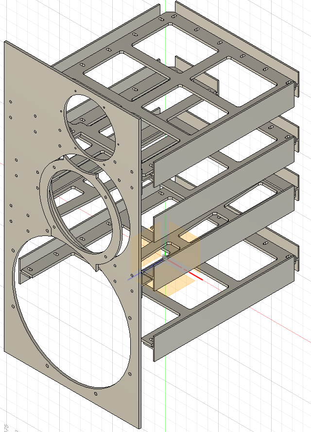

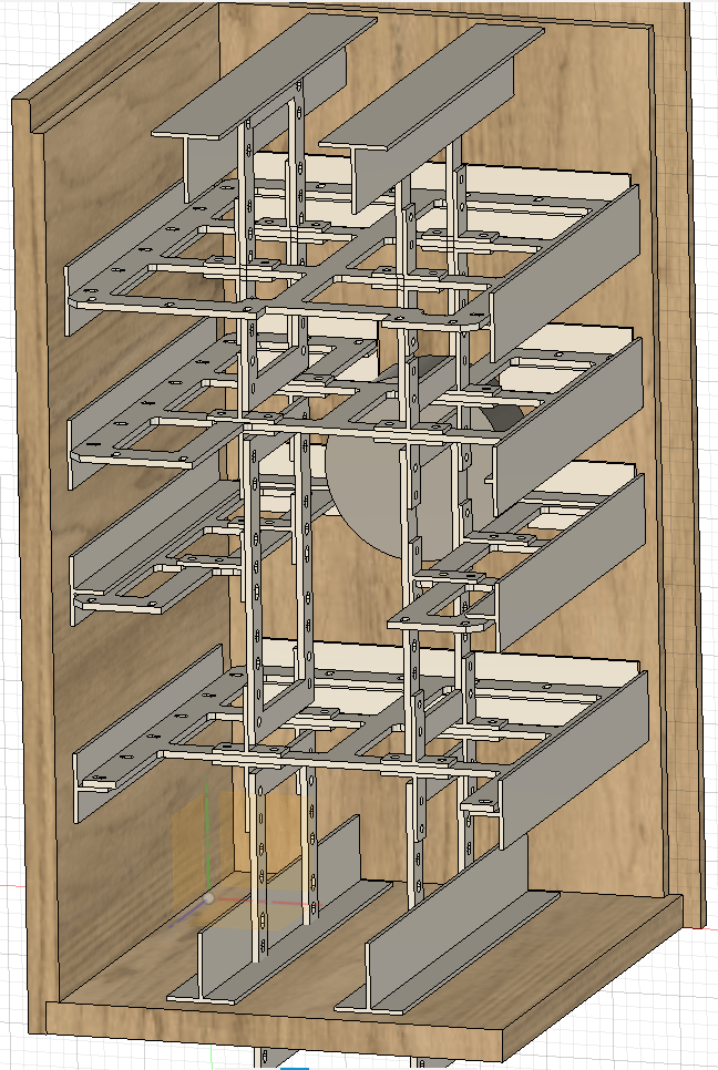

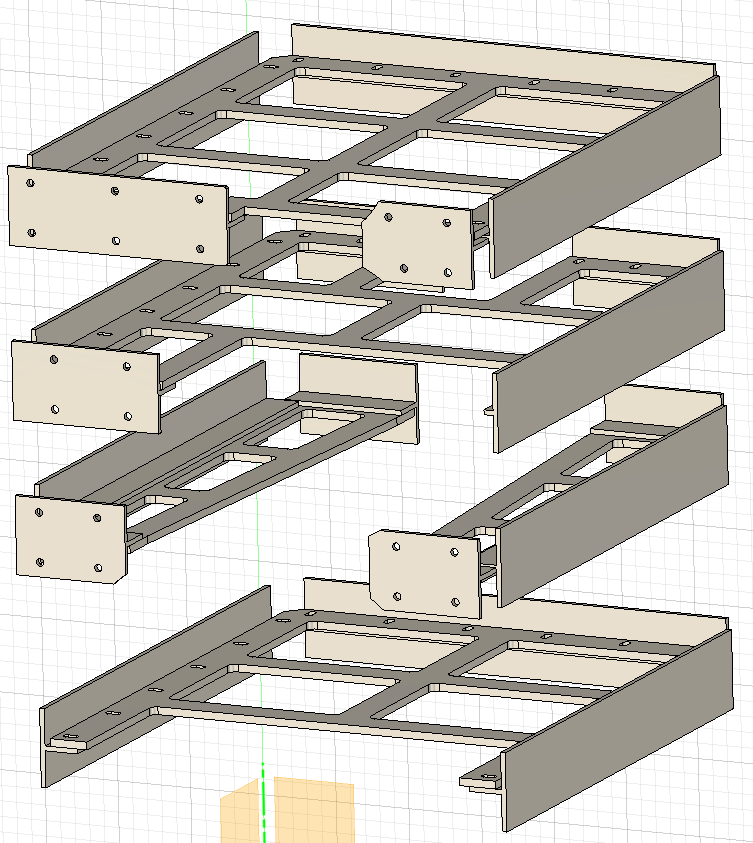

I started the woodwork for the OSMC last year, getting the outer pieces for the boxes done with rabbet joints. Then I attended Munich and could not get over the clarity in sound and instrument separation heard from Magico speakers, so I did a little research. Building carbon fibre enclosures with constrained-layer damped baffles (and/or braces) was beyond my capabilities, but I decided to at least take one point on board: never screw drivers into wood. Also, I felt that there is maybe too little bracing in the original OSMC design. So I taught myself Fusion 360 and came up with aluminium mounting plates and braces, and I am looking for feedback before I actually implement this.
The drawings below are aimed to nail down the aluminium mounting plates and braces, so the speaker drivers and reflex tube are dumbed down. I did not model the screws and threads but you can see where the holes are.
The tee profiles would be around 3mm thick, 2 inch wide and 1 inch high, getting them into shape would be a manual job.
All other aluminium would probably be 5mm thick, made by laser cutter. Threads and countersinking (not shown in drawings) would again be manual. These thicknesses are significantly less than what Magico uses for its alu braces, and I don't see why such thicknesses would be required for the OSMC. However, no modelling (finite element analysis) has been attempted to estimate required brace thicknesses.
The mounting plates and tee-profiles would be bonded to the plywood with epoxy, e.g. West System. There would be no screws threading into the wood. All screws, e.g. for the drivers, thread into aluminium. Apparently epoxy can bind alu and wood well enough, but this would be a rigid bond as opposed to the flexible bond chosen by @mbrennwa for his build. The vertical distances between braces vary a little and are all between 4 and 6 inches. Would this cause problems because enclosure resonances are pushed into a relatively narrow frequency range?

Ignore the protruding vertical braces:
Also, don't forget to add some braces at the top and bottom.
There is enough space to mount the Volt from the inside. Will have to remove the highlighted bit though.Make sure nothing is getting in the way with the magnet of the Volt.
