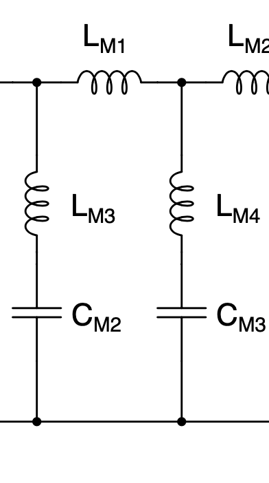

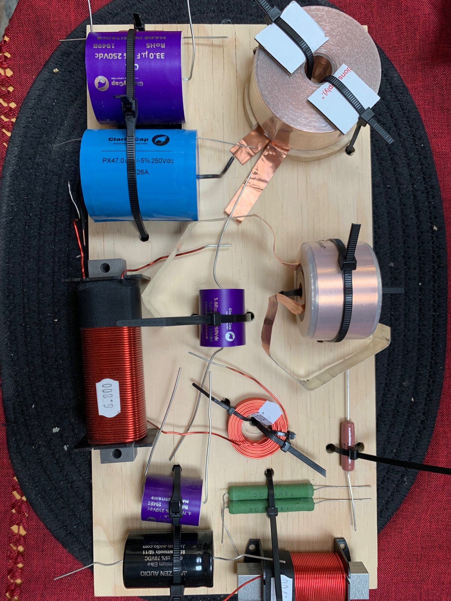

Question on ordering of capacitors and inductors to ground in the crossover:
Does order matter? L -> Cap -> ground vs Cap -> L -> ground.
It would be convenient for board layout to change a couple of them.
I am not quite sure I understand your question. Can you make a quick drawing or show photos of your L/C/GND arrangement in question? Also, which board are you referring to?Question on ordering of capacitors and inductors to ground in the crossover:
The ones from the midrange (L-M3 -> C-M2 -> GND and L-M4 -> C-M3 -> GND).
Wanting to swap to C-M2 -> L-M3 -> GND and C-M3 -> L-M4 -> GND
Ah, ok, yes, you can swap the positions of C-M2/L-M3 and C-M3/L-M4. You might also consider moving the large foil inductor from the top right in your photo to the top left (and move the purple and blue caps from top left to top right). This would increase the distance to the other inductors a bit, which is always good to reduce cross-coupling.
