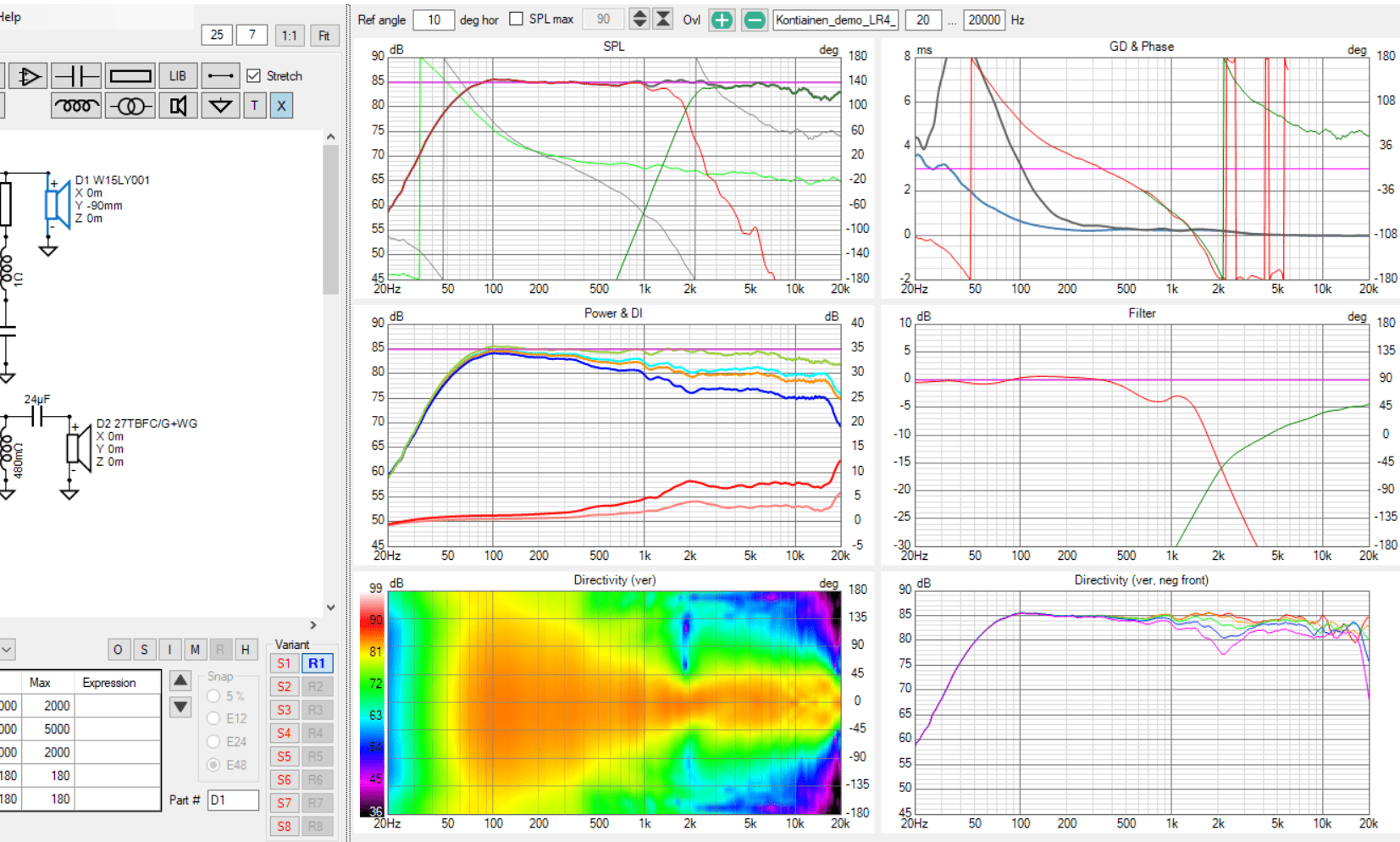

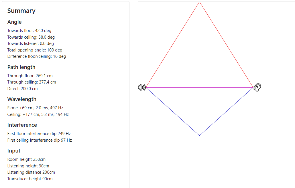

Some numbers into calculator says at 3m listening distance ~10 degrees is about ~50cm, so small head movement while seated happens within few degrees and quickly simplifying people between 1m and 2m tall all have ears within 10 degrees when seated. Just keep the nulls outside of this, what ever is the application and requirements, and it should be fine.

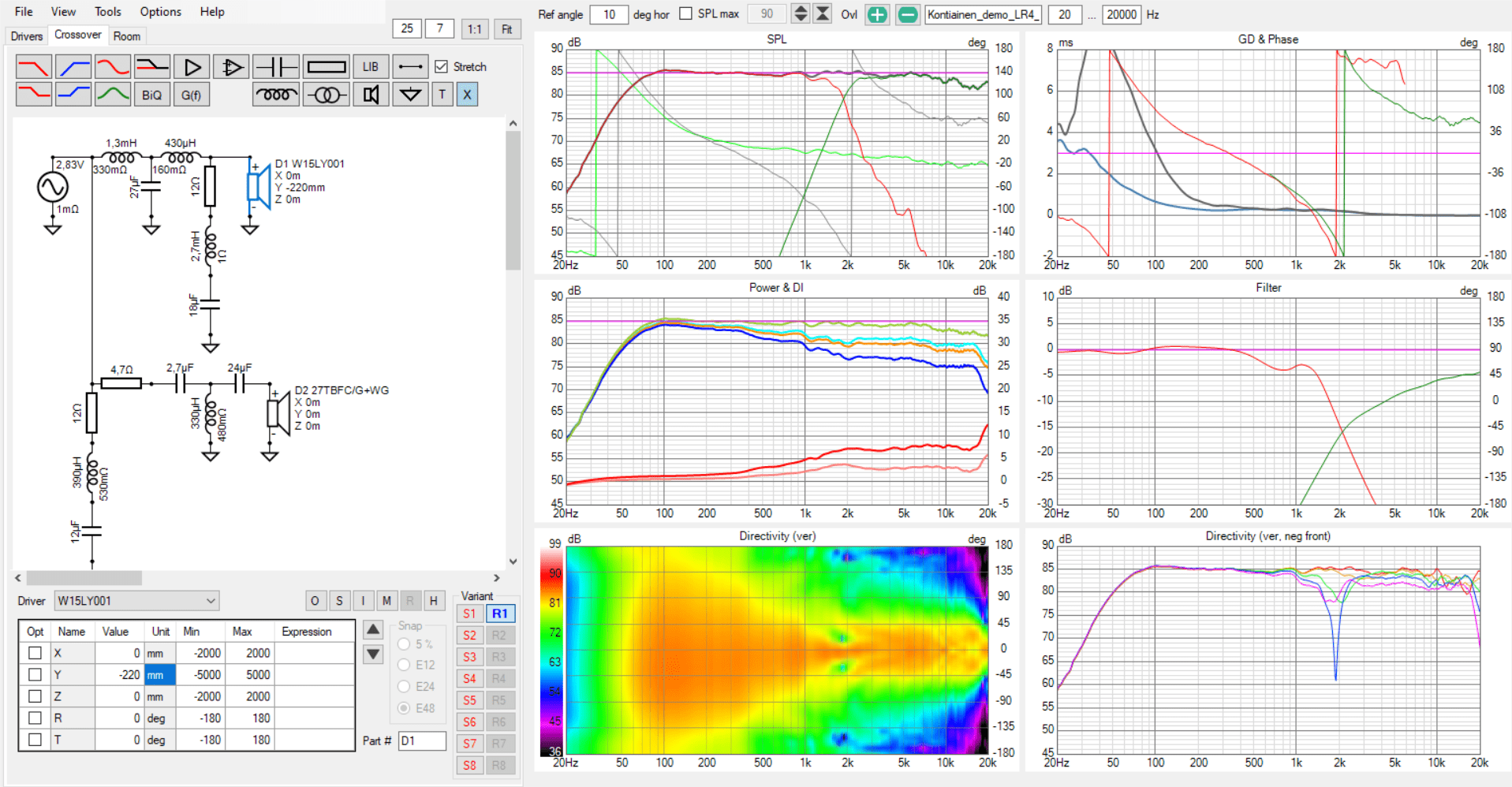

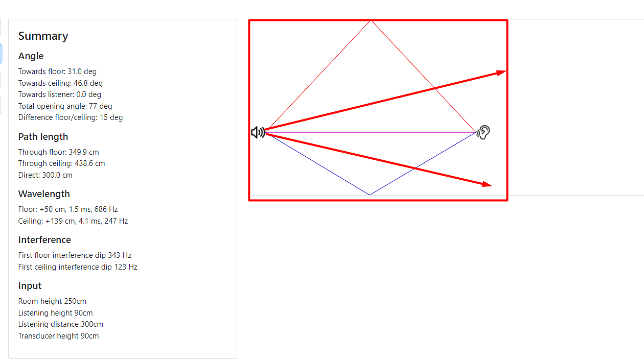

The thing is, the sound that shoots to an angle between the first ceiling/floor reflection and ear take many boundary reflections before hitting the listening position making them into the room reverberant field and not to early reflections. Basically they would have come back all the way to front wall to get to listening position, maybe 3th order reflection. It would be great if the nulls can be pointed here, and it depends on everyones application.

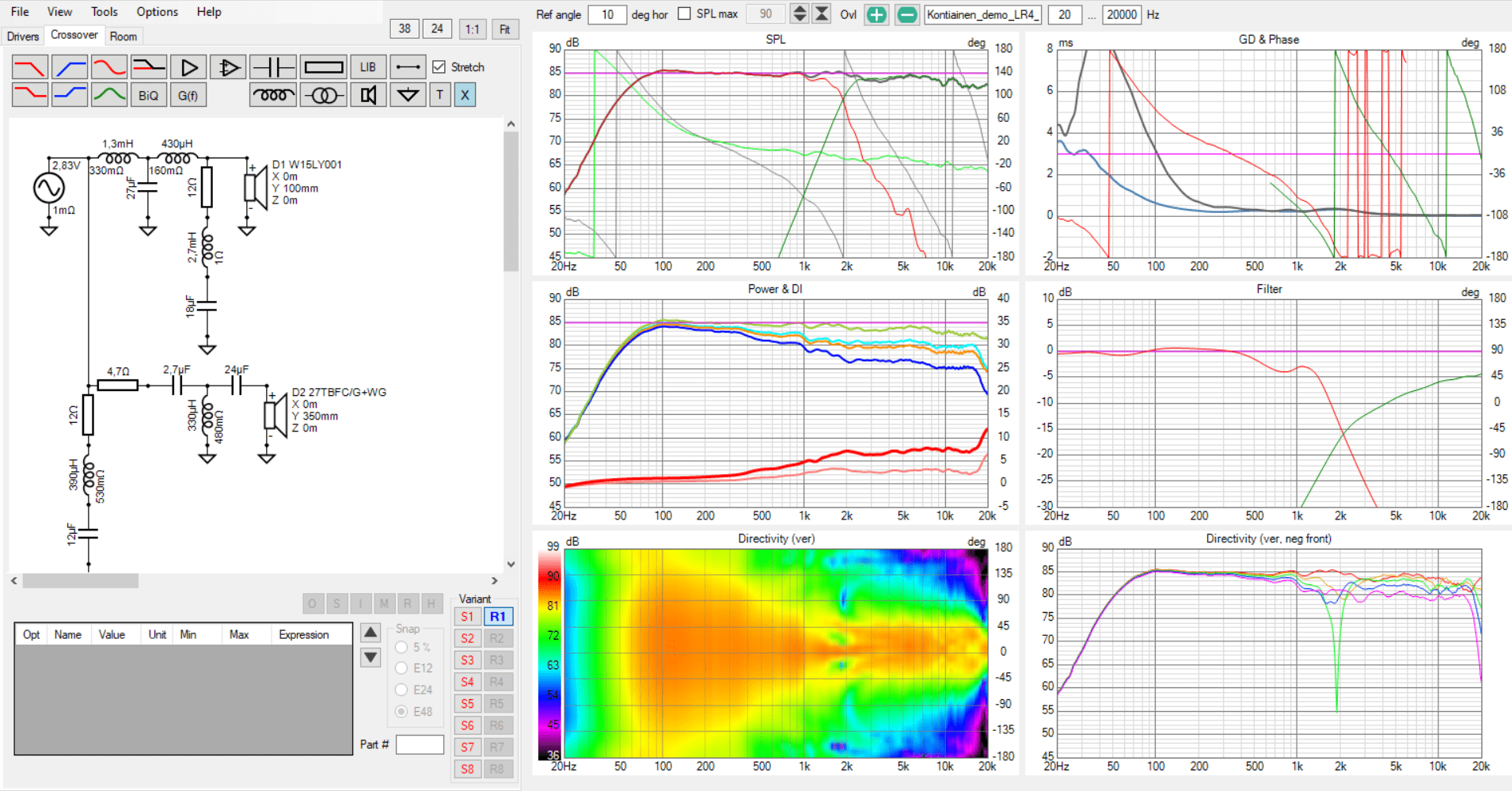

Lets try an example, seated listening is the goal and +/-5 degrees for it is assumed to be fine for design axis, the main lobe. At 3m listening distance specular floor reflection might happen about 30 degree angle depending on the height of the drivers, ceiling reflection is at greater angle. Basically, point the nulls between 5-25 degrees, or perhaps to 15 degrees to make them out from not coloring direct or early reflections. I guess these angles are not in CTA2034 PIR calculation because they don't affect the perceived sound at listening position, hence making the graphs nice by pointing the nulls just below and above listening position would work nicely in reality as well, at least the reasoning seems logical. One should consider their own listening situation what the angles are, not too hard to calculate but missing from the discussion. Lets not forget the nulls are not 1 degree wide and could possibly reach out into both the listening window and the first reflection.

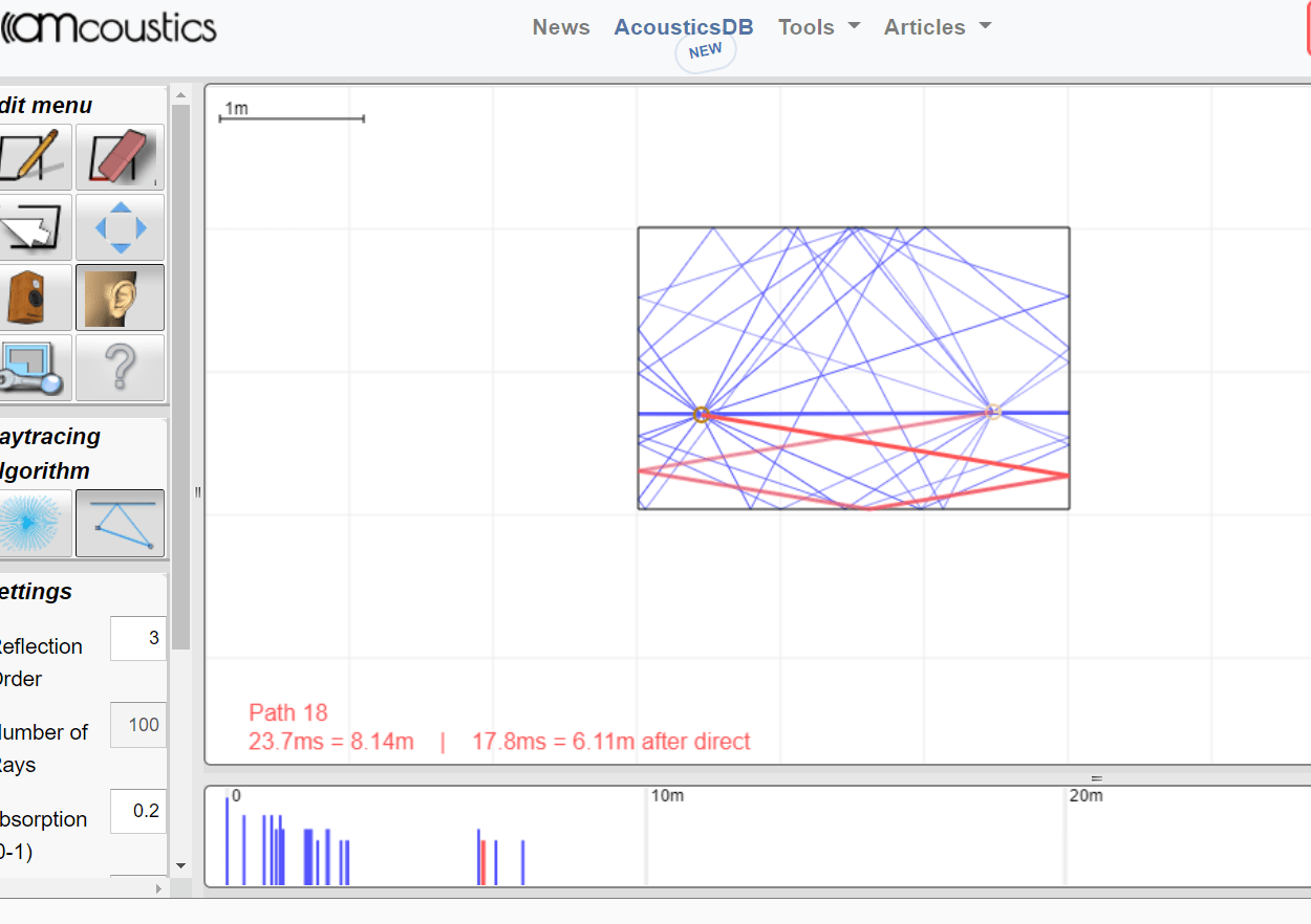

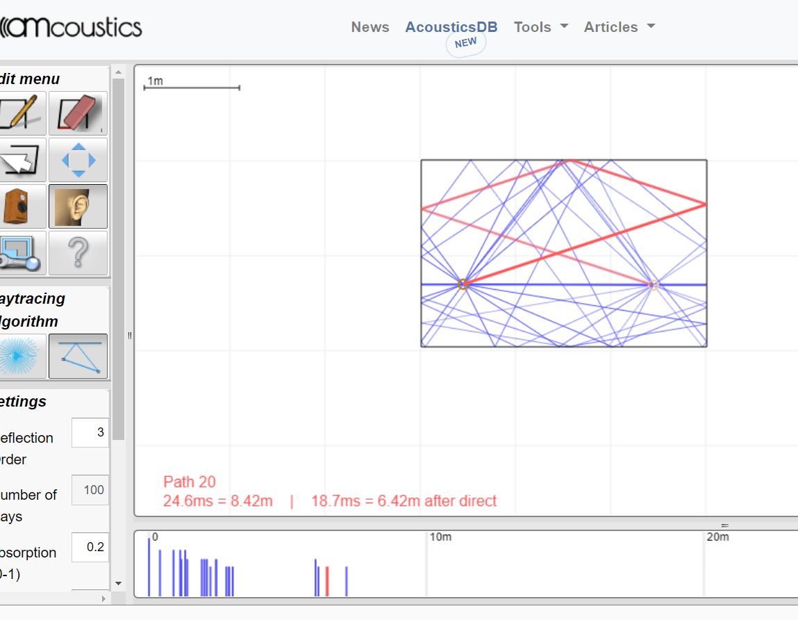

Attached is approximation of typical situation, if nulls shoot where the arrows are they would become at least 3rd order reflections. Change the parameters like listening distance or driver height and the situation changes. If listening distance gets shorter than this the angles toward first reflections get greater and less c-c spacing/ wider lobe works the same, or better since the 10 degree window at listening height is kept or preferably increased. Greater listening distance and it doesn't work anymore because the reflections happen at such low angle the null wouldn't fit between the floor and ear and in this case wider front lobe would work better, which could make null at greater angle and would make it perhaps to 2nd or 3rd order reflection between ceiling and floor.
edit. few more screenshots to show the low angle nulls would ideally make into 3rd order reflections. Very cool tool for this kind of experiments https://amcoustics.com/tools/amray
edit. for the above example of 3m listening distance, ~90cm heights of speaker and listener tweeter at listening height. Here is VCAD demonstration.

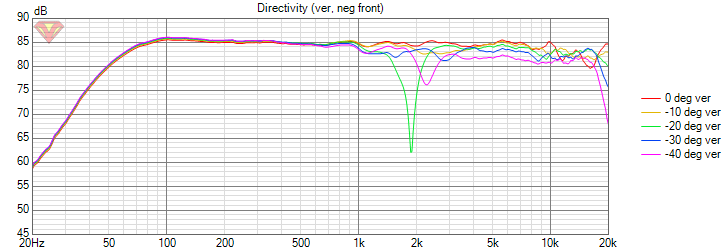

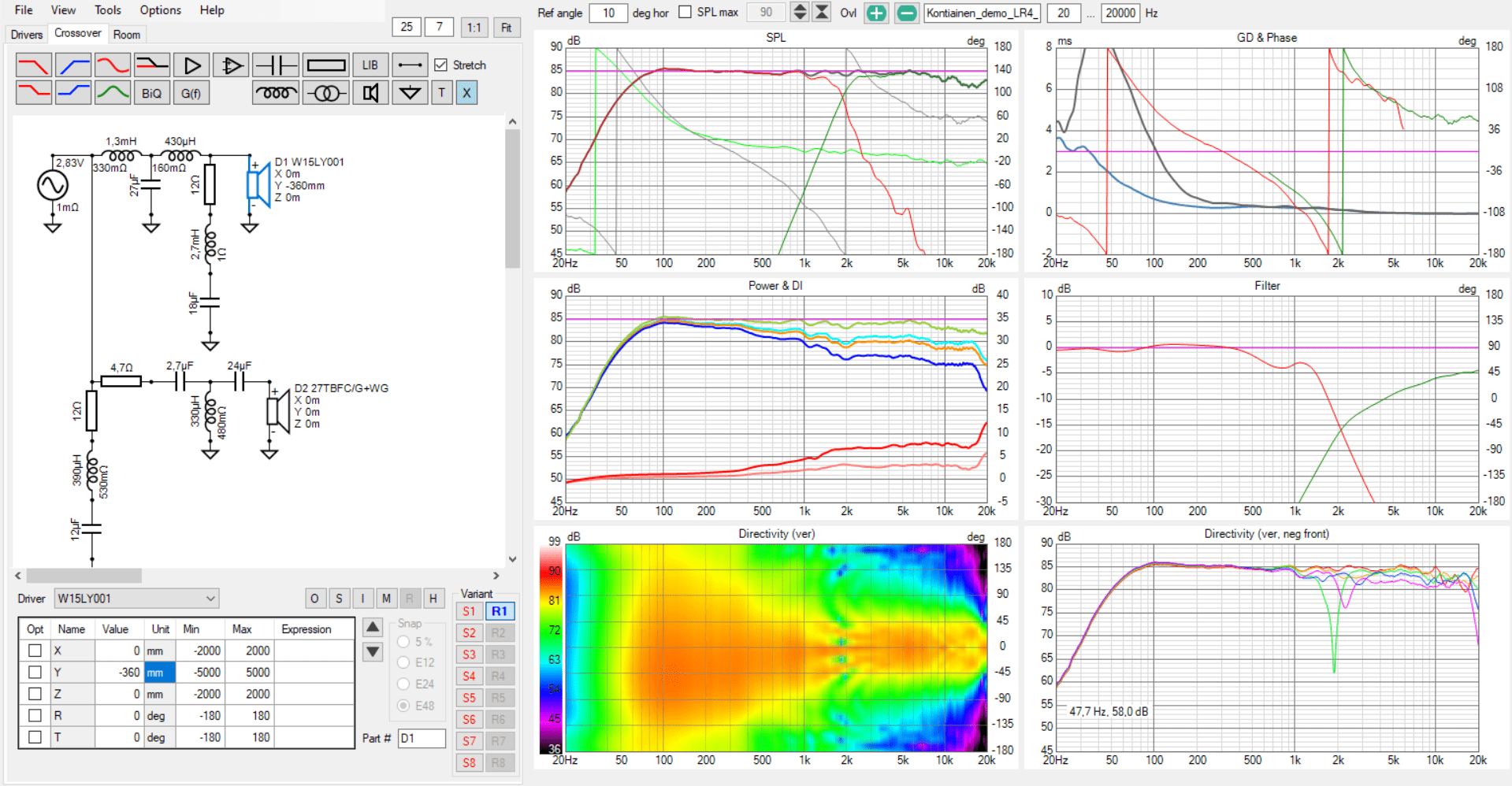

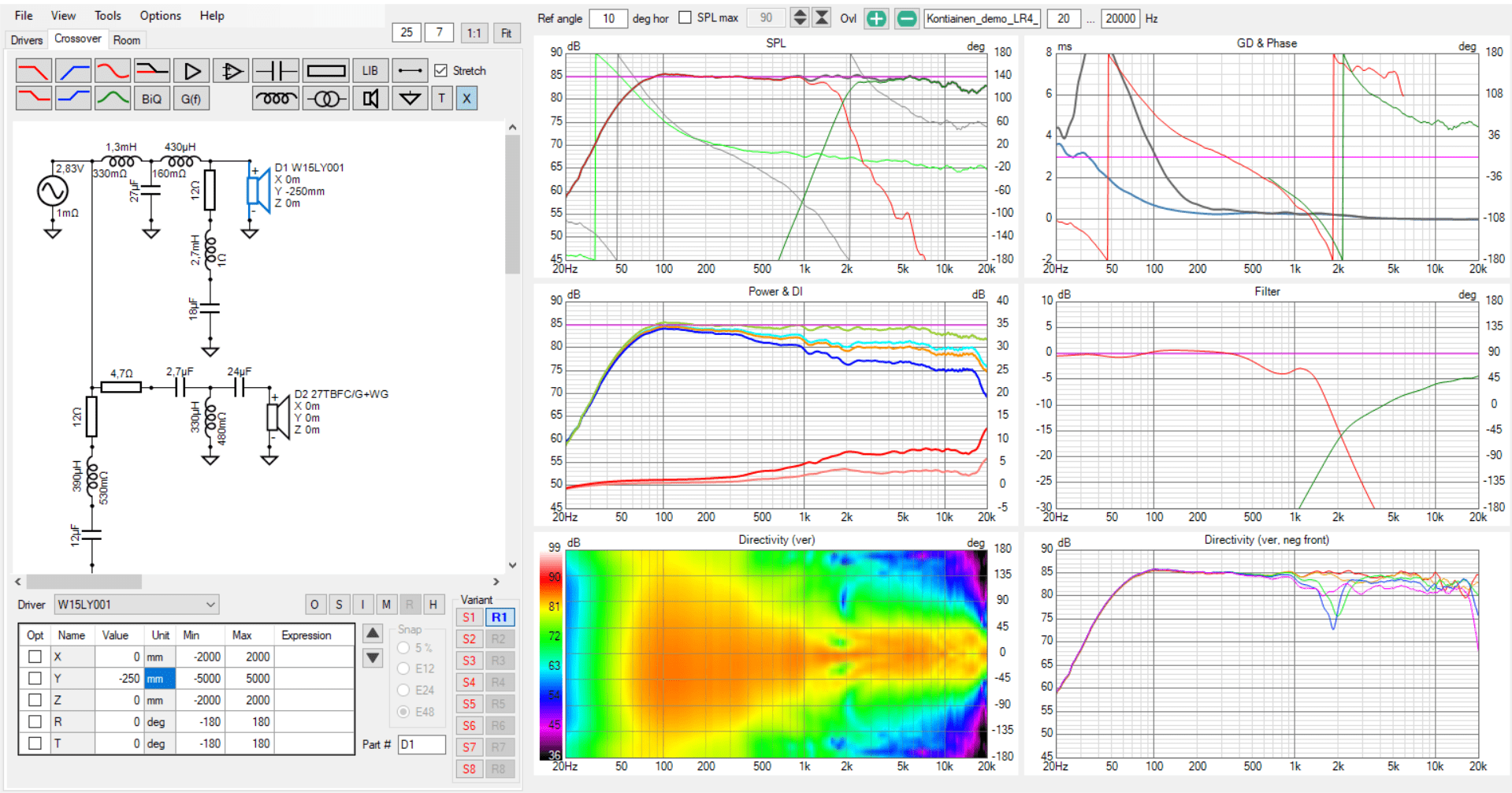

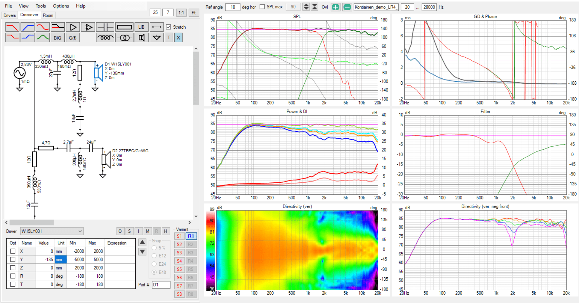

Let's see if the null can be fit between listening window and floor reflection. Look at the bottom right graph which is 0-40 vertical angles towards floor. The reflection in our scenario is at 30 degrees (blue line) and direct sound is 0 degree (red). We'd want the null to happen with the 10-20 degrees lines (green and yellow), more to the 20 than 10 if possible. From this experiment it looks like we barely make it, and it and it takes 2wl c-c! Ideally all red, yellow and blue lines would look the same. 0.5wl and 0.75wl here looks better than the 1.4wl for example, considering just the floor reflection.
From this experiment increasing c-c works better for short listening distances, less than 3m, as the angle towards floor reflection is greater and the null fits into window between the reflection and direct sound. However, angle towards ceiling is always bigger so that would work fine before floor which is the hard case.
If one imagines the situation by thinking size of the main lobe and moving the listener around it is quite easy to see that as the main lobe narrows the more the optimal listening position is constrained (vertically) but also by the distance especially with some height variance. If it is a bookshelf speaker and both the speaker and listener could be at any height or distance out of designers control then it would make more sense to go for biggest main lobe, least c-c spacing, coaxial/point source being the best.
Well, these things can be reasoned from many perspectives and it really is application dependent what kind of system works better.

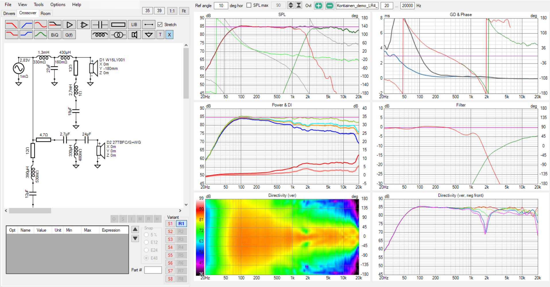

And for completeness sake one more. In the previous post tweeter was kept at listening height and woofer lowered increasing the c-c. Tried to change the height of the system instead and see if the null was just poorly positioned. With 1.4wl spacing it gets a bit better as it should as the null gets better fit between by manipulating the height of the system. But the null is just too big/wide to fit comfortably into the small window between 0-30 degrees.
While I'm not sure how much particular crossover topology affects here and what actually sounds better it looks like the nulls need to be made as small (tight angle span ) as possible in order this c-c trick to work out as touted. With 3m listening distance the 0-30 window is just very small to fit the null into.
Alright, if we decrease listening distance to 2 meters, the floor reflection is at ~40 degree angle which increases our shoot window roughly into 0-40 degrees, in which case we just look the purple line on the graphs instead of the blue one. Red, yellow and purple should be as similar as possible while the null should be on the blue and green lines. With 2m listening distance the 1.2wl or 1.4wl c-c for works nicely, better than 0.5wl for example. Just see the graphs posted on the previous post.
To recap my thoughts on the experiment: the increased c-c makes DI look nicer but does not help much with the first reflection if the angle to the reflection (floor) is small. Fitting a null into a small angle between listener and reflection is possible increasing c-c distance but this also makes the main lobe increasingly narrow. It looks like adjusting c-c suits nicely relatively short listening distances where angle towards first reflection is > 40 degrees where as at 3m and longer listening distance it makes more sense to use biggest lobe possible, smallest c-c. However, not knowing how these scenarios actually sound and that ceiling reflection is at greater angle even at 3m listening distance I cannot say which is actually better. It is great relief though, for builder, to know that there is no necessity to cram everything very close and roughly similar performance can be had with increased c-c especially if there are other compromises that would benefit doing this.

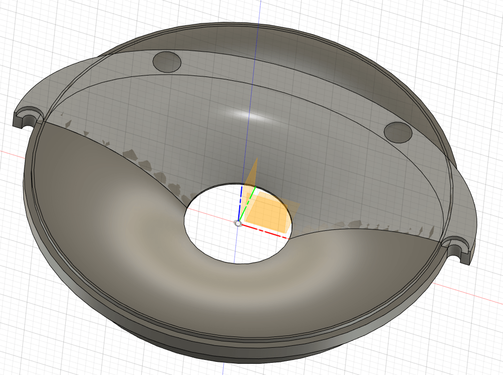

If you had a round waveguide you could just fudge it with VituixThe difficulty being that it is vertical measurements which requires a bit more work to the turntable setup etc. But it will be worthwhile testing.

The DI of a round waveguide should be a better match to the vertical of a round woofer but the best profile for a round waveguide may not be the same as it is for the horizontal part of an elliptical one.Would the round waveguide matching the woofers directivity on the vertical axis make a difference and if so, how much?
A round version can be made from the step files

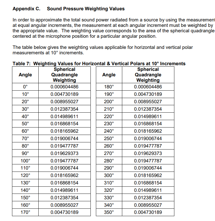

Attached is weights from CTA2034 used for power calculation with 10 deg measurement steps. As null is moved from ~40deg to ~20deg and is made "narrower" the weighting halves and partly smoothens the power just by that. One could still listen at the nulls even if the power was smooth. Perhaps they are wisely chosen weights? I'm not exactly sure if this is just a technical thing that needs to be taken account or something that would actually make some angle more important than some other. Weights (angles) on the PIR calculation is another thing, which I can't currently find what those were.

Edit: Yeah the power weights are just technical thing like fluid points out in the next post. PIR includes some particular angles (average of several). This reads in CTA2034-A standard page 54:
Sound power represents all of the sounds arriving at the listening position after any
number of reflections from any direction. It is the weighted rms average of all 70
measurements, with individual measurements weighted according to the portion of the
spherical surface that they represent. Sound power is a measure of the total acoustical
energy radiating through an imaginary spherical surface with the radius equal to the
measurement distance. Thus the on-axis curve has very low weighting because it is in
the middle of other closely adjacent measurement points (see the perspective sketch at
the top of Figure 1) and measurements further off axis have higher weighting because of
the larger surface area that is represented by each of those measurements. Ideally, such
a measurement would be made at equally-spaced points on the entire surface of the
sphere, but this simplified spatial-sampling process turns out to be a very good
approximation. The result could be expressed in acoustic watts, the true measure of
sound power, but for the purposes of this standard it is expressed as sound level, a
frequency response curve having the same shape. Any bump in the curve that shows
up in the other curves (on-axis, early reflections, etc.) and persists through this ultimate
spatial average is a notable resonance. Calculation of the sound power curve begins with a
conversion from dB to a scalar magnitude. The individual measures of sound pressure
are then weighted according to the values shown in Appendix C and an energy average (rms)
is calculated using the weighted values. The final average is converted to dB.
