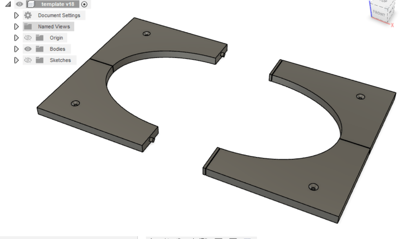

I've finally added router templates for elliptical waveguides to my website! You'll need 5/16" OD and 1" OD template guide bushings to use them. There are holes that will accept #4 sheetmetal screws, or you can use a finish nailer, or double-sided tape to attach them. https://www.somasonus.net/waveguides
FYI, I ended up going with .stl over 3mf. When I tested a couple vendors, some don't recognize 3mf yet. This is a bummer because 3mf allowed including the engineering units in the file, so there would be no more confusion over metric vs standard. Also, weird internal faces throwing errors were supposed to be reduced because 3mf has a better storage format. Oh well.

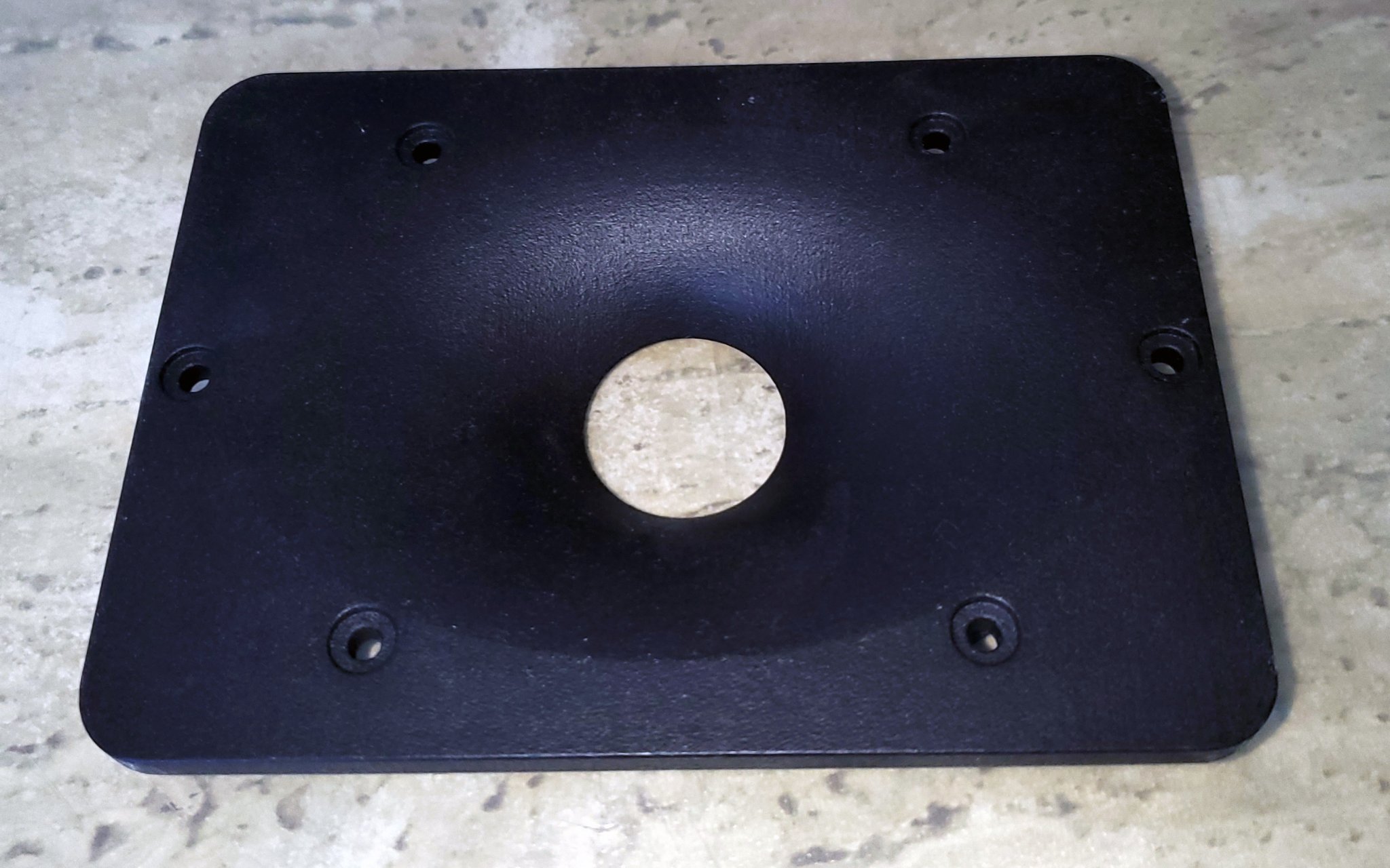

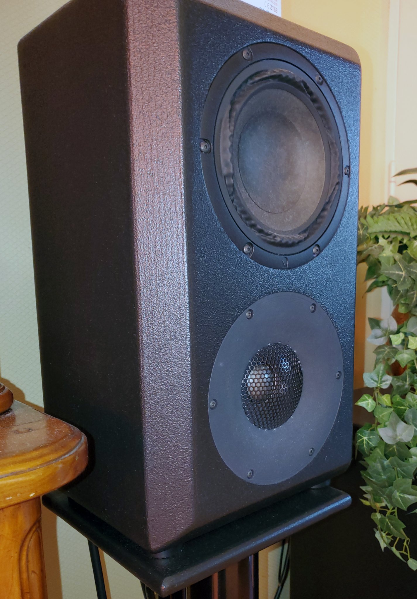

Brandon,
I sent 2 files to i.materialize and I confirm they have good price, I select SLS with black satin diying and to me it looks good enough for my project
