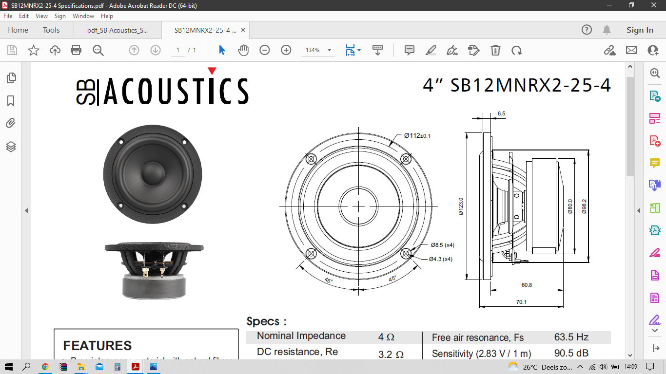

Can someone help me out to alter the 4"waveguide for SB26-ADC to match the size of a SB12MNRX2?
Keeping the original shape of the waveguide of course, but make a round frontplate which has the same size as the SB12MNRX2 driver and same positions of the scrww holes.
I dont have any knowledge about designsoftware

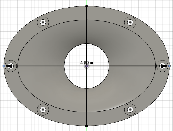

I have T25B on order, 2-way pairing with Purifi 6.5X04 in a 13L enclosure with 2 PRs. Shifting from a DXT 27T, which is great, I’d like to explore the Bliesma with a WG available on tap. Seems that an oval design might be better suitable for my listening room which is relatively large 4m x 9m x 3.5m high (no carpets, limestone floor, concrete walls and lots of glass windows). Assuming that I’ll run active, which wg size would you recommend? I like a small tweeter visually (5”68) yet it’s secondary to audio quality.
Currently I'm crossing at 2.15 KHz with the DXT, I'm hoping to drive the T25 lower towards 2KHz or maybe less. I'll need to do some measurements and attempt to align phase. 6" or 6.5" oval or circular ?Where do you plan to crossover? I would look at the 6" or 6.5".

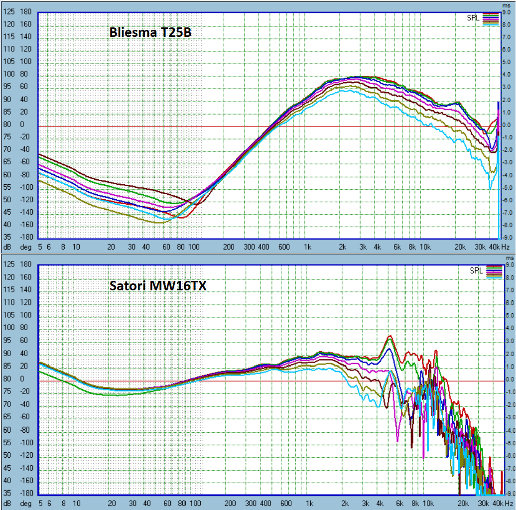

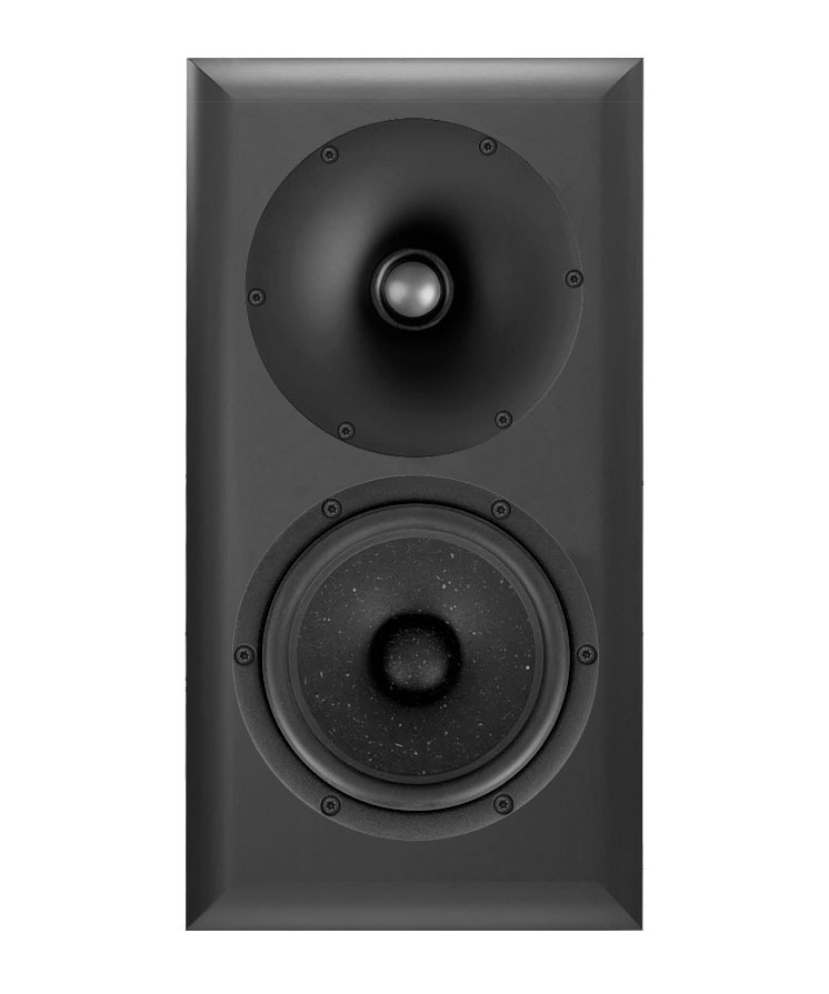

I've started designing two families of speakers, one family based on SB "ceramic" drivers, and the other on Satori Textreme and Bliesma Be drivers. Yesterday I measured the prototype of a 2-way TM speaker to verify diffraction modeling. I just wanted to share some of those measurements, I'm very happy with the results. Waveguide is working properly and the T25B is so smooth on it. Just as important, the woofer hardly shows any diffraction hump, just like the ABEC model but I had my doubts it would actually look so good. Plots are 0-60 degrees horizontal, 7.5ms gate and no smoothing.

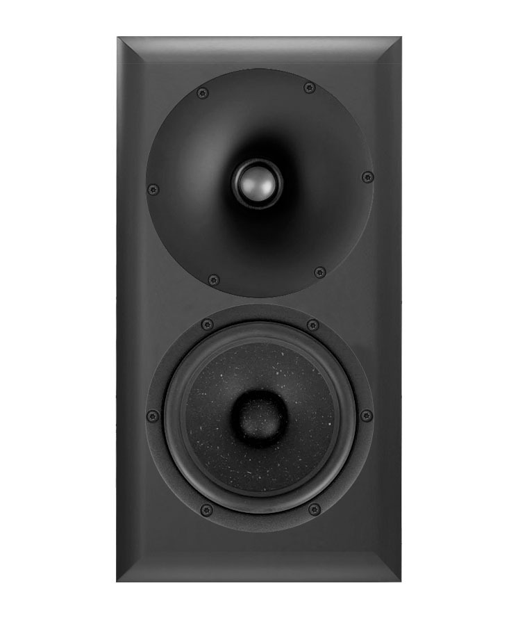

Here are some additional details about the new designs. Waveguided tweeter of course. Simple CLD construction based on my testing in another thread. High performance port that will be available for printing in 3 variants: high performance contour, HP contour with full damping of port resonances, HP contour with some damping of port resonances, but better chuffing/distortion behavior than the full damping version. Both active and passive versions. If there is interest after I publish the TM proofs-of-concept, I'd like to move on to a WTMW center channel, and main speakers of undetermined layout. But constrained vertical directivity will be a goal for the mains, so possibly MTMWW or WMTMW.

Regarding the speaker family based on SB "ceramic", are these TM? what size/model of woofer?
Also, looking forward to the livestream with Erin!
First one will be TM, using SB17CAC. Once this proof-of-concept is finished, the other variants will created.

I suspect better low end performance allowing reduced distortion at lower XO frequencies eg. 1KHz and better directivity match. At the top octave, the far off-axis (60-90 degrees) will be reduced.
